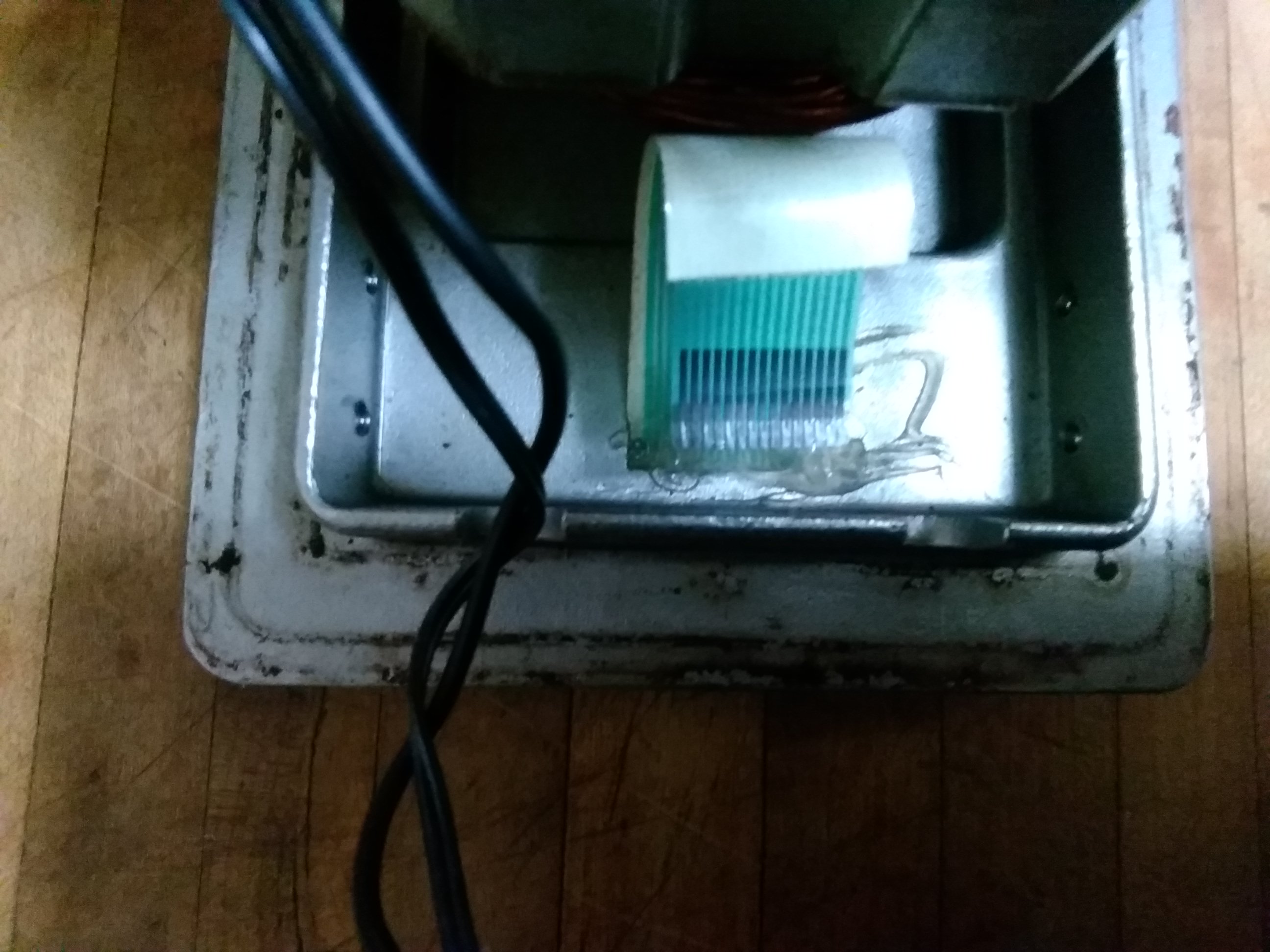

      Hi! I have an ICB3 Blendtec smoother and I have been having a similar issue. Lots of sparks come from the armature followed by the "overload" error on the display. I have taken unit apart, cleaned the armature with 400 grit sandpaper using a drill to rotate, and am still having the same issue. The brushes are new as well.
      Any idea as to what else could cause this to spark excessively and give the "overload" error?
      Attached is a photo of the commutator now that it is cleaned. There is one area that the gap is slightly larger, I'm wondering if this could be part of the problem? Any thoughts?
      Thanks!

          New brushes, or if you moved/flipped the old ones, you have to break them in and seat them properly.
          Partial contact will make more arcs and can damage new brushes or the commutator copper because you have high-currents flowing on small contact area. Look really hard to see if the brushes are fully seating the commutator copper - not sitting crooked, misaligned.
          Break-in usually looks like running the motor at lower speeds for 15 minutes, with a variac or series light-bulb. With no-load, it should only use a few amps at most. This is just to get the brushes worn in enough to mate with the commutator.
          You could look for a local electric motor repair shop and put the armature on their "growler".
          This is to check for any short-circuits on armature windings or between the commutator leafs. An ohmmeter might be able to find shorts too.
          These Blendtec motors look very small for their 13A rating. chinese motors are worked very hard and don't last due to heat or cheapness.
          The one copper leaf that is arced up, is suspicious - does the opposite side have the same missing copper? It might be a shorted winding there.
          There is a small chance the control electronics is wrongly reading high current and nothing is wrong with the motor.

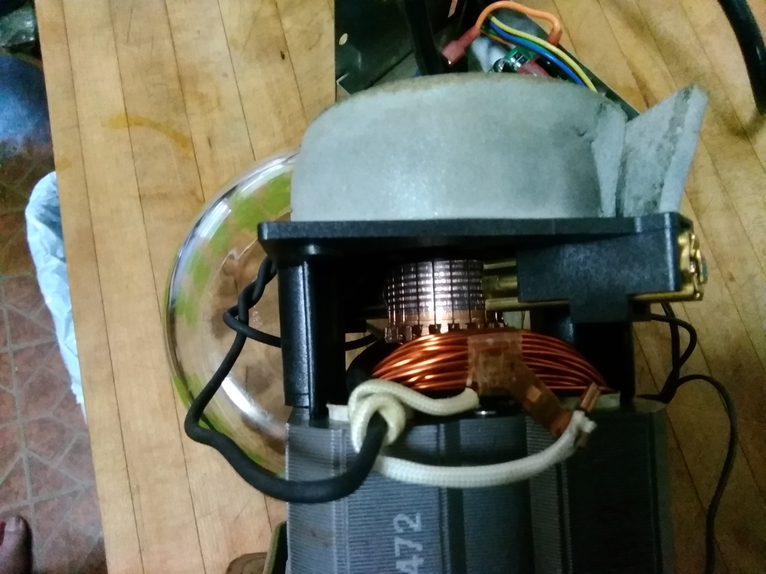

                    After two weeks I finally get the nut off the commutator, but taking the fan blade out puts me no closer to getting the brush holders out.
                    If I get them out they will be mangled, so since no one has posted the dimensions can someone tell me what size brush & holders to get?
                    The commutator may be my problem going by how scratched up it is. (See pic). But I may also need the ribbon that carries data between the motor and PCB. Does anyone know the name and where to get it? (It has 15 traces).
                    Edit: I got one brush housing out, and "61C" is stamped on the brush.
                    Thanks.
                    Darren

                          All I could find is one part used on a few Blentec products but no mention of the Smoother 13. Blendtec brushes 10-030-03 obsolete, replaced by 10-030-04. If you know the size and shape you can get them from Ali very cheap.
                          I saw the youtube video where the guy had a junk Blendtec and then cranked up the speed with a variac until it burned up and he killed it.
                          I noticed massive arcing, a ring across the entire commutator so I have to wonder if the motor is a cheap, small design. The commutator seems really small for the voltages and power.
                          I would try add capacitor across the brushes to calm down arcing. Like a 47nF 275VAC film X-cap.
                          When you put the brushes back in, make sure they are not flipped or mixed up, so they seat nice and flush on the commutator. I've learned to mark them with a pencil to show orientation.
                          The sandpaper rough finish on the commutator will help with break in. Some people undervolt the motor and run it for 15 minutes to seat the brushes. It probably runs on 25VDC.
                          Your only challenge is if there is a shorted winding on the armature.
