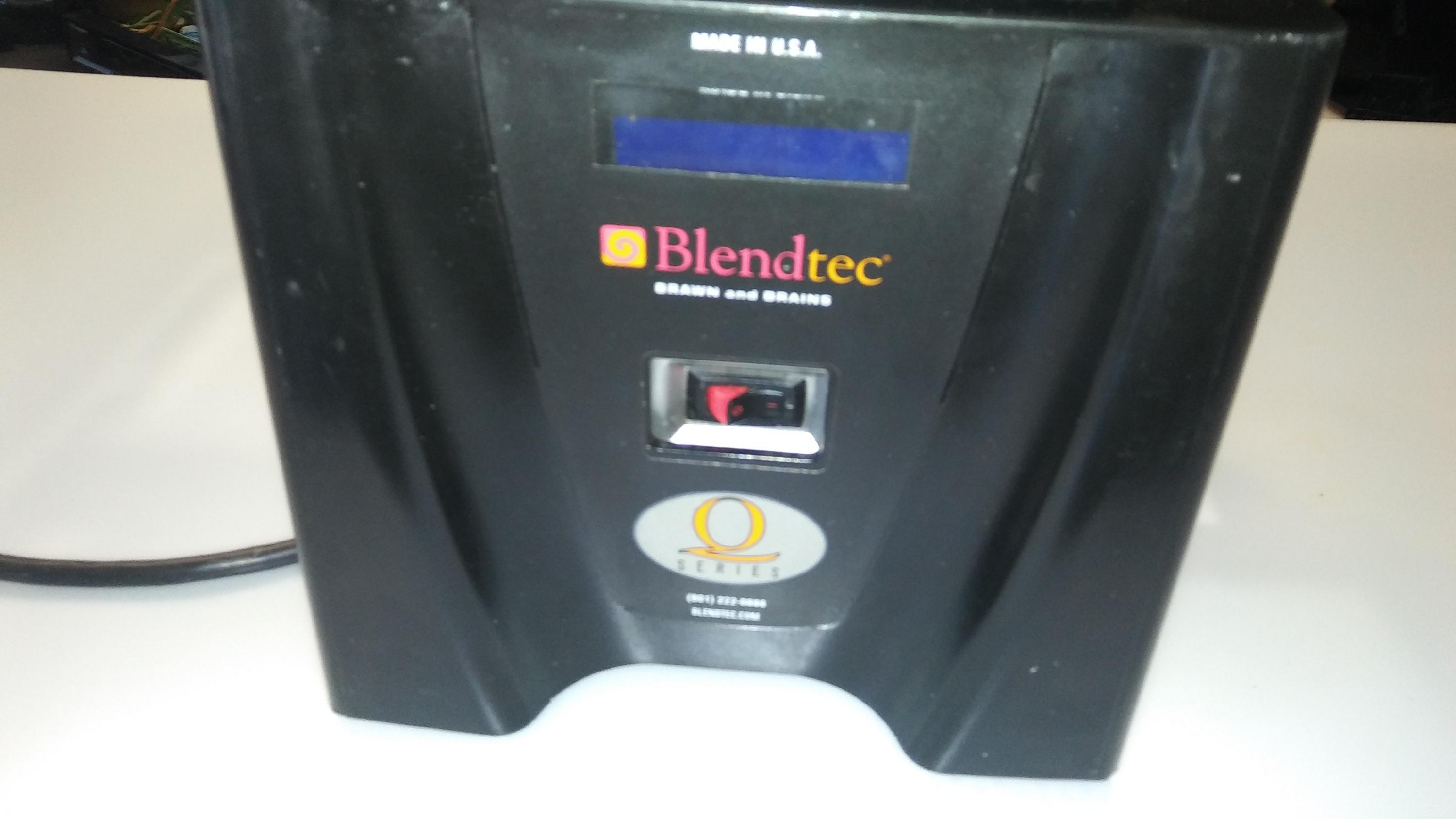

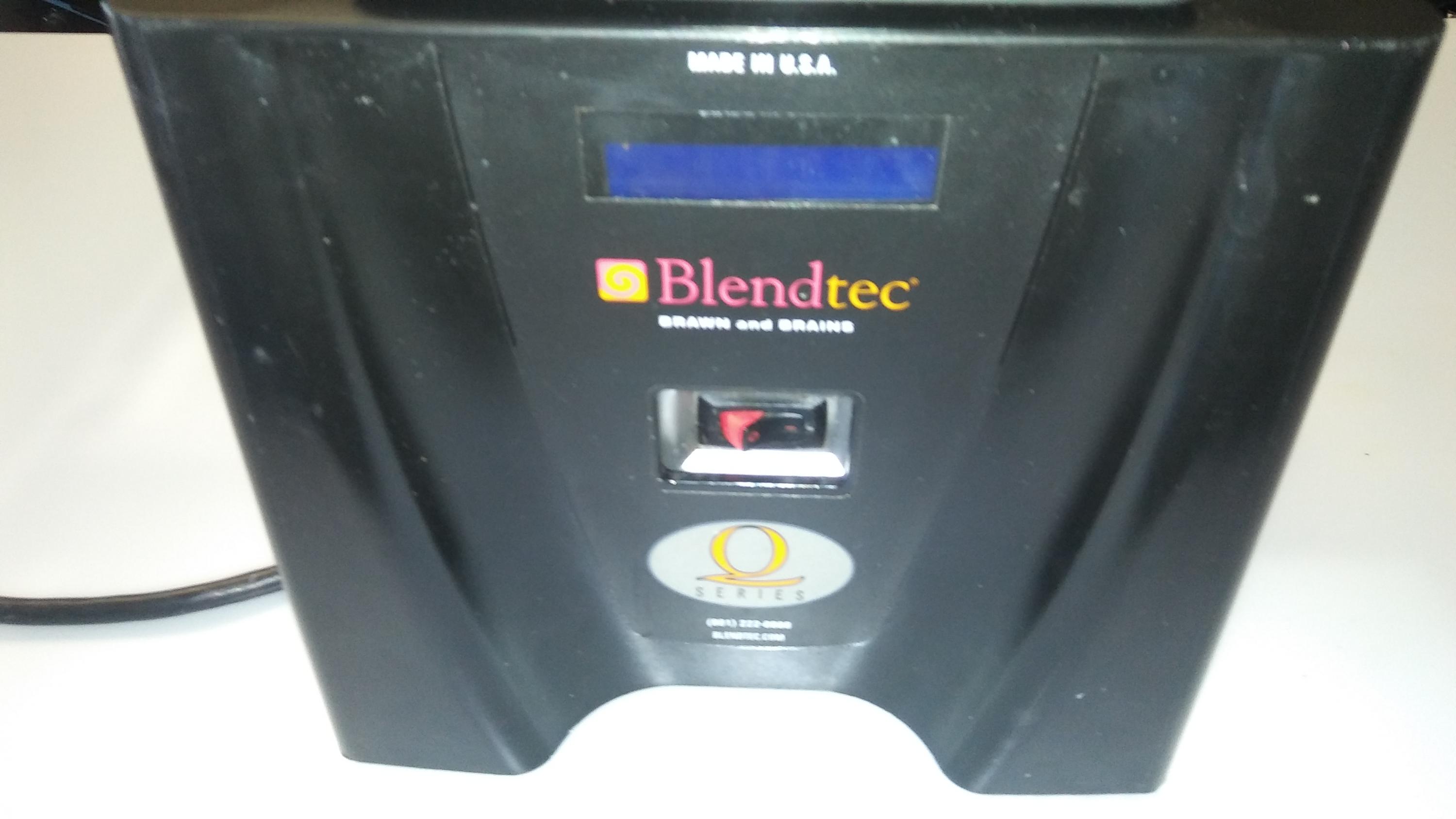

Blendtec smoother 13 repair.
  • capwizard
    • Jun 2016
    • 1991

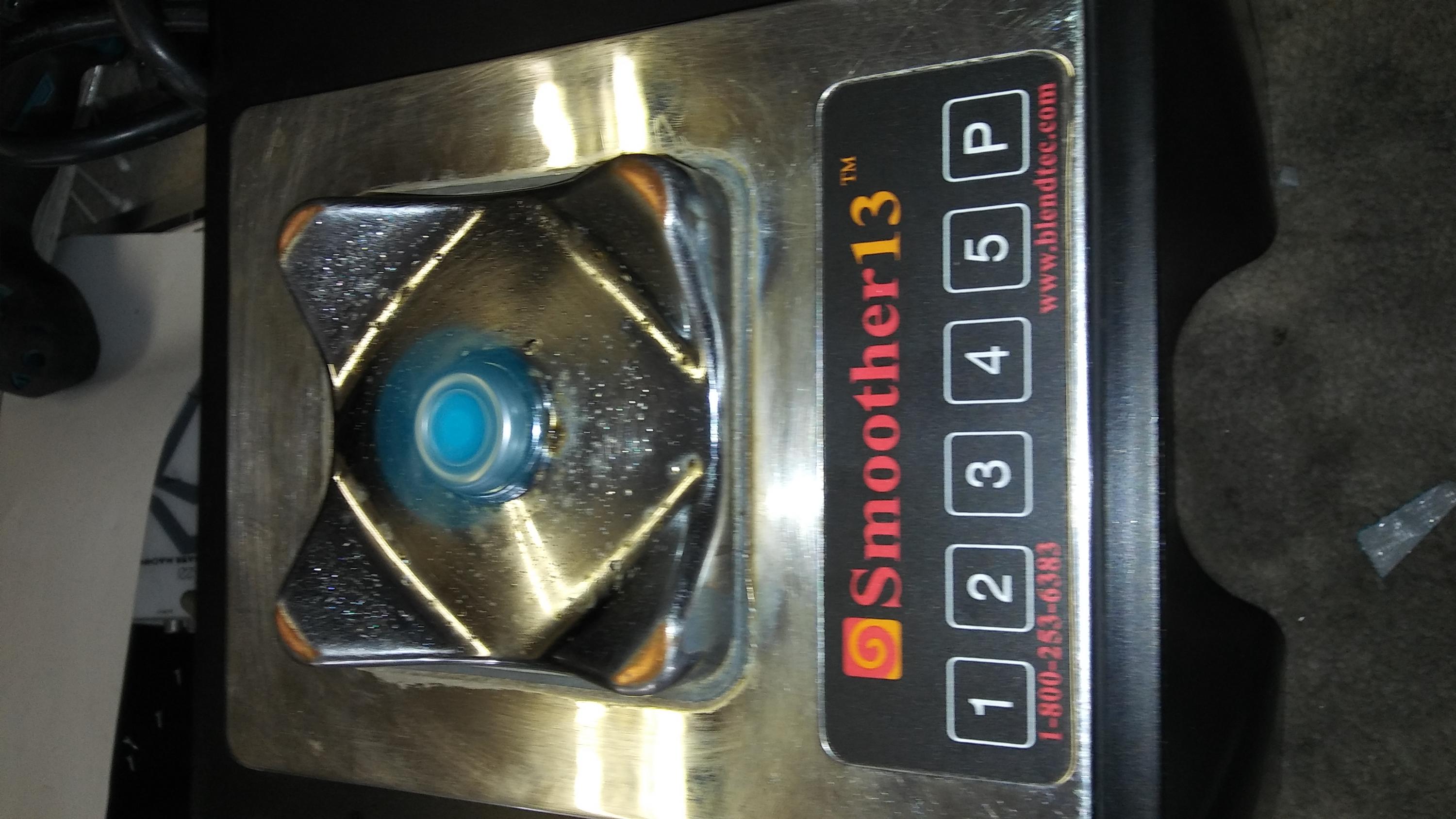

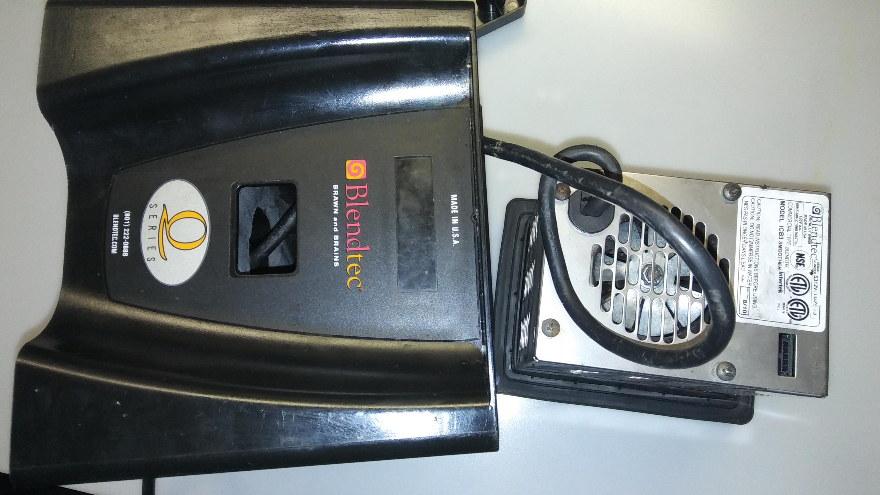

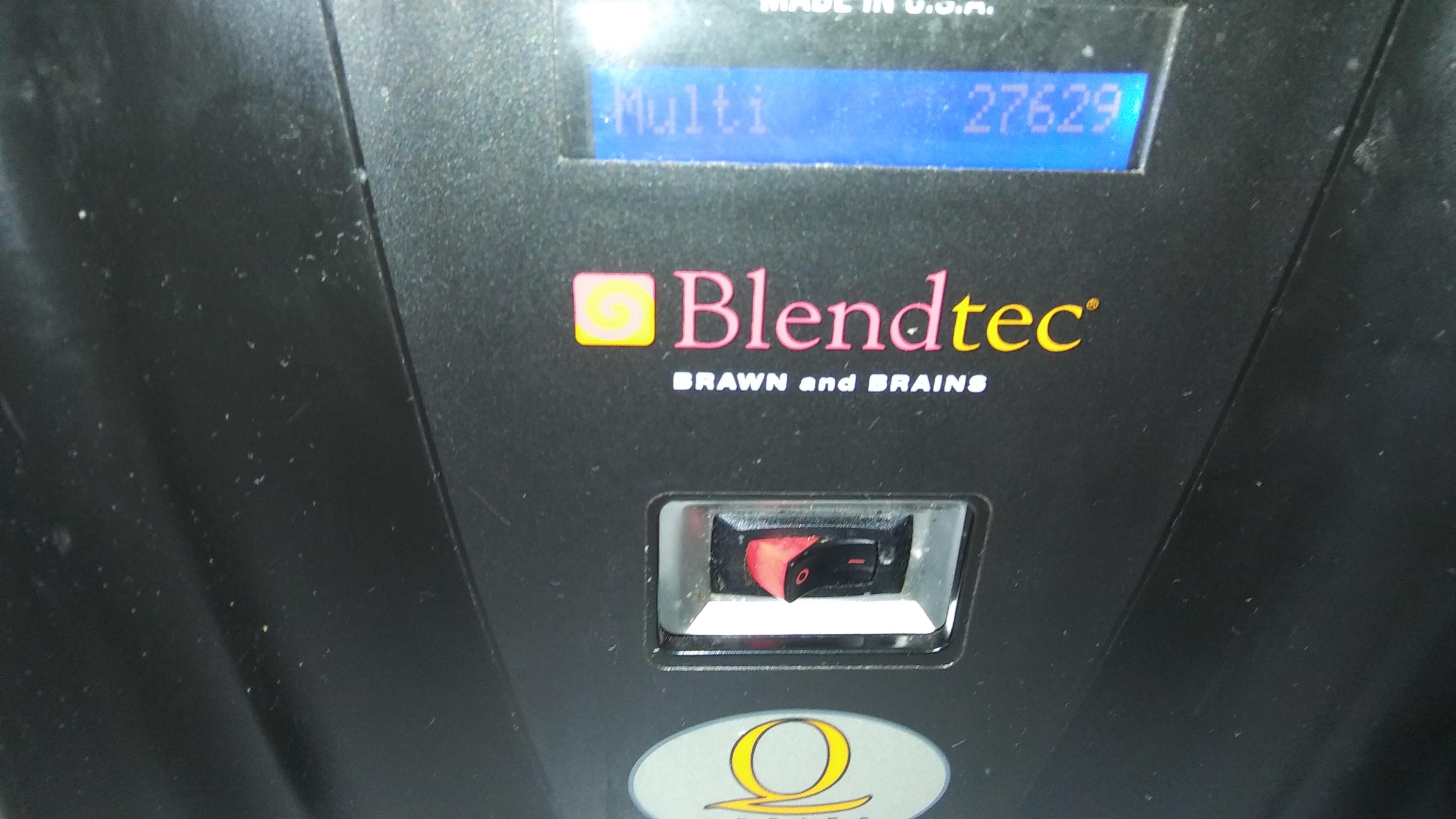

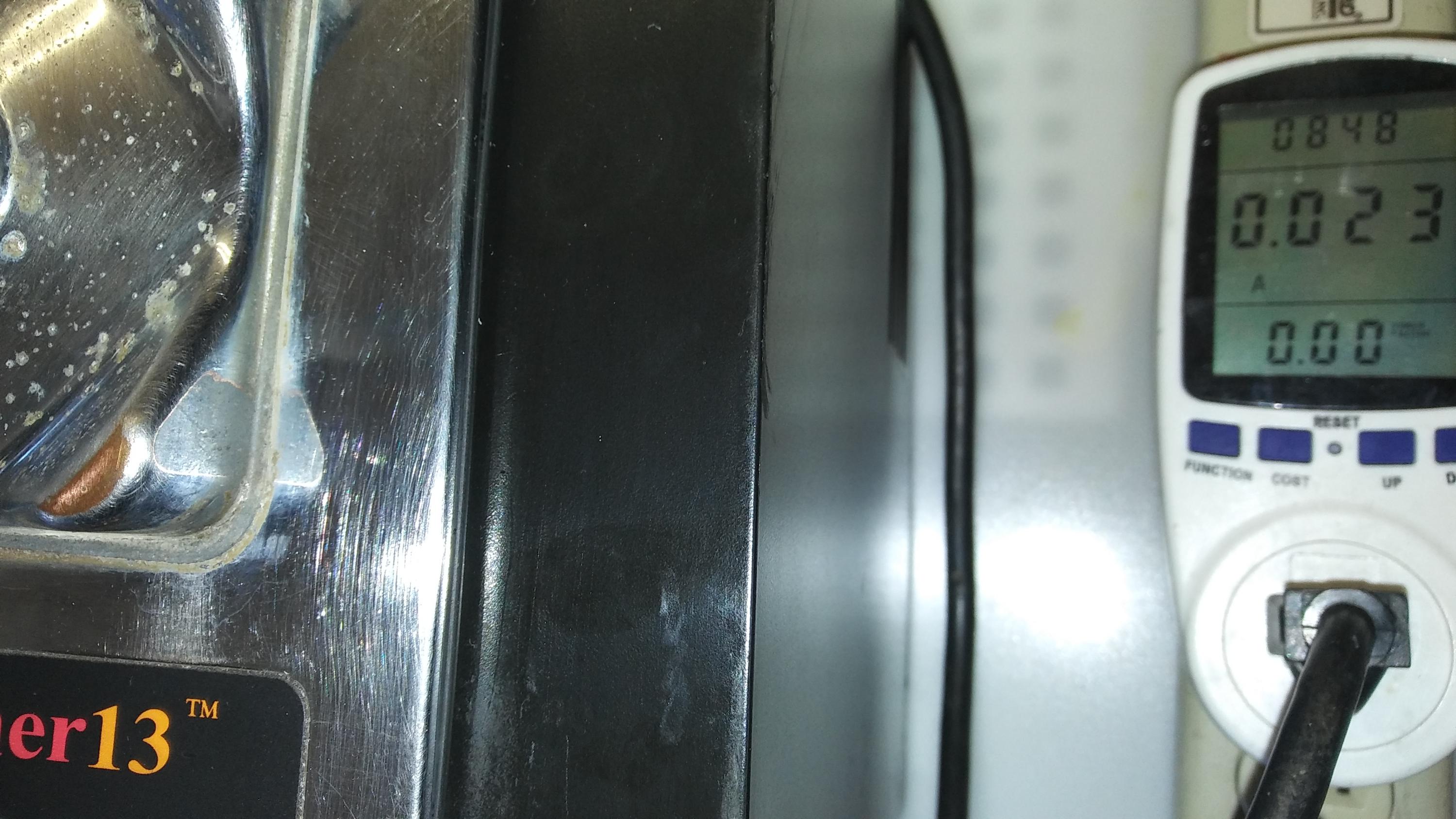

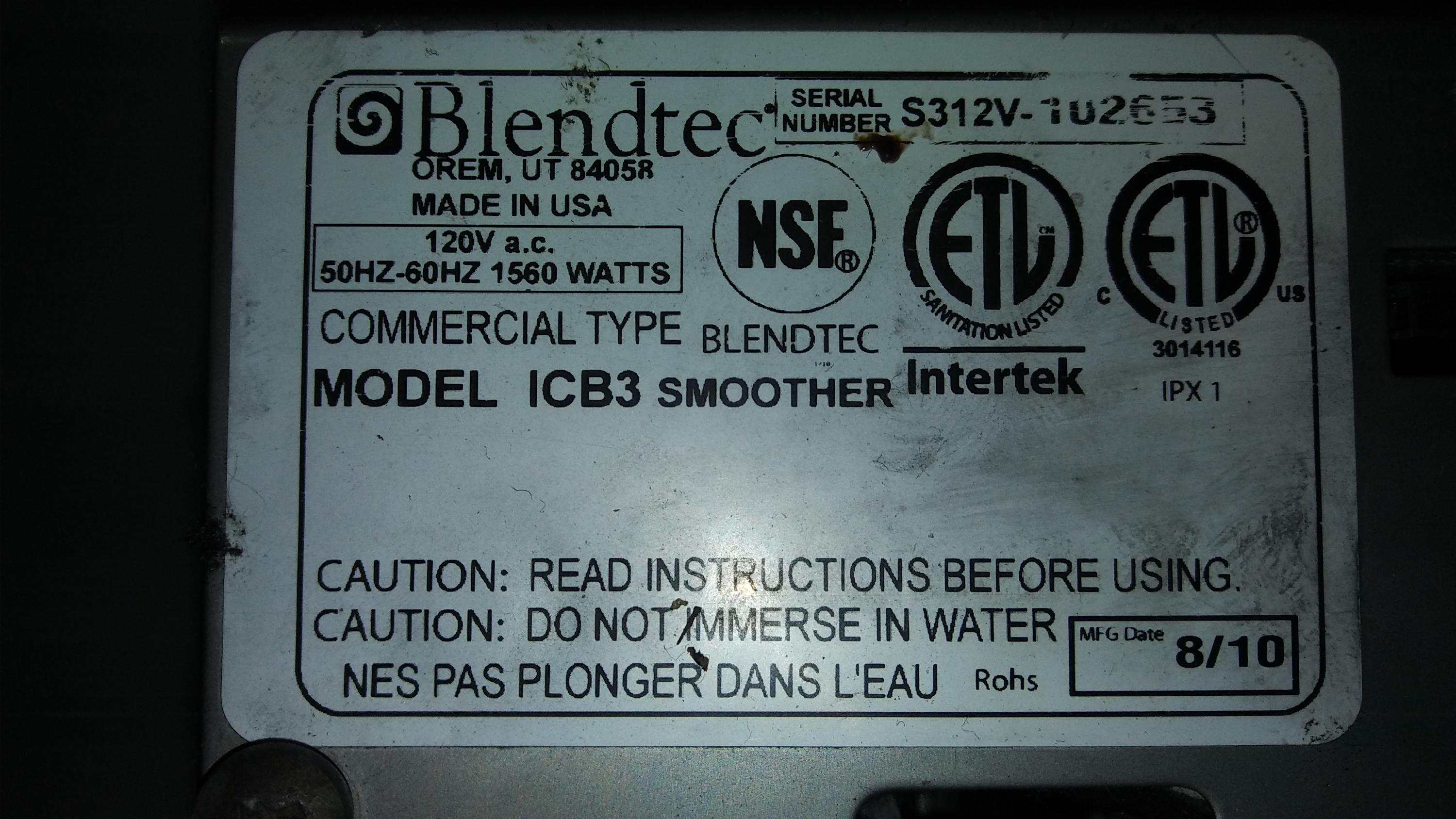

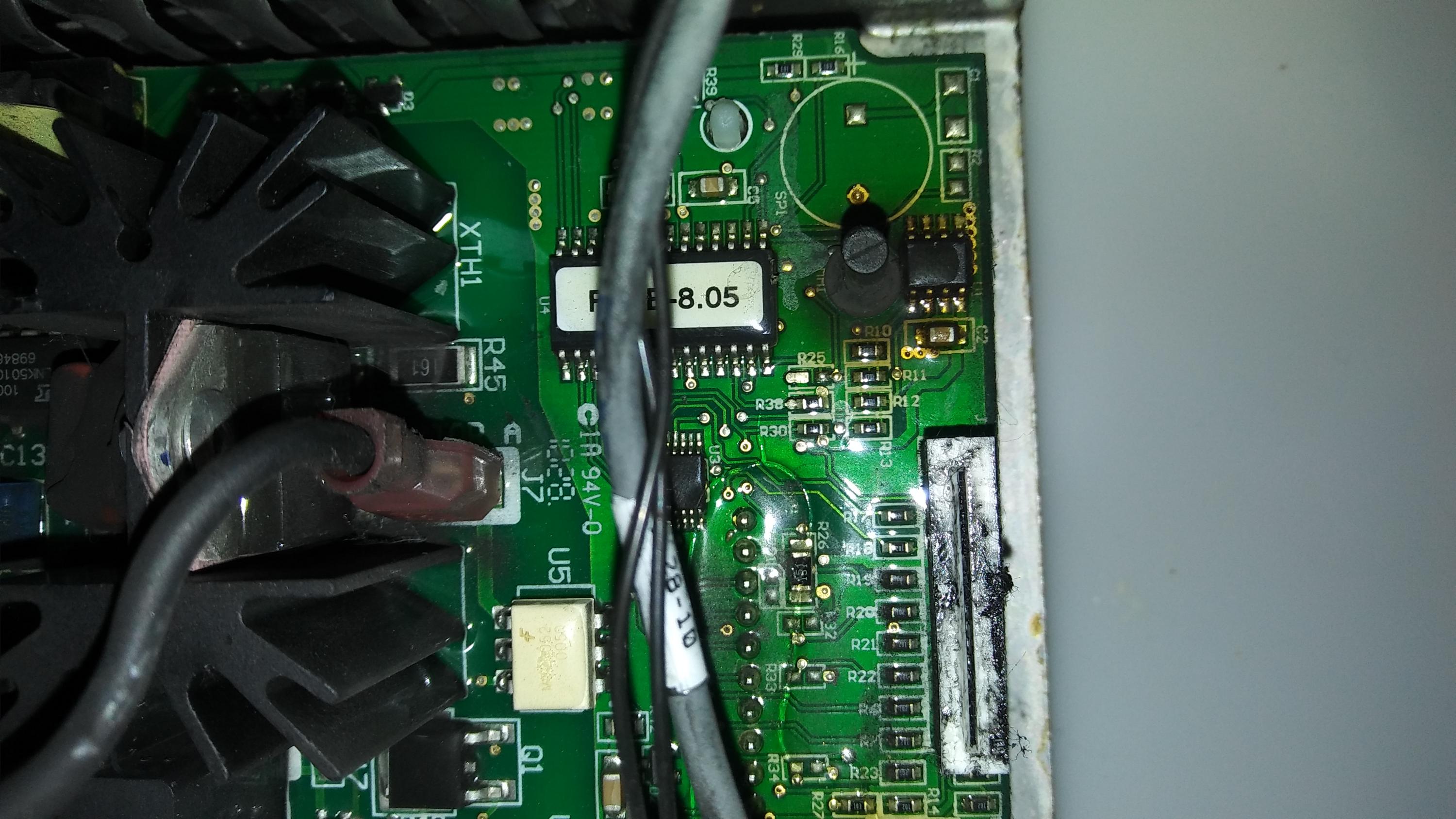

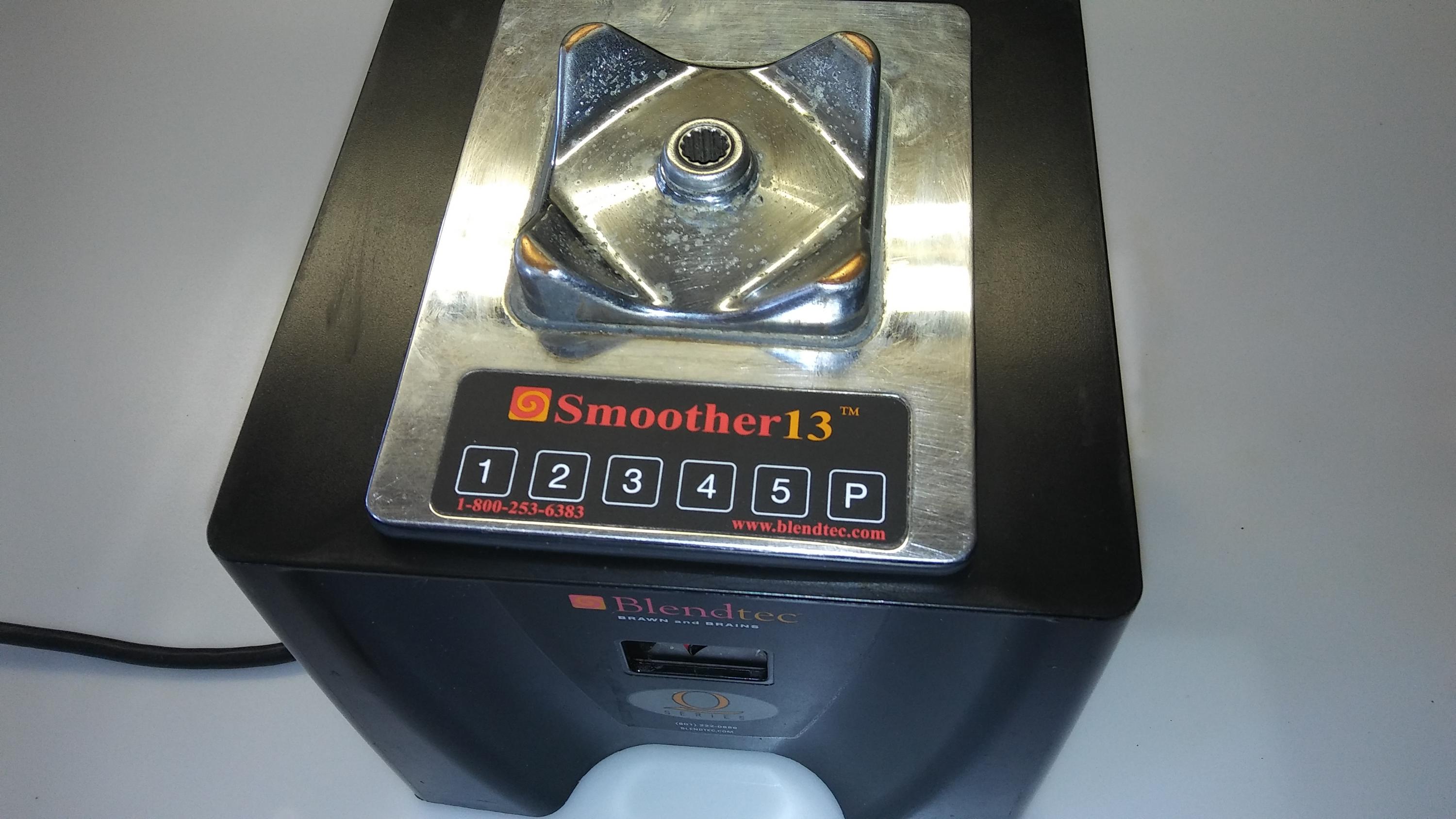

    Blendtec Smoother 13, He said " no power, it cast $2000, from Starbuck Coffee, Boss gave to him, free, see if it can be fix!"
    PS: I plug in, it does has display!

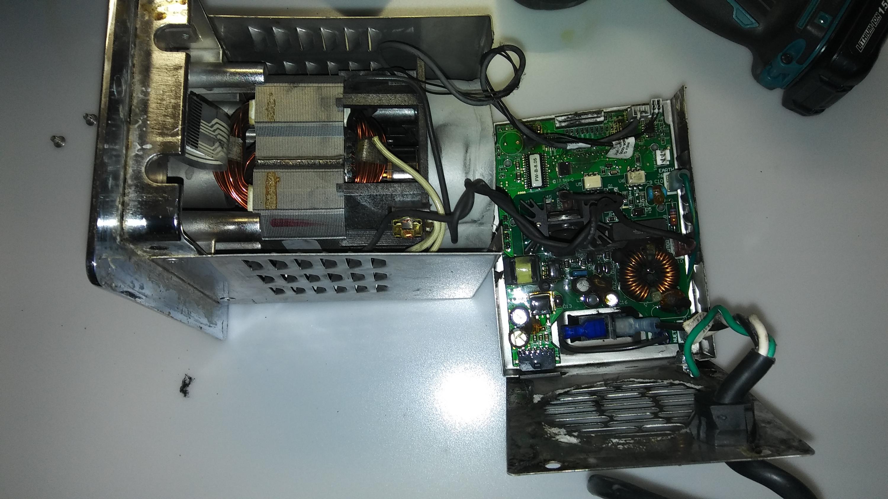

    Re: Blendtec smoother 13 repair.
    I cant open this ICB3 blendtec, Googling found those videos.

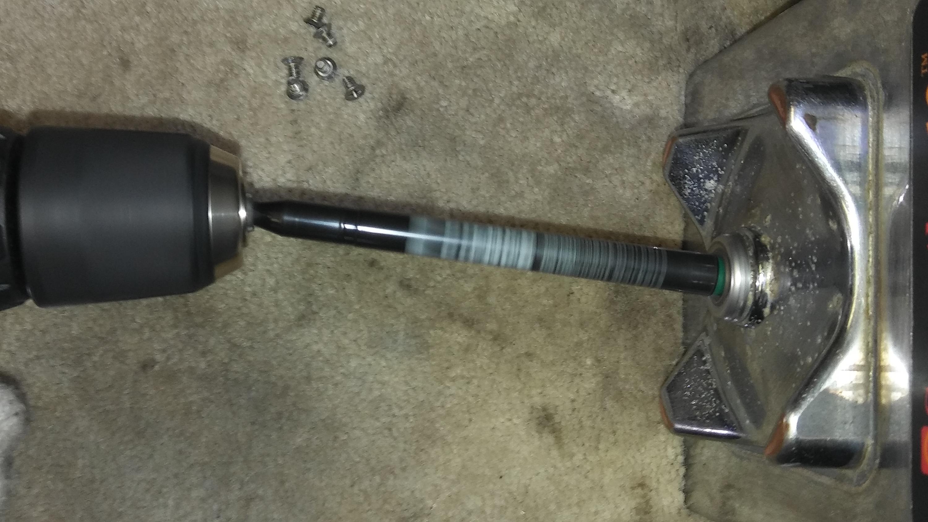

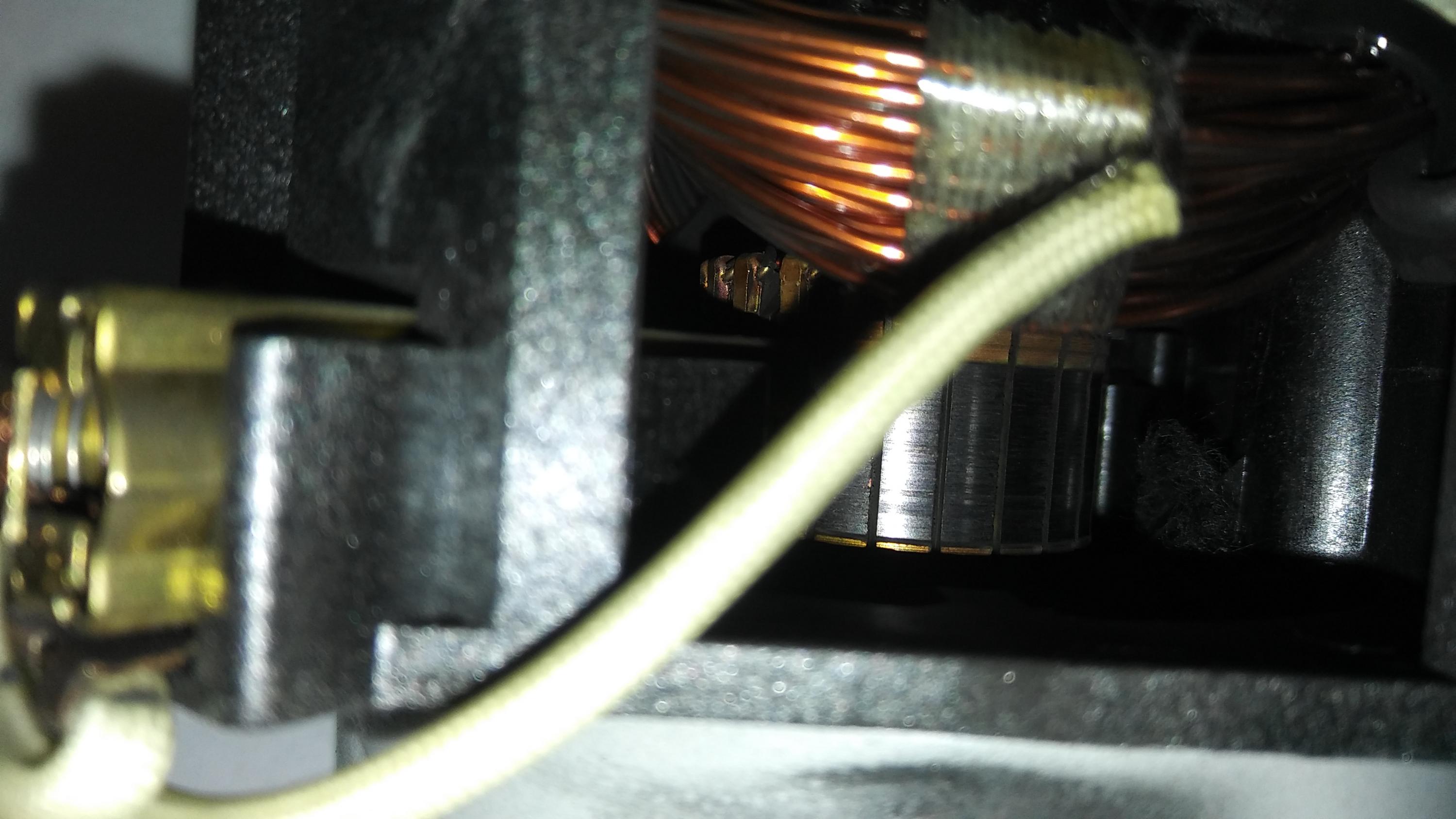

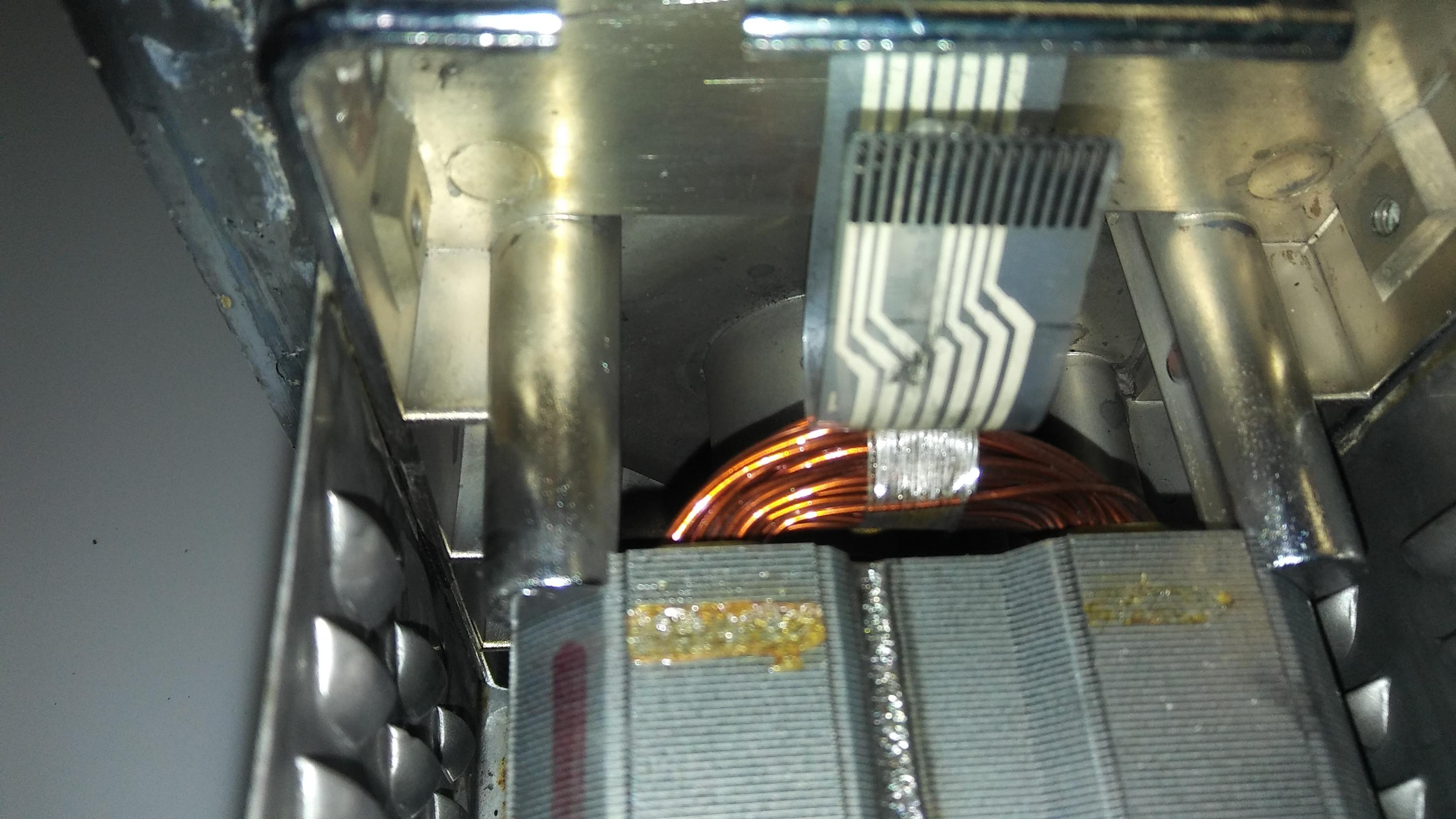

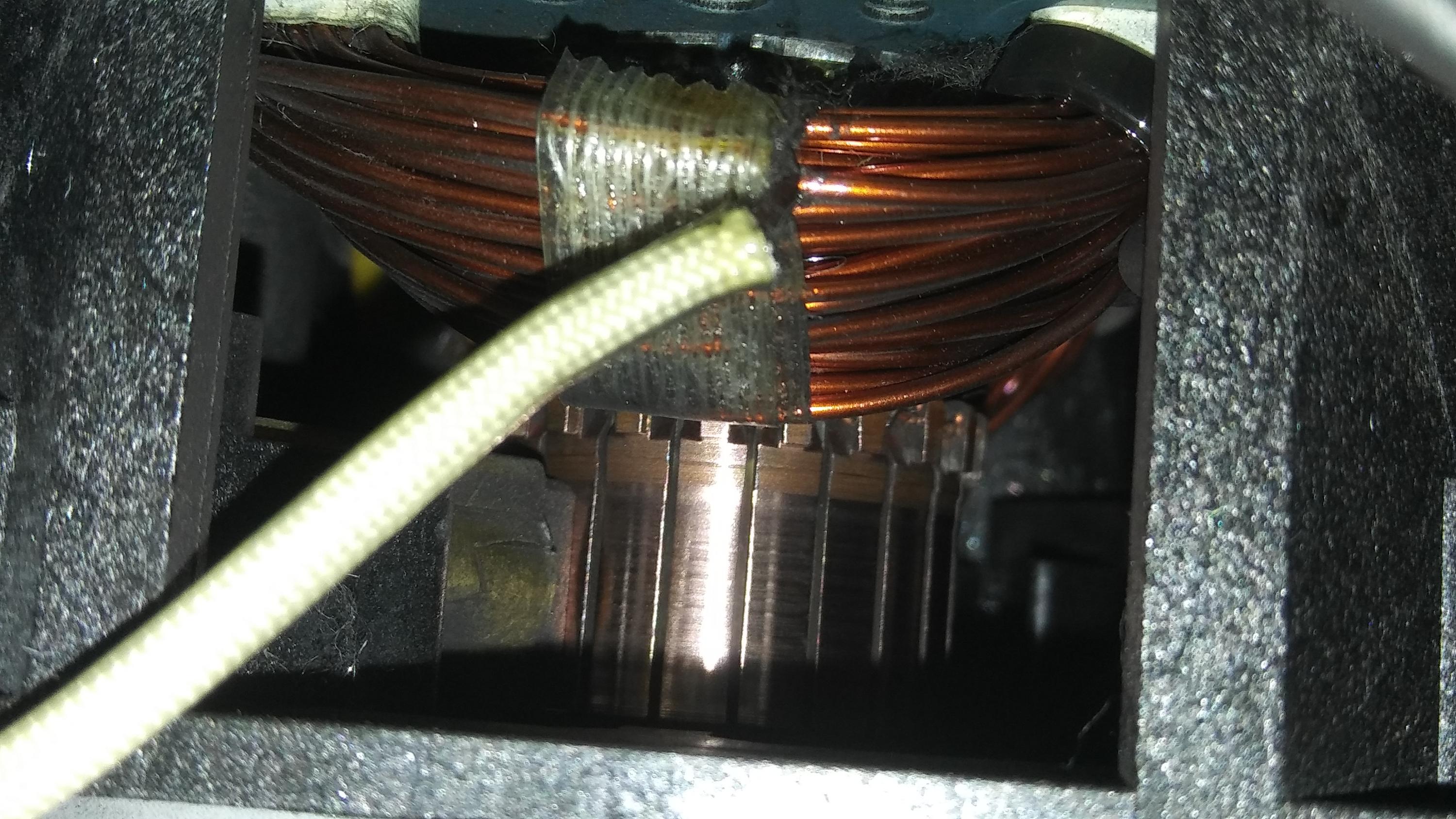

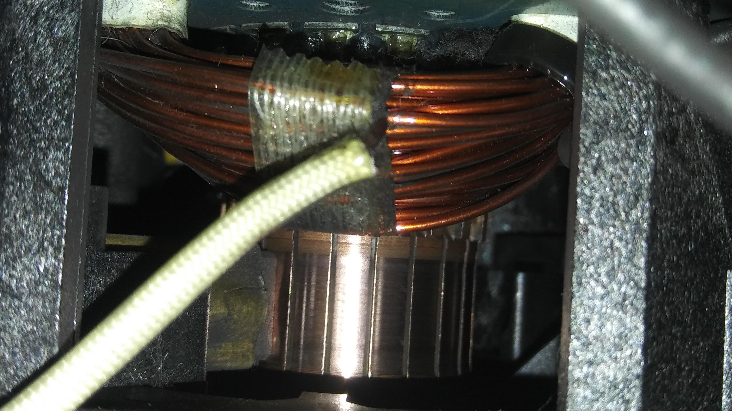

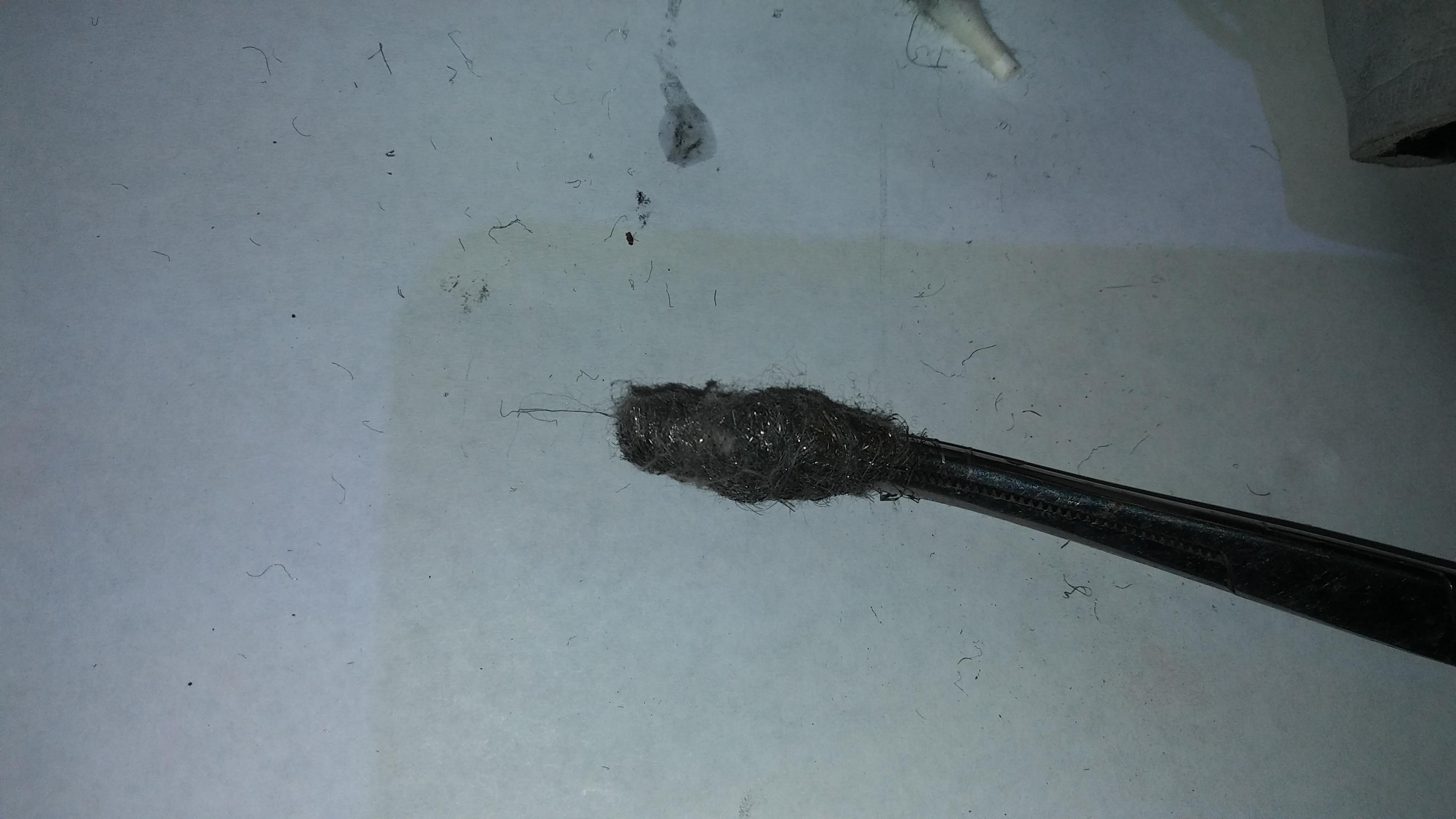

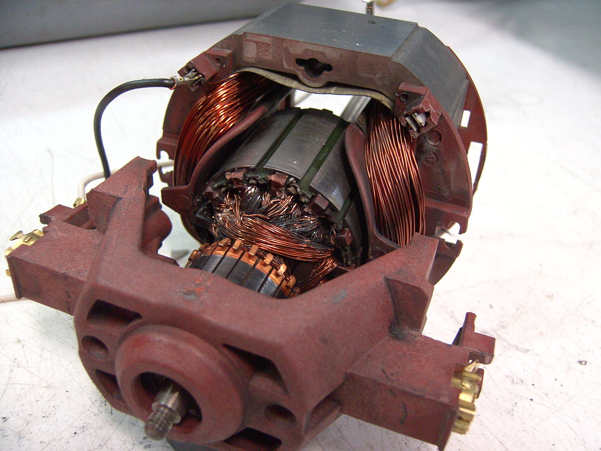

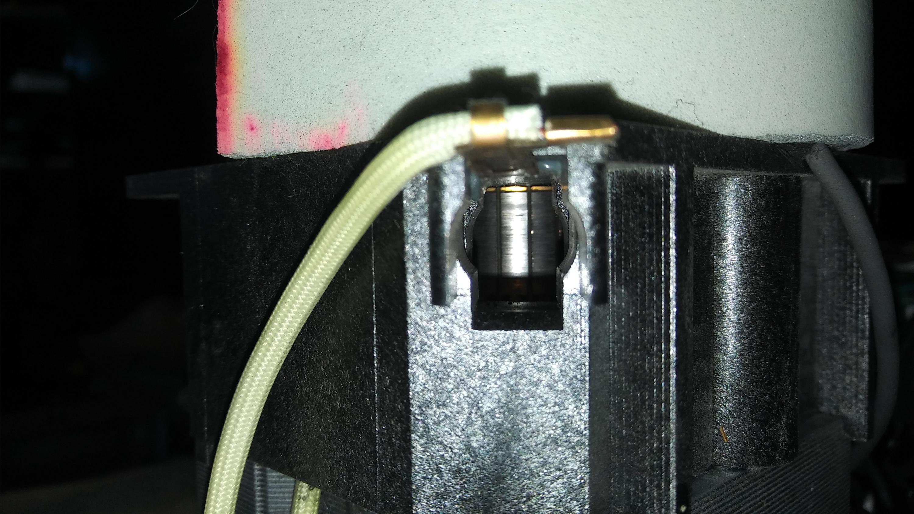

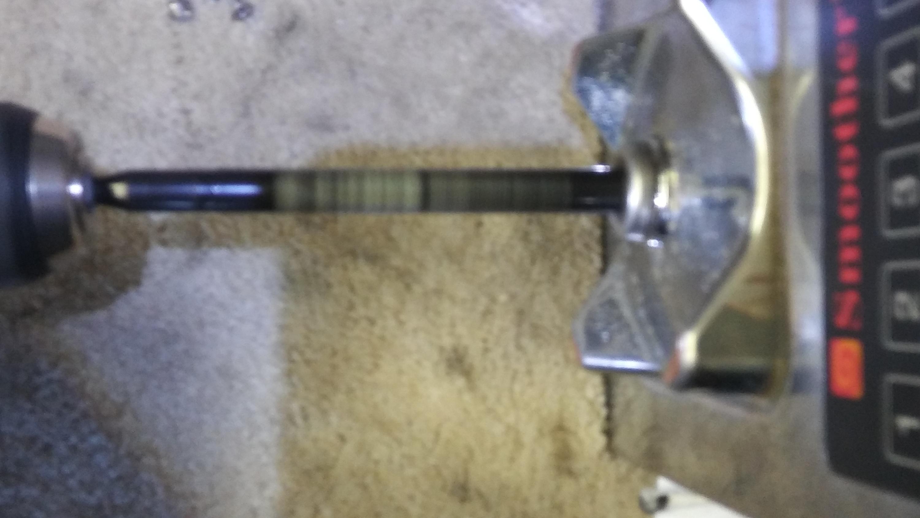

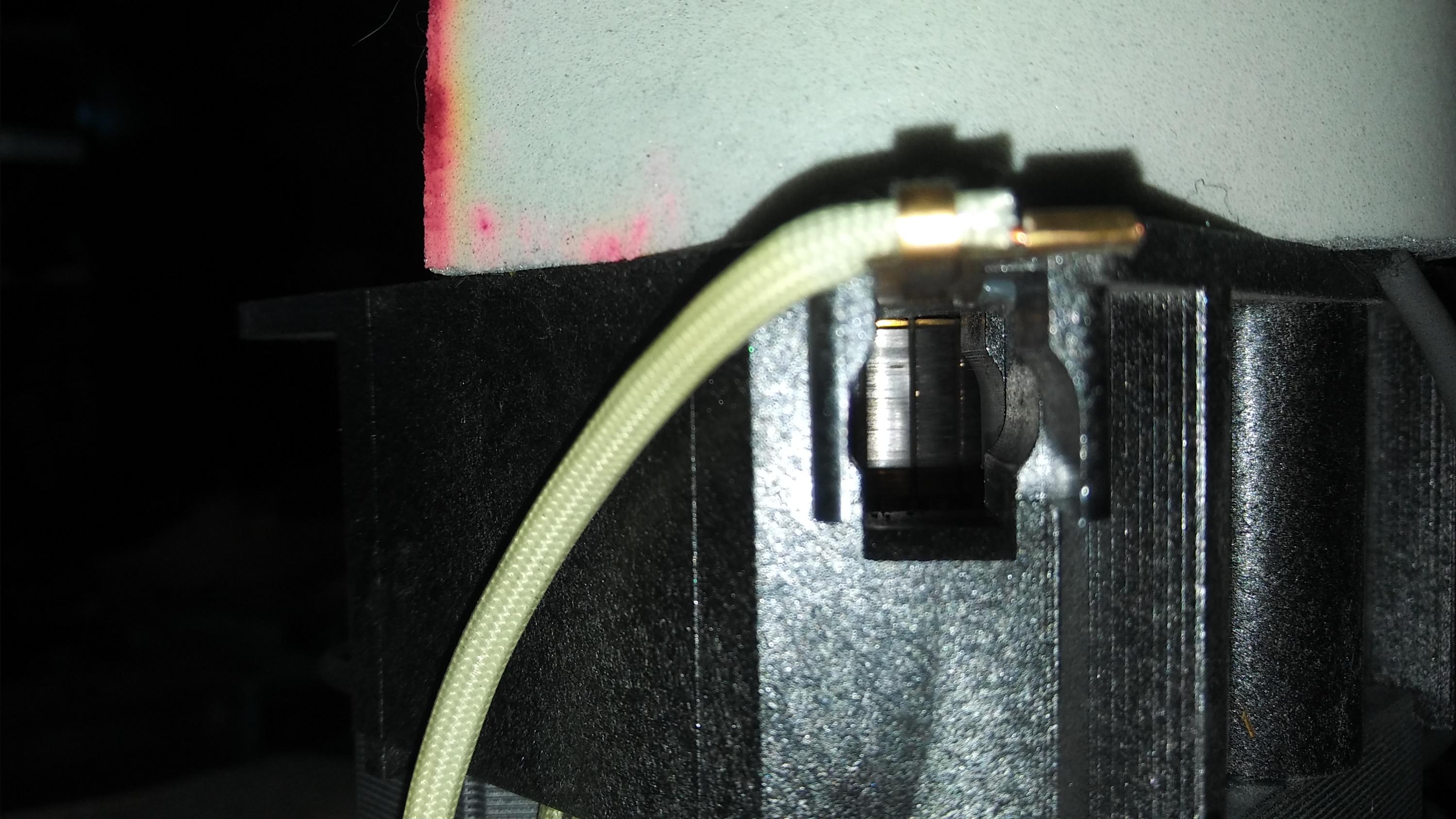

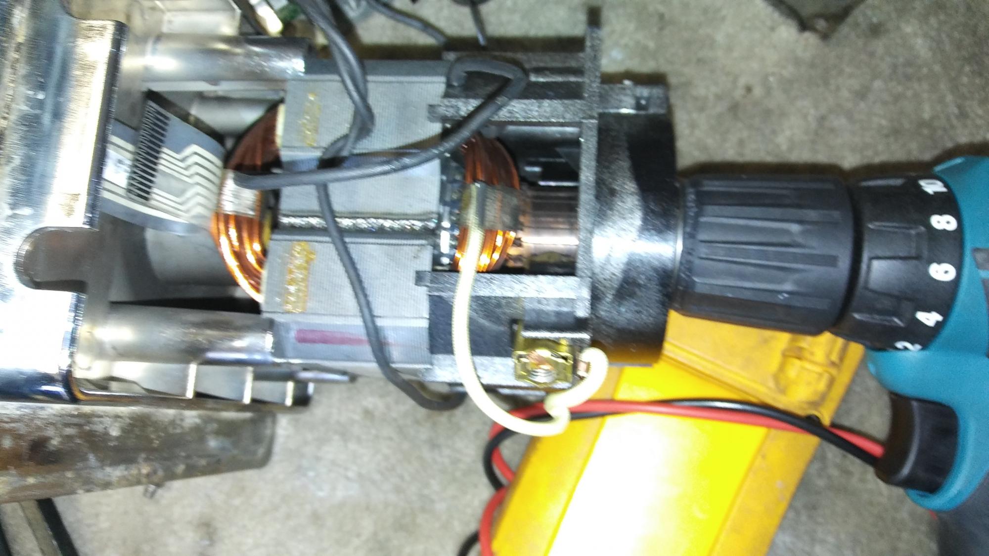

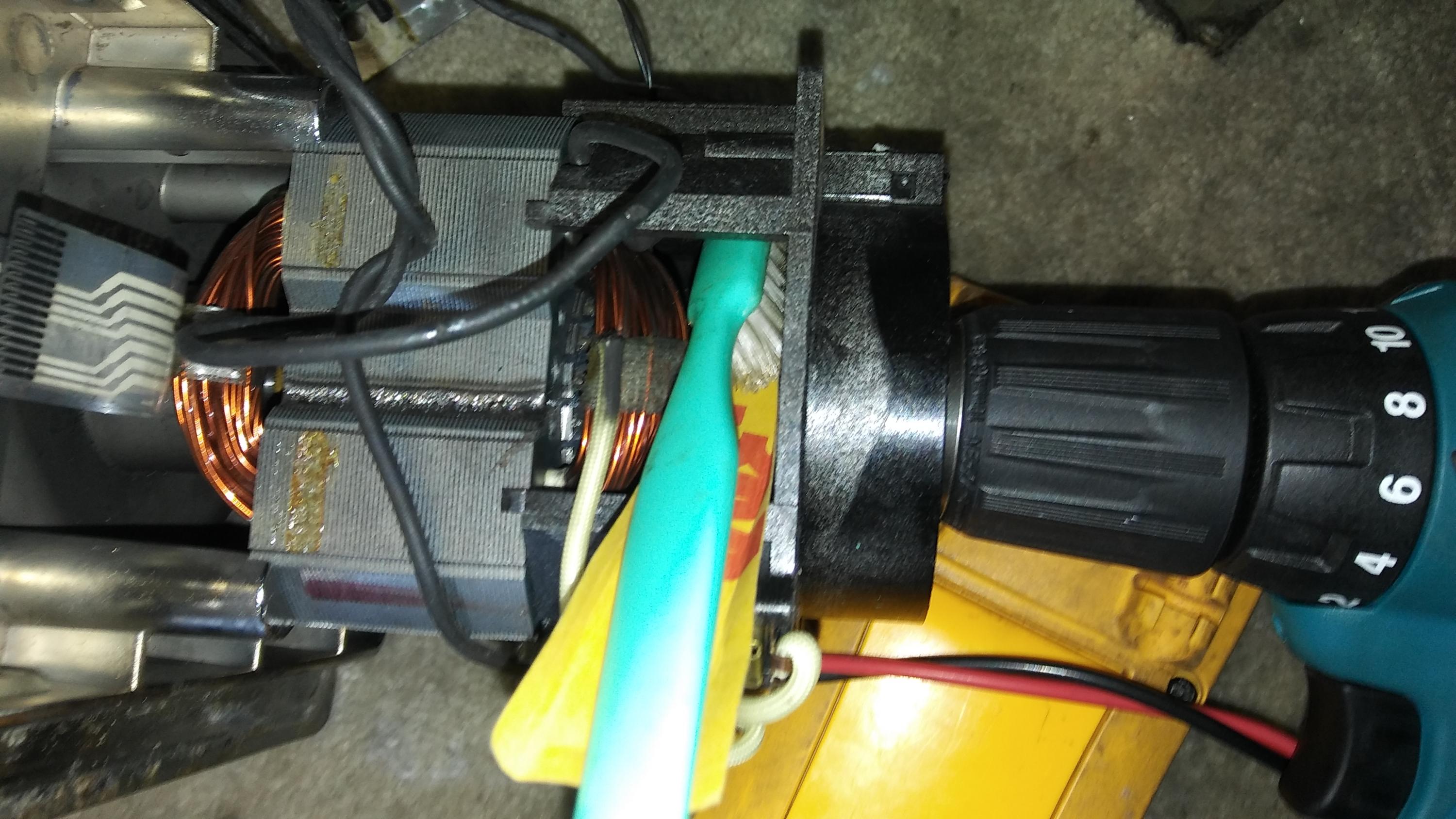

      The blender has an electric brushed motor, 316472-01, commutator needs to be clean, that's it, the rotor spinning at 28,000 rpm is kind of important.
      Pic8 : I connect pen and drill together to spin the rotor, steelwood and cotton swab, for cleaning.
      PS: one question is what kinda coating I need to put on commutator(WD40)?

          • capwizard
            • Jun 2016
            • 1991

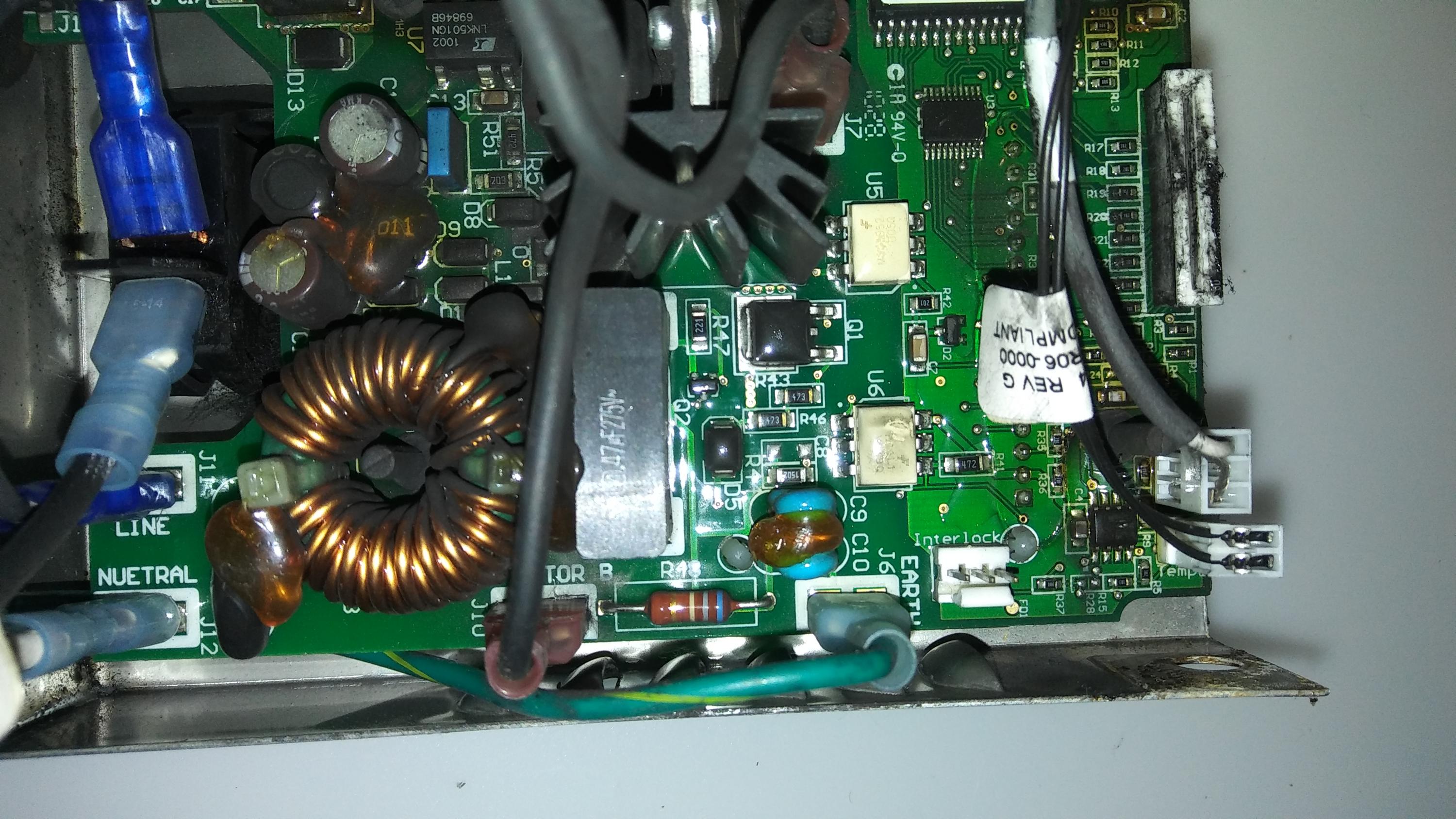

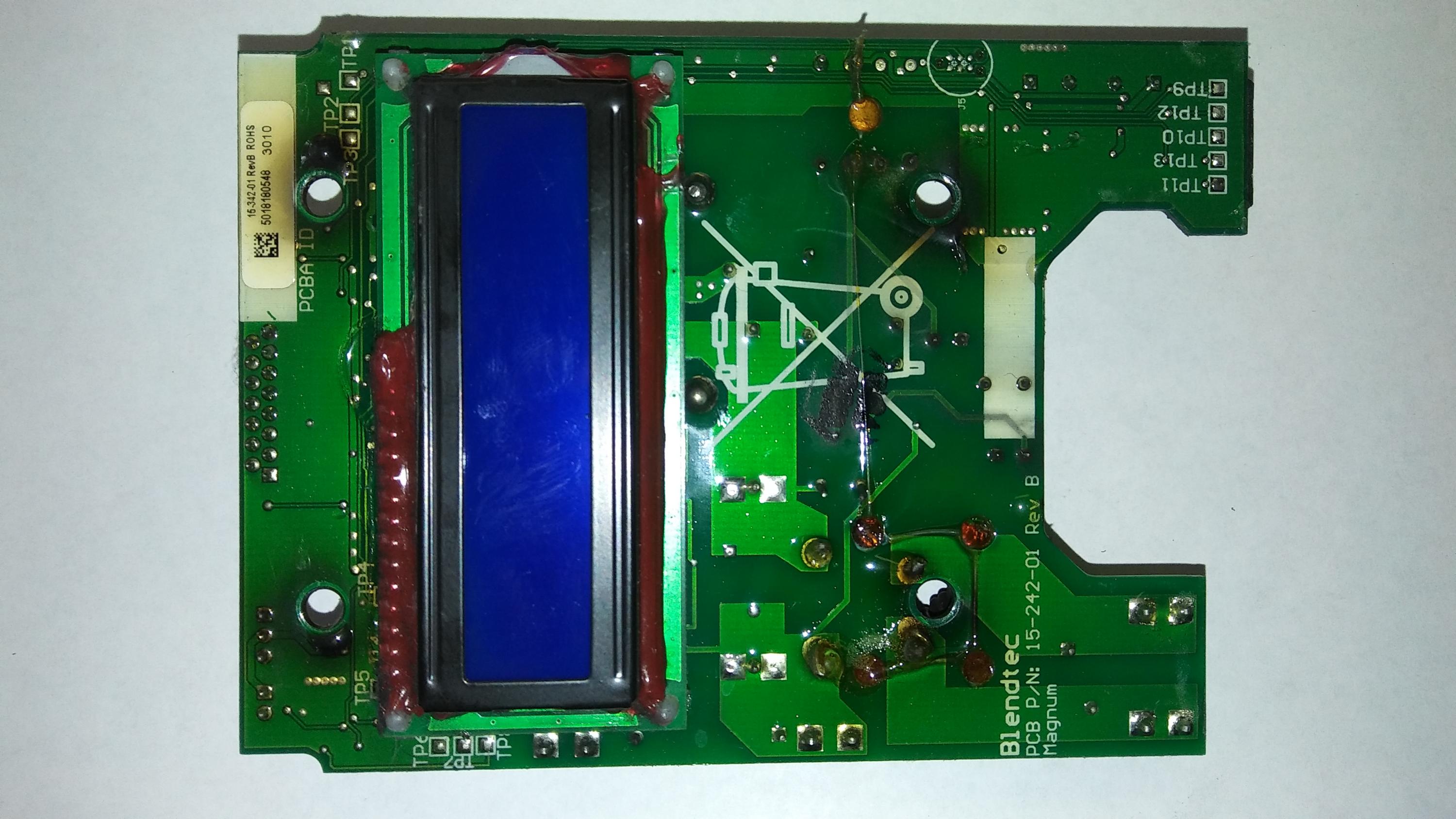

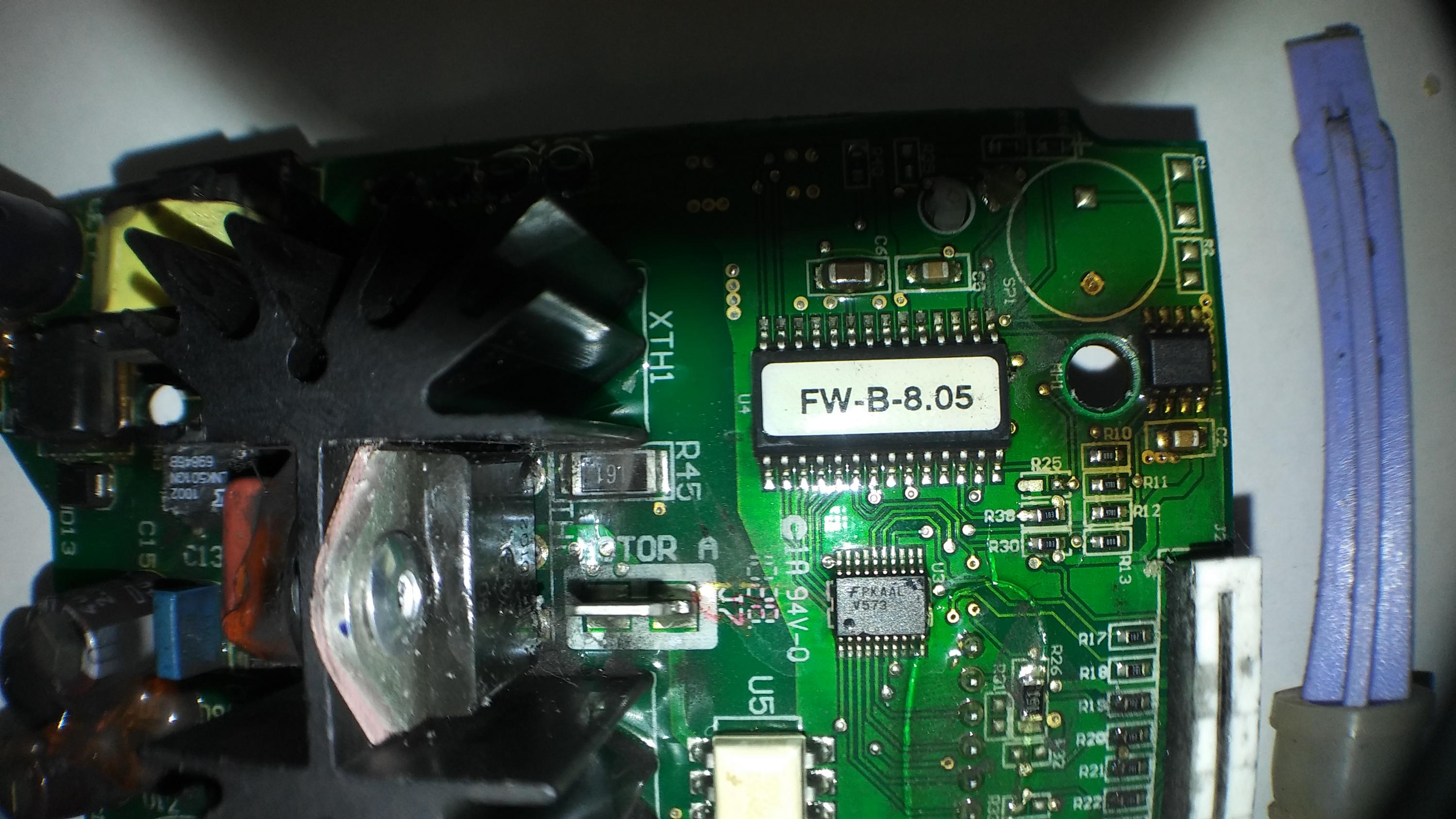

            After I clean the commutator, It worked, the story finished? No this is just A begin.
            This is A good example. How to use microcontroller to improve the performance of your project.
            Your Blendtec Blender features the most advanced microprocessor
            available. Nine (9) blending speeds and thirty (30) pre-programmed
            blend cycles
            are stored within its memory. With the touch of a few
            buttons, you determine your blender cycle configuration. Experiment
            with your recipes and the programs to determine which cycles are best
            suited for you.
            • capwizard
              • Jun 2016
              • 1991

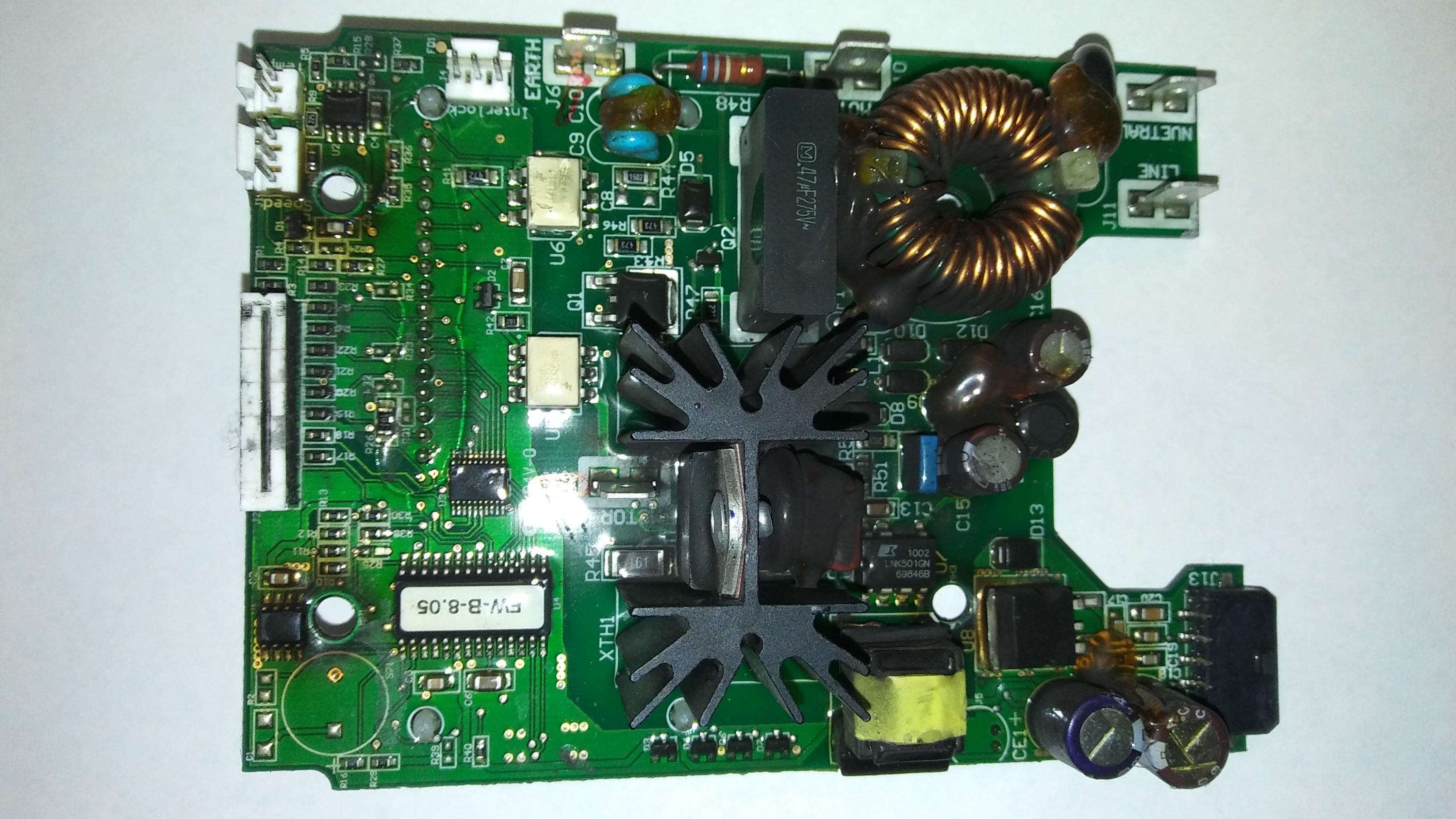

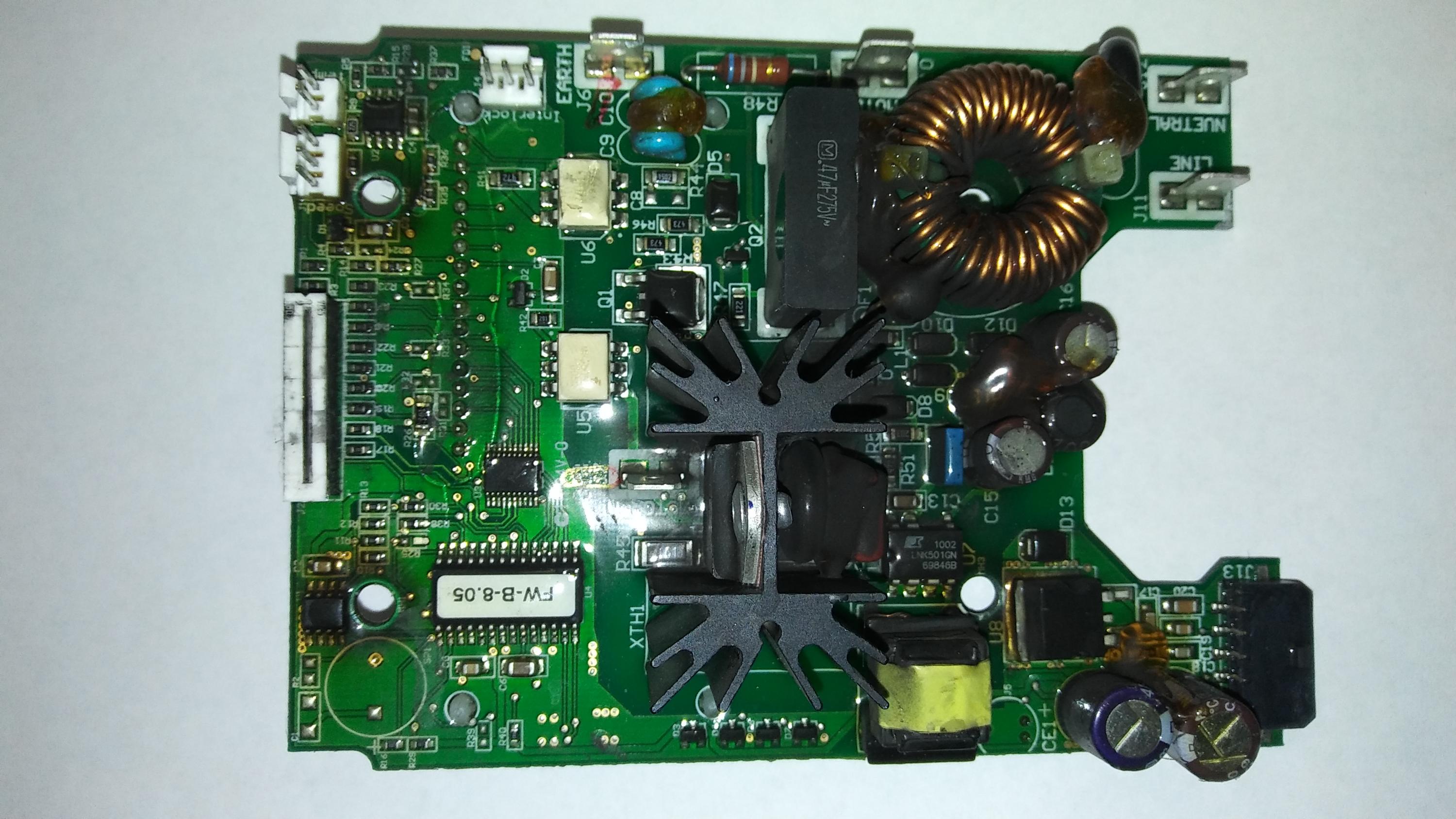

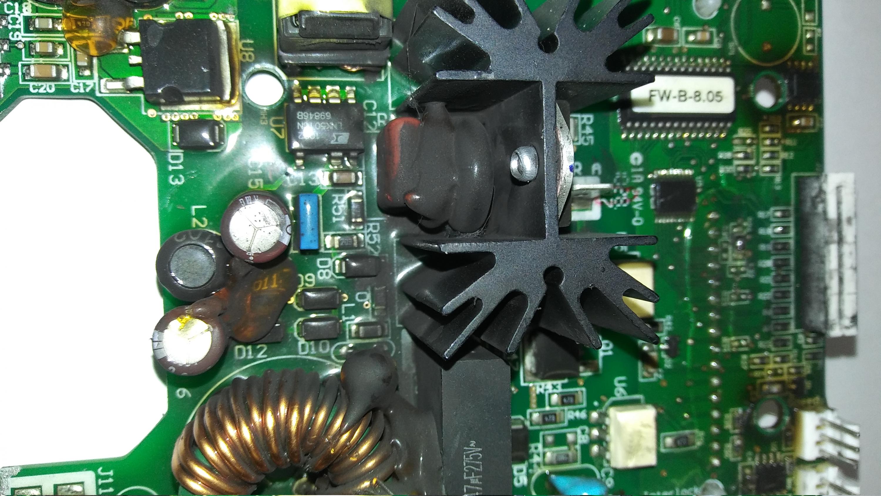

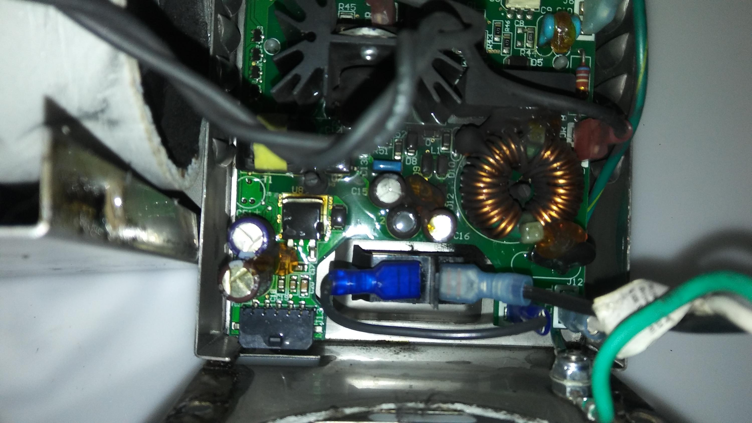

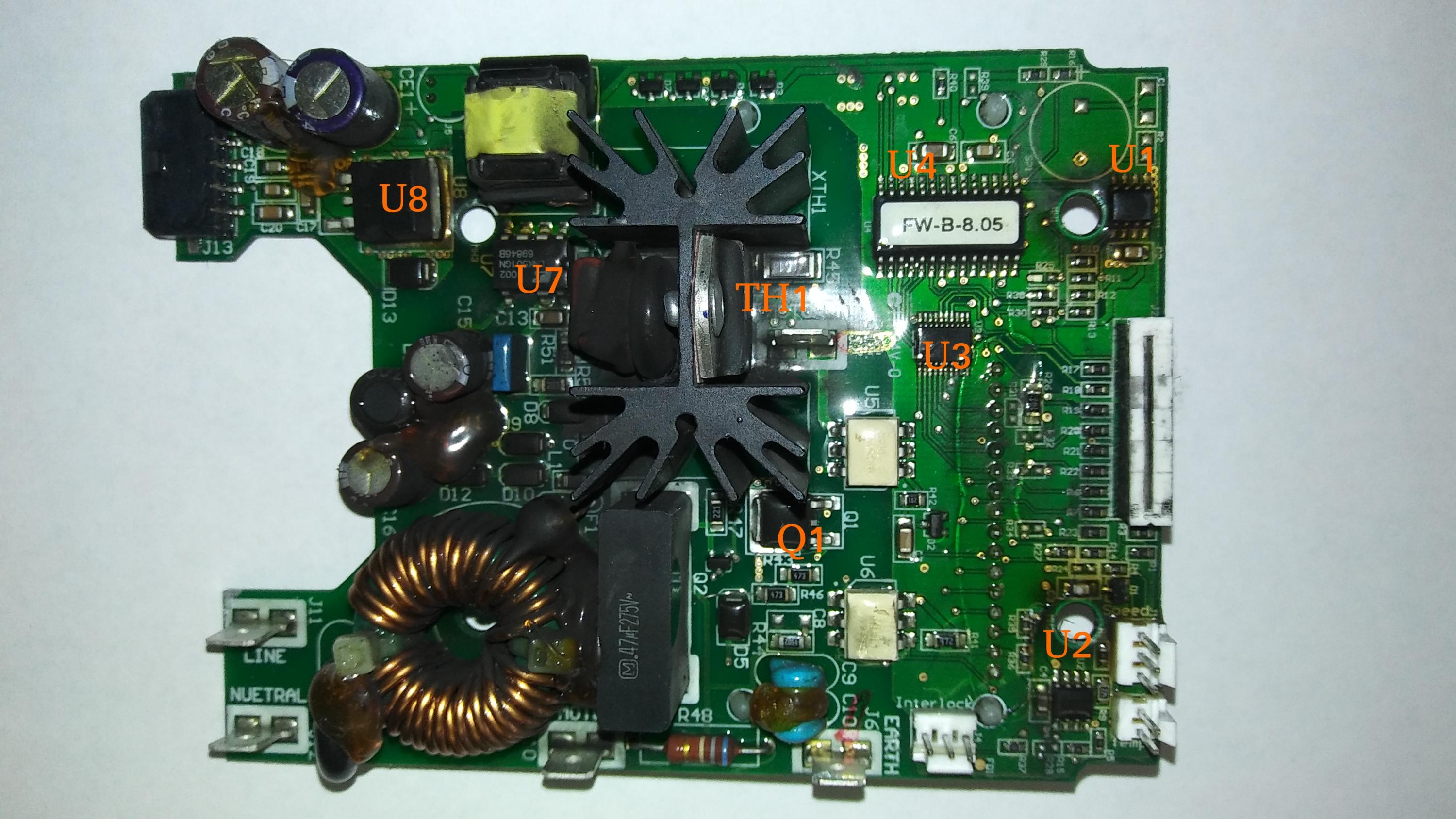

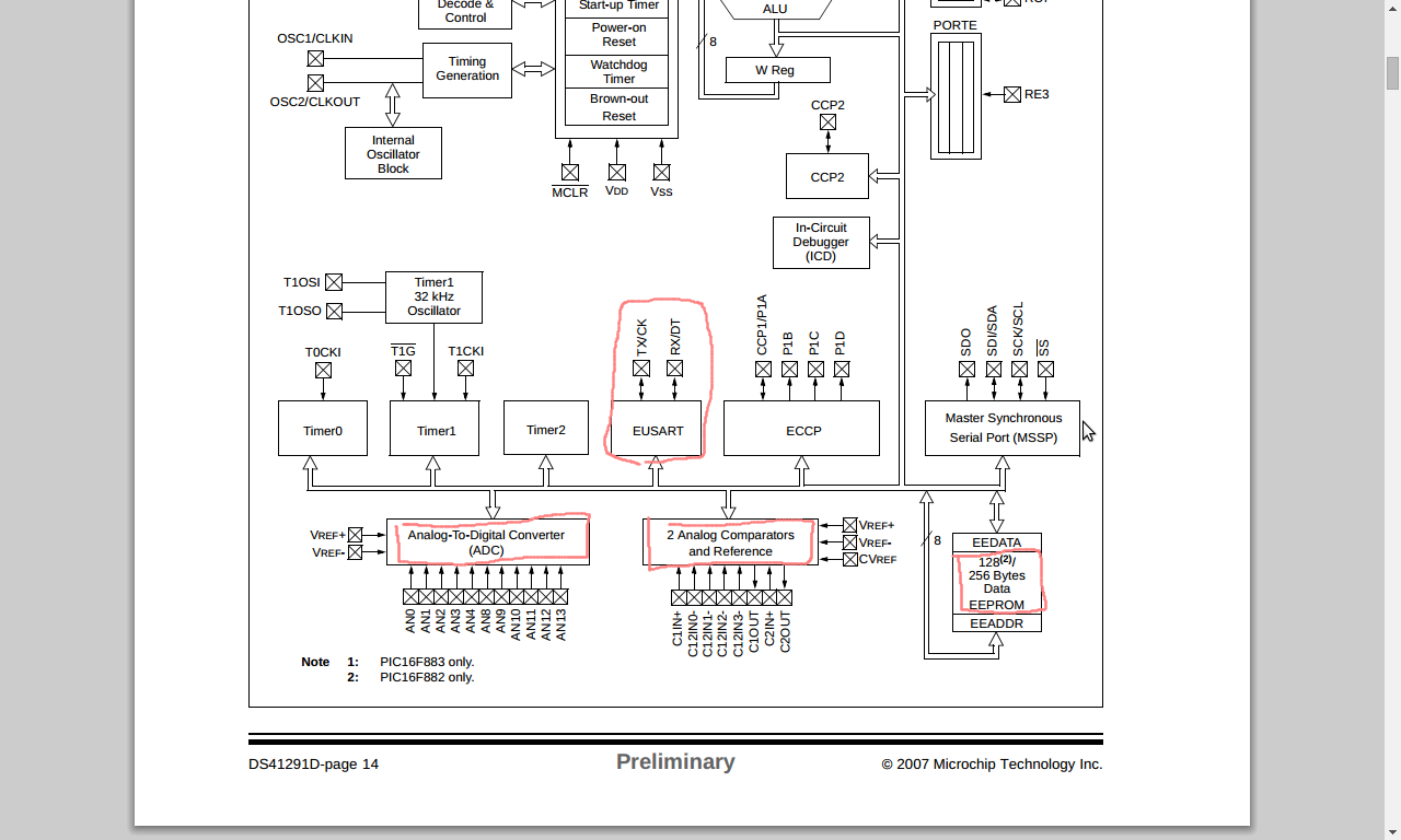

              More...More...More.

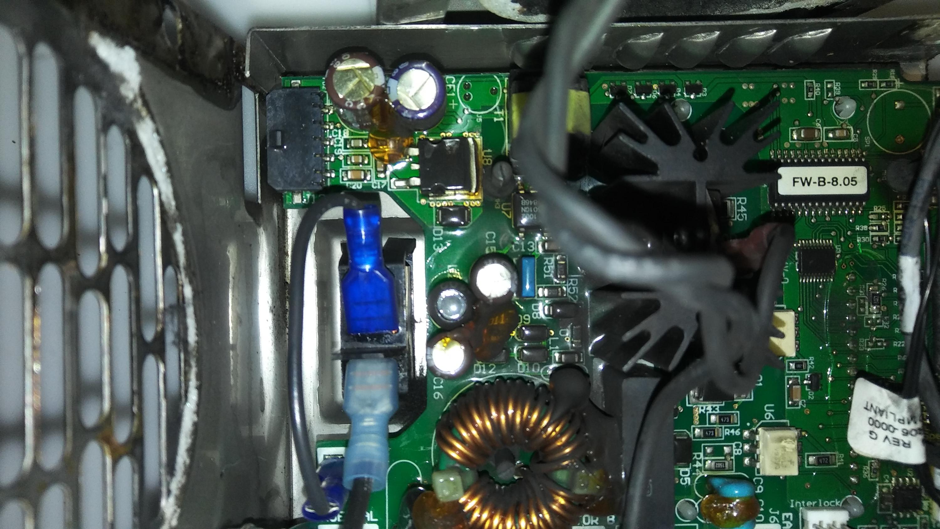

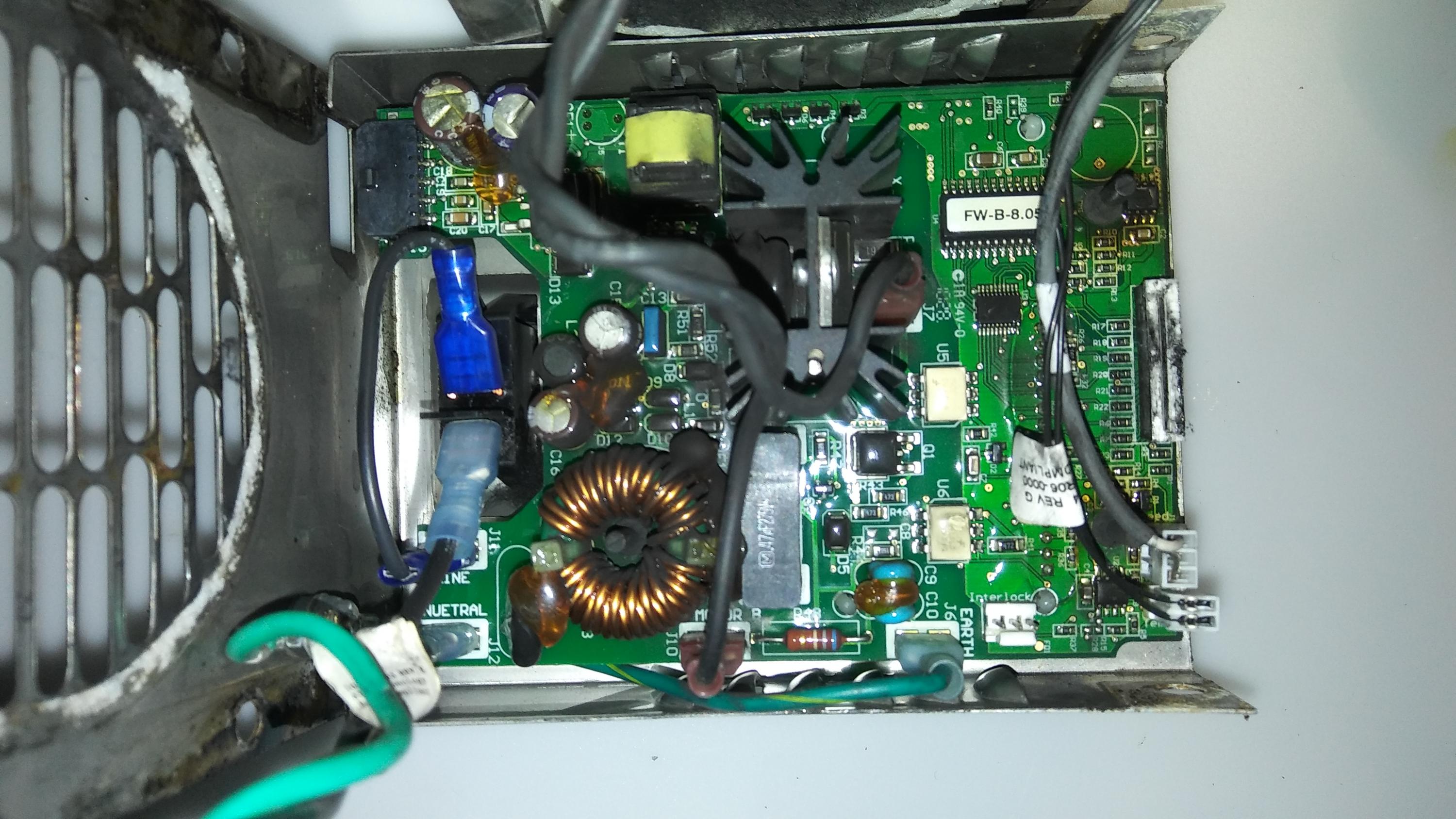

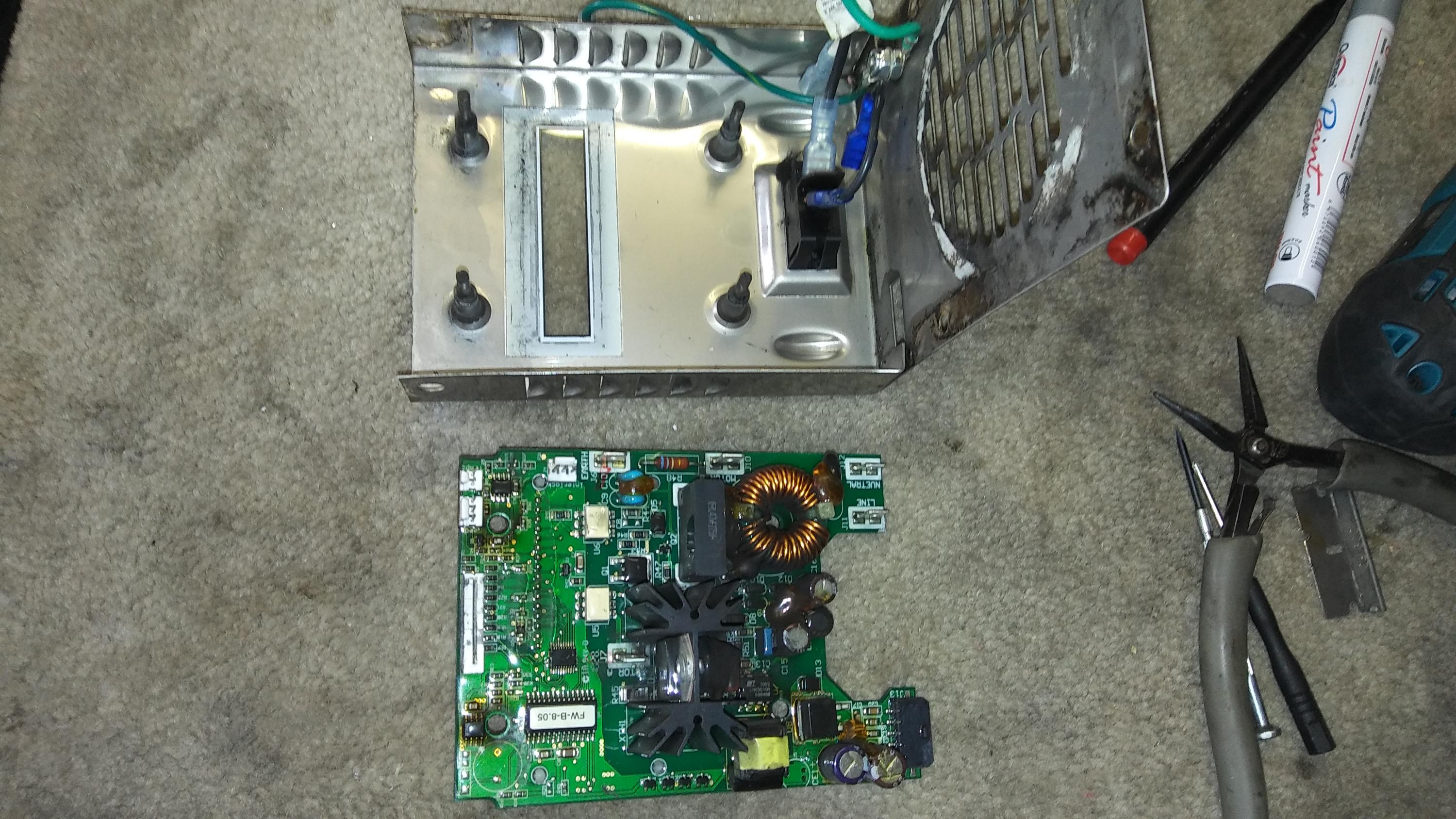

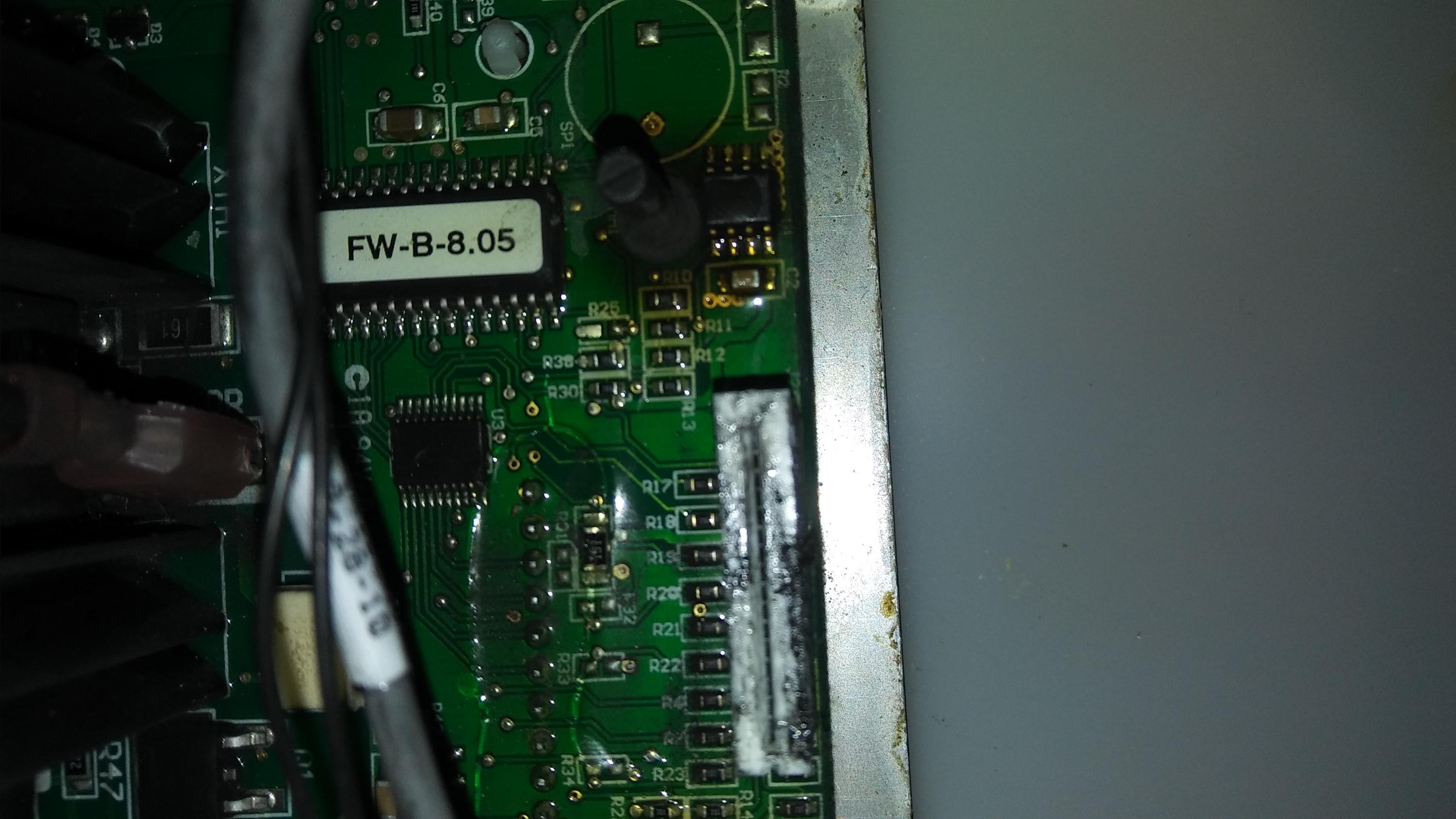

              U4: Microcontroller: PIC16F886: Enhanced Flash-Based 8-Bit CMOS Microcontrollers with nanoWatt. Technology.
              https://cdn.badcaps-static.com/pdfs/...4ca5c921bc.pdf
              Only 35 instructions to learn: All single-cycle instructions except branches.
              • In-Circuit Serial Programming (ICSPTM) via two pins
              • Master Synchronous Serial Port (MSSP) module supporting 3-wire SPI (all 4 modes) and I2C Master and Slave Modes with I2C address mask.

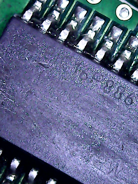

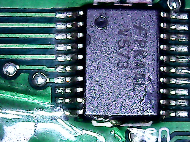

              U3: Fairchild - 74V573 - IC, TTL. SMD, Only marked V573.
              PS: Can someone helps me get it? I don't like to fill up the informations! My guess is for display?
              http://www.hkinventory.com/public/Pu...=2010&Qty=2500

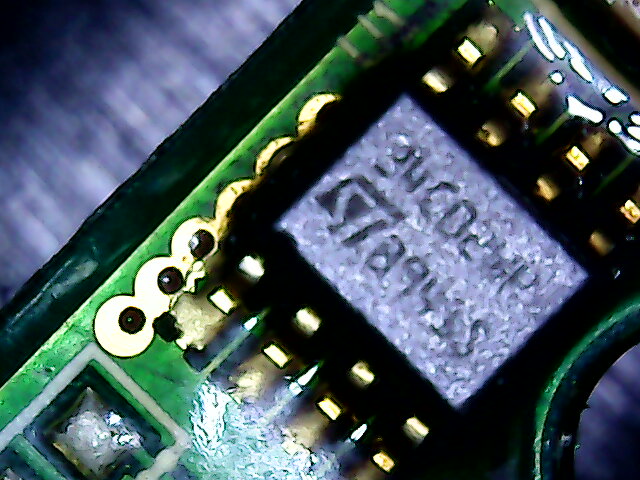

              U1: 24C02 EEPROM; Customers input informations, It's changeable.

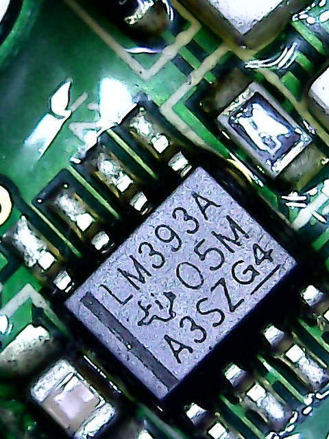

              U2: LM393A OP Amp
              U7: lnk501gn Energy Efficient, CV/CC Switcher for Very Low Cost Chargers and Adapters
              https://cdn.badcaps-static.com/pdfs/...2285a8510e.pdf

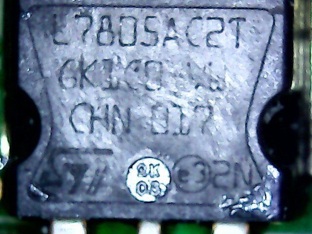

              U8: L7805
              Q1: 2SC5502

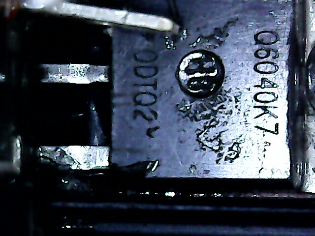

              TH1: Q6040K7TP-ND: Thyristors - TRIACs,TRIAC Alternistor, Snubberless 600V 40A Through Hole TO-218 Isolated Tab
              https://cdn.badcaps-static.com/pdfs/...080fc5136d.pdf
              • capwizard
                • Jun 2016
                • 1991

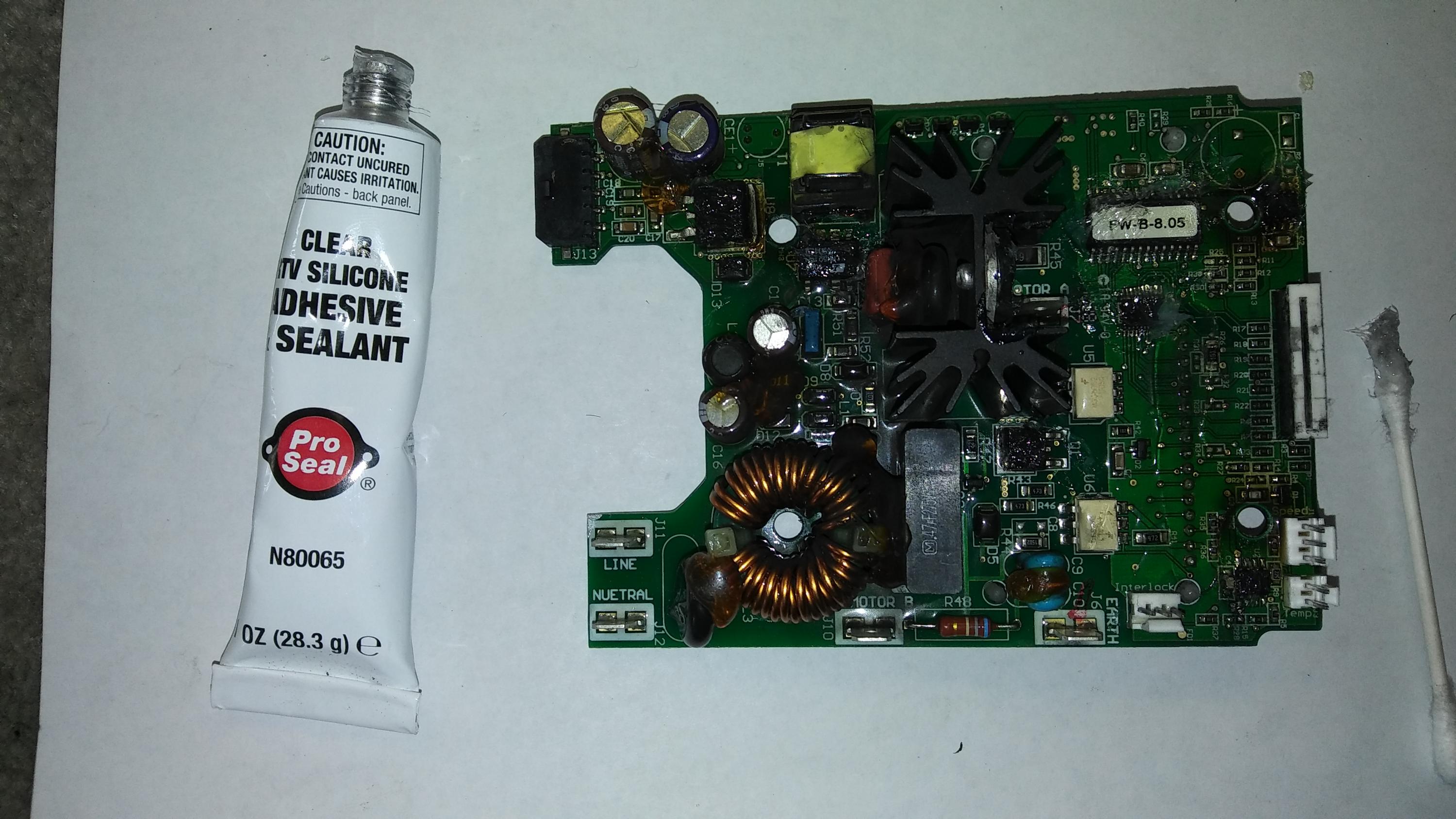

                Oh my God! Customer gonna pick up in an hour.
                I siliconed it for waterproof. He would be very happy this free Starbuck Blendtec Smoother is fixed. I will mention about this science project to him.................
                PS: Yes, it works like a Champ.

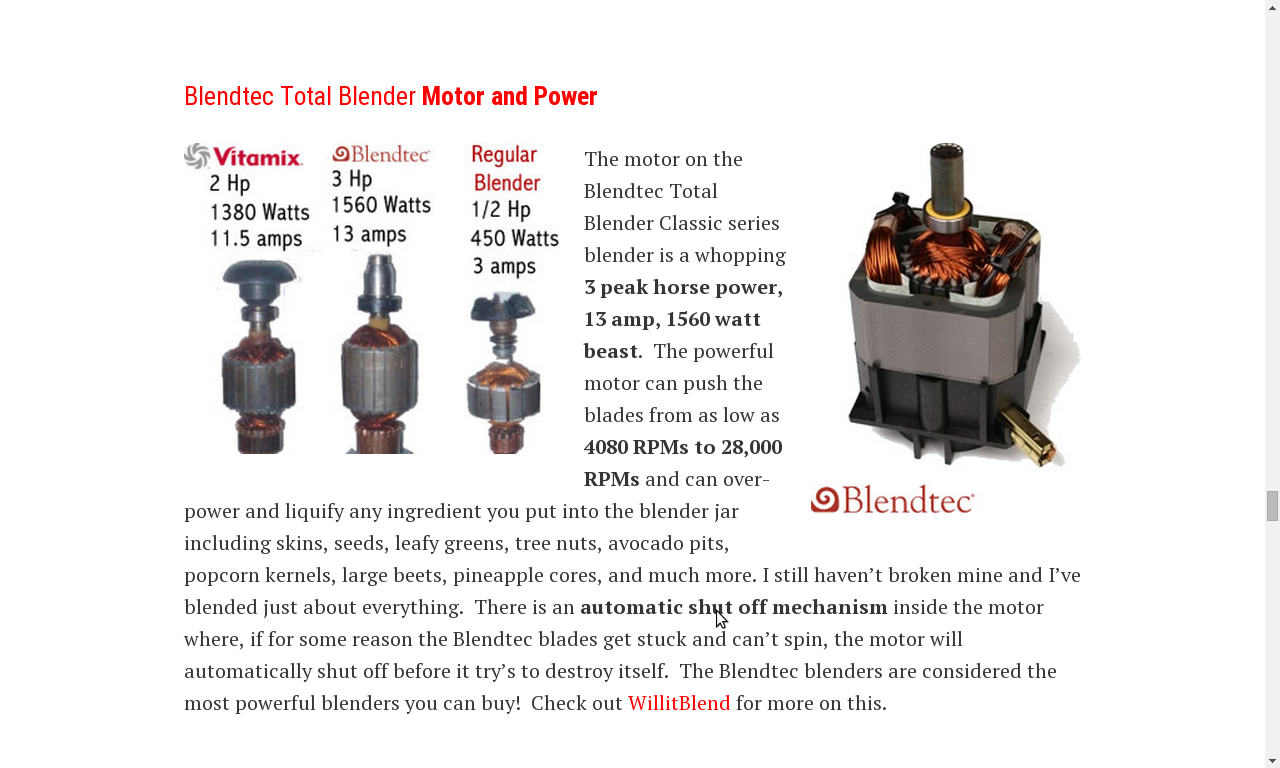

                  Blendtec Smoother 13 uses Universal Motor.
                  A type of electric motor that can operate on AC or DC power. It is a commutated series-wound motor where the stator's field coils are connected in series with the rotor windings through a commutator. It is often referred to as an AC series motor.
                  The universal motor is very similar to a DC series motor in construction, but is modified slightly to allow the motor to operate properly on AC power. This type of electric motor can operate well on AC because the current in both the field coils and the armature (and the resultant magnetic fields) will alternate (reverse polarity) synchronously with the supply. Hence the resulting mechanical force will occur in a consistent direction of rotation, independent of the direction of applied voltage, but determined by the commutator and polarity of the field coils.
                  The motor on the Blendtec Total Blender Classic series blender is a whopping 3 peak horse power, 13 amp, 1560 watt beast. pic3: Voltage 120v current:13A P: 1560 watts (Motor resistance = 8.4 Ohm). The powerful motor can push the blades from as low as 4080 RPMs to 28,000 RPMs and can over-power and liquify any ingredient you put into the blender jar including skins, seeds, leafy greens, tree nuts, avocado pits, popcorn kernels, large beets, pineapple cores, and much more. The Blendtec blenders are considered the most powerful blenders you can buy! From http://thedailyvitamin.com/blendtec-total-blender/
                  Universal motors have high starting torque, can run at high speed, and are lightweight and compact. They are commonly used in portable power tools and equipment, as well as many household appliances.
                  A universal motor's armature typically has far more coils and plates than a DC motor, and hence fewer windings per coil. This reduces the inductance.

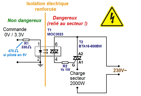

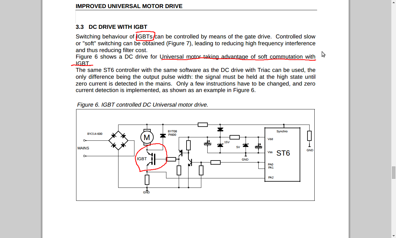

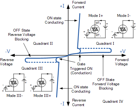

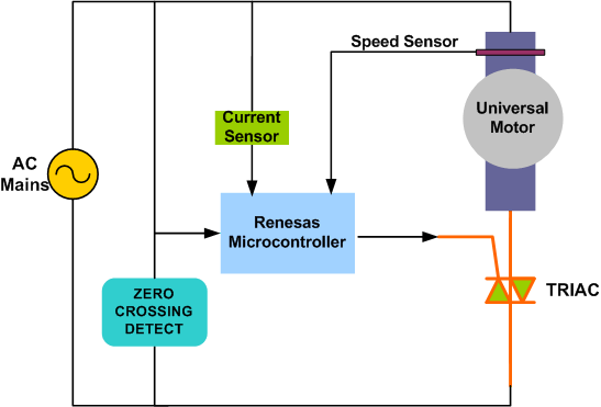

                    TH1: Q6040K7TP-ND: Thyristors - TRIACs,TRIAC Alternistor, 600V 40A TO-218
                    Phase Angle Control...........It is the simplest method to control the speed of a universal motor. Speed control is achieved by the varying the firing angle for the TRIAC. Phase angle control is very cost effective solution but not very efficient and prone to EMI.
                    The Phase Angle Control mechanism typically employed for speed control of the TRIAC. A phase shift of the TRIAC gate's pulses allows the effective voltage, seen by the motor to be varied and hence the speed of the motor. A Zero Crossing Detection circuit is used to establish a timing reference for delaying the firing of the gate pulses.
                    the commutator has brushes that wear, so they are much less often used for equipment that is in continuous use. In addition, partly because of the commutator, universal motors are typically very noisy, both acoustically and electromagnetically.
                    PS: The IGBTs will replace TRIACs in the future. Next Topic will be, How Microcontroller does with Blendtec Smoother 13.

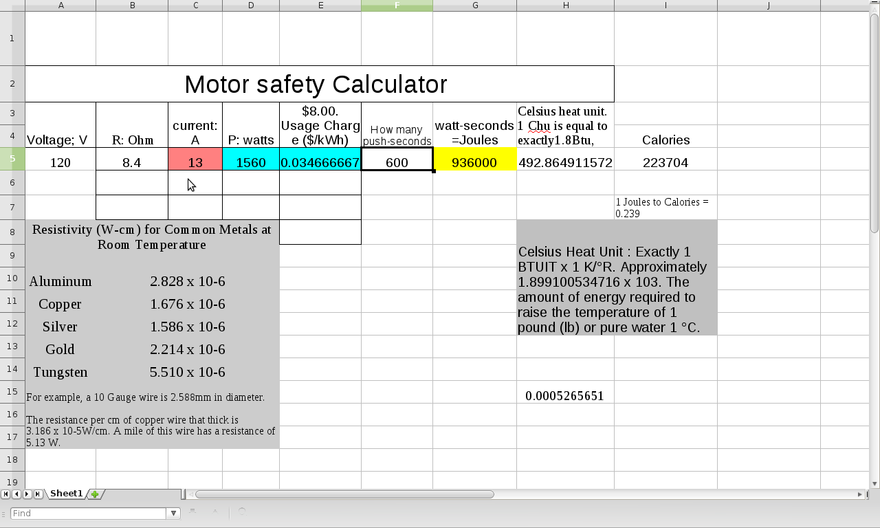

                    PS: Voltage 120v current:13A P: 1560 watts (Motor resistance = 9.23 Ohm).
                    Universal Motor Control Algorithms
                    https://www.renesas.com/en-eu/soluti...universal.html
                    Improved Universal Motor Drive
                    https://cdn.badcaps-static.com/pdfs/...d283a6124a.pdf

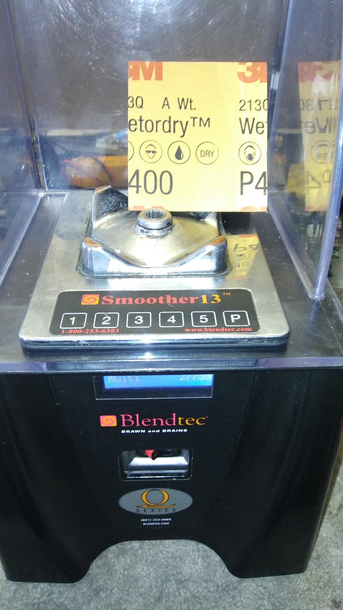

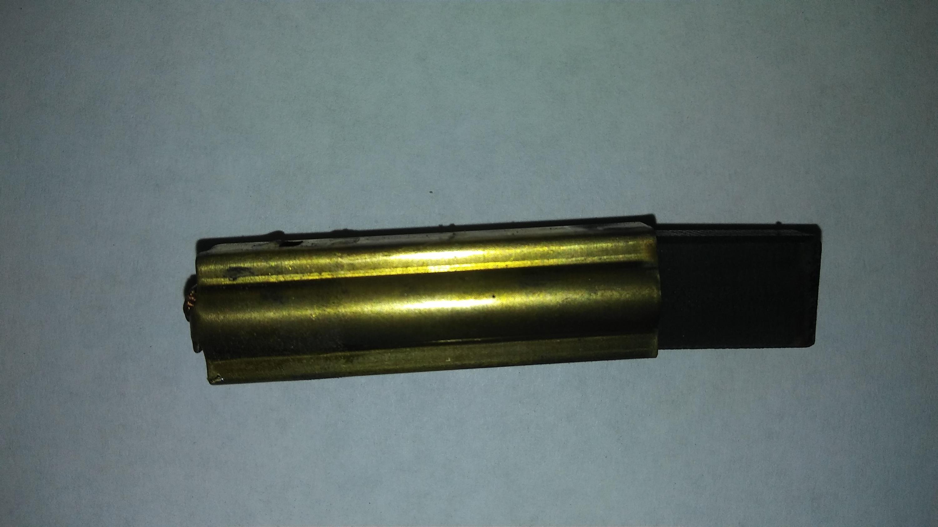

                      I have A redo. Customer complains Blendtec has too many sparks. I need to clean the commutator. I used 3M 400 grit sandpaper to clean it. ... ............................
                      The right way to clean commutator
                      Reconditioning the starter motor commutator
                      https://www.youtube.com/watch?v=YYkhNhZW8ro
                      Vacuum cleaner motor commutator cleaning
                      https://www.youtube.com/watch?v=cmdpCmch9nE
                      Easy Power Tool Fix: Burnt Commutator
                      https://www.youtube.com/watch?v=MkBLwUG_AdU
                      DIY: How to Clean the Commutator of an Armature
                      https://www.youtube.com/watch?v=oB-h-vZc6FY
                      PS: I gave the customer A 3M 400 grit sandpaper, do it yourself next time!
                          Hi.
                          I have a Blendtec ICB3 smoother that still give these overload error.
                          changed the brushed and cleaned the commutator but still that error.
                          could it be the speed sensor that is broken?if so where to find this.

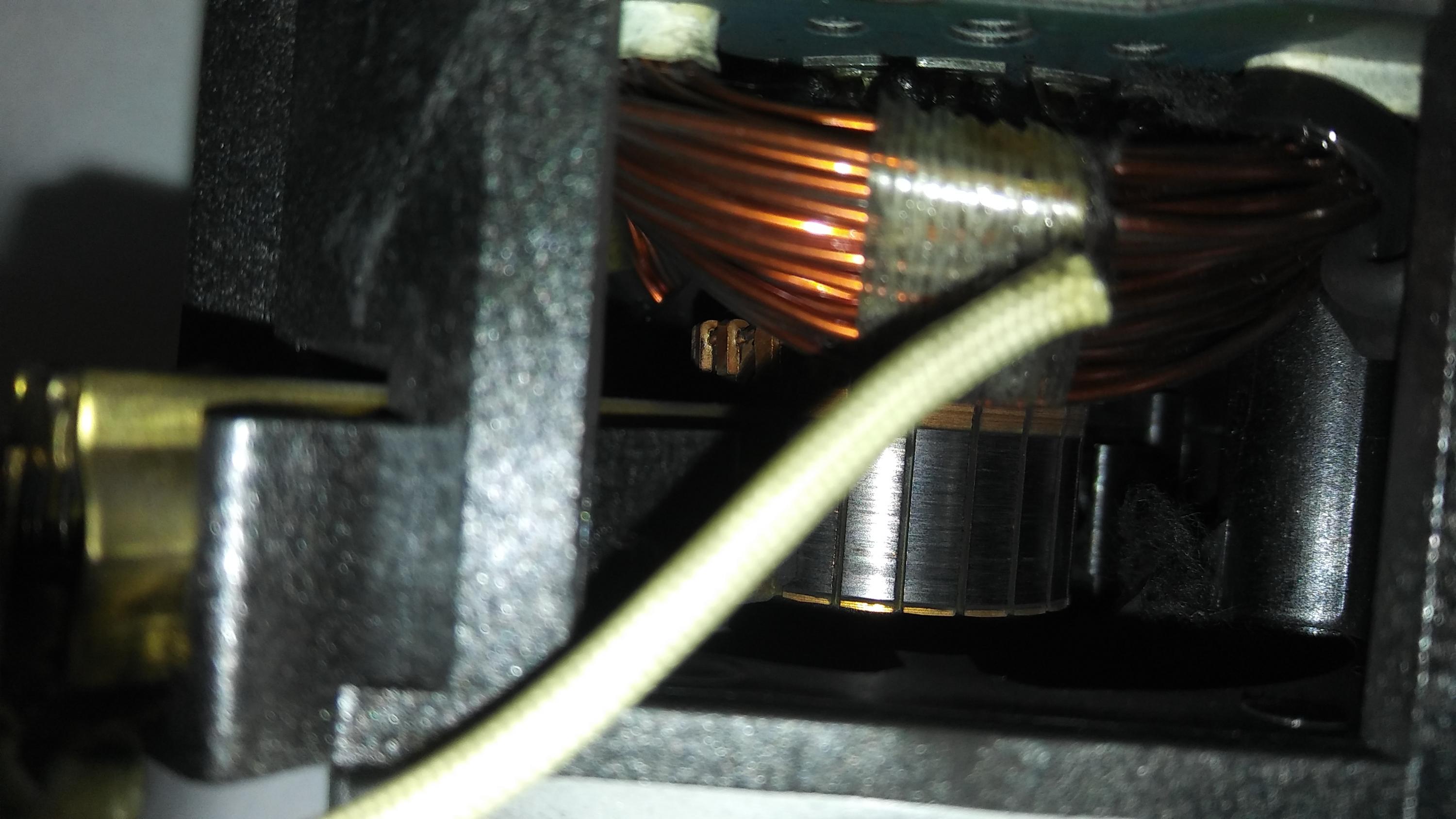

                            I've cleaned commutator by hand, Blendtec ICB3 still has a recall after 3M 400 grit sandpaper with hand-drill cleaned commutator up, no more problem. The point is that the surface should be very smooth and it will not produce a lot of sparks.
                              I did the same but still nothing,cleaned commutator by hand with sandpaper P400,the carbon brush still produce a lot of sparking.
                              i think the rotor is shorted out.replacement?
                              • capwizard
                                • Jun 2016
                                • 1991
                                look at the picture, I connected center axis of the juicer to a hand drill then I pressed it down sandpaper with a toothbrush. You must do this to completely clean the commutator, because hand clean it will leave Scratch marks,
                                  When you clean the commutator the way you do, all the brass debre ends up shorting the commutator, you need to clean between the brass sections.
                                  I use a fiberglass burnisher.

                                    • Alain2003
                                      • Feb 2019
                                      • 4
                                      • Belgium
                                      After i Disassembled twice used new carbon brushed and used your methode,its now fully working again.
                                      thanks for the help.
