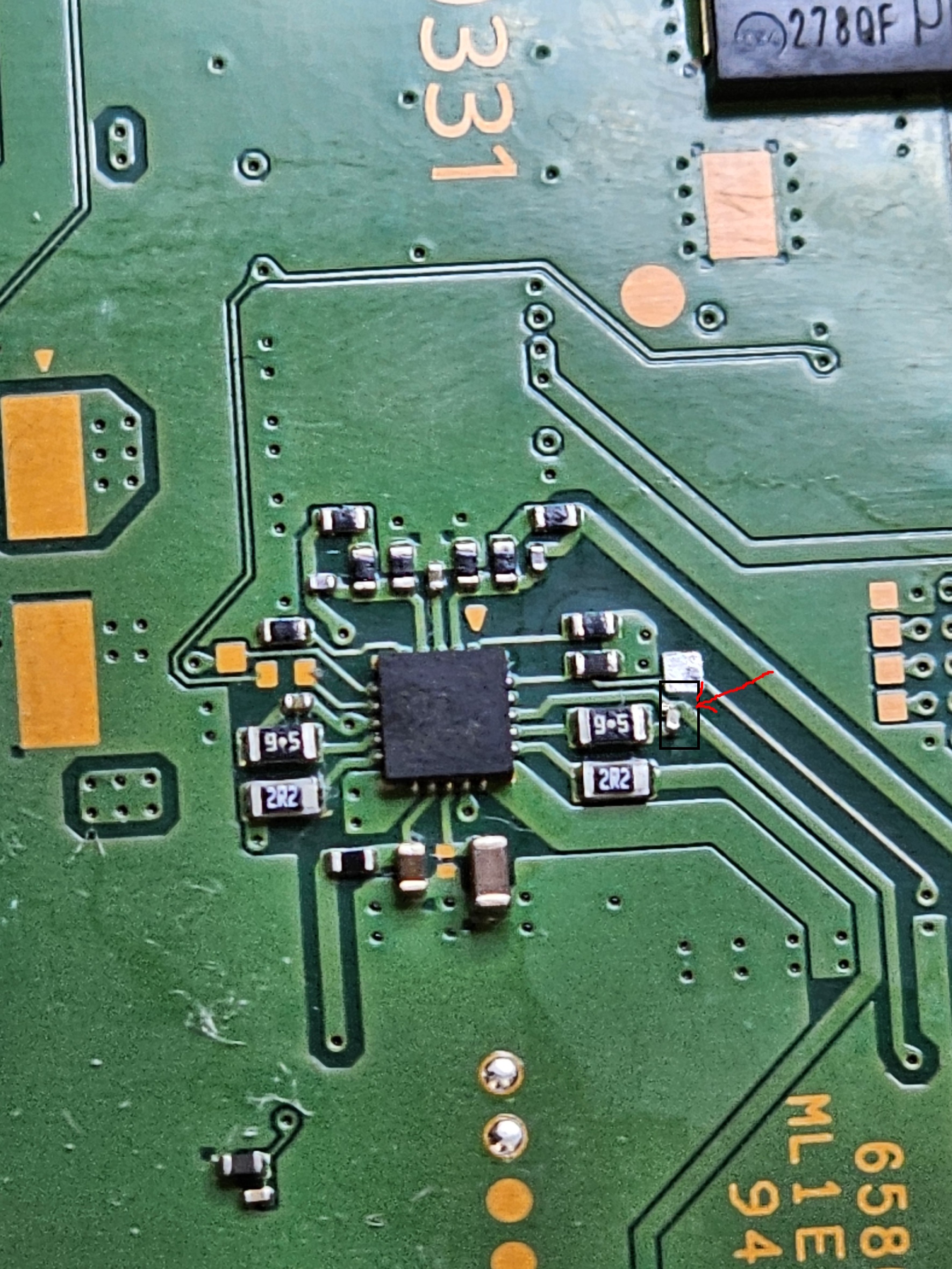

    PS5 EDM-033 capacitor value
    Have a PS5 with a cracked MLCC capacitor, motherboard model EDM-033. Anyone happen to know what the value of the capacitor marked with the red arrow is?
  • slinkygn
    • Dec 2013
    • 12
    In-circuit it reads as 290nF. Can't pull one off a board right now, unfortunately.
    I've got one for you as well -- same board, the cap between F5402 and the drive connector, any idea the value of that one? The similar cap by F5401 reads around 470uF in-circuit, which of course can't be right, but I don't want to start pulling arbitrary 0201s off this thing just yet.
