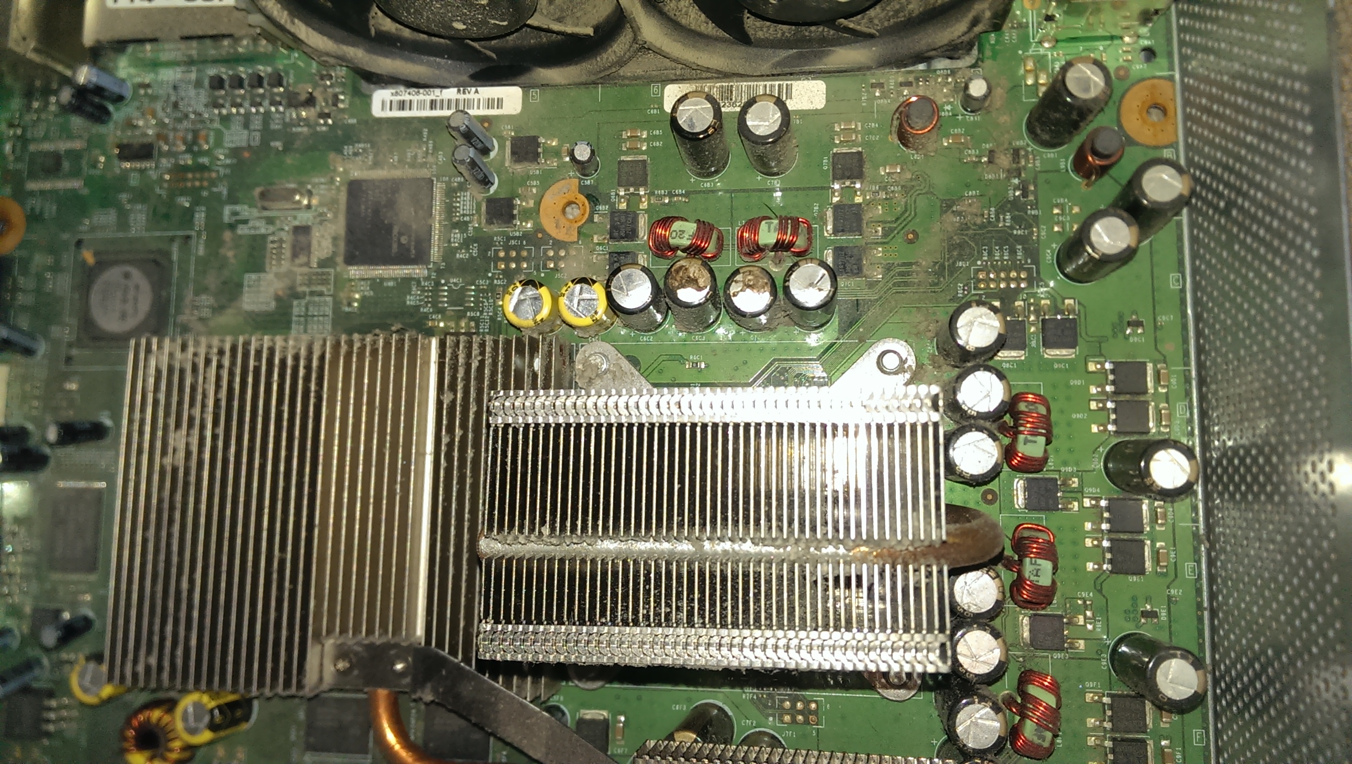

    Through some google searching, I ran upon this website thankfully. I have the dreaded rrod. I'm sure that's a surprise.

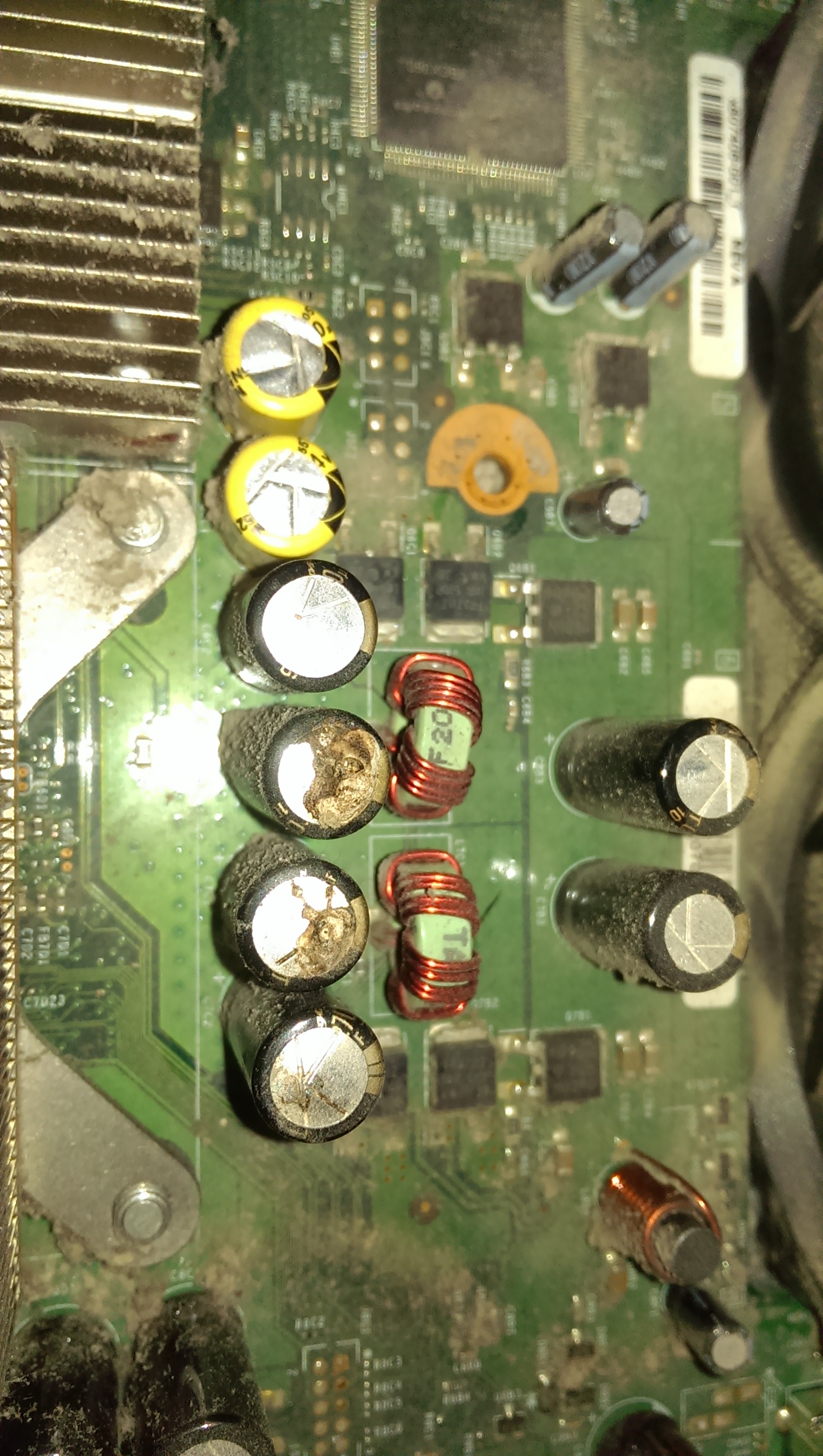

    Anyway, I took it apart thinking I'd just reflow the gpu/cpu and be done with it. But, I immediately saw some other problems. 4 obviously failed caps.
    From some browsing around here, people are saying that the nichicon HZ are suitable replacements for them(rubycon mfz 2700uF/6.3v). Referencing this thread: https://www.badcaps.net/forum/showthread.php?t=4931 OR, upgrade to a poly such as http://thecapking.com/plg0j182mdo1.html. Would the Nichicon LG cap work in this application?
    Also, all the other caps seem fine by looking at them. But, since I'm in there, I could replace some others, if they are prone to failing too.
    I do plan on cutting out the rear grill to improve airflow, and fabricating a small aluminum shroud to pull air through the gpu sink as well. I hope to not buy an xbox 1 anytime soon, so I'm hoping this one lasts. I can justify spending a few more bucks on poly caps if you guys think it's worth it.
    So I guess the main question is, can I use the Nichicon LG caps here, or should I stick with electollytic caps like the Nichicon HZ?
    Disclaimer: I know next to nothing about electronics so forgive me for any glaring errors. I have soldered a bit, and played around with pcs before, but that's about the extent of it.

    I think the biggest problem you will run into is finding a powerful enough iron to solder/desolder the caps on these boards. I'm not even sure if a regular iron would work here... maybe if the board is pre-heated to about 100C and if the iron is rated for at least 60W.
    All I know is, even the cheaper Hakko 936 clone temperature-controlled soldering stations will struggle to melt the solder on the caps of these boards.
    If you haven't replaced caps on a computer motherboard before, I would suggest you find a junk one to practice on first. The Xbox 360s are tough, though not impossible. Also grab some liquid or paste flux (but NOT plumber's flux! - that stuff is way too acidic and will eat away the copper traces).
    That aside, those Nichicon LG should be fine. However, you do have a much bigger choice here. Pretty much any polymer rated at 820uF or more and 4V or more should be okay. And yes, you can use Nichicon HZ as well. In fact, many Xbox 360s with 10mm diameter caps have 6.3V 2200uF Nichicon HZ on them.

        If it's a cap rated for 16V, you definitely DO NOT want to put one rated for 4V. However, for those 6.3V 2700uF Rubycon MFZs, you CAN use 4V caps. In fact, have a closer look at those yellow caps that are on the same row as the blown caps - those are Fujitsu FP caps rated at 4V and 820uF. These two, along with the row of blown Rubycon MFZ next to them are all for the GPU core voltage. IIRC, they don't really see more than 1.2 or 1.4V, if even that much. So theoretically, you could go as low as 2.5V polymers - though I wouldn't recommend you do as I haven't tried that experiment myself yet (and I have tried quite a few things with these boards).

            Anything that works, really. If I knew these Xboxes didn't have GPU and BGA problems, I'd spend the money on polymers and make it last a lifetime. But unfortunately MS did a crappy design on the cooling, so I'd say just go with these:
            https://www.badcaps.net/store/produc...roducts_id=137
            or these:
            https://www.badcaps.net/store/produc...roducts_id=149
            or these:
            https://www.badcaps.net/store/produc...roducts_id=142
            They will all work. Many Xboxes that don't use the 6.3V 2700uF Rubycon MFZ use the 6.3V 2200uF Nichicon HZs instead.
