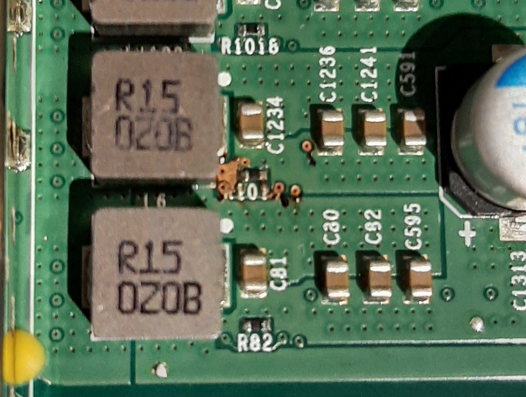

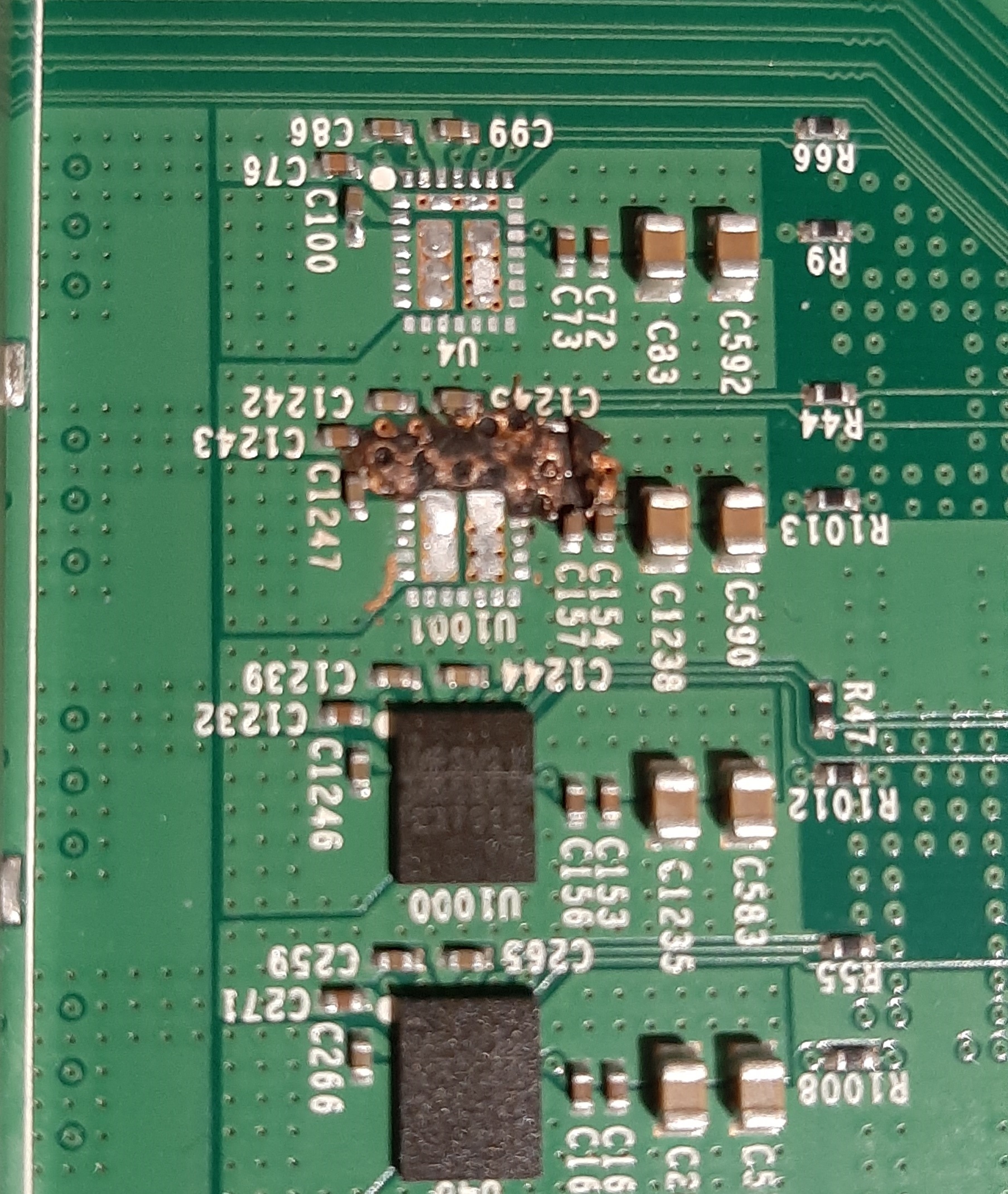

    Xbox Series X, is this repairable ??
    Just look at the pictures and tell me if this Xbox is scrap or repairable ?
    I removed the mosfet next to the blown one to see what the traces look like ! Pictures are from top and bottom.
    Thank

    Can't see the traces, what's the brown bubbly stuff ? Clean it off.

      It's the copper trace that I rolled to the right. Believe me, it is clean !

        gosh what a mess. how did that happen? doesn't look promising with..perhaps wit lots of time and patience

          Now you say you've rolled the copper to the right, I see it.
          It is a bit blurry, but I'd say it's possible.

            Now that you say you've rolled the copper to the right, I see it.
            I would say it's possible.

              Possible, maybe ! It's burn through the second layer, I think. How can I solder a new mosfet if there is no more traces, pcb pads ???
