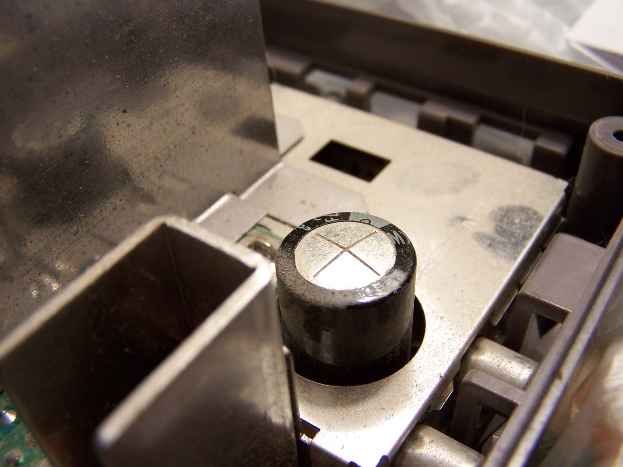

    Was digging through old boxes and found my Nintendo!!!
    But damn thing did not work!!!!!
    Blown Nichicon VT cap. Panasonic saved the day.

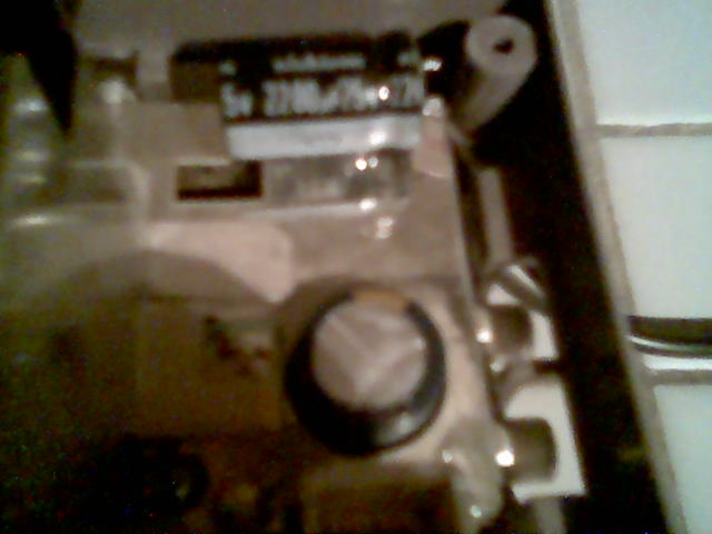

            I have a nes that I'm attributing some malfunctions to that cap as well. 1. What is the cap rated 2. How hard was the install 3. What wattage soldering iron did you use? Thanks Aaron
            • Fatal0E
              • Jan 2004
              • 252
              Re: Nintendo Entertainment System!!!!!
              Was a 25 volt, 2200uf cap. Was the 6 or 7 screws to get case off, 6 more to get a shield off, 6 more to get the board out, pop off a metal shield and remove cap. I used my usual $1.99 big lots iron . Had no problem melting solder.

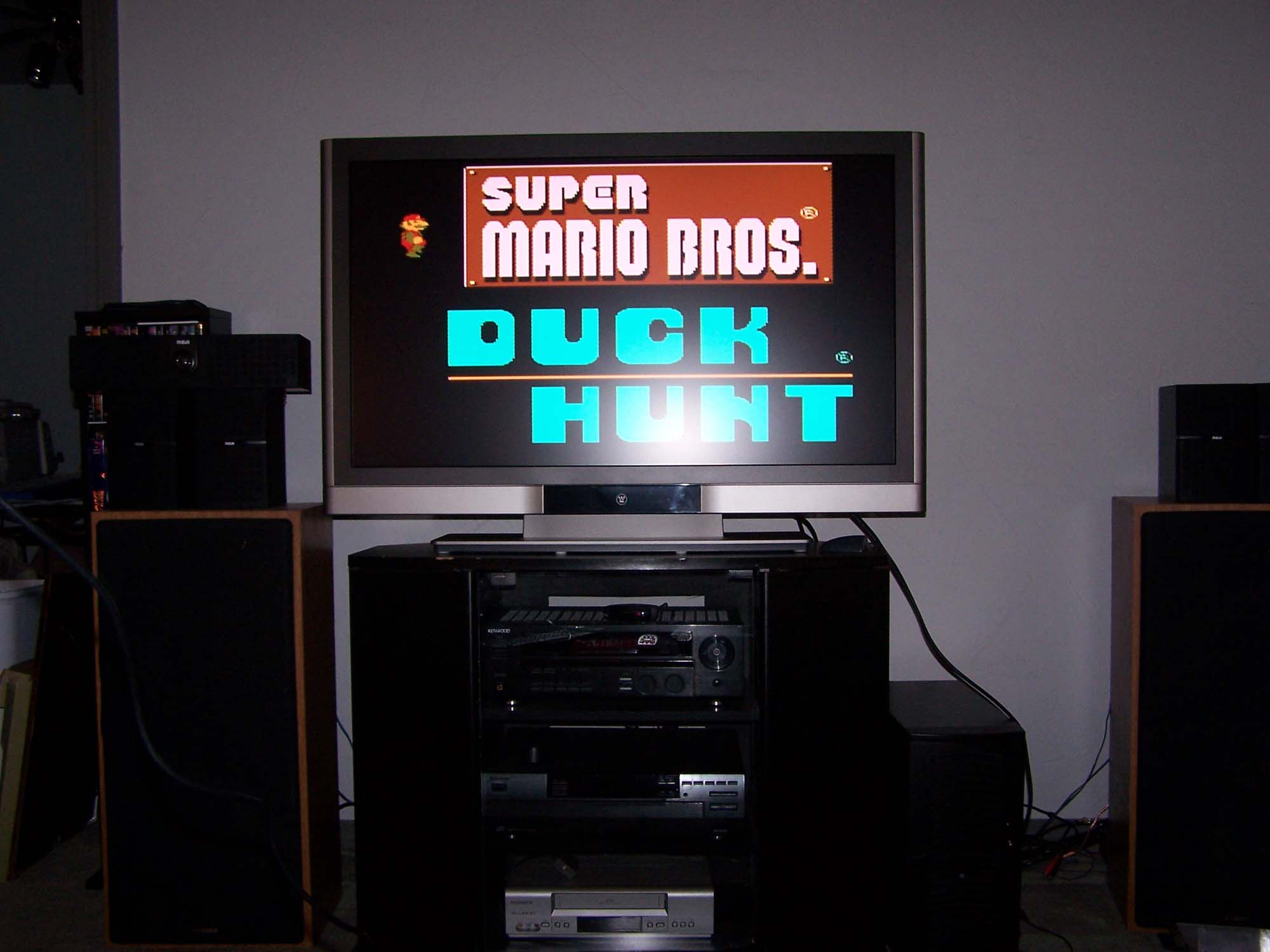

                The Sega Game Gear had an interesting design flaw with the cartridge connector. If the cartridge wasn't pushed in fully, the bottom row of cart pins would actually short the top row of connector pins. This frequently ended in a destroyed system - indeed, I blew up three Game Gears this way . I remember smoke pouring out of the mains power connector when it happened...
                I've never heard of bad caps in a games console before though, and I have semi-recently checked mine - all still good. I always thought that the caps inside these games consoles are too small, and/or don't get put under enough stress to fail prematurely, unlike the ones in PC motherboards.
                BTW, Duck Hunt won't work on that TV. The gun works by reading where the electron beam on a CRT is when you pull the trigger; since LCD and plasma sets use a completely different method, it'll just act like you're shooting off-screen all the time.

                  If you don't mind my asking where did you get that cap on short notice? Do you think a local tv repair shop in town might have one?
                  • Fatal0E
                    • Jan 2004
                    • 252
                    I ordered the cap from Digikey I needed some others anyway. I cant find my gun or my Super Scope. I did find my Mario 3 but something is wrong with it. Cannot find my Mario 2, but somewhere I have all 3 games for my super nintendo, I am looking.
                    The Digikey part# is P10285-ND

                          So I got the cap from an electronics repair shop for free and I replaced the cap. Unfortunately it didn't fix my problem. When I turn the nes on everythings perfect for about 5-7 seconds and after that the colors go all funky. If I just hit reset the colors stay the same, but If I turn it off for about 5 seconds the colors will be right when I turn it back on for like another 5 to 7 seconds. Any thoughts or suggestions would be greatly appreciated.
                          • Fatal0E
                            • Jan 2004
                            • 252
                            My problem was when i turned on the NES it would just flicker on and off, had to let it get hot, took about 20 minutes, then it would work, but crashed often. Now it is working fine except for mario 3. But I did find my Super Mario Allstars for the SNES and it works perfect!!!!
