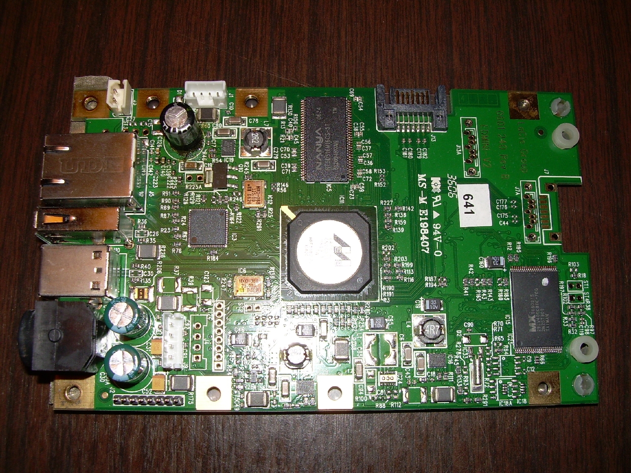

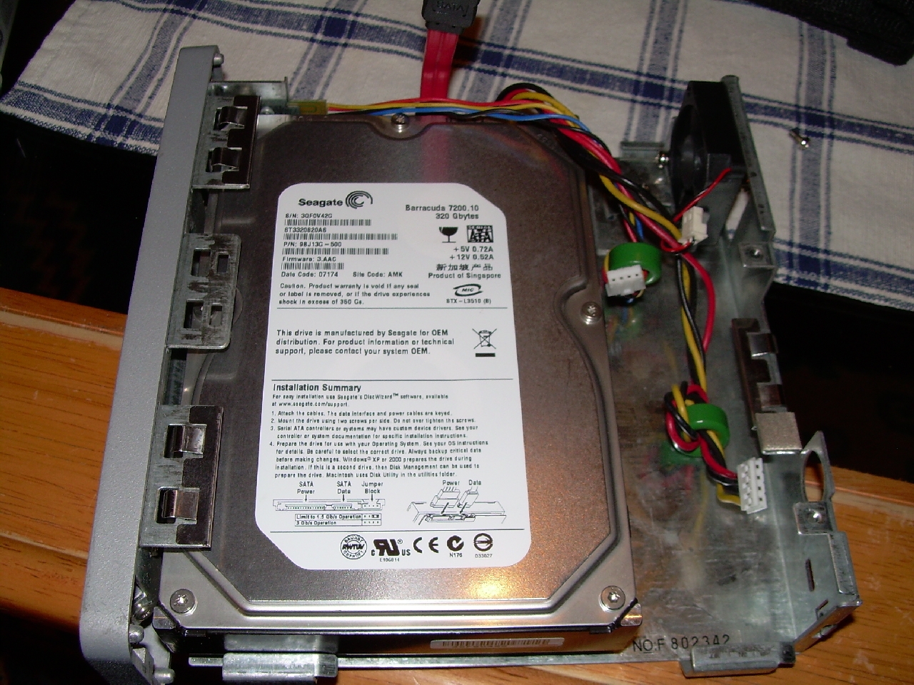

    Some years back I found this Lacie Edmini V2 at the dump, only thing wrong with it was the boiled Samxon Gf's in the powersupply. Checked the hdd and it only had 16 hours of use, I have only used it maybe for 30 hours now and last night I decided to do a complete backup and format the drive.

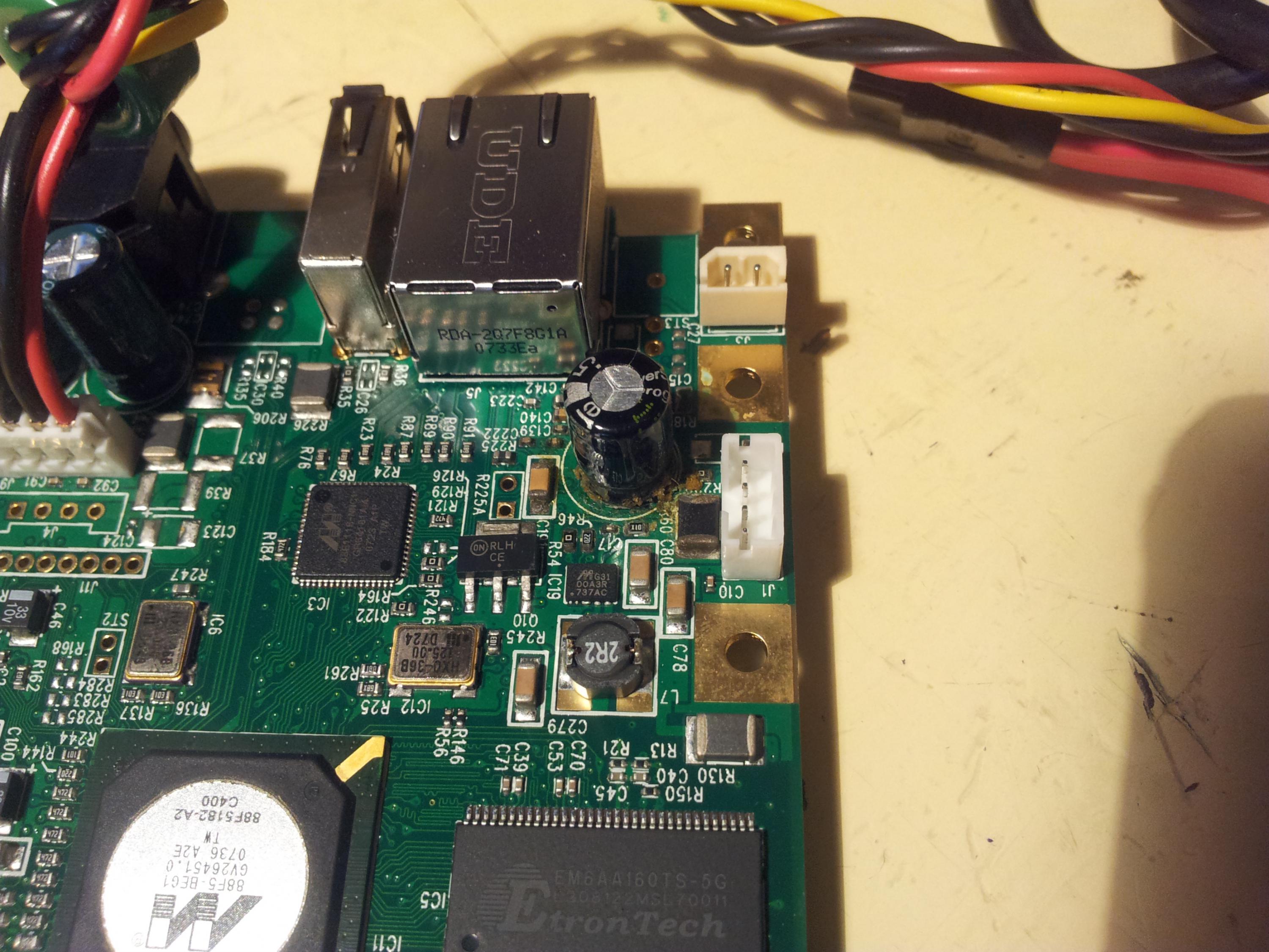

    I remembered it had a Seagate 320GB drive so today I thought I could check and see if the drive had the famous firmware problems which it did not.

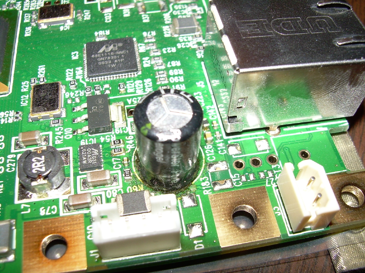

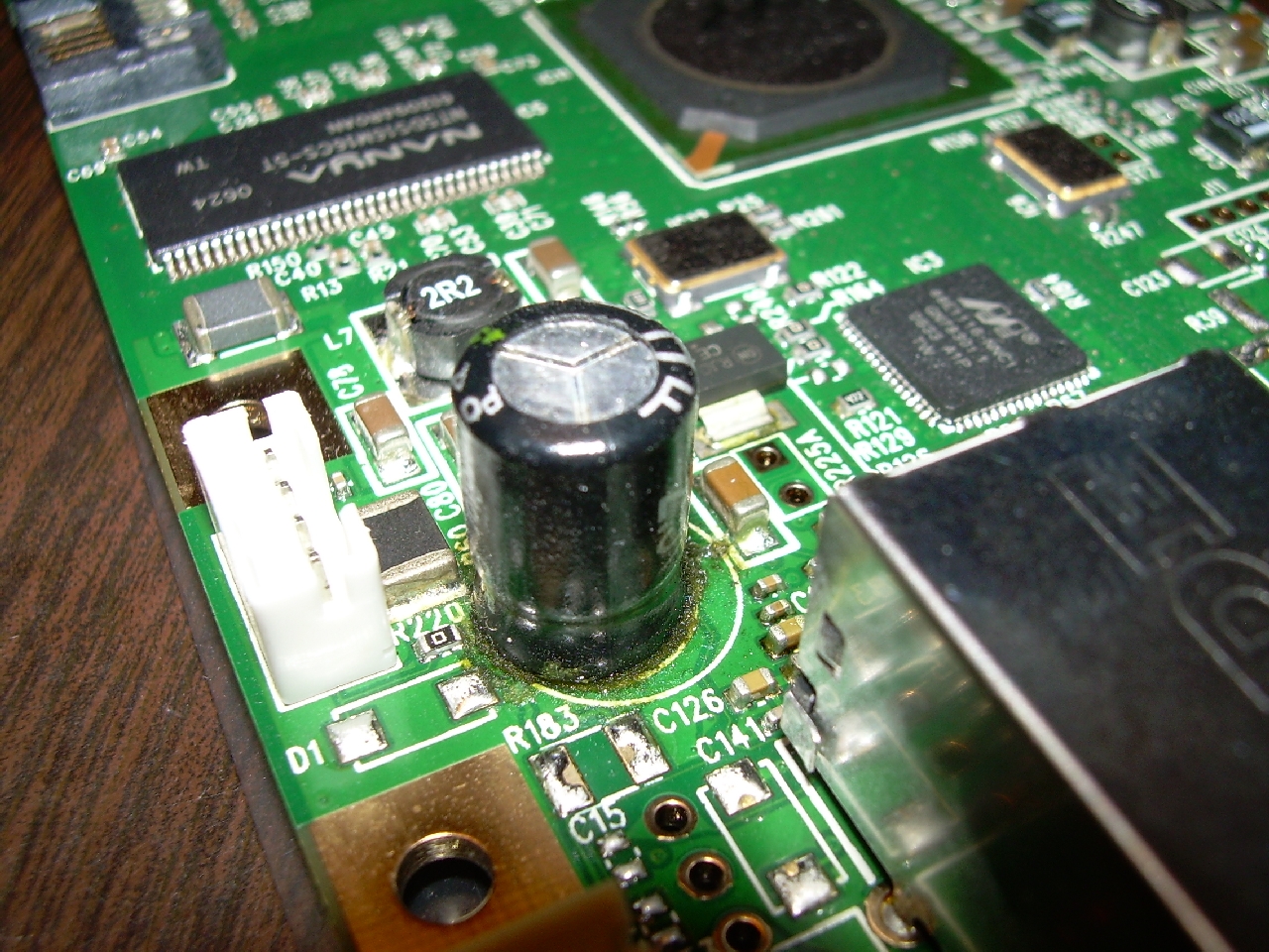

    Anyway, had a look at the main board and got a little surprise.

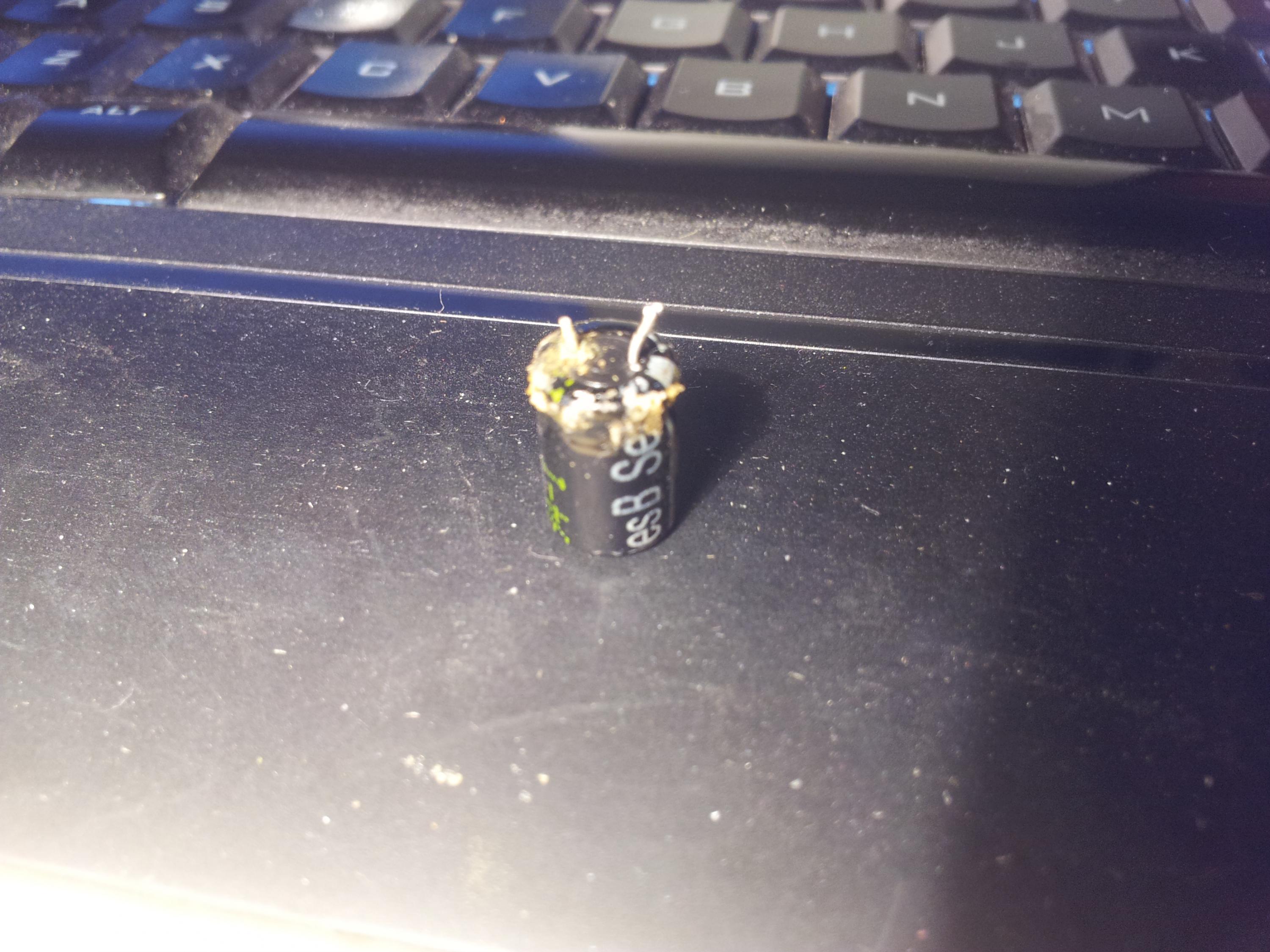

    It had a Powerstor aerogel series B 2.5V cap that must have failed last night.

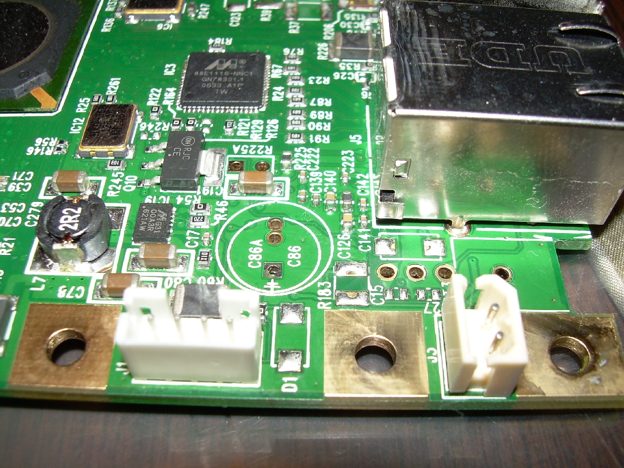

    Managed to get it off and clean the board with crc contact cleaner and a brush.
    According to the datasheet the Powerstor should be 1F and I had non to replace it with, I did notice digikey sells these today.
    The two Samxon Gk measured fine but think I will replace them with ZL.
    There is no battery to keep time on the board so I guess the Powerstor is used for that and that it will work just fine without it ?
    If it is, how long will the cap keep time before it needs to be recharged ?
    Suggestions on that ? maybe a cr2032 will do the same job ?

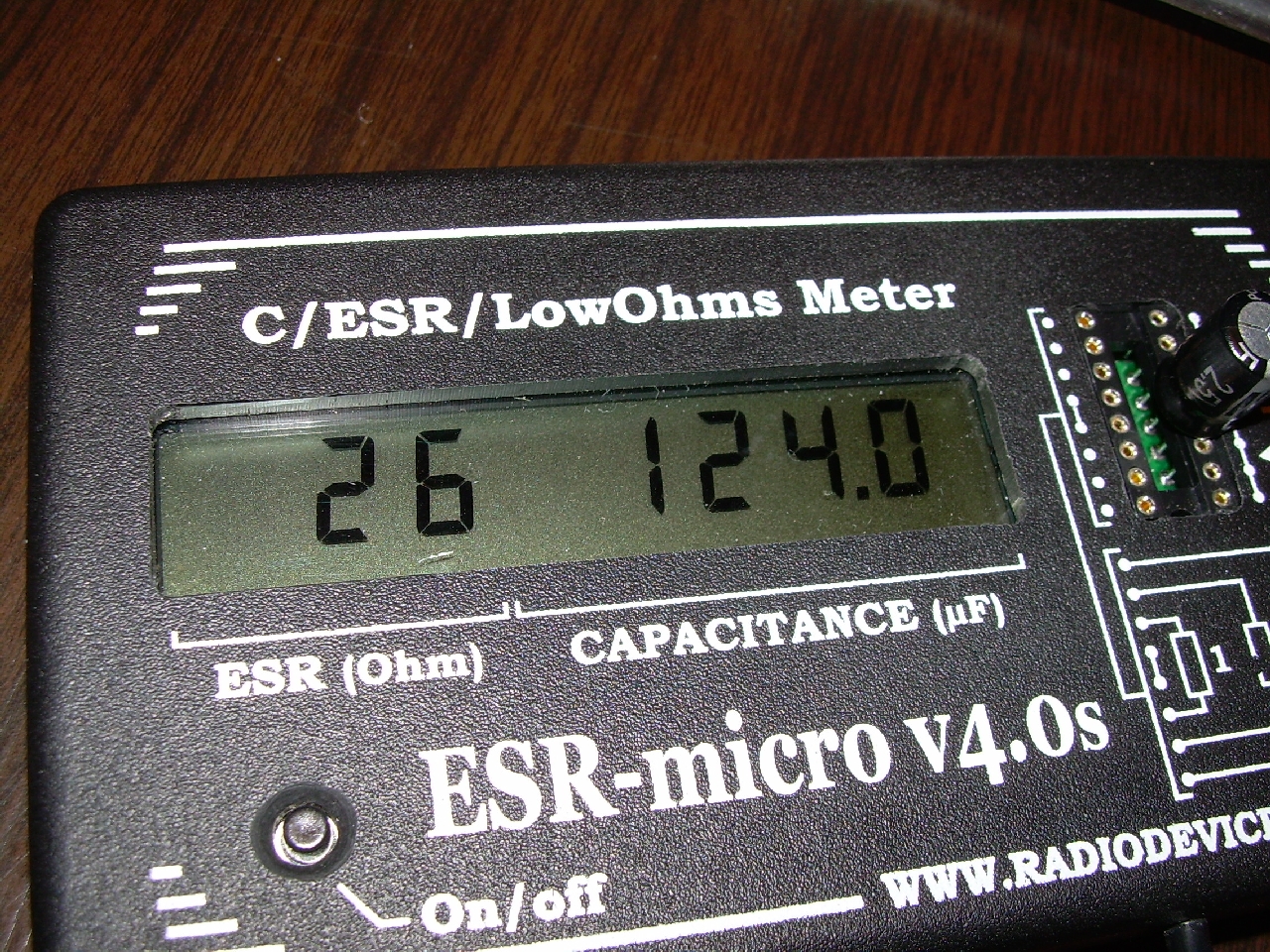

    Using the esr meter it first measured it to 54 ohm ... ..

    I'm not sure esrmicro is capable of measuring the ESR of a supercapacitor, at least one that's 1F or that big of a value.
    And... that looks more like glue to hold the cap in place while flow soldering, but since you didn't show the underside of the capacitor I can't be sure if it's bad or not.
    The pcb holes look fine and the crap on board follows the diameter of the capacitor, without any trail going to the leads, which makes me think it was just glue.

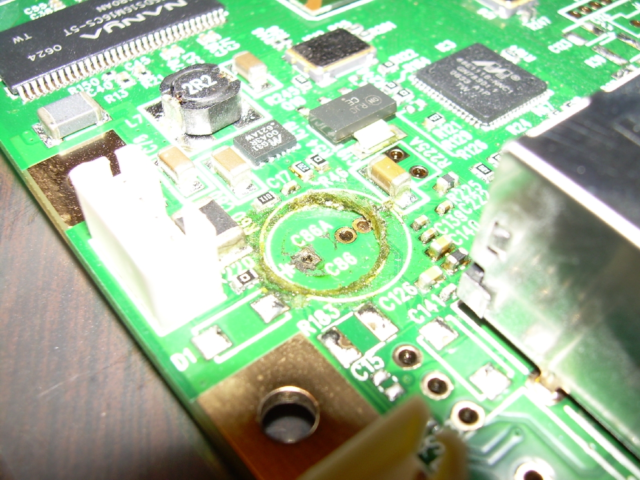

      Not sure if the esrmicro can measure it properly.
      No, it's not glue - not sticky substance at all - you can see on the components around the cap that some of them (picture 7) are covered in a yellow like substance. After cleaning no more yellowing in picture 8.
      Yes, the board looks fine - if the cap started leaking last night the fluid did not have time to corrode the board.
      Tried to take a photo of it, some of it left and it covers my fingers.

        this looks to be the same kind of supercap the original xbox has for clock backup. it's notorious for leaking.

          Hehe your right - found some info about xbox and these aerogel B-Series caps.
          https://www.badcaps.net/forum/showth...hlight=aerogel
          http://forums.llamma.com/viewtopic.p...e69dc9466e585b
          And to answer my own question in the first post 'Ultra low leakage current (can hold a charge for several weeks)'

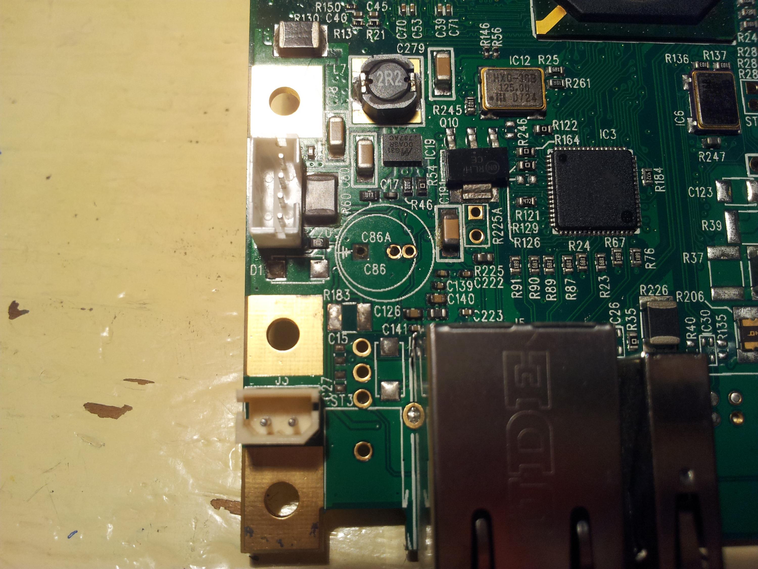

            Have been testing this drive for a few days, I took a cr2032 battery and holder and soldered in a 1n4148 diode to prevent battery from charging.
            The rtc circuit from Ricoh draws Typ. 0.5μA at 3V,it now keeps time and I guess it will maybe for several years instead for just a week with the 1F cap.

              After the Edmini won't boot anymore I opened the case and found this supercap with a lot of dirt around it. After removing the supercap and cleaning the pcb, a tiny trace and a thru-hole was gone, luckily i could solve this with a tiny wire. Just to be able to boot the Edmini and rescue my files, I put in a small capacitor of 2000uF/5V. Now the Edmini works again and my files were copiëd to a new NAS.
