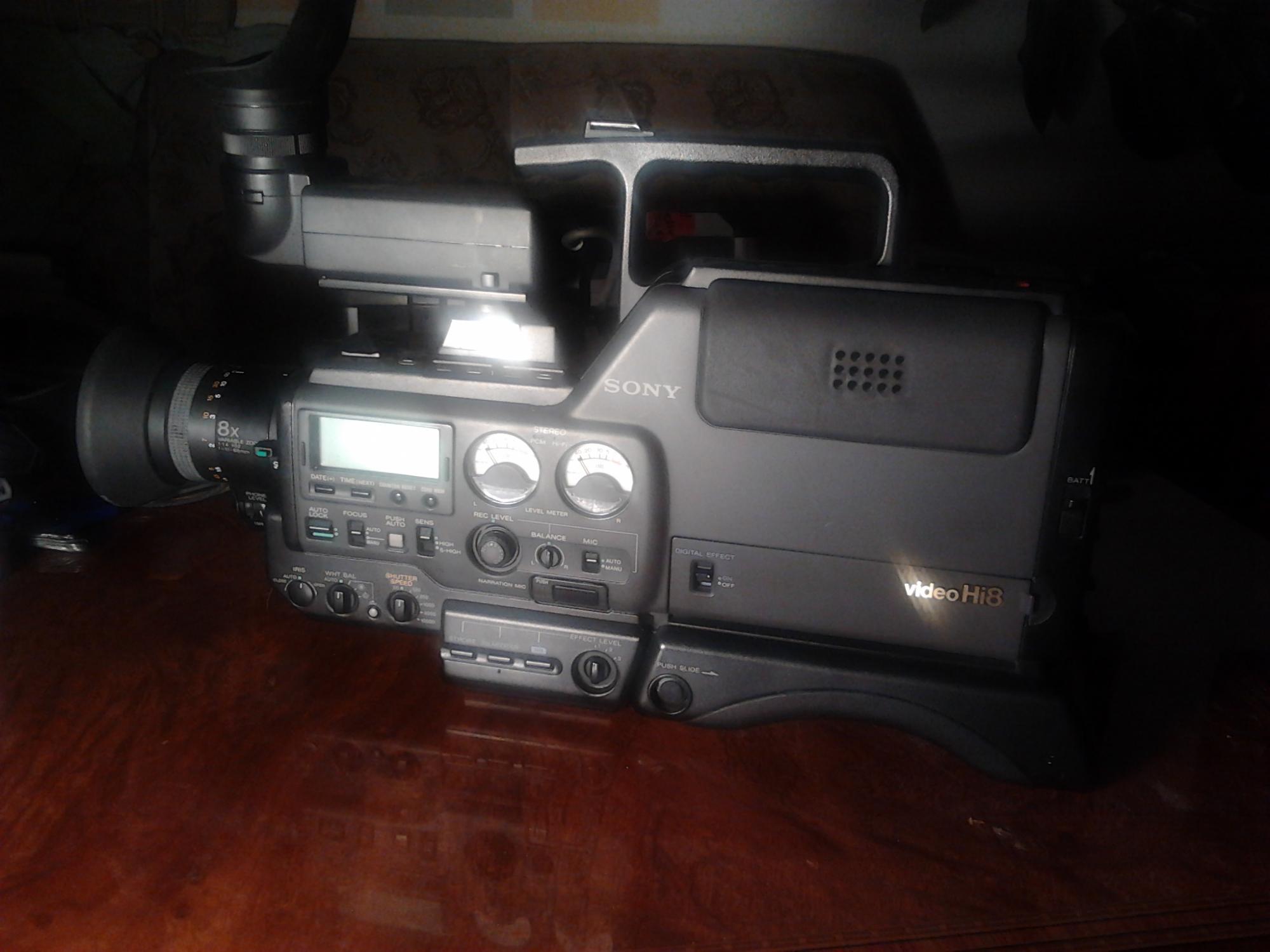

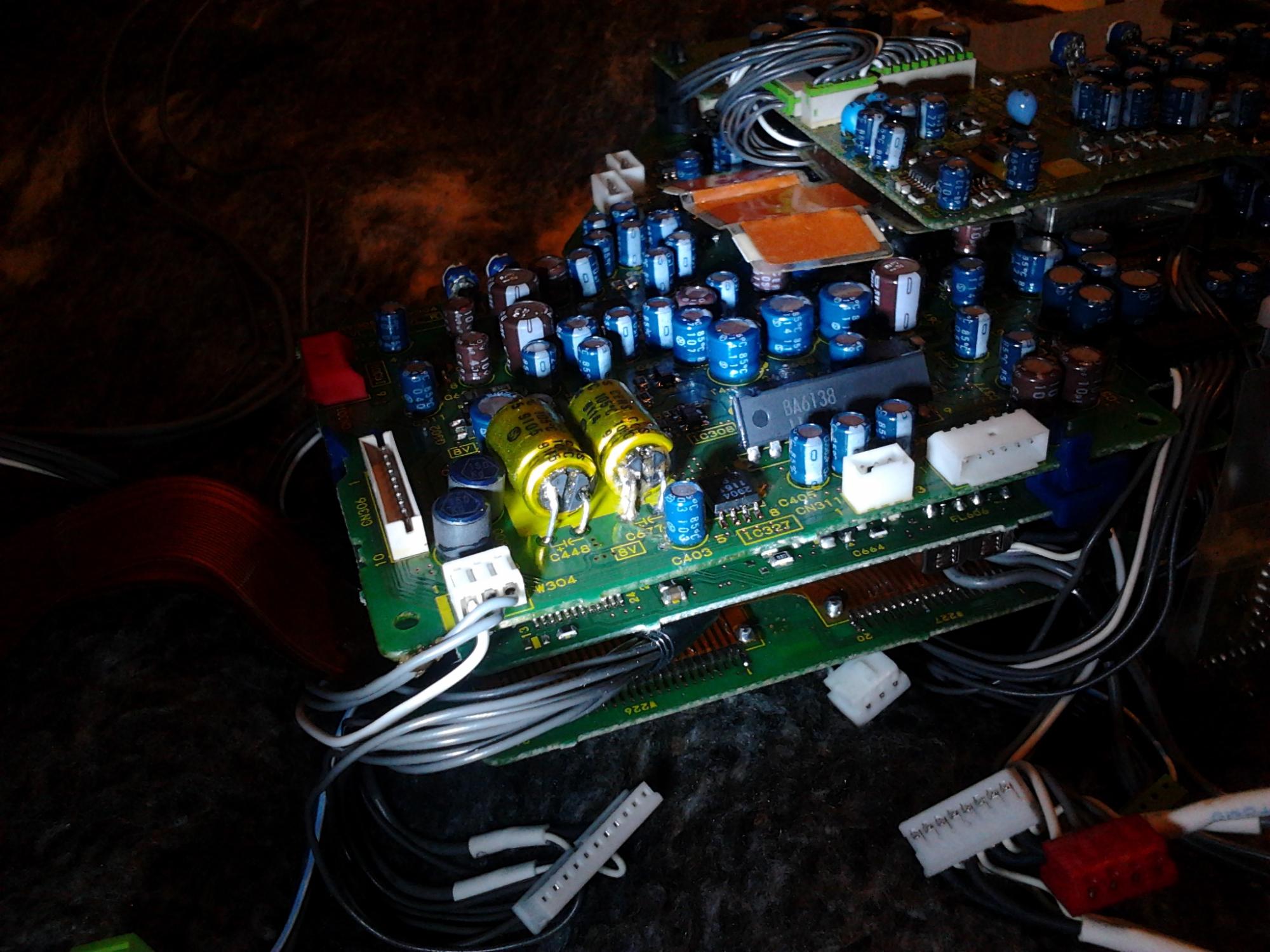

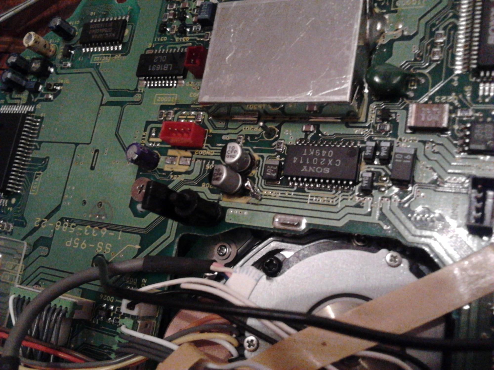

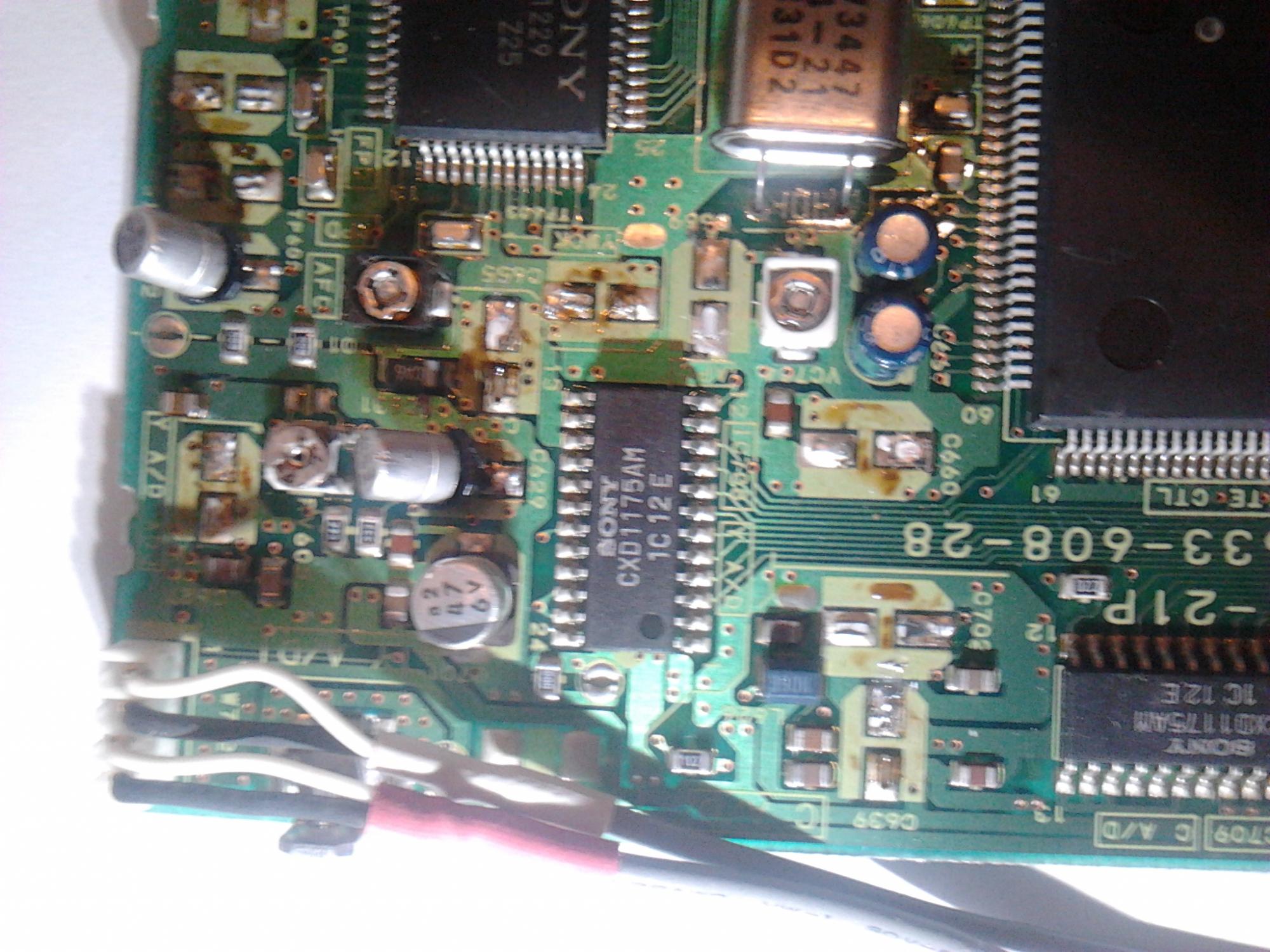

    Some weeks ago I bought a big fullsize camcorder on Ebay. The seller stated it was working and I could get it for 50 bucks, so I thought it would be worth a try.
    I was already a bit suspicious about the condition, as the price was a bit too low So it arrived here and yep - it was broken. The camera would start up, but needed a time of 10 to 20 seconds to show a picture in the viewfinder. When I tried to record something with it, the picture got garbled.

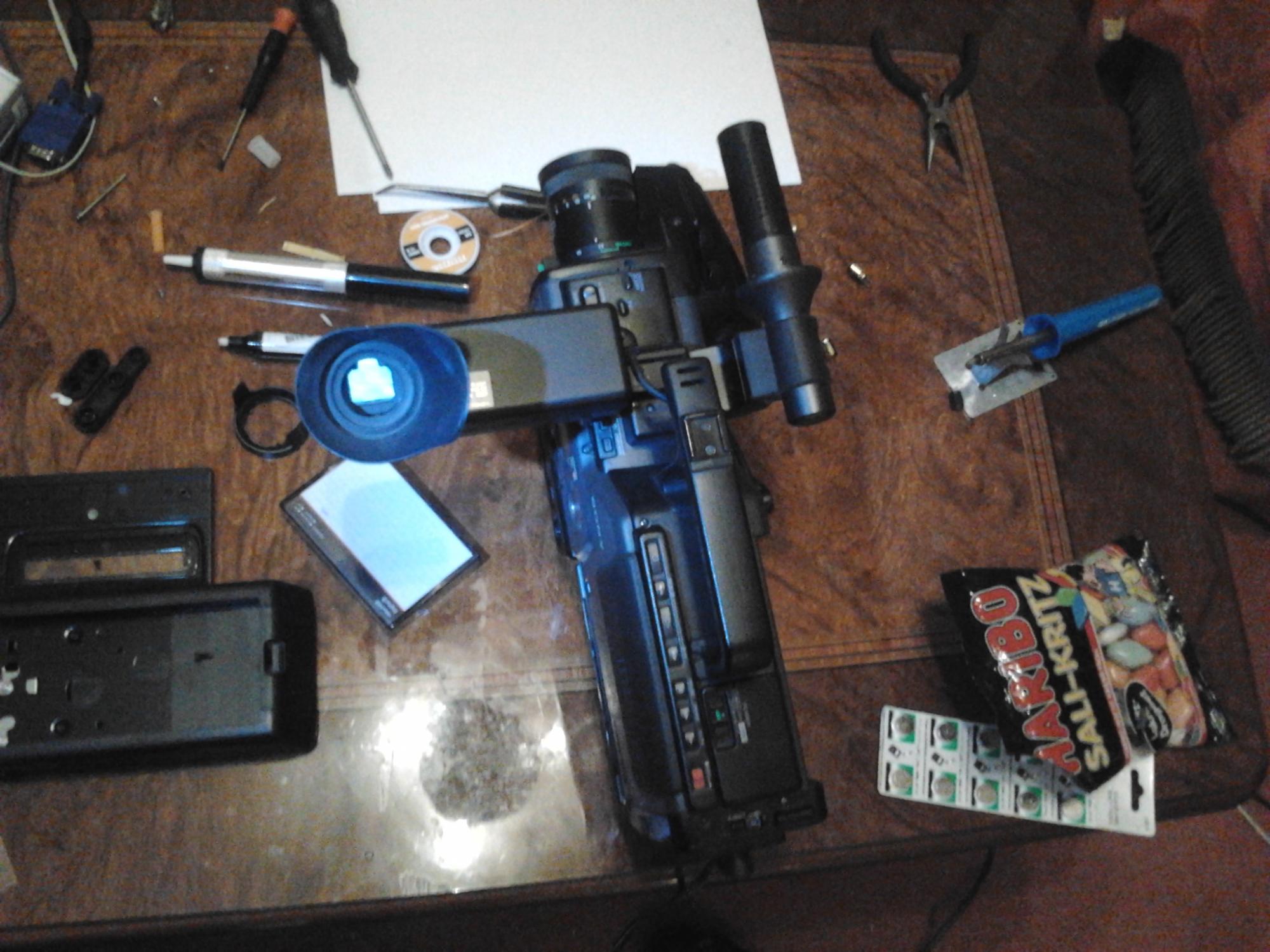

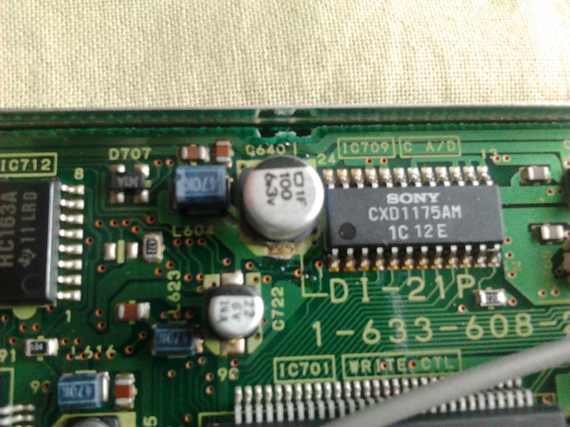

    So i opened up the camera and found 67 leaking SMD capacitors and 5 leaking normal capacitors! I already replaced all of them on one of the boards and hopefully this thing will work as a charme again when I am finished. I have never done such a thing before, but I learned a bit of techniques for soldering from Youtube. So i bought PCB cleaner, tweezers, magnifiers and started going!
    In case of somebody finding this thread on Google and having the same camera lying at home, I will note down all of the capacitors that have to be replaced.
    The SMD capacitors are:
    22x 22/6V
    9x 10/16V
    3x 47/16V
    9x 47/6V
    8x 100/6,3V
    2x 2,2/50V
    6x 4,7/35V
    1x 22/35V
    1x 3,3/50V
    1x 10/35V
    1x 0,22/50V
    3x 1/50V
    1x 33/4V
    I couldn't get the 33/4V capacitor, so I had to buy a 33/25V one. And the 0,22 capacitor was very hard to get. Nowhere I found a SMD version of it, just a normal black and long capacitor, which isn't even Low-ESR. So I hope it works.
    And the "golden" capacitors on the boards where also leaking, here are the values:
    3x 220/16V
    2x 330/10V
    They where easy to get. From all of these caps I bought some more and I got away with 20 bucks, so I think thats a good deal as a local repair shop here stated that they can't repair the camera anymore because a lot of the parts are no longer available. A lie - I guess they where just to lazy to replace the bunch of caps in there
    I will attach some pictures from the leaking capacitors and from the board I already recapped today. It's the memory controller of the camera, so I guess the record function could be working right now if I would test it. But a half-done job is not a well-done job, so I won't.
    As progress on this camera continues, I will post more.

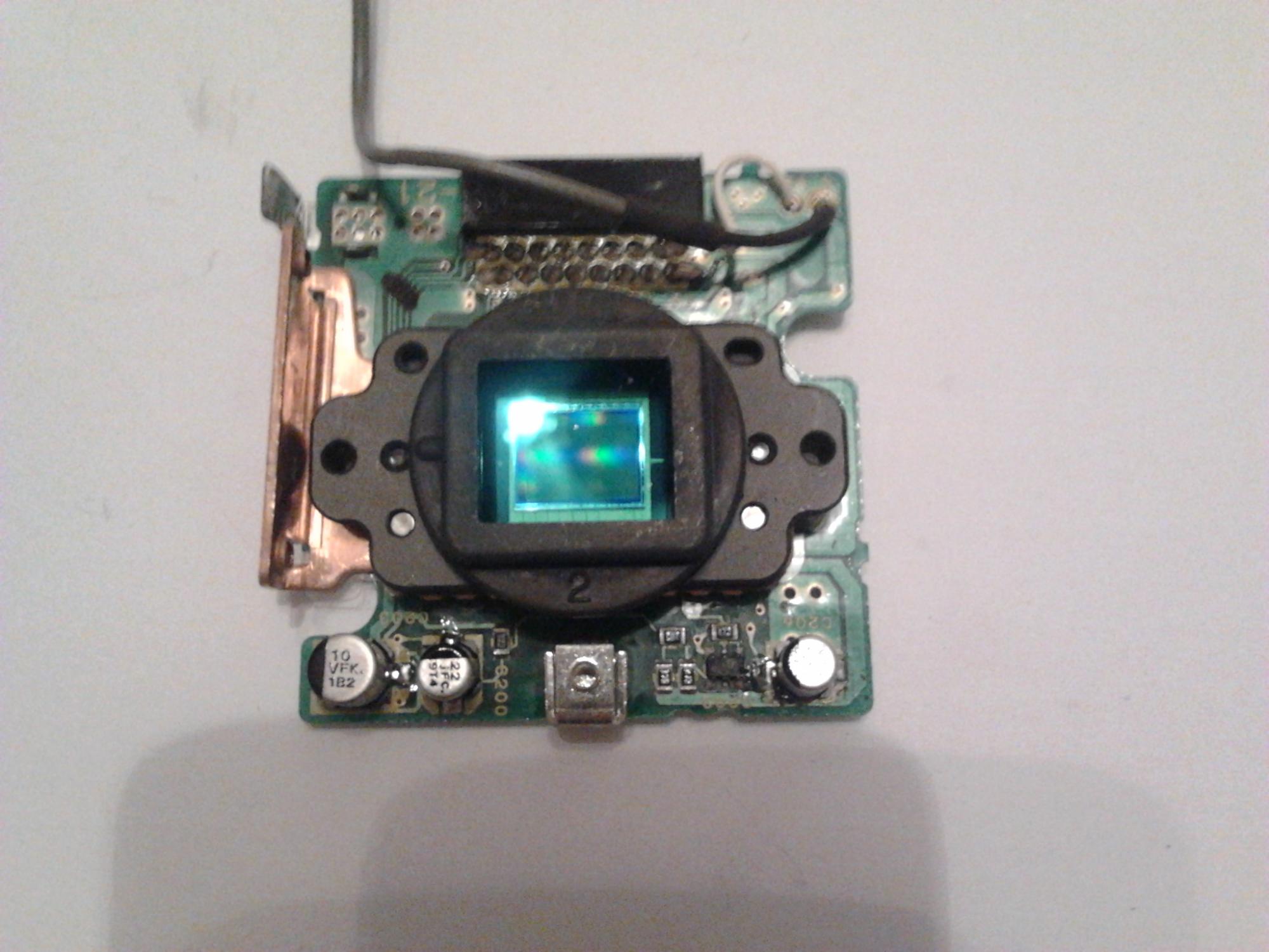

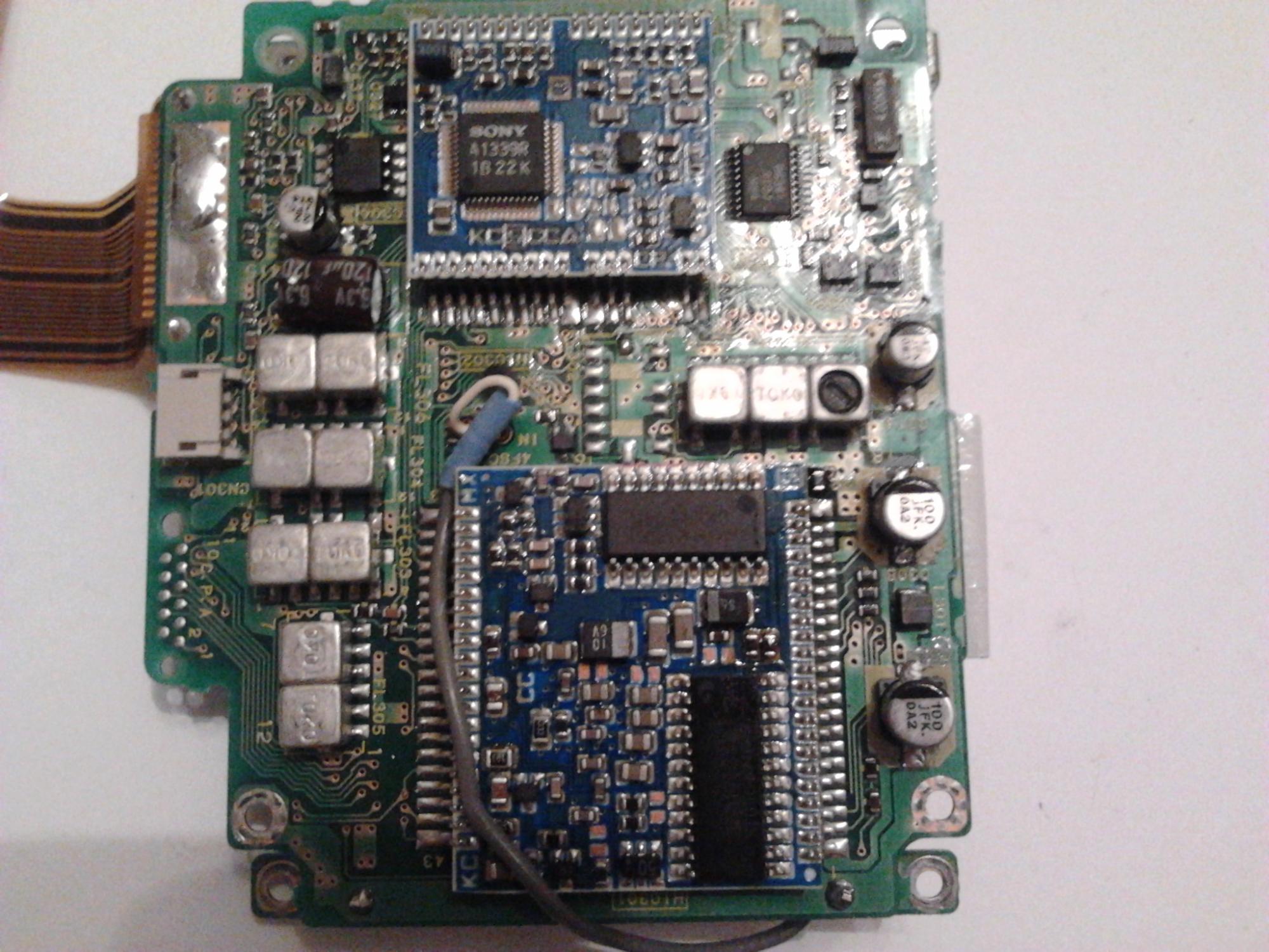

        Today I recapped one double-board that is sitting on the lens block and I recapped the CCD board. I also managed to change all the big golden caps. Pictures attached I guess I made it really well for a beginner with shaking hands.
        All that is missing now are 3 SMD caps on the other lens boards and some SMD caps on the "big board". After that, I will reassemble the unit and try it out!

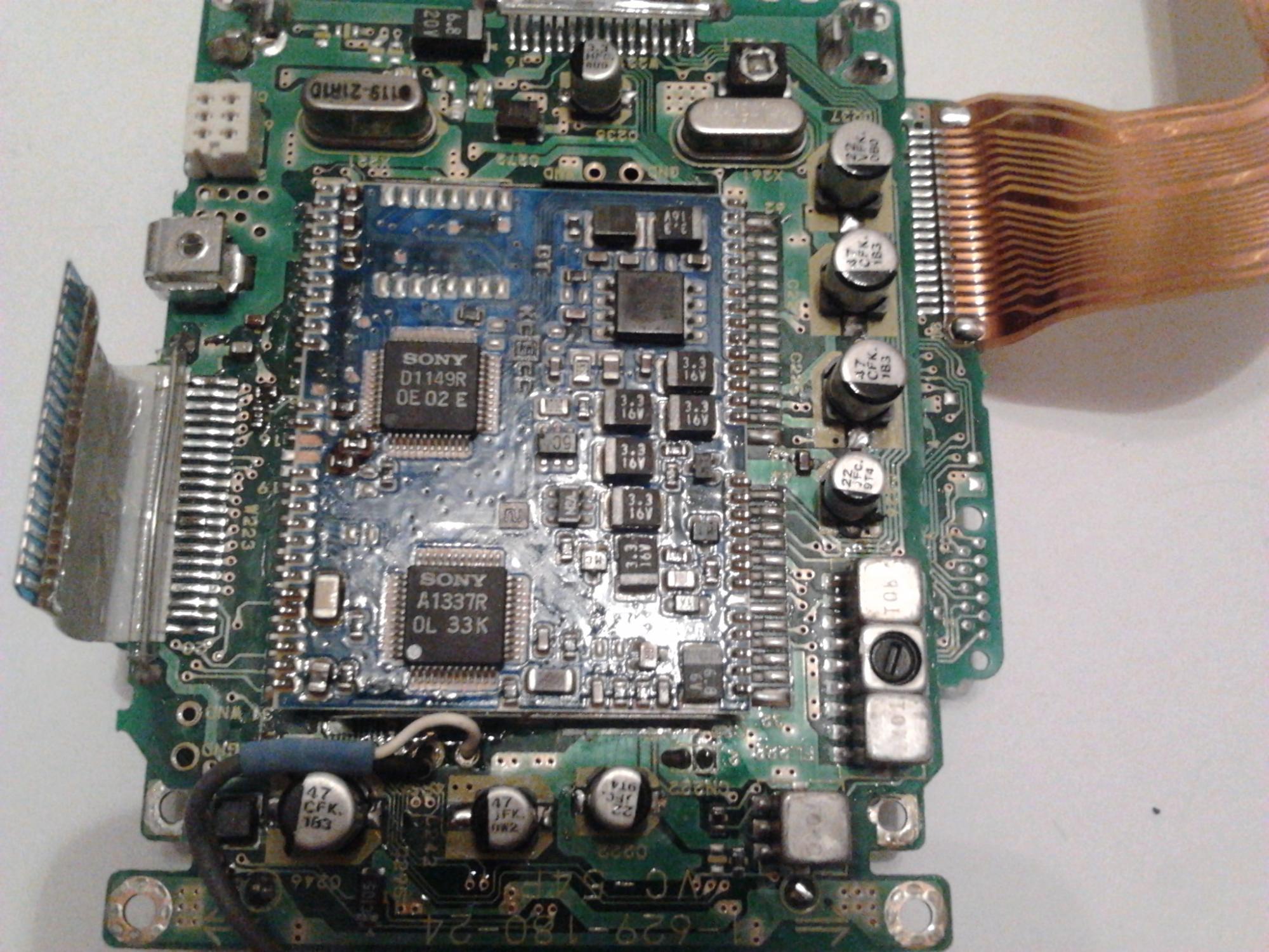

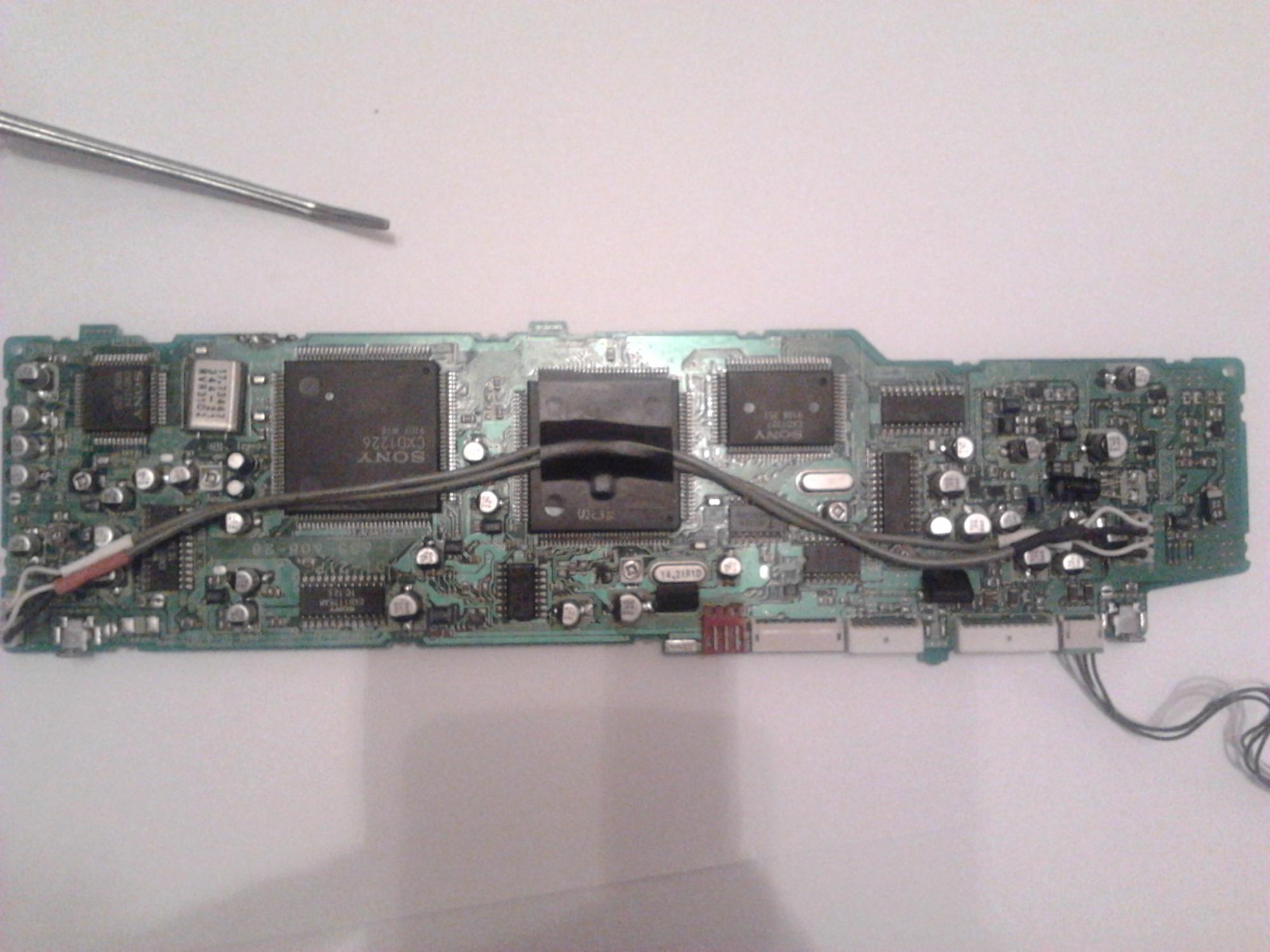

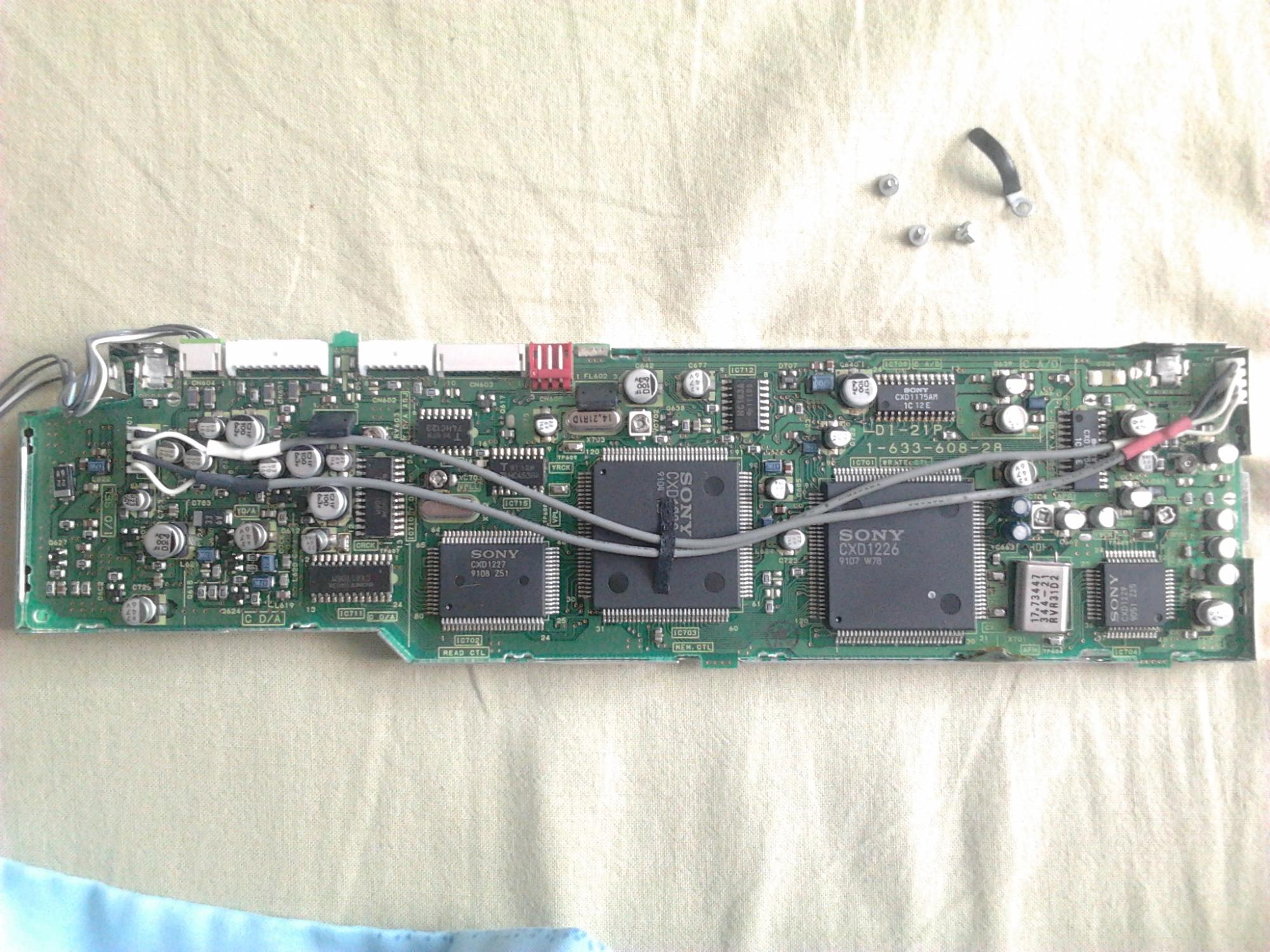

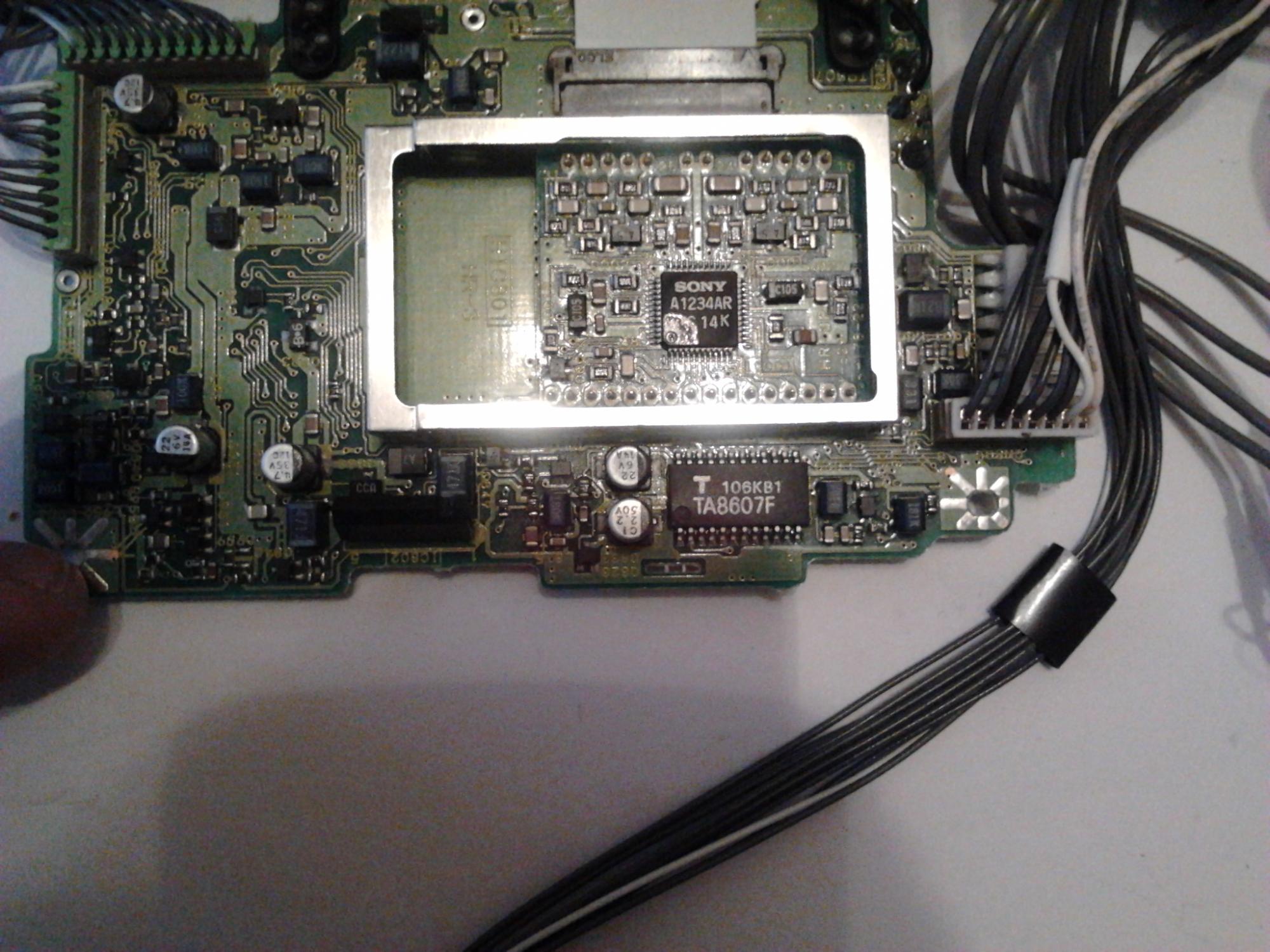

          Today I recapped half of the mainboard and a little board, that is directly attached to it. I also finished the lens unit.
          Recapping the mainboard has been really difficult so far. A lot of the solder points are in a really bad condition. One was even completely missing, so I had to attach some wire in the hole there and connect it to the paths, that where going there. I took me nearly an hour, but the connection has been made!
          I fixated the caps in this area with hot glue after that. That should last for a while.
          Only 9 caps are missing now. Maybe I will finish up tomorrow. Hope it works.

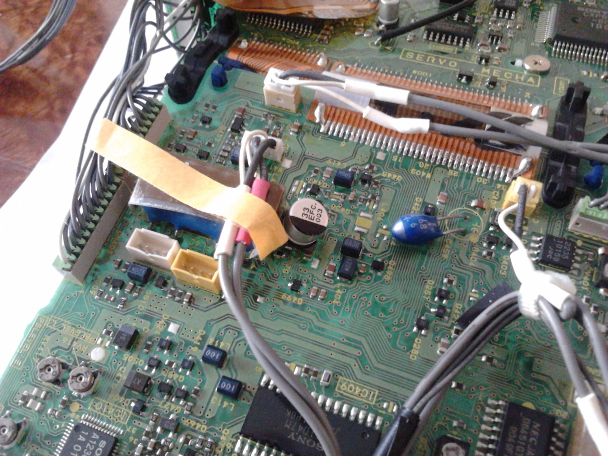

            Re: Sony CCD-V5000E (Repaired!)

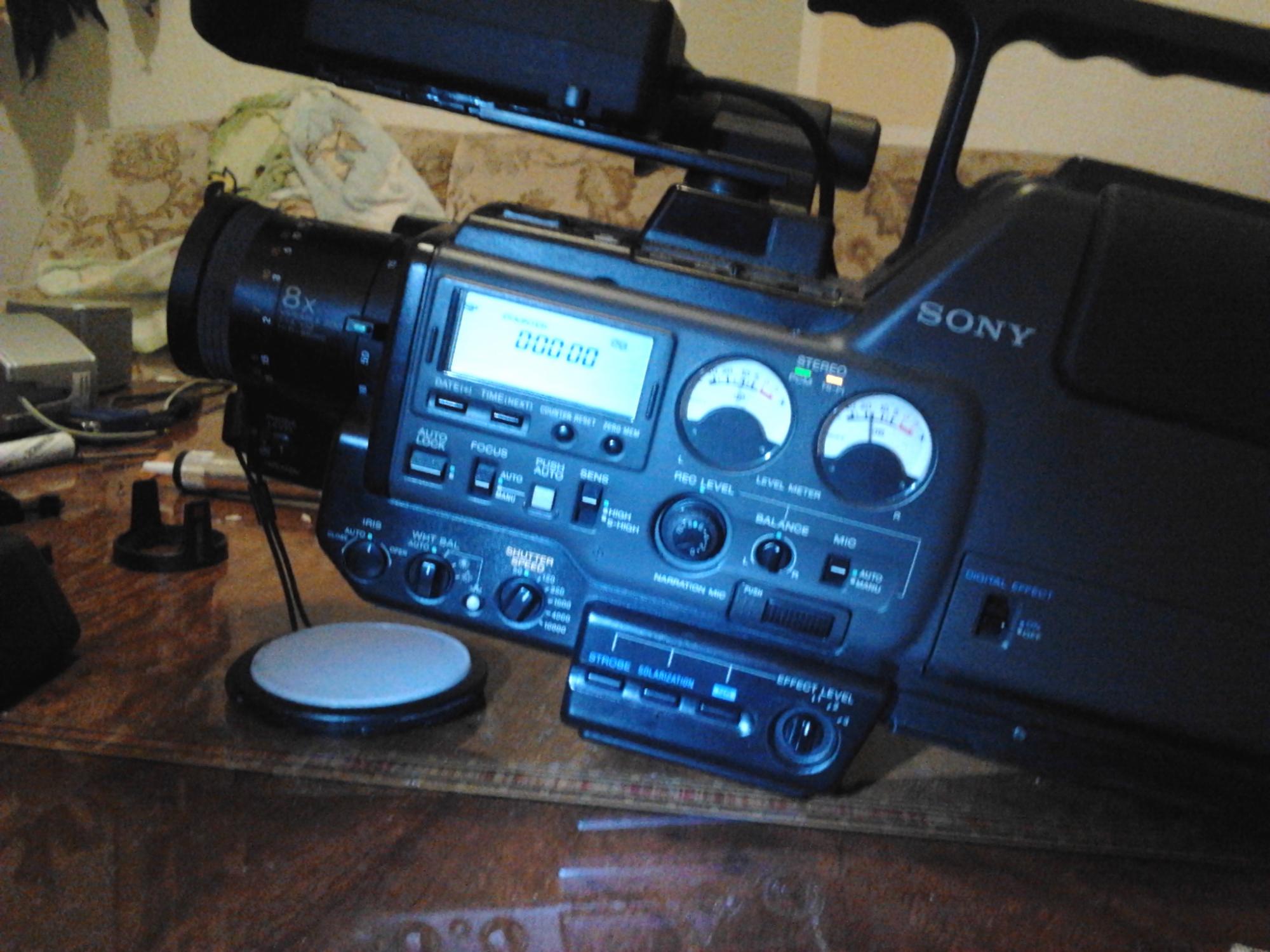

            I recapped the last half of the mainboard, One of my caps was too big, so I had to solder it a bit weird. You can see it on the first picture. But IT WORKS, so...nevermind.
            Now I got one of the last fully working CCD-V5000E cameras. I'm proud!

                    But YES. The disassembly isn't that hard, but the reassembly was one of the trickiest I ever had. There are a dozen connectors inside the camera and they all look the same. What's even worse is the fact, that even the cables look the same - they're just white.
                    In hindsight I am very glad that I shot a lot of pictures after removing each part.
