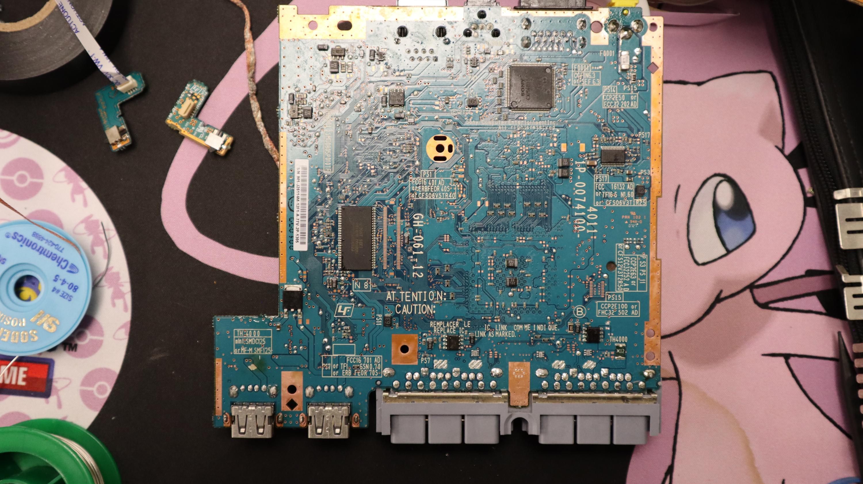

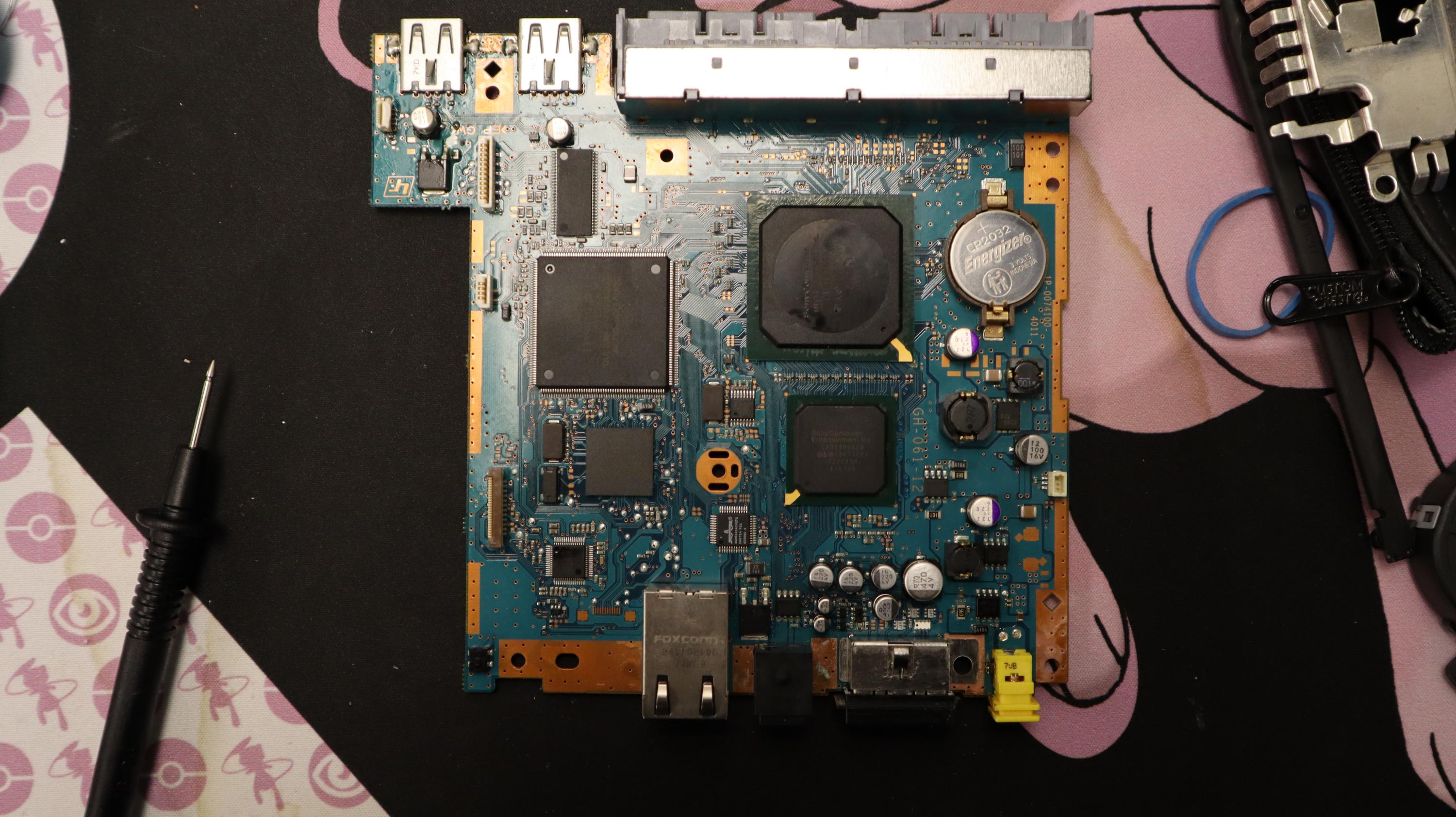

    My multimeter and PS2 board.

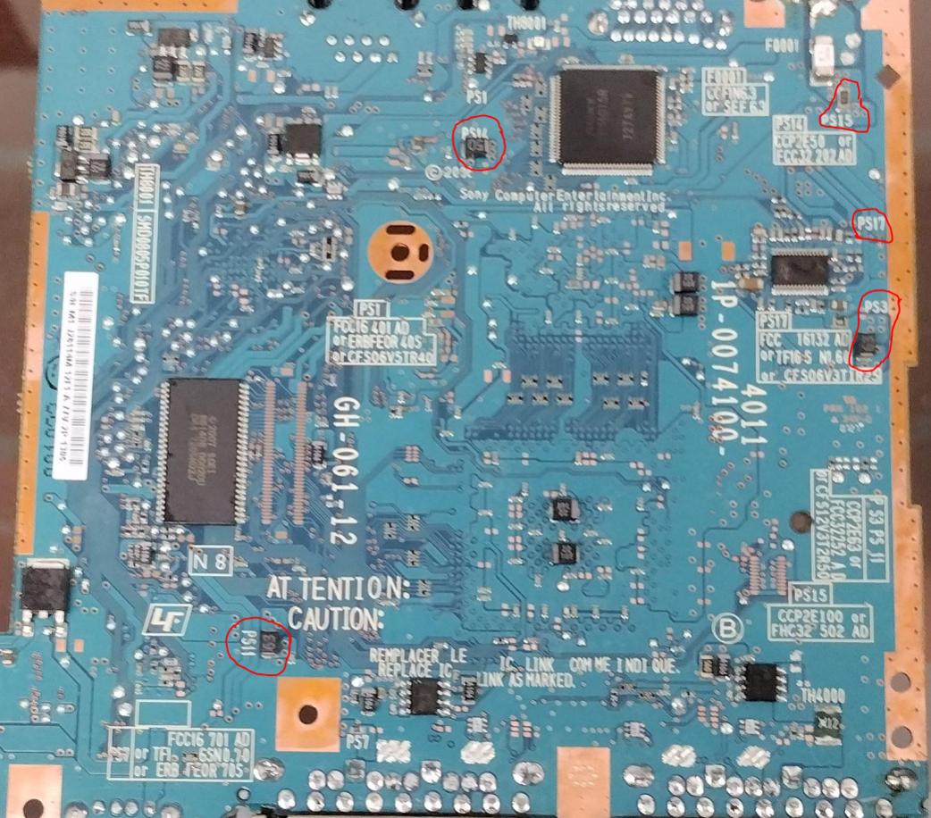

    Probably the board was shorted somewhere, in addition to the input fuse, there are several other smd fuses on the board, they have the designation PSxx, check them.

      I tested all of the fuses that you highlighted. One was giving me some trouble, so I cleaned it with Isopropyl and it's continuity was fine.

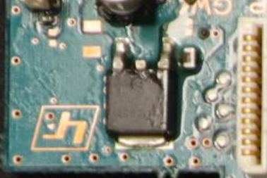

          Didn't know that was a feature. I took this with a higher resolution camera.
          Also I regret to inform you that I removed whatever that component was last night. :boom:
          No success.
          If I can find it, then I will solder back on if necessary. I also have a spare board for components. Are you determining what it's function is by observing the circuit around it?

            check this .. it looks broken .
              What kind of component is this? How do I test it with a multi meter? The only thing I could do was refresh the solder.
              What makes you think it is broken? The center prong?

                looks like a chunk has broken off

                  I found an identical part on another mobo and they look identical. They both have the same continuity too
                    i think it's flux
                    i dont know why sony has always sprayed it's pcb's with rosin???

                      I can confirm with 100% certainty that there is an abundance of flux in that area.

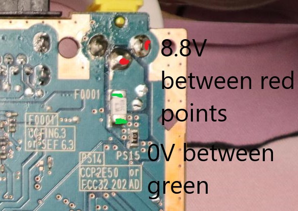

                            The AC Adapter prominently specifies 8.5V (this is not an OEM PSU). MM shows 8.88 from the adapter and 8.88 on the mobo where the DC Connector is.
                            I am not getting any voltage at the main fuse, however I am getting continuity between the both points of the fuse.
                            The standby LED is off.

                              Post 5, second pic, top right is a yellow connector. You saying you get 8.8V there and no voltage on either end of the fuse below it? I am saying bad connector.
                                • 31264
                                Re: PS2 Slim Not Powering On
                                yea, here is nothing but a copper track between that connector and the fuse.
                                check again, but meter the connector from it's actual solder joints
                                if you still get voltage then maybe the soldering under the fuse is cracked
                                  Yes, that is what I am saying.
                                    • 31264
                                    re-flow the solder on the yellow socket - the joint on the right looks a bit suspect

                                      For shits and giggles put the power directly to the far end of the fuse and see if the led comes on.

                                        Btw… you don’t measure voltage with both probes on both sides of the fuse, right?
