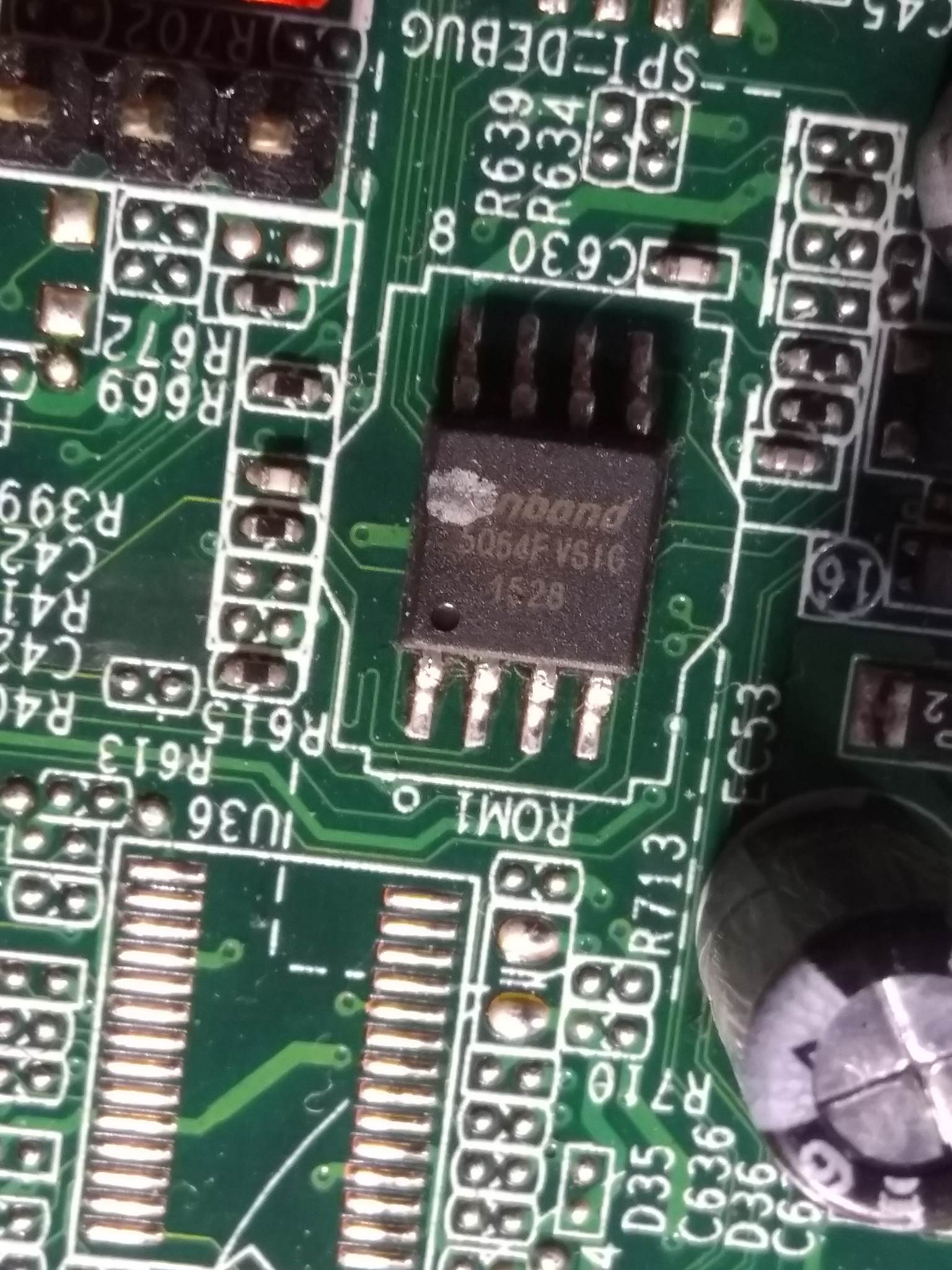

    The desktop is not booting so i need the bios bin to compare or reprogram it.
    I managed to extract a Bios installer o35jy19usa_y700.exe using 7zip, a file named IMAGEO1Z.BIN, I don't know if this is the file.
    Any ideas is a big help

    Using a programmer and reading your bios chip , save it become *.bin file and then post that file with serial number here.

      Its a Winbond W25Q64FV
      The bios file from the motherboard
      The bin file from the o35jy19usa_y700.exe lenovo flash installer.
      I used Ch341 v1.38.

        Yes, IMAGEO1Z.bin is the bios file you need.

          Flash the attached bios.If you need to add or change the serial number,UUID,MTM etc use the installer with command options https://download.lenovo.com/consumer...19usa_y700.txt
