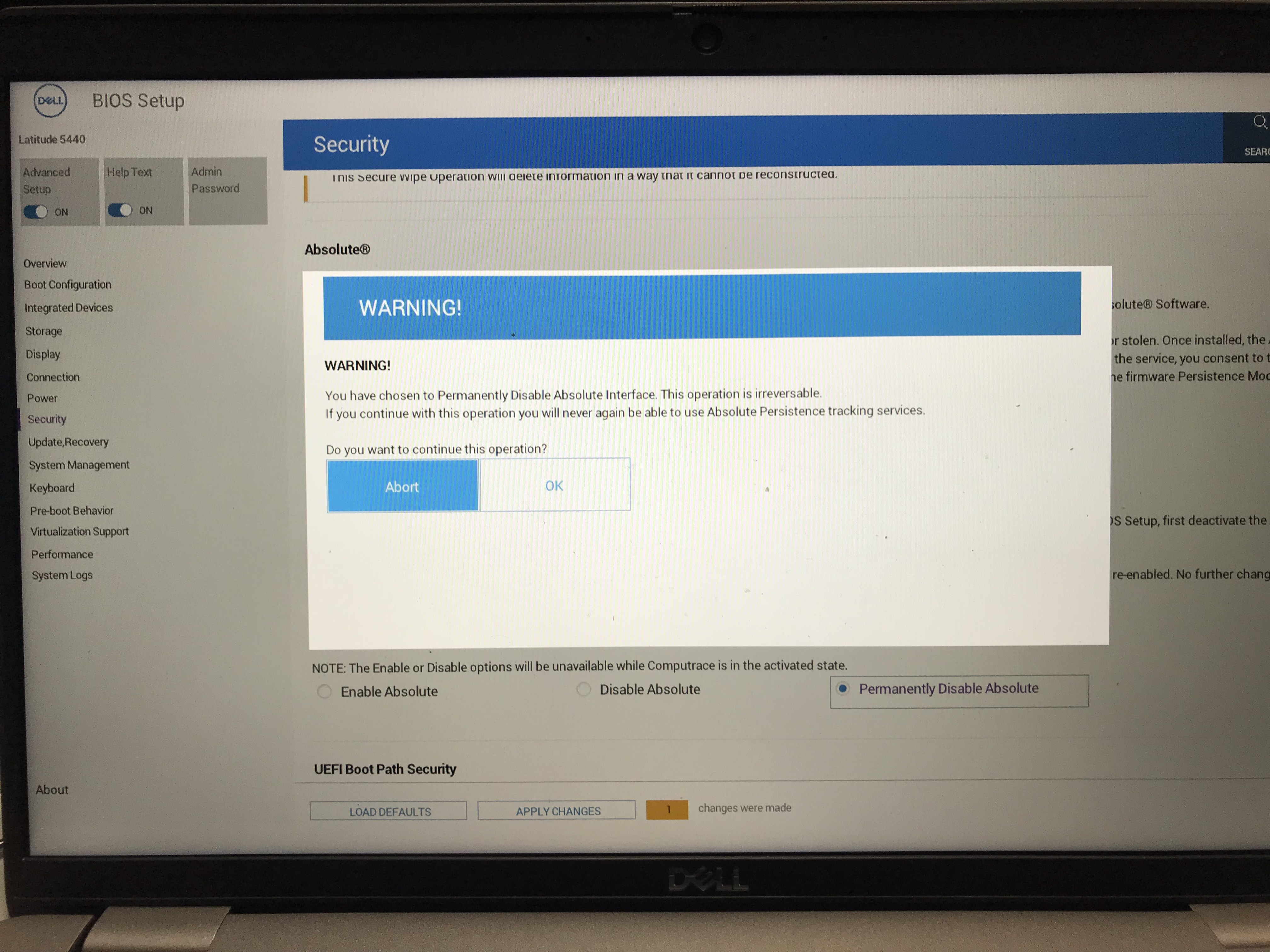

                      #172
                      I have a Dell Optiplex 3000 micro form factor that has Absolute/Computrace enabled. I'm looking for assistance to disable this. I acquired this unit used.
                      Service Tag: JXHJ5S3
                      I've attached both the 16mb Bios Dump and the 32mb Bios dump.
                      Thank you,
                      - Brian

                        Bumping to see if anyone can assist. hoaca388 - can you save me one more time?

                          #174
                          Thank you,
                          - Brian
                          write only 32Mb chipset. At 1st boot go into bios settings, security and permanently disable absolute. Pay attention, it will ask if you want to cancel operation and click No.

                            #175
                            volinakis - For some reason i'm no longer receiving video output (can't get back to bios). Tried both the HDMI and Display port. Any idea? I confirmed it was written correctly to the chip already (verified hex readback).
                            • redcapangler
                              • Mar 2025
                              • 20
                              #176
                              volinakis - I was able to flash the original bios back and boot up. I'm trying to factory reset, then reflash to see if it helps it boot up.

                                #177
                                check soldering

                                  #178
                                  volinakis - Did not work. Any ideas? Thank you for all your help.

                                    #179
                                    I only invalidated Absolute entry, has nothing to do with video output. you have to wait for 2-3 minutes, machine will restart several times with no image. I just did a 5440 making same modifications and it worked.

                                      #180
                                      Click image for larger version  Name:	IMG_2395.jpg Views:	0 Size:	2.08 MB ID:	3606039
                                      Ok, I reflashed original bios again, confirmed the machine can still boot (success) cleared the settings - then reflashed the updated file you provided.
                                      The video came online (good, I wasn't waiting long enough for the reboots), i went into bios but the Absolute is still grayed out. Any thoughts?
