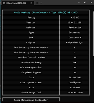

                            Hi I need BIOS ME Clean Plz Help Me.
                            lenovo thinkcentre M920q
                            Machine Type : 10RR
                            Model No : S05F00
                            S/N : MJ09P7T2
                            Product ID : 10RRS05F00
                            Device Status : No Power

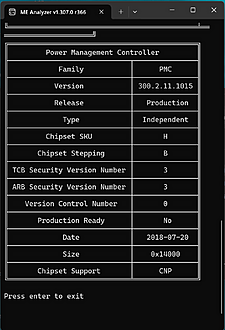

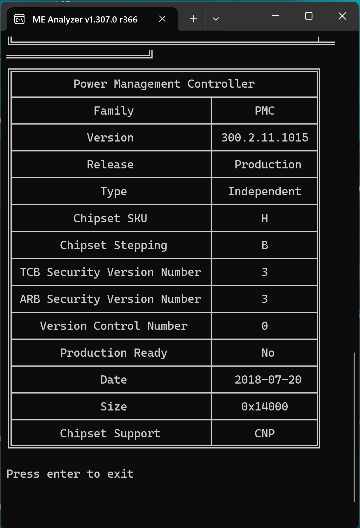

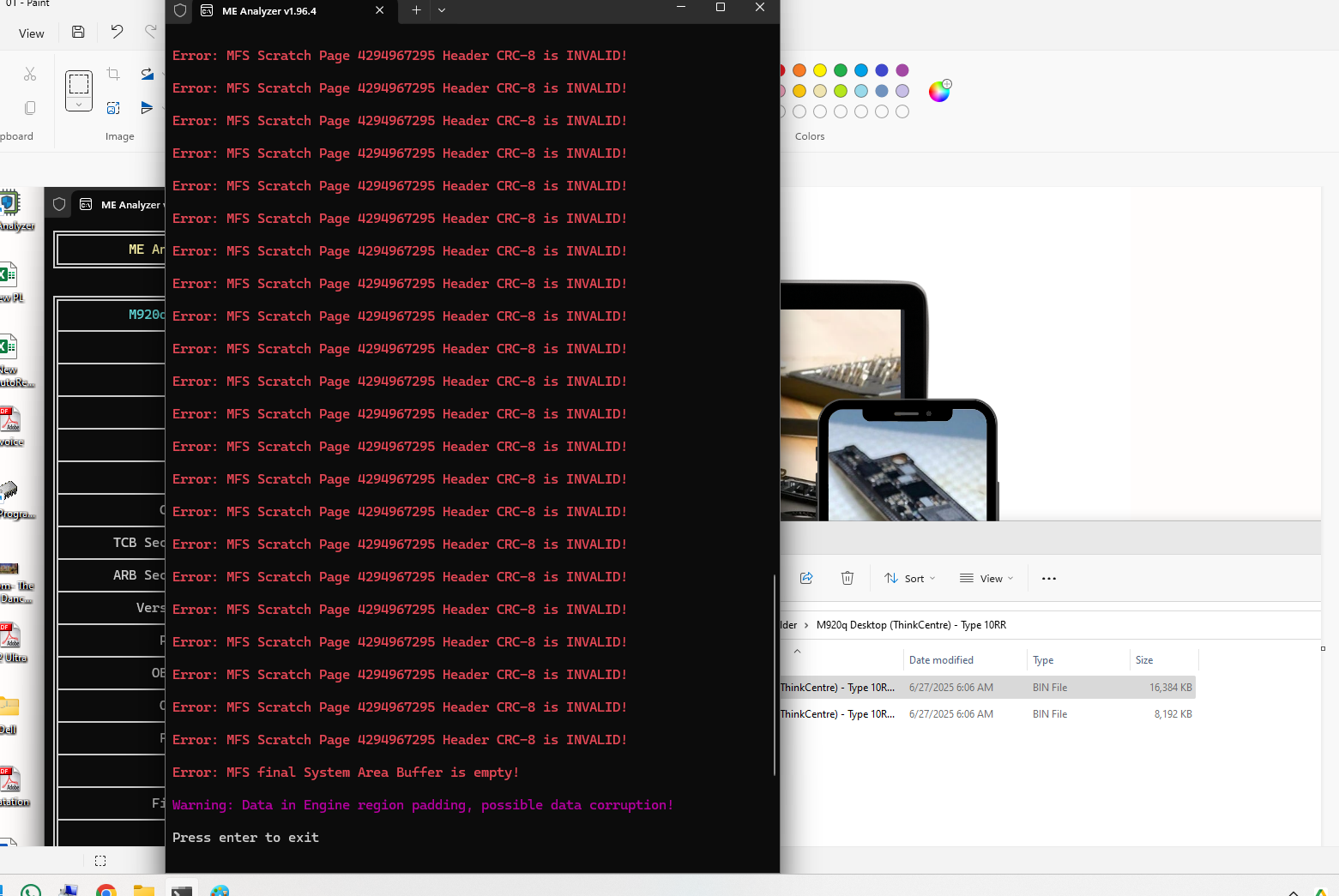

                                #35
                                Originally posted by hoaca388
                                M920q Desktop (ThinkCentre) - Type 10RR
                                thank you for help. but shared file are error attched screenshot
                                • hoaca388
                                  Badcaps
                                  • Jan 2022
                                  • 12330

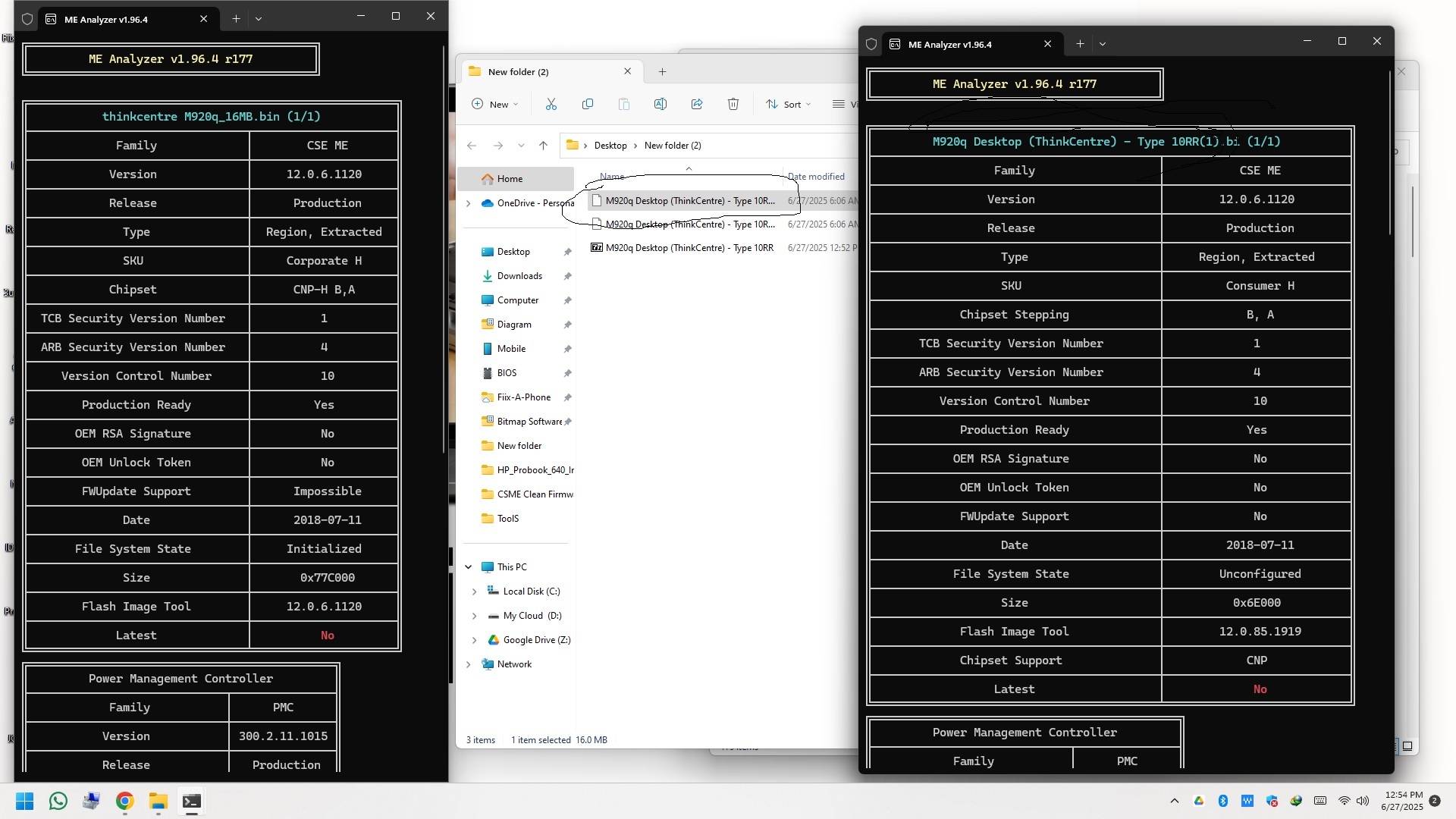

                                  #36
                                  Where is the error ?

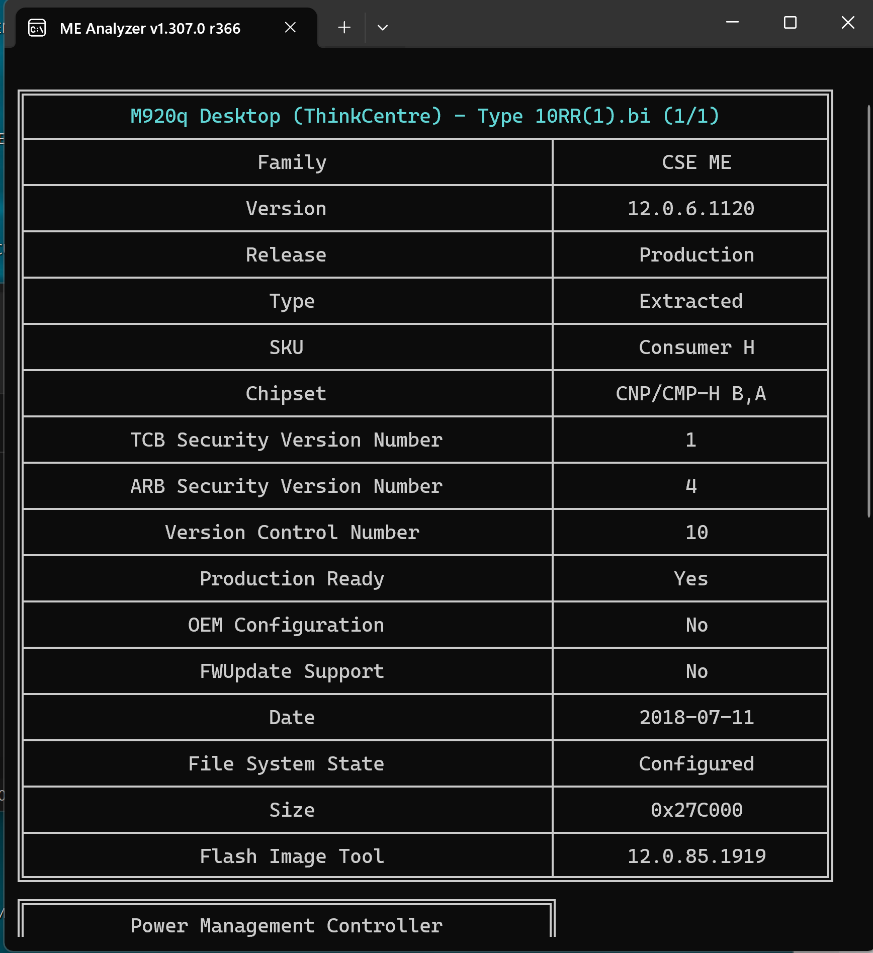

                                    #37
                                    o redownload and aganing checked with analizer same error ??
                                    • hoaca388
                                      Badcaps
                                      • Jan 2022
                                      • 12330

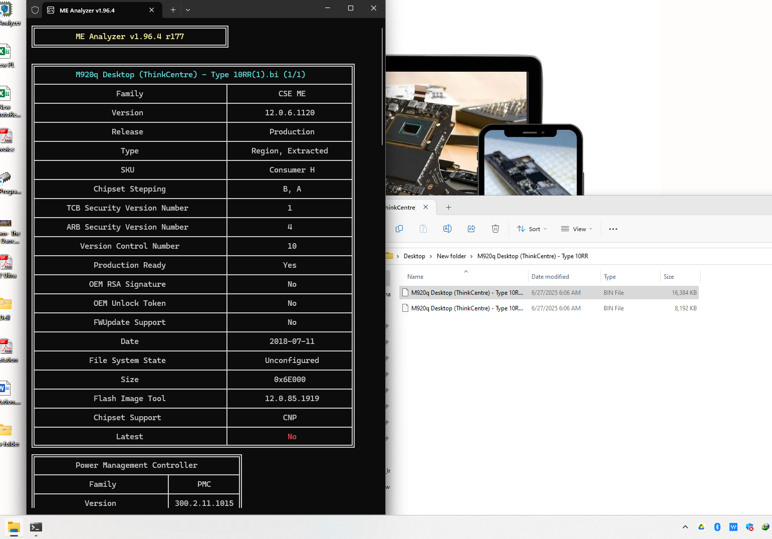

                                      #38
                                      You have not joined the two files.
                                      16 + 8

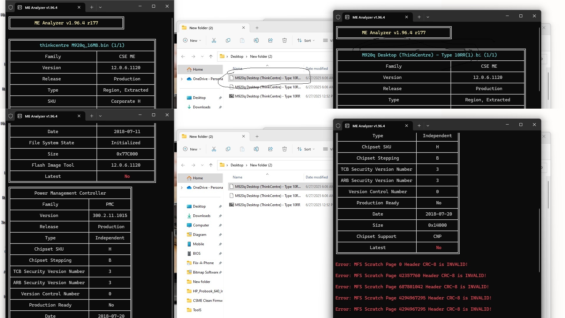

                                      • prasath_max
                                        Technician
                                        • Feb 2020
                                        • 33
                                        • Sri Lanka
                                        #39
                                        16 + 8
                                        how can joint it. becaset this bios have separate chips
