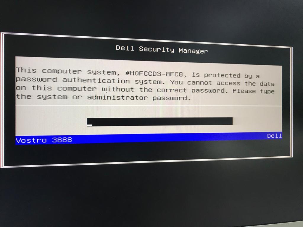

    Hello
    Please help me
    remove dell bios password
    service tag H0FCCD3

    Unlocked

        Thanks bro its working

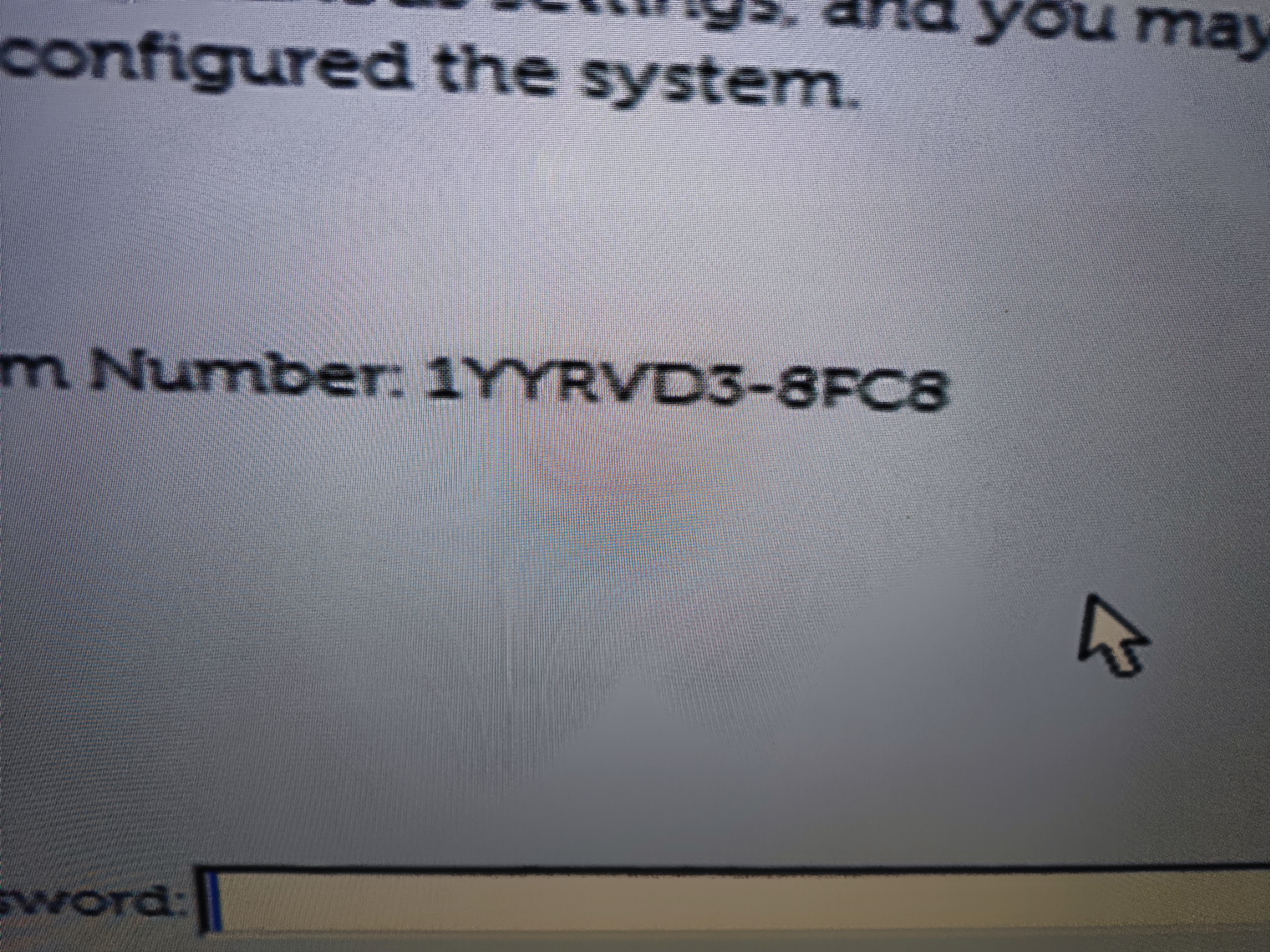

                                      Hello, i need a help a bios password.
                                      service number: 1YYRVD3-8FC8
