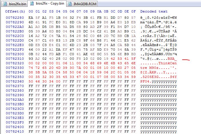

    Good day all
    i have a lenovo m90z that shutsdown every 30min, i have tried flashing a clean bios but , there is no change ,Please any advice will be appreciated

    Its probably an management engine firmware issue,the firmware needs cleaning https://www.badcaps.net/forum/showpo...41&postcount=3

      Re: lenovo AIO M90z 30min auto shutdown
      i tried cleaning today, it stopped shutting down after 30min, but the fan is still running at fullspeed, and if i shut the machine for 30mins, then it wont post, unless i reprogram the bios chip.....Thanks for your time
          Originally posted by teknikbursa
          pls send your original bios.
          thanks, i started having this problem since 2019, and i ended up loosing my original bin file.... but i downloaded the bin that i have uploaded,..... its the one that has fixed the 30min shutting down, but the fan is running at fool speed, and if i switch off the machine for some time then it wont boot on the screen........
            and the orignal serial number is S4YPF04, the one inn the bin belongs to the machine the bin was extracted from

              Try this one.The ME FW is cleaned,plus your serial number added using a hex editor.
              You can also edit the serial and other info using wflash2.exe with command line options. To get wflash2.exe download the bios update and extract the exe using winrar or 7-zip ,and read the readme.txt file
              9BKT42A https://download.lenovo.com/ibmdl/pu.../9bjy42usa.exe
