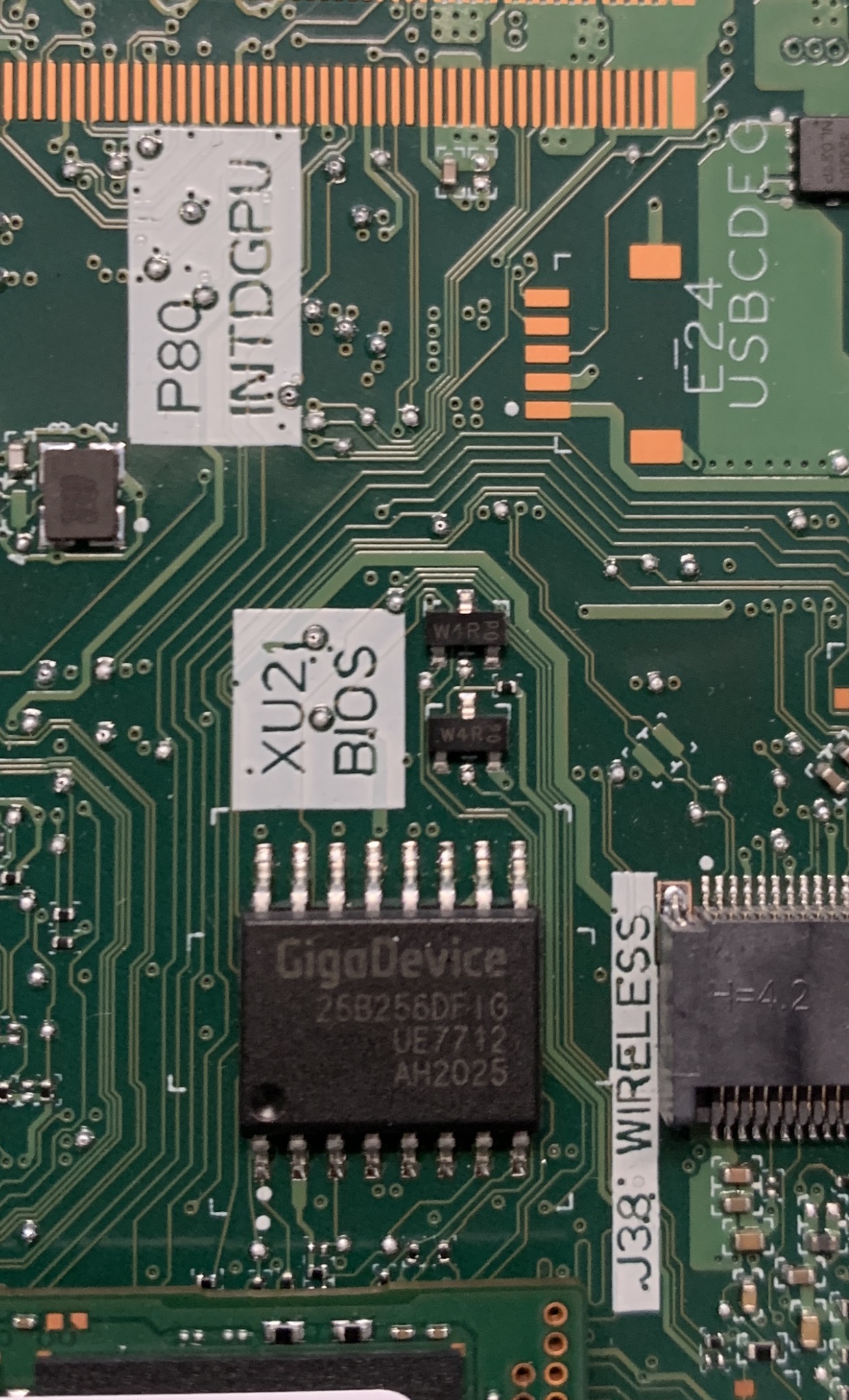

                            Are you by any chance aware of what exact chip it runs?
                            I made a picture of the chip, but can't find a lot about it.
                              The Product No. of the 400 G6 I got is a 1C6Y8EA#ABH.
                              From its number it should be (256Mbit/32MB, 3.3v). If your programmer can't detect it, you can choose "GD25Q256" and see if that will help or not.

                                #35
                                Re: HP ProDesk 400 G6 Small Form Factor PC bios
                                So I just finished extracting the data.
                                Any chance you can have a look at it?
                                I have a spare 400 G6 But with slightly different mobo chip.
                                Any idea It's wise to copy it from the working (bios chip) one to the non-functional 400 g6?
                                Edit:
                                Check the other motherboard.
                                Both chips are the GigaDevice 25B256DF1G.
                                Only difference:
                                Non functional has the UE7712 / AH2025 under it and the functional one has UHK914 / AJ2204.

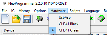

                                        Why you didn't use the same Programmer that you have already used to read the file from post #35?
                                        I think if you want to use "CH341A v1.7", you will need to choose "CH341 Green" in NeoProgrammer.
                                          After reading I had realized I had the CH341a version with the 5volt issue.
                                          Sadly the iron failed during soldering.
                                          I just finished writing the .bin you had provided but the mobo indicates a invalid firmware with 5 long beeps and 2 short.
