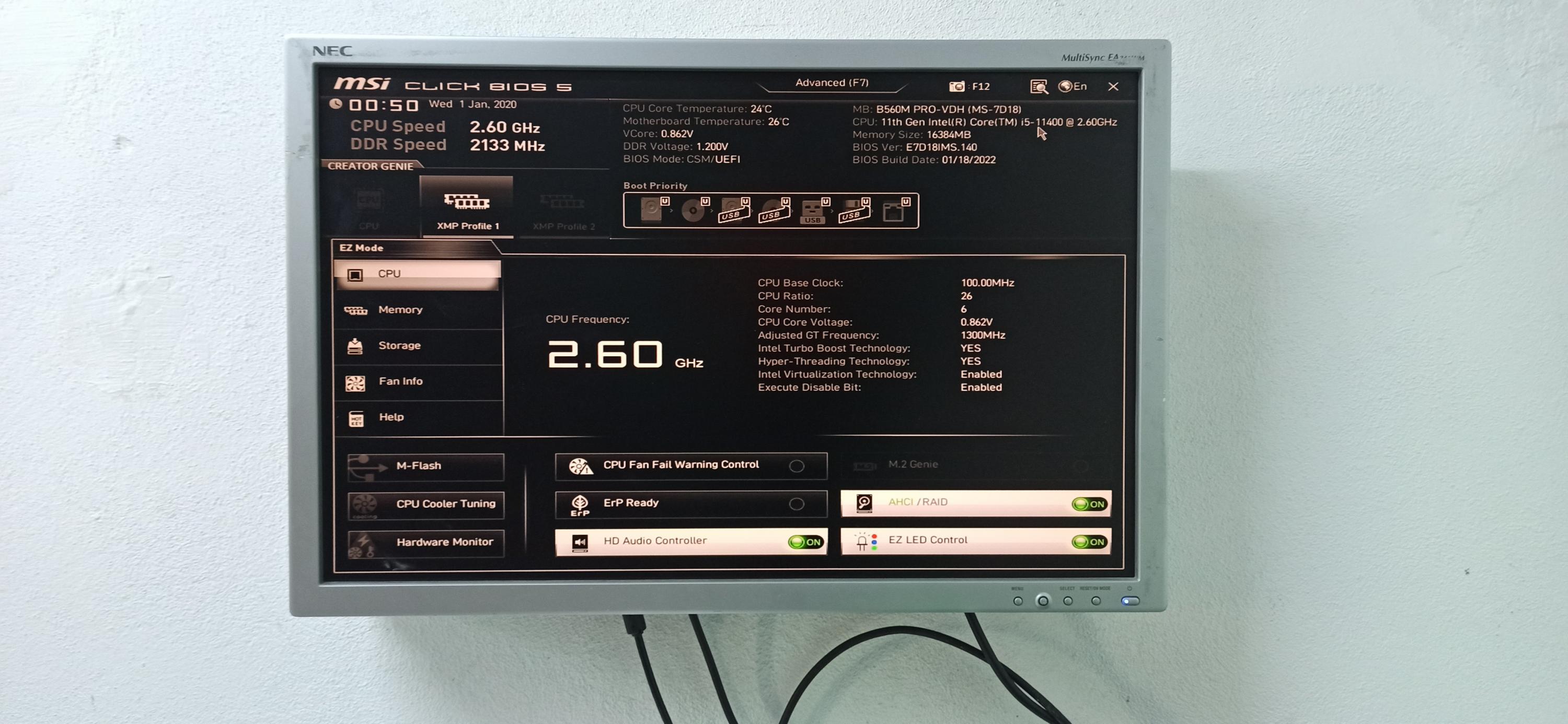

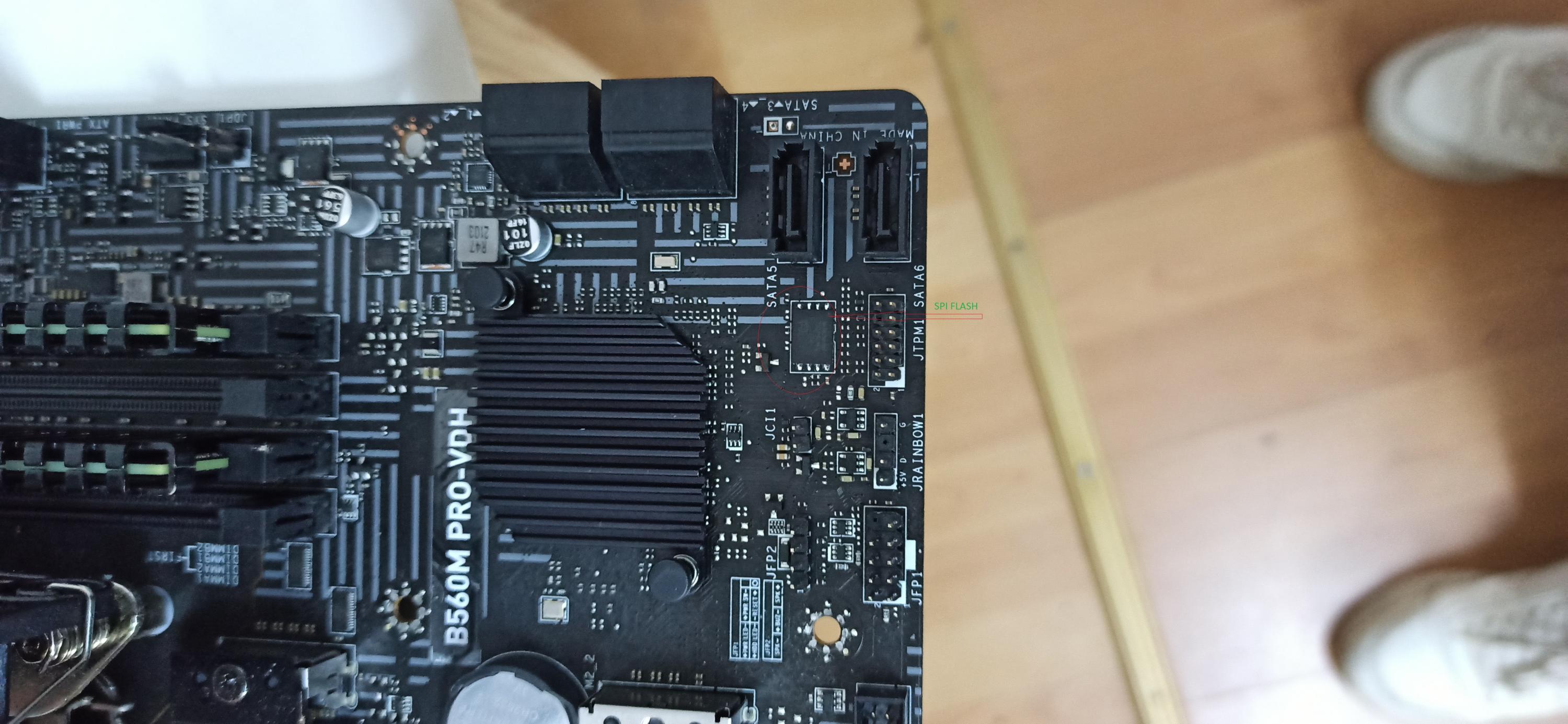

    Hi everyone, I received on my desk one MSI mainboard with an bricked bios.
    The owner tried to flash with a new version of the bios, but unfortunately the procedure failed.
    With the faulty bios, the motherboard started but did not display anything on the monitor and the Dram LED was always on.
    I made a backup of the faulty bios and rewrote it with one from the MSI site but the motherboard still doesn't start.
    I put the saved bios back in flash memory and the motherboard doesn't start with it either.
    Does anyone have a solution for this defect?
    I have attached the faulty flash memory backup.
    Thanks in advance.
  • viking6791
    • Aug 2018
    • 42
    • My Desk
    Re: MSI B560M PRO-VDH bios bricked
    I find my problem with this mainboard, the problem was that by putting back the memory with hot air the motherboard warmed up and I didn't let it cool down enough and in that area there is a southbridge and a temperature sensor.
    So the problem is solved the motherboard is functional again, see the attached pictures.
    The original bios were really corrupt, I put the latest version on the MSI site!
