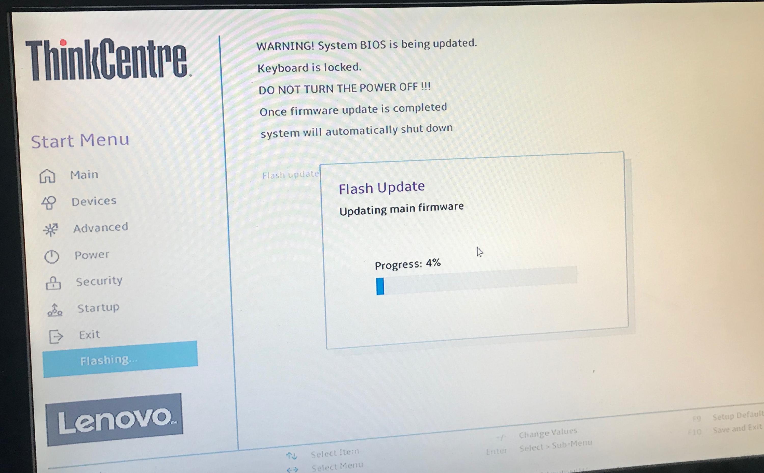

    Please help me with BIOS for ThinkCentre M70q Type 11DT.
    Desktop had a failure bios update and didn't start. I took a BIOS file from this forum with SVP (https://www.badcaps.net/forum/showth...highlight=m70q) which seems to be from a 11DU unit and after few minutes it did enter in flash mode with "cannot find or load image ROM file" error. I extracted BIOS files from lenovo site and put them into a USB drive. It started to flash bios and it took like 15mins to finish, after that I was able to enter in BIOS, make changes but the unit is running very slow. It seems it's a problem with ME firmware - version in BIOS is reported 0.0.0.0 - I tried to update ME firmware with version from lenovo site but I got an error "cannot locate ME device".
    I attached original BIOS file - I think is damaged - the BIOS file I used to start the unit, files I used to flash BIOS and some photos with errors I got, maybe someone can help me.
    Thank you in advance!

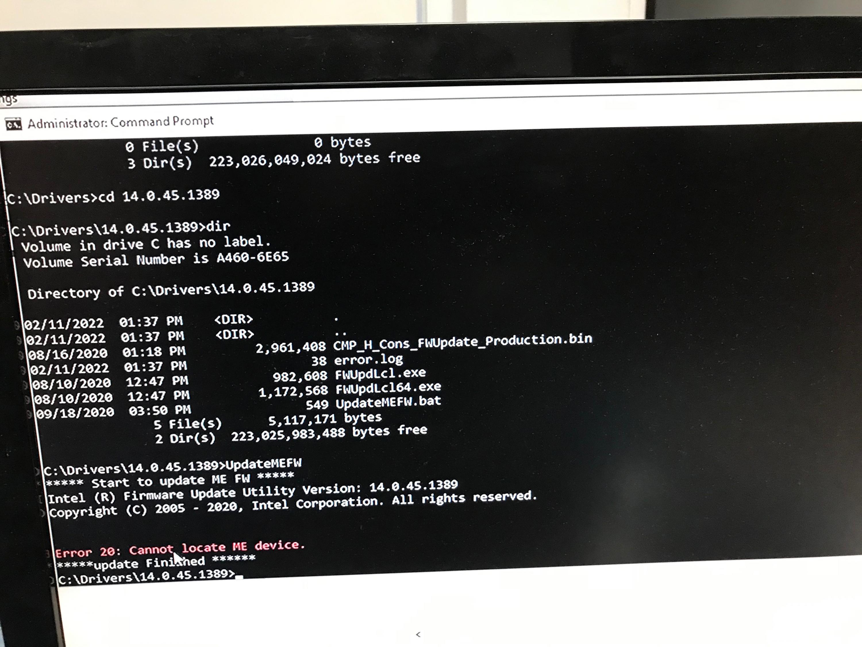

    Re: ThinkCentre M70q 11DT
    Here is the bios file reported by MEInfo "ME is disabled" . i did try with CSME System Tools v14.0.20+ to clean ME but it says it can't decompress the image. Maybe someone with more experience can tell me what i am doing wrong, thanks.
              Originally posted by zizoert
              clean ME Not work file error
              If unit starts, make a bios update. There is also a ME update on lenovo site.

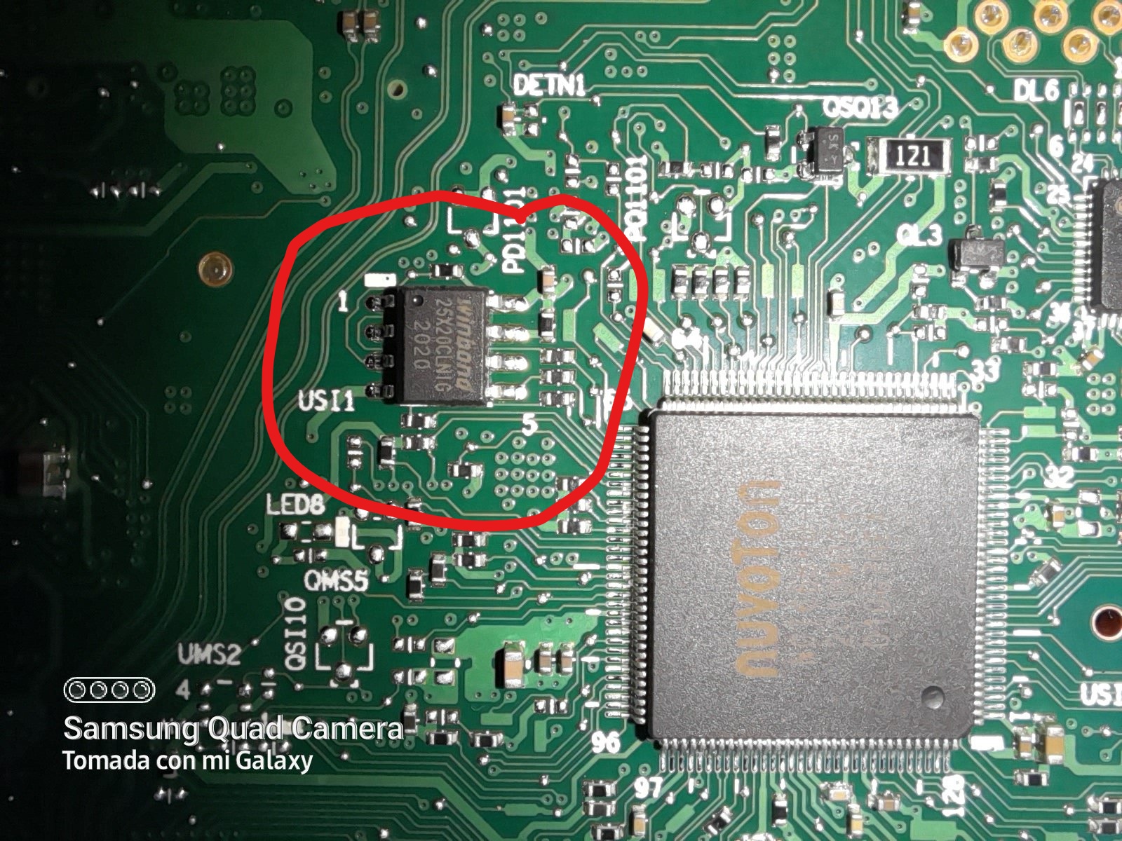

                  hello i want to help me how can i fix on the sop16/dip8
                  how to identify the pinouts when connecting the
                  sorri the lvds cable to the sop16/dip8

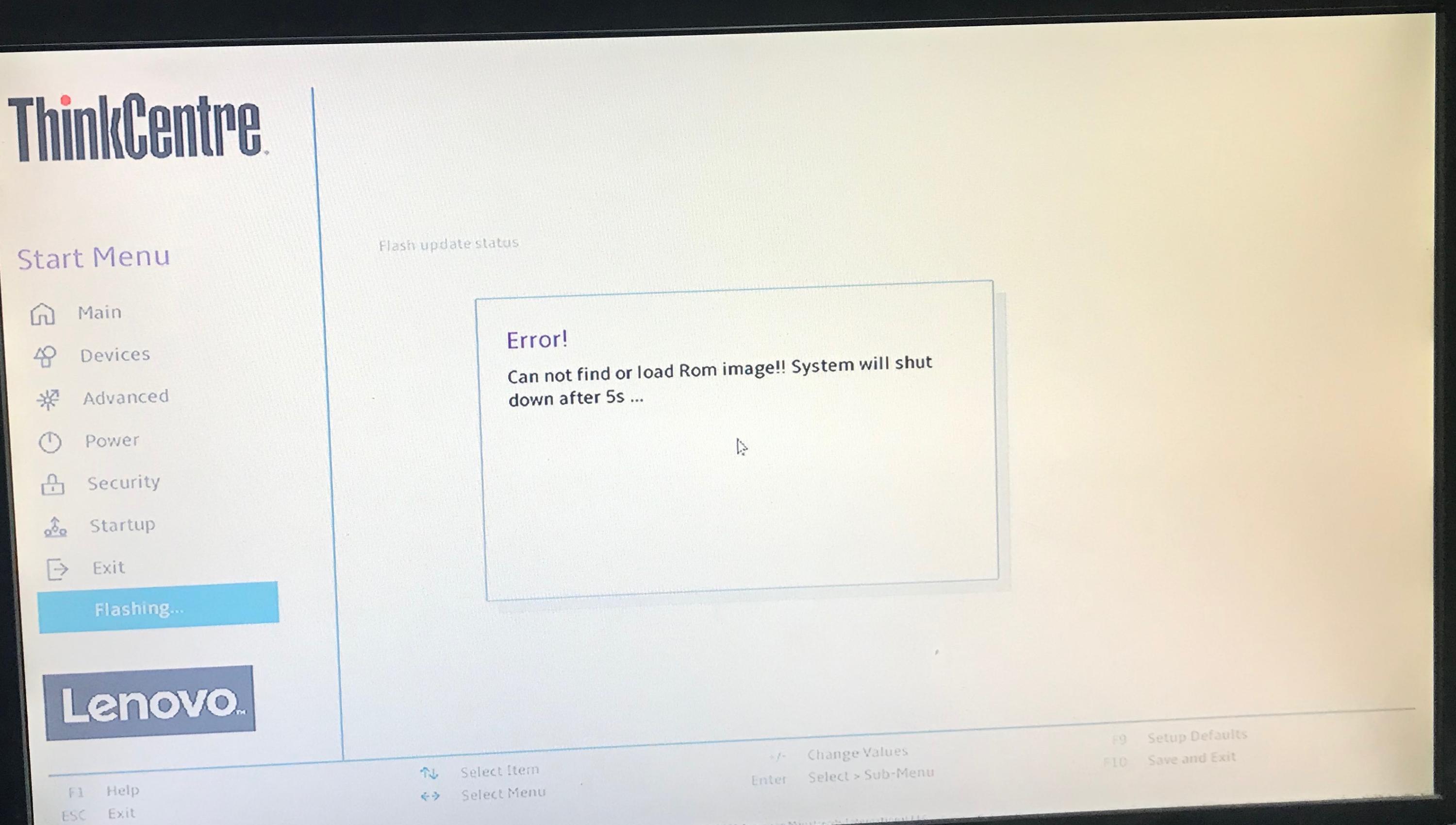

                            I have the same problem on my M70q Desktop (ThinkCentre) - Type 11DU. ME Firmware version in BIOS is report 0.0.0.0. Does anybody know how to solve this?
                            I am also having trouble shutting down my computer. I click turn off and the screen turns off but the red light and white light are still on.
                            When I try to update the BIOS using a UEFI BIOS update stick, I get the same error: Can not find or load ROM image!!
                            Who can help?
