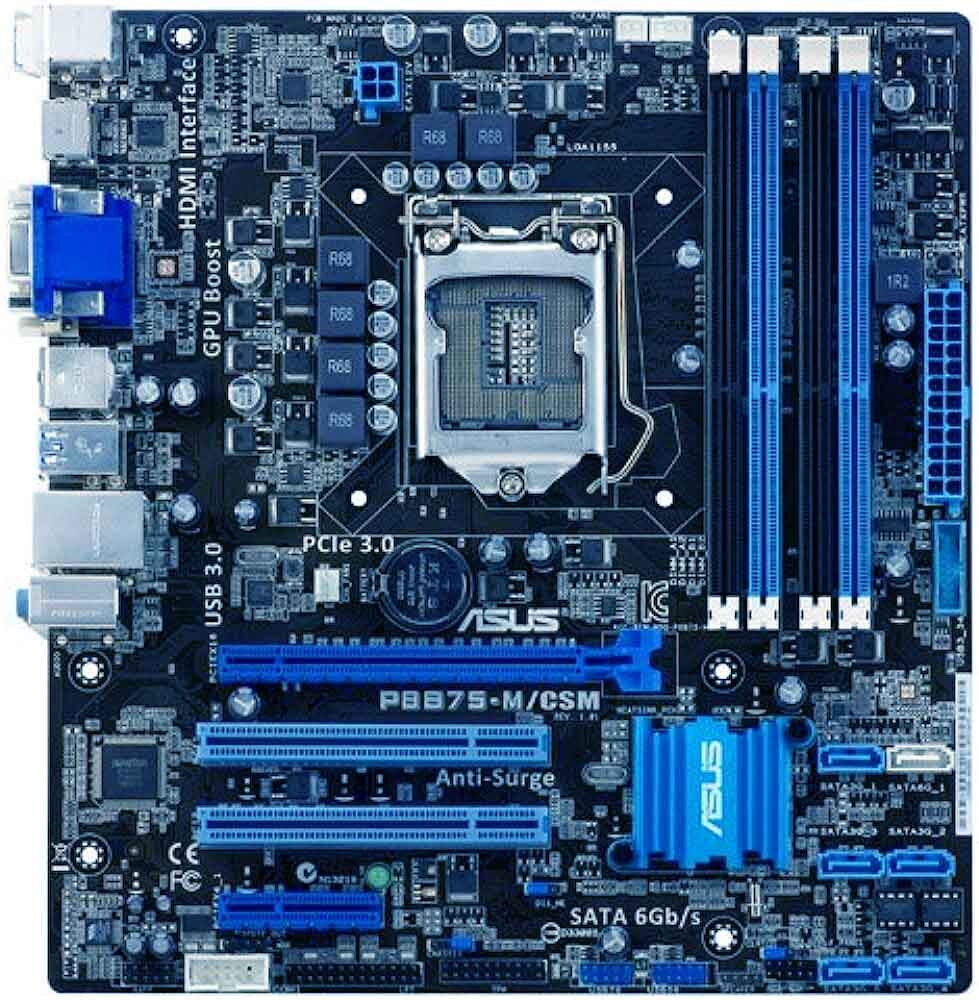

    Hi
    I have an ASUS P8B75-M/CSM and as you know it has two different flash chip the left one is bios and the right one is ME and Flash descriptor. The left one can be programmed with a file from asus website but i can't find the dump for the right chip at all.
    So i need a kind person to help me and send me the ME dump if it's not too much trouble.
    I have tried a dump from P8B75-m LX and it worked but it shows the temperature and voltages incorrect and i get a surge current message.
    thanks in advance

    Is there a dump from ASUS P8B75-M without "CSM" needed?

      post both backup copies (main + EC).

        Re: Asus p8b75-m/csm
        Thank you kindly for offering help so quickly.
        I just found the dump from a ASUS P8B75-M without "CSM" and it worked like a charm.
        I"ll share them here if anyone needs them in the future.
          Dear Friend you saved my MB! your dump is awesome. Ver 1701. Left is MAIN. Left - far from the edge of the mainboard. Right is the closes to the edge.

            hello i have bios issue after updating... i have a P8B75-M/CSM and after a update to bios it shows no display or functionality.I have a chip flasher (Ch341a) and need to know where my bios chips are so i can flash them! I did all steps on ez flash 2 and still got this error. If you know where the P8B75-M/CSM bios chips are, or how to fix this issue
              Can you read the part numbers on the top of the 2 chips at the bottom right, between the SATA connectors

                SMDFlea​ Hello yes thank you for helping me find the bios i was looking all over! The bios chip is a winbond 25Q64FVAIG. If you can help me rewrite it or show me how that would be amazing!! Thank you again!
