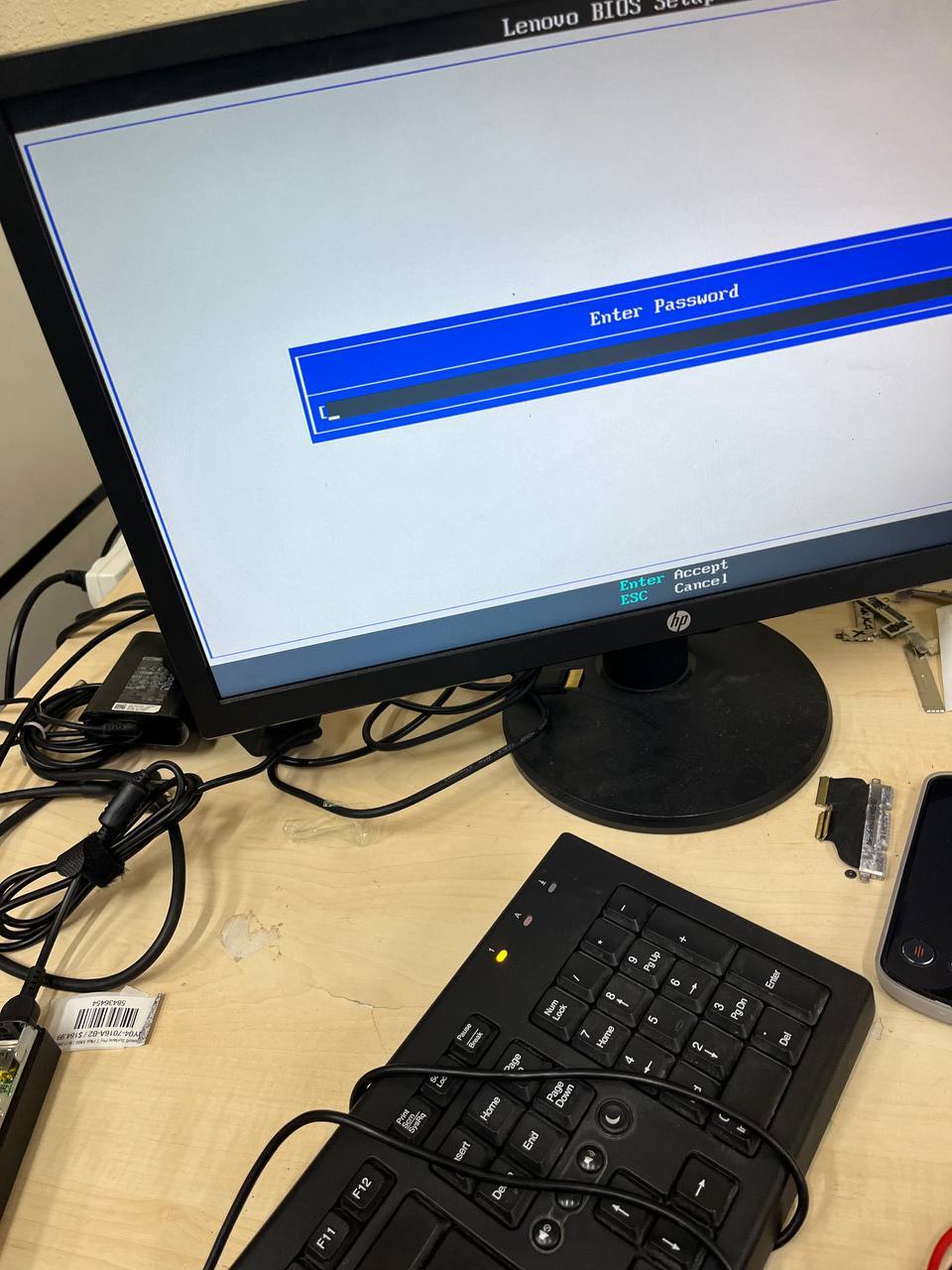

    Originally posted by nezumi
    The password protected devices are:
    S/N: PC0K9A58
    Lenovo M700 Desktop Tiny (ThinkCentre)
    Motherboard Model IS11X1H
    Type 10J0
    BIOS Chip MX25L12873F
    S/N: PC0K9A5Y
    Type 10J0
    S/N: PC0K9A61
    Type 10J0
    BIOS Chip 25Q128FVSQ
    S/N: PC0K9A6S
    Type 10J0
    S/N: PC0K9A77
    Type 10J0
    The unlocked one is:
    S/N: PC0K9A6Y
    Type 10J0
    After initially attempting to read and verify the files without success using the CH341A programmer ver 134, I was able to successfully read the BIOSes using the "CH341A v 1.31 free" tool, which appears to be a bit simpler but worked. Each BIOS file was read, verified, and saved twice (closing the program and unclipping the reader between each), and then the two saved files were compared to each other and confirmed identical.

          #45
          Originally posted by hoaca388
          Unlocked
          I flashed PC0KA977 with the provided BIOS (with the only difference being a zeroing out of 2 rows?), but it is still coming up with a request for the Administrator password to access the full BIOS.
          I had a go at flashing the already unlocked BIOS onto PC0KA977, and that worked without a problem. I was able to enter the BIOS without needing a password and has full access, so I'm assuming that the section that was changed wasn't the right password area?
