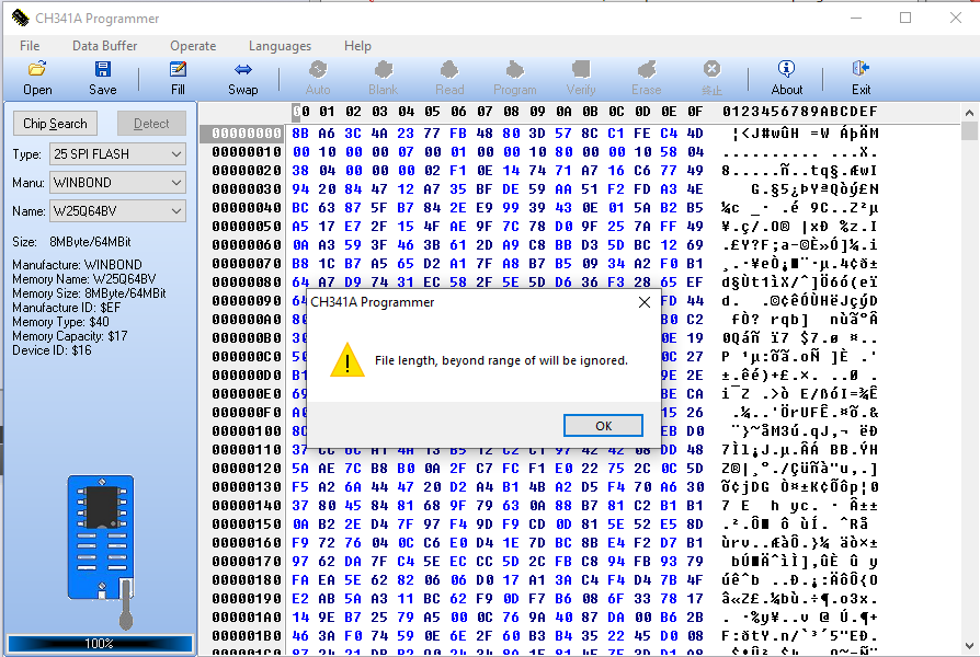

    Hello guys,
    I am struggling to find bios BIN file for ASROCK FM2A55M-VG3+
    When i download from official website, and put that in CH341A programmer software it says ''FILE LENGHT, BEYOND RANGE OR IT WILL BE IGNORED''
    That means that file i downloaded is larger than chip says, even tho chip is 8mb and file is 8mb

    the update on the official site is bigger..it must be entered in the HxD program and cut to the size of 8MB..try this ..
      thanks tested ok
        It works!

          Thanks a lot!
          It worked perfectly
          You saved my life
