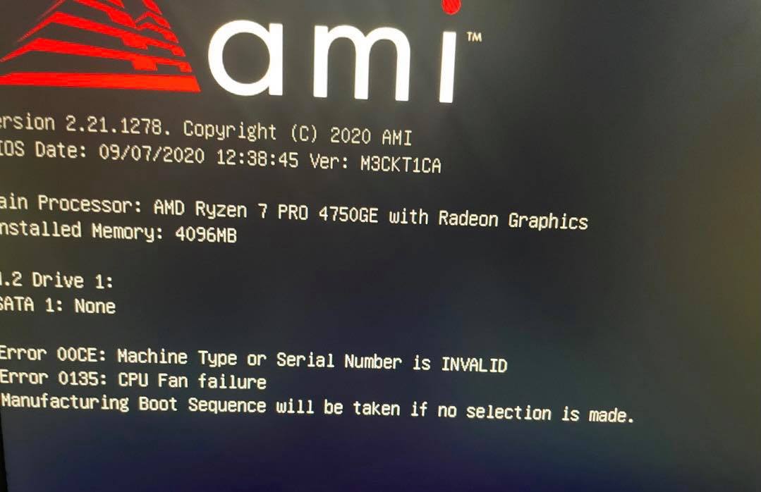

    Hi, some one can help me
    tiny PC Lenovo M75q gen 2 ( AM4IV Ver 1.0) mising serial number, after do upgrade bios give no display
    please help me fix this error! thank you all!

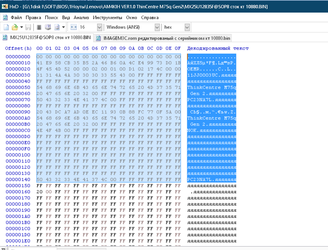

      Re: Lenovo M75q gen 2 bios No display need fix
      Hello. exactly the same error.
      BIOS, whichever is higher. did not help.
      here is my original bios.
      but on it. no picture.
      please help me to rearrange the serial numbers in the working bios above.
      thank you all!
      • shabbat
        • Nov 2021
        • 3
        • ukraine
        Thank you. already figured it out. in their editor, replace
