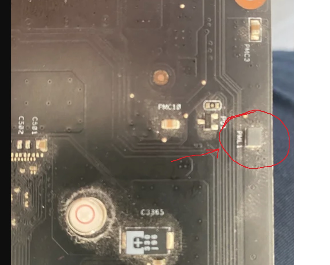

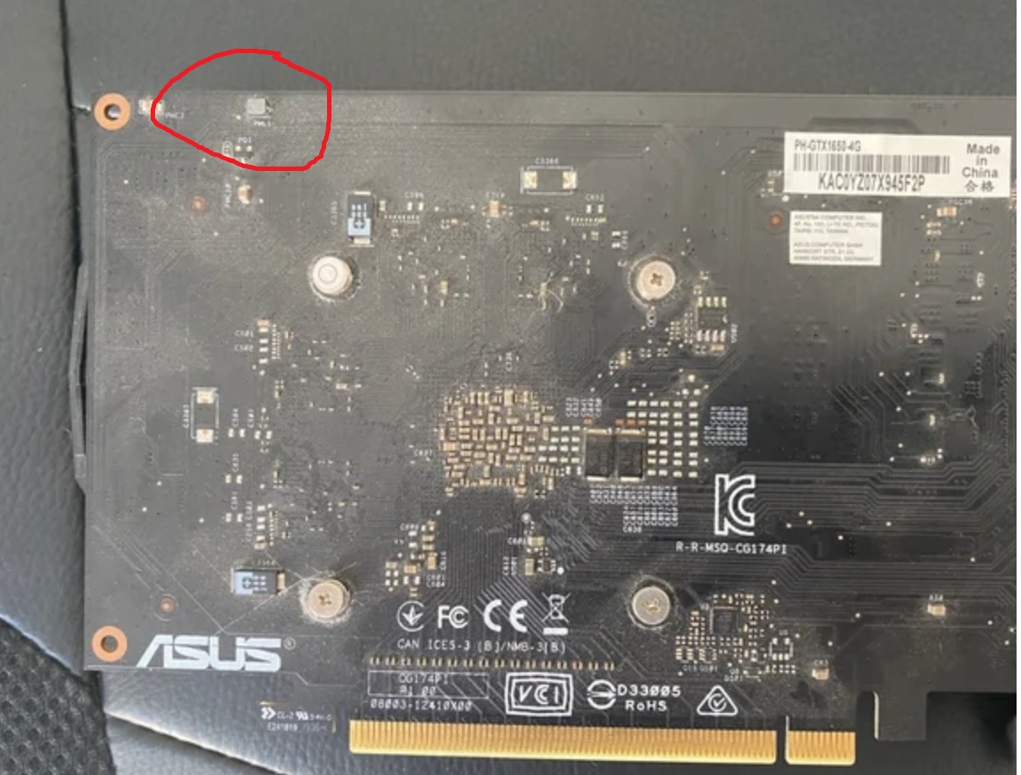

      Hello, I have an asus phoenix gtx 1650 4G without an external power connector that is missing a component, all the boardviews that I have found are with an external connector and do not have that missing component, someone would have the schematic or could tell me what component is the PML1, it may be an inductor but i'm not sure, Thanks
      Images are for reference
      PS: Thanks Nvidia for putting the component is such a well positioned site

          I don't have the boardview for that card, but from the name I assume it is an inductor that you are missing. My suggestion would be to measure if there is 12v at either end and if the other goes to the drain of some mosfet.
            Re: Graphics card Schematics and Boardviews
            Thanks for answering, because if it is a 12v line and it goes to a mosfet, I have been told that it is only a noise filter and putting an inductance of a high value would be worth it, any advice on the value?
              0.22uH should be fine. Given the rather odd location, I myself would replace it with a big ass 0 ohm resistor, but that's me being a degenerate sometimes. Don't know what others might think about that.

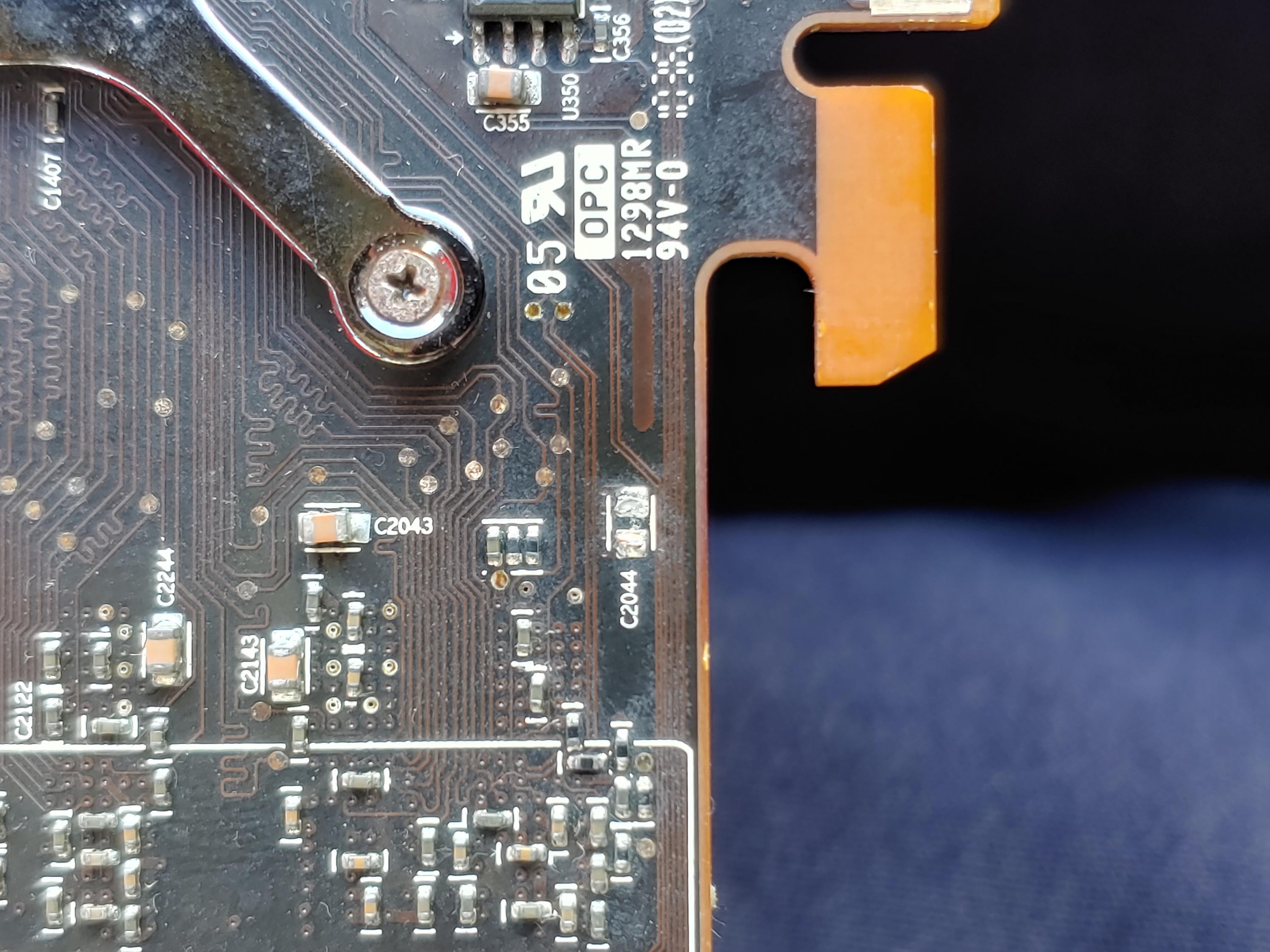

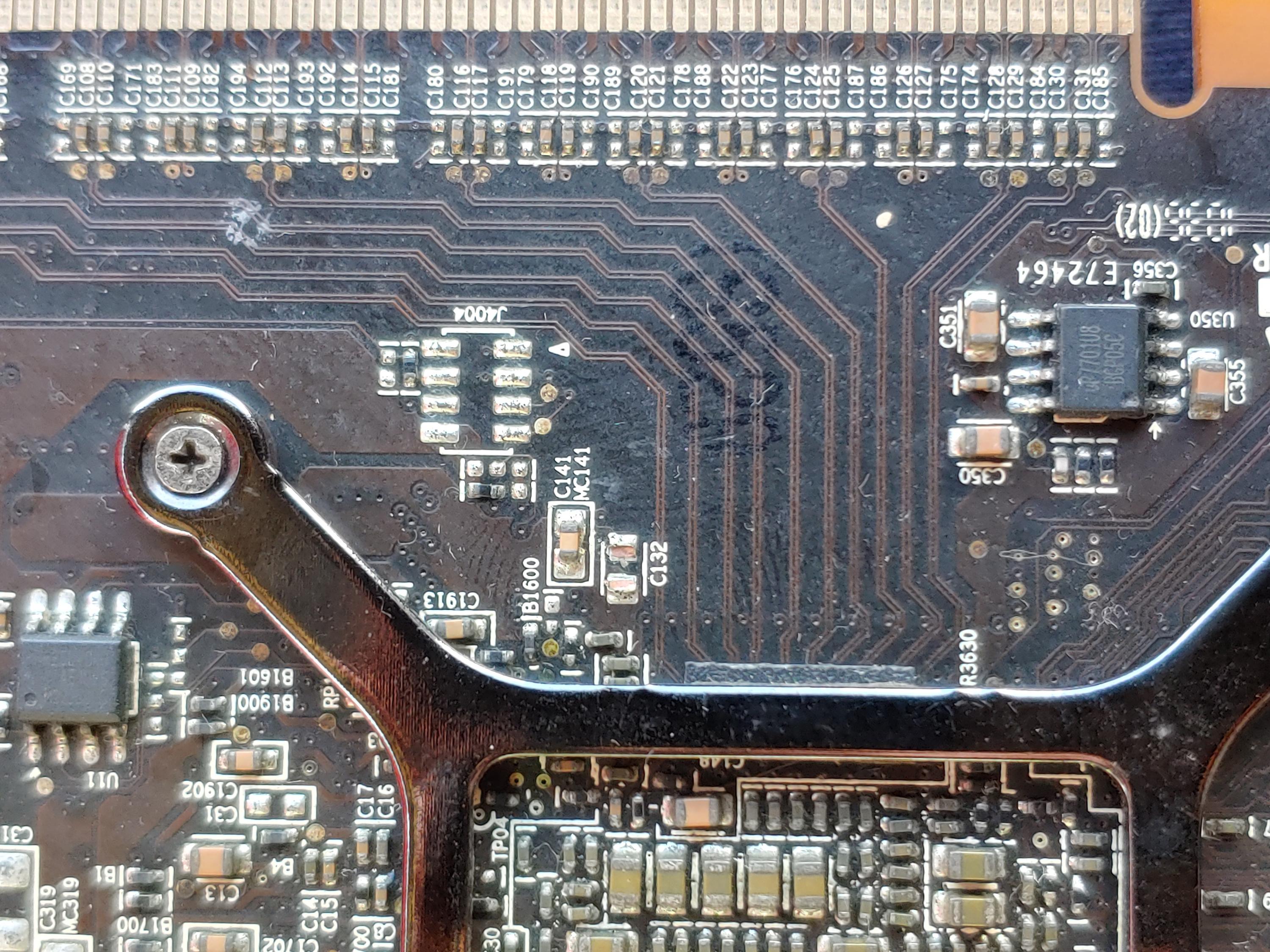

                Hello, Do anyone here have schematic for Sapphire Radeon HD 6870 1Gb. Can you please share it to me. I'm trying to fix my nephew's GPU but there are 2 missing capacitor C132 and C2044. Or if anyone knows the value of each capacitor any help is much appreciated. Thanks in advance
