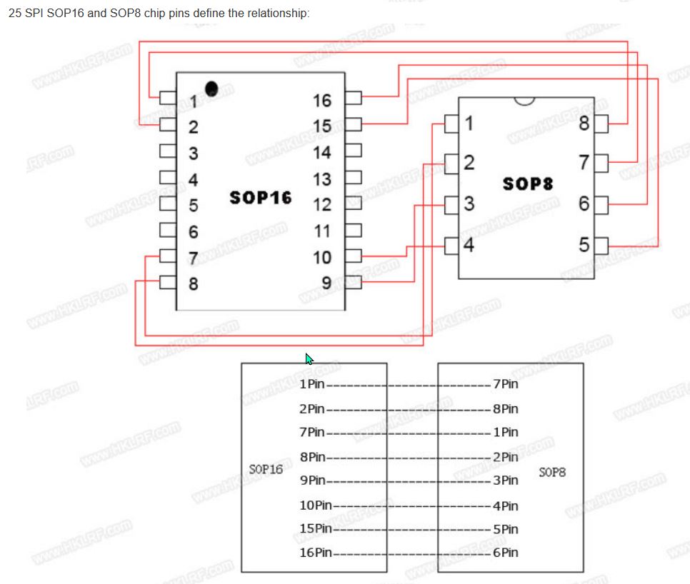

    I don´t know how to read it.
    I try but nothing happens.
    It have 16 pins and CH341a have 8 pins.
    Service tag is 9XL63Y2
    I tried other Chip with 8 pins on graphic card and it works with it.

      Re: dell optiplex 7060 bios bin need bios

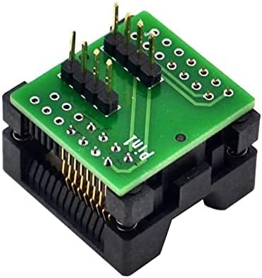

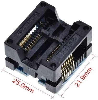

      You should have an adapter converting from 16Pins to 8Pins, 16 to 8 Clip or a small PCB with 16Pin Footprint for your IC Package.

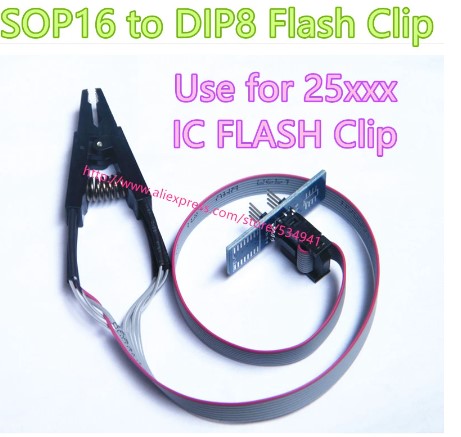

        I was searching and i dont have it.
        Will this work?
        I have to order it..
        In program for programmer (ch341a),there is no support for that chip
          Will this work?
          I can't see if the Clip have 16 Pins or not. Anyway, I don't prefer to use a Clip, you could face some problems with it.
          I will attach Images for the Adapter I meant.

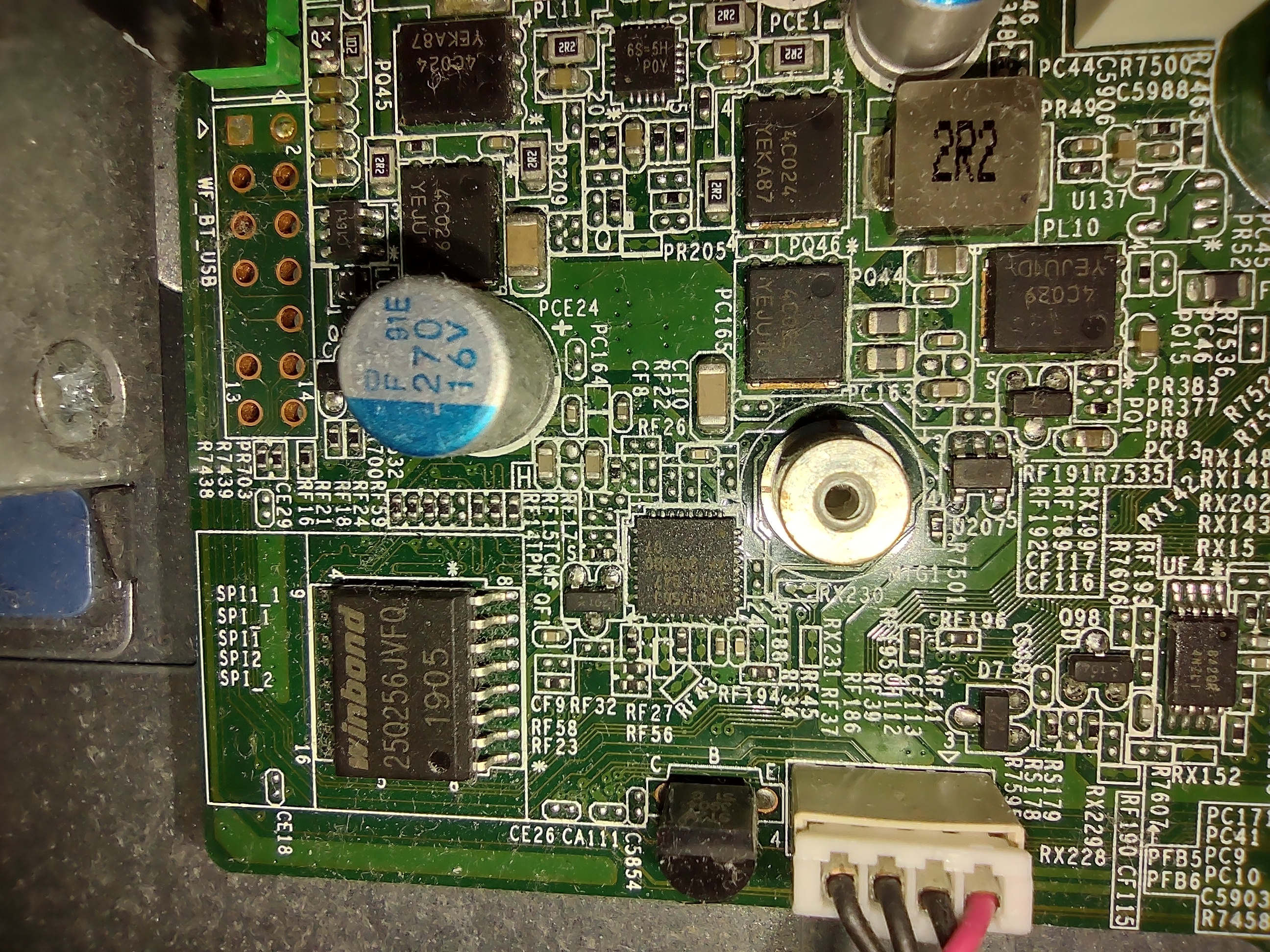

                              Hello, I need to recover bios on my Dell Optiplex 7060 SFF after unsuccessfull bios upgrade caused by power outage. Can you advice me what I will need to flash it ? As I understand I will need IC SOP16 cable and CH341A USB programmer. Are they all the same or do I have to buy specific one ? I found EEPROM programmer with USB MX25L6405 version 2 from local reseller. Can I use bios from this thread ( Dell OptiPlex 7060 (V_1.24.0).rar) or do I need Service TAG specific BIOS ? What Software will I need ?
                              • DUGi
                                • Jun 2023
                                • 4
                                • Slovakia
                                #35
                                Update: Chip is Winbond 25Q256JVFQ 1905 16 pin, Machine Service TAG H4Q1GV2

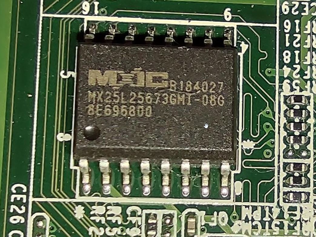

                                  Hello, Actually chip on faulty motherboard is MX25L25673GMI-08G

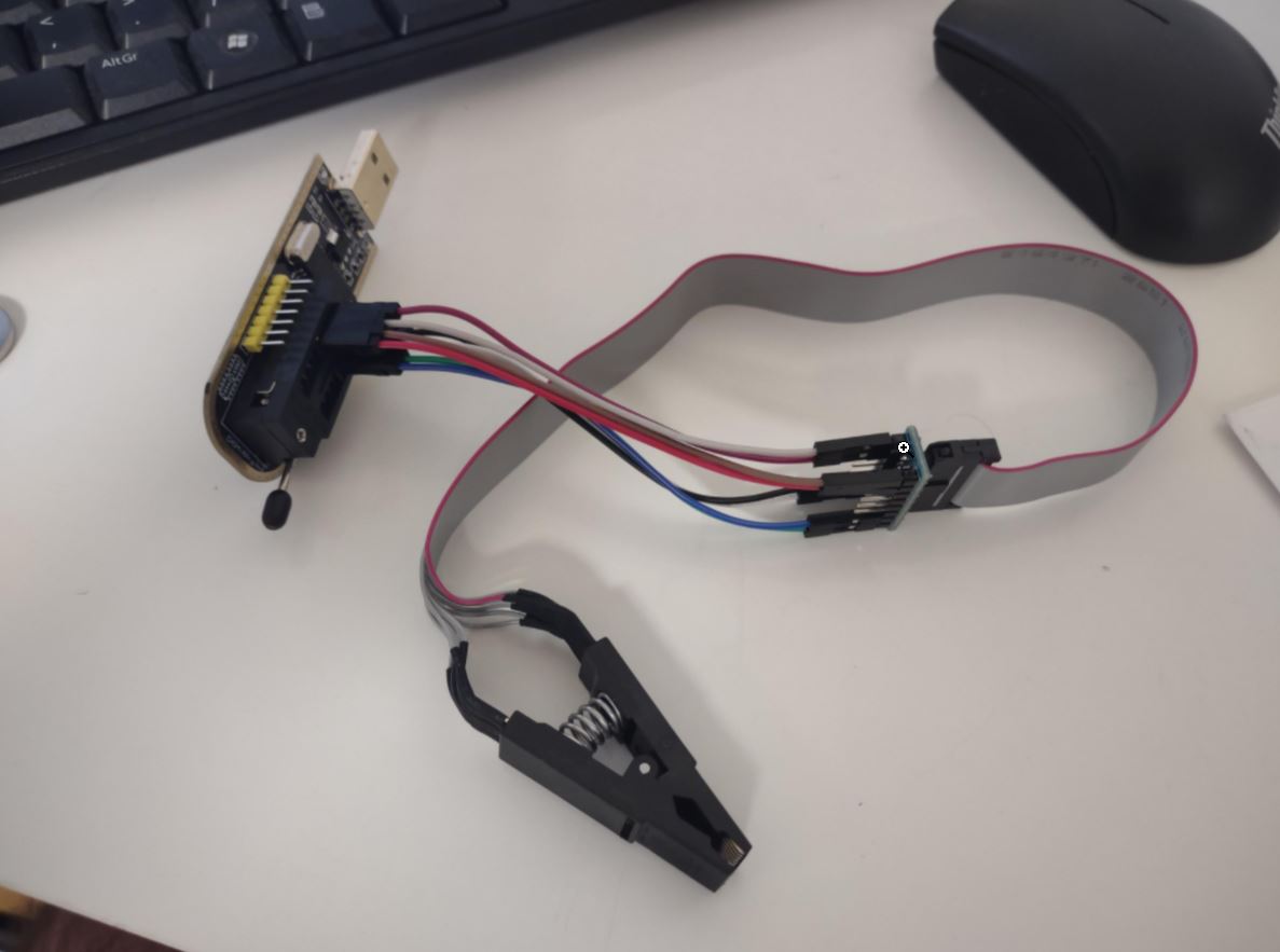

                                  I finally put everything together, CH341A programmer, SOP16 clip which I rewired to 8pin using diagram on the picture.
                                  I disconnected everything from motherboard except CPU, connected clip to the chip.
                                  Installed drivers and run NeoProgrammer 2.2.0.3.
                                  But software is unable to detect chip.
                                  What I'm doing wrong ?
                                  Do I have to remove CPU as well ?
                                  Do I have to power up PSU ?
                                  If clip is disconnected from Motherboard when I plug the power cord, PC is staring up beeping.
                                  When Clip is connected it not starting after plugging the power cord.
                                  If I have to power up PSU is it just short green and black wire from it ?

                                    I did a progress by modifying programmer to 3.3V by lifting pin28, soldered a wire between the power pin 28 and the output of the 3.3 V regulator as well as pin 9 of the CH341. I noticed more variations of that "conversion". which one is correct ?
                                    I'm able now identify the chip and read the data from it. BUT when I write to the chip verification is failing and data are not written correctly.
                                    I tried to use different USB 3 ports, powered USB3 hub etc. Without luck.
                                    Any ideas ?

                                      #38
                                      Any ideas ?
                                      When I was doing this for the first time I also had issues - I removed the 3.3v mod from the programmer and all my reading/writing issues disappeared - It was on this particular chip too so without the mod it won't do any damage.
                                      Also the chip clips can be unreliable, de-soldering is more reliable if you are handy with an iron.
