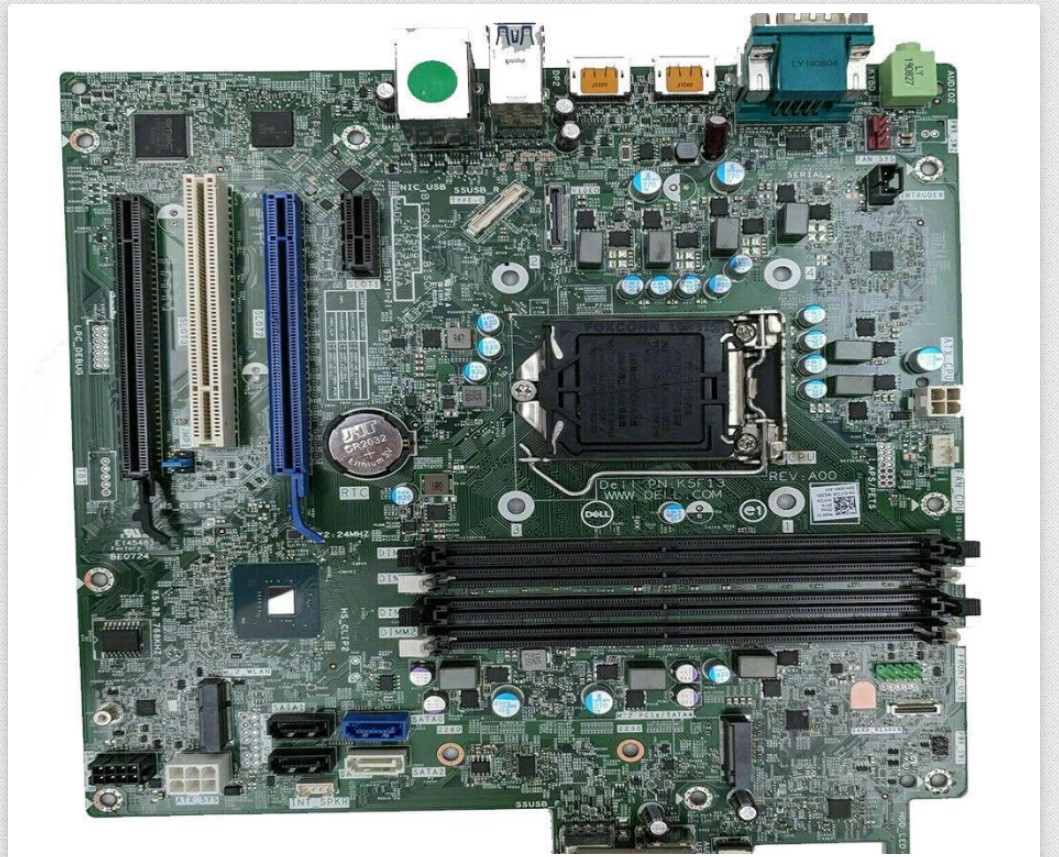

                          Re: dell optiplex 7060 bios bin need bios
                          Hi!
                          I have problem with interrupt bios on 7060 optiplex and can´t get in recovery screen with Ctrl + Esc.
                          I have programmer CH341A ,but can´t find location of bios chip on motherboard..
                          Any help
                          • hardware1
                            • Sep 2021
                            • 2948
                            • N/A
                            Originally posted by Spori
                            Hi!
                            Any help
                            BIOS Chip could be in WSON Package or SOIC Package, search for photos and see which one you have on your Board.
                            all donations are welcome,
                            • Spori
                              • Mar 2023
                              • 6
                              • Hrvatska
                              [url]https://p****************
                              This is picture of mobo..Im really not sure and i can´t fins shematics which bios chip is.
                              Very small/bad logos on upper side.
                              If anyone knows ,please circle it

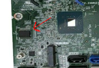

                                  This mobo
                                  Which one is bios?
                                  • hardware1
                                    • Sep 2021
                                    • 2948
                                    • N/A
                                    This mobo
                                    Which one is bios?
                                    It could be this 16-Pins Chip, take a clear image for it, need to see what's written on it.

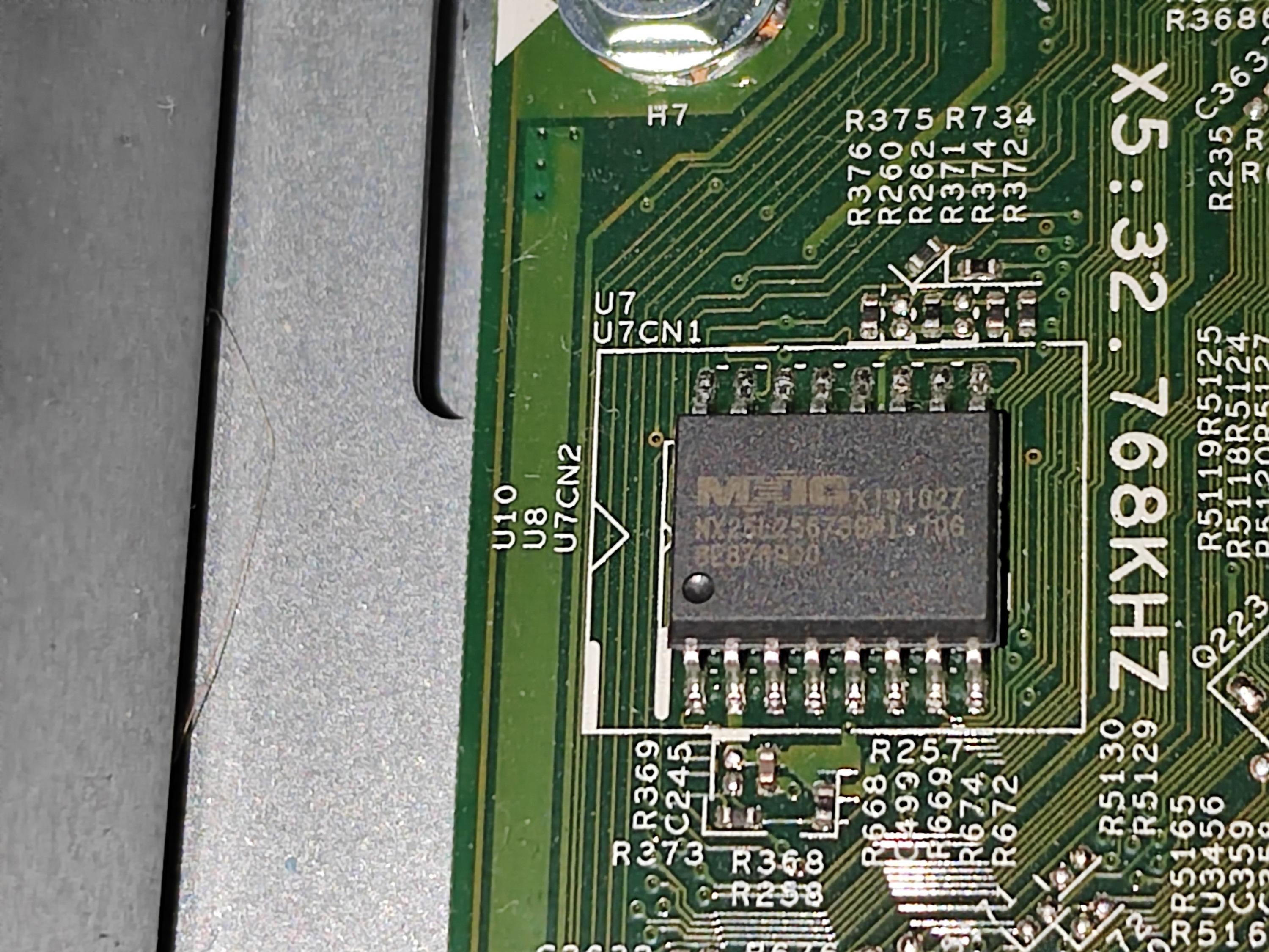

                                      This is the best i could
                                      • hardware1
                                        • Sep 2021
                                        • 2948
                                        • N/A
                                        It's the Correct Chip. You need to read this Chip and upload it's content here.
                                        Also write your Service Tag.
