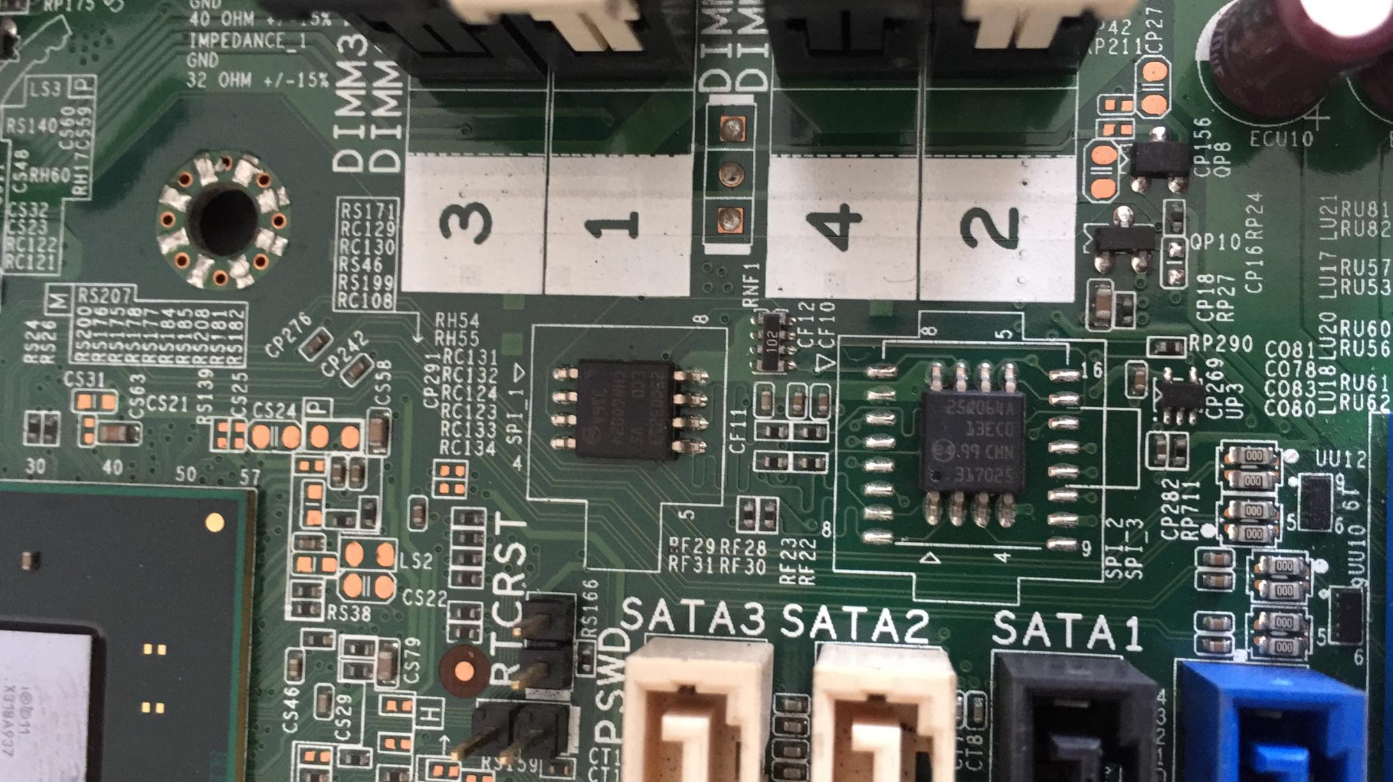

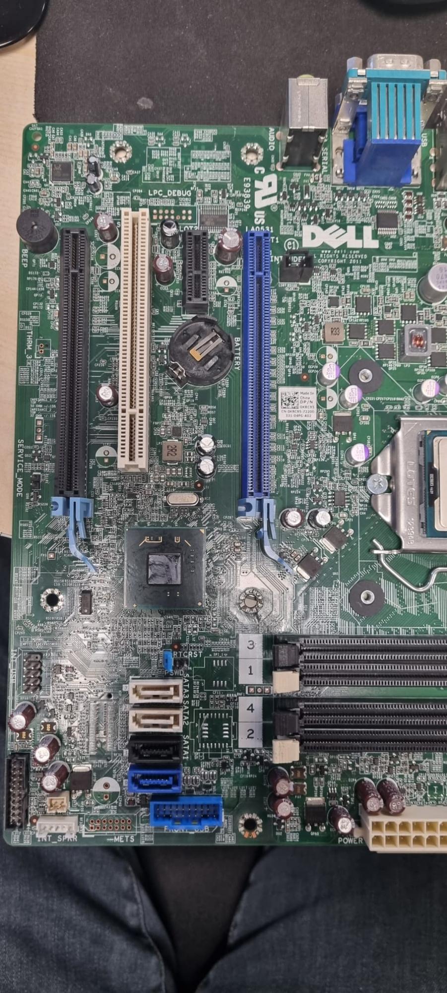

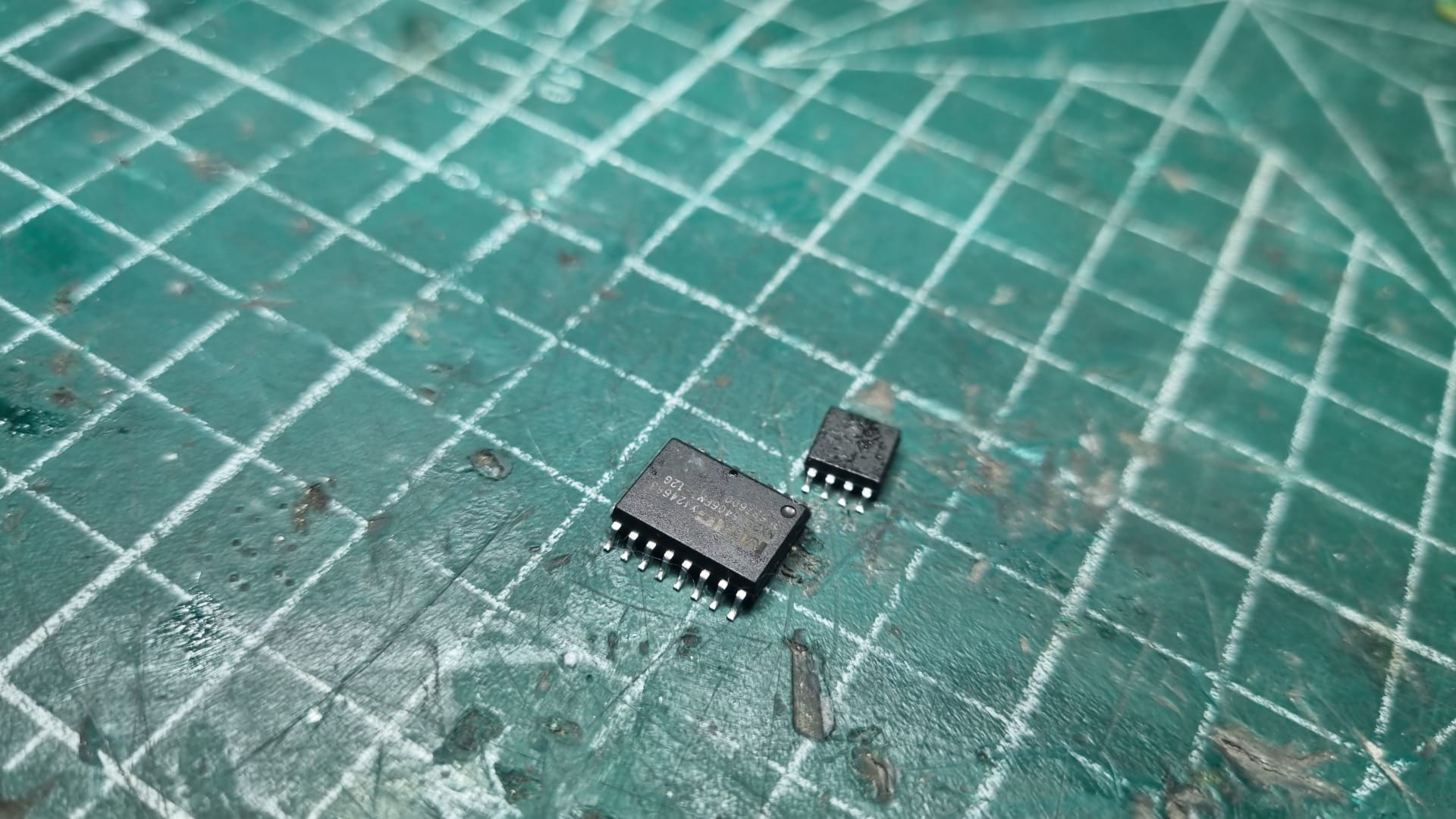

    Im trying to program the bios chip, it my first time.
    My big friend from Romania is helping me as well, but we need some clarity along the way, i have 2 bin files, 8mb file and 4mb file
    Dell Optiplex 7010
    Kindly assist and with a working dump files
    And the board has 2 bios chip, which one we need to program?
    Kindly see attached photos

    Flash both. I found a post with some dumps using the forum search...
    https://www.badcaps.net/forum/showthread.php?t=80895
    Backup both chips before programming the new dumps.

      One chips is 128kb/1mb and the other one is 8mb/64mb
      I have 2 dump files, 8mb and 4mb
      Kindly advise

            i have same board.. does any one have working bios???
              Re: Optiplex 7010 Bios dump files help
              Did you take any time to read this thread... ,at post #2 there`s a link to another thread with a confirmed working bios,there`s also post #5 in this thread. Make backups and try them.If you have already tried them then say so,we don`t know what youve tried and what you havn`t.
                yes sir i have tried all the files in this post and another post also..
                Post #2 bios power on the board but 1-3-2 beep with no display and amber (orange) light blinking
                Post#5 bios power on but no display (power on button/ white light)
                  I have the same issue too. This is probably a bad motherboard and not a BIOS related the issue.
