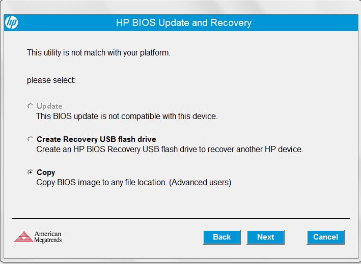

    Hi all. I'm looking for bios file for HP All in One.
    Model: HP Pav 23-q105na All in One
    Motherboard: dan61amb6f0
    Thank you.

    Anyway,there are 3 different bios on the support page, ROM Family SSID 2B43, 2B44 and 2B45 .
    Download the 3 bios, run the exe ,select copy and save the full 8MB bios.Backup your bios first.

      Re: HP Pav 23-q105na All in One bios
      Thank you for your help but I need a full dump as computer has no image and system won't load up.
        You will get the full 8MB bios as described above .
          Yes, there is 8MB file. Unfortunately after bios chip flash LCD has still no display. Any ideas where to look for a fault. Tried new CPU and new bios. Computer powers up but there is no display.
            Did you make a bios backup , and try all 3 bios 2B43, 2B44 and 2B45
