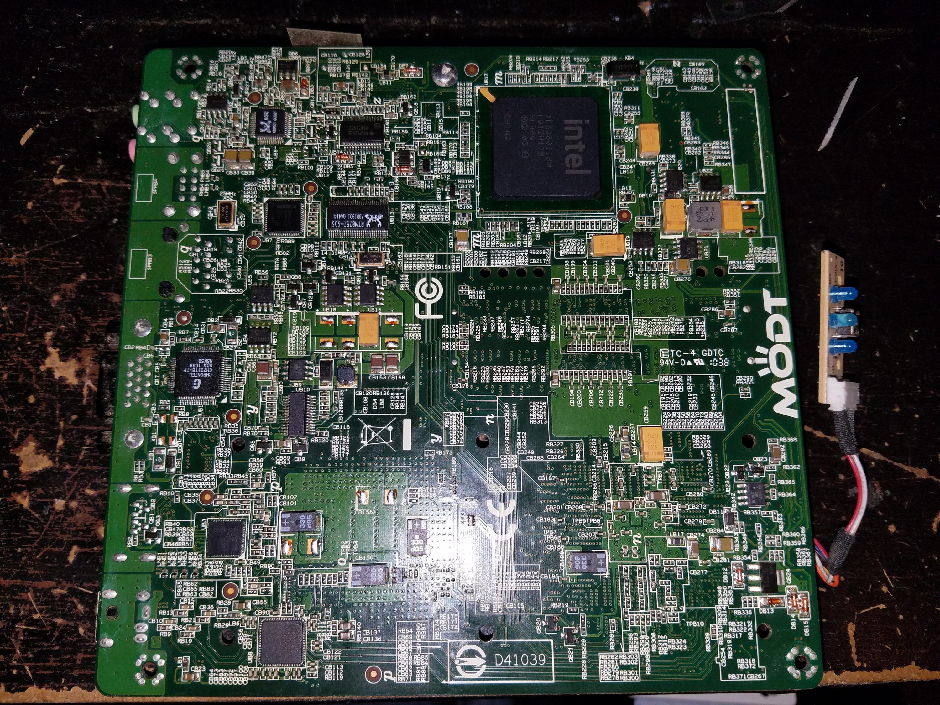

    Just grabbed this out of the e-waste bin at work.
    Digital Engine DE45-HG MiniPC
    Plugged in, press power. Power light lights, CPU fan spins, no output from either video port. After ~30secs, the CPU fan spins faster. About 30 seconds after that, power off, then the process starts over.
    I don't see any obvious defects in the motherboard, and I've tested the CPU and the memory with a laptop that uses the same CPU socket (Socket P).
    I'm honestly out of ideas with this one. I'm suspecting BIOS eeprom failure, and I've removed what I believe is the BIOS chip. MX25L1605DM2
    Anyone have any suggestions?

      So I found a laptop chassis that shares the same components.
      CPU - Pentium T4400 (Socket P) vs. Core2Duo T9400 (Socket P)
      Northbridge - Intel GM45 vs. Intel GM45
      Southbridge - AF82801 IBM vs. AF82801 IFM
      EEPROM - MX 25L1605DM2 vs. MX 25L3205DM2I
      I swapped out the eeprom IC's with no change. Maybe I'm on the wrong track?

        Re: AOpen (Digital Engine) i45GMx-HG - Powers on, no POST
        power supply voltages good ?
        did you reset bios by removing battery for a while ?

          I don't have a schematic for this board, but I do have one for the donor chassis.
          The mobo uses voltage from a seperate power brick, the brick itself is putting out 20V. Not sure where to test on the board itself for the independant reference voltages.
          I have removed, and reinstalled the battery, but only for ~30 seconds. Should I have waited longer?
          • petehall347
            • Jan 2015
            • 4423
            • United Kingdom
            sometimes there are pins to short after removing the battery .
            i would leave battery out for a few minutes
