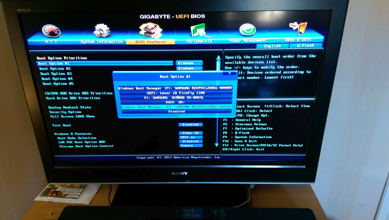

    Modded the attached BIOS for the Gigabyte AM1M-S2H so it can support NVMe PCIe SSD's.

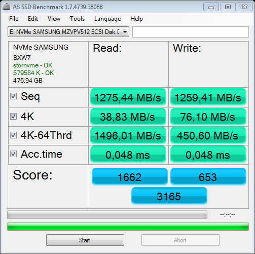

    I tested a 512GB Samsung SM951 using this adapter and it worked great.
    The x16 slot is x4 Gen 2 which does limit the speed though.
    Because the SSD supports Gen 3...
    Last edited by Per Hansson; 10-30-2016, 01:23 PM. Reason: Attached photo of BIOS screen showing NVMe drive.

      Hi, I have used MMTool 4.50.0023 and as source the BIOS from another Gigabyte board that had NVMe support.
      From it I have extracted Nvme NvmeSmm & NVMEINT13 modules.
      Then I have inserted these into the BIOS to be modded which is the file attached to the OP.
      Note: they need to be inserted into the same volume index as the CSMCORE module is located in. (01 in the case of Gigabyte AM1M-S2H BIOS).
