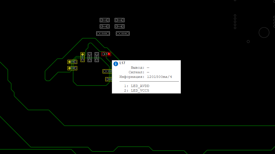

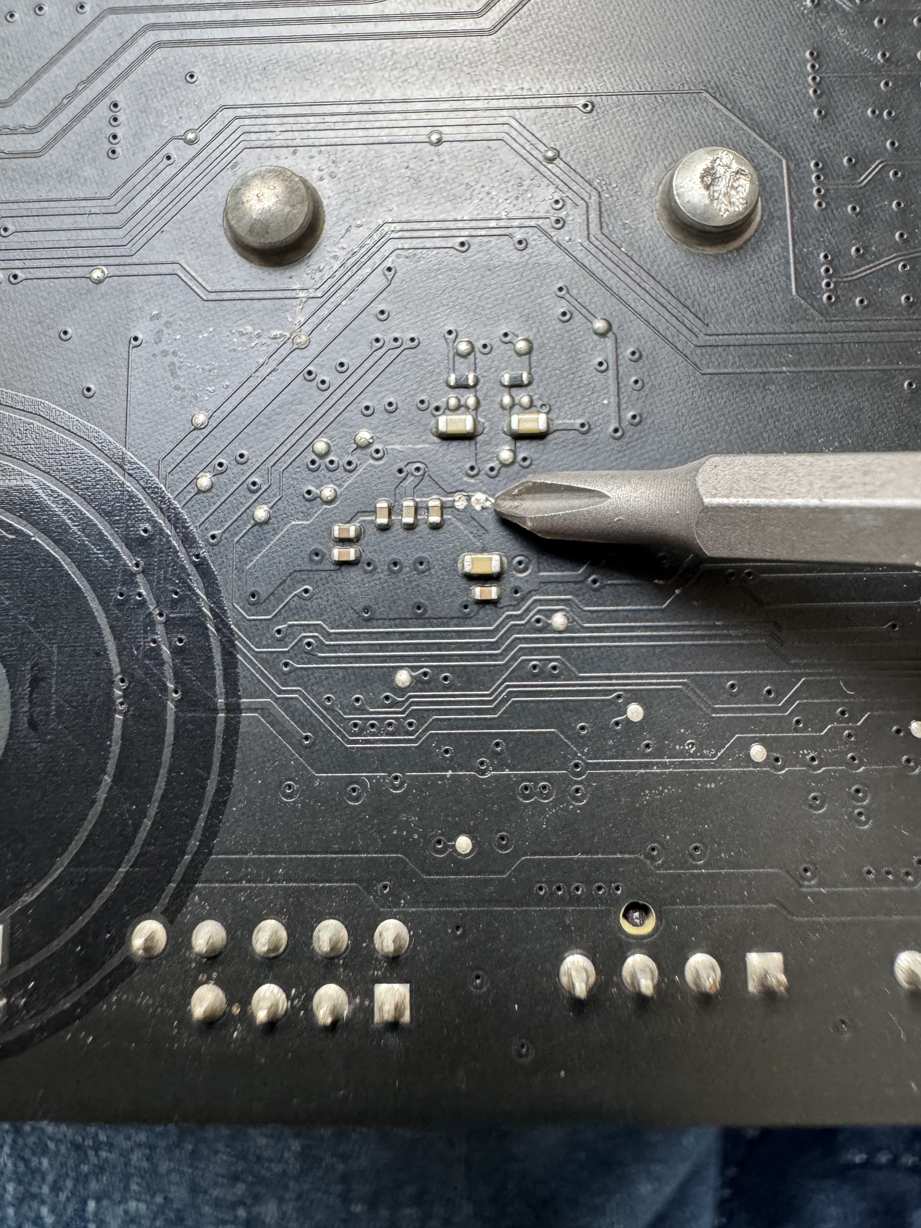

        I also have the same board after physical damage. A couple of ripped tracks which are not that difficult to fix, but there is also one broken smd element on the back side of the board near the lowest m2 slot area.
        If somebody knows could you tell me what that element is please? (please see the photo)

          L17 120l500ma/4

              L17 120l500ma/4
              Thank a lot for your reaction on my request and help on getting info about the missing element. I appreciate it a lot!
              It looks like its an inductor because of the letter "L"? Unfortunately, I have no idea about its specs and what can be soldered instead of it...
