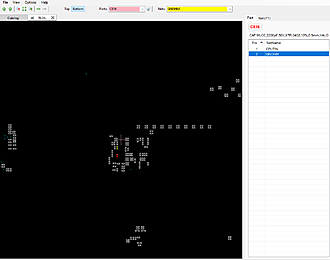

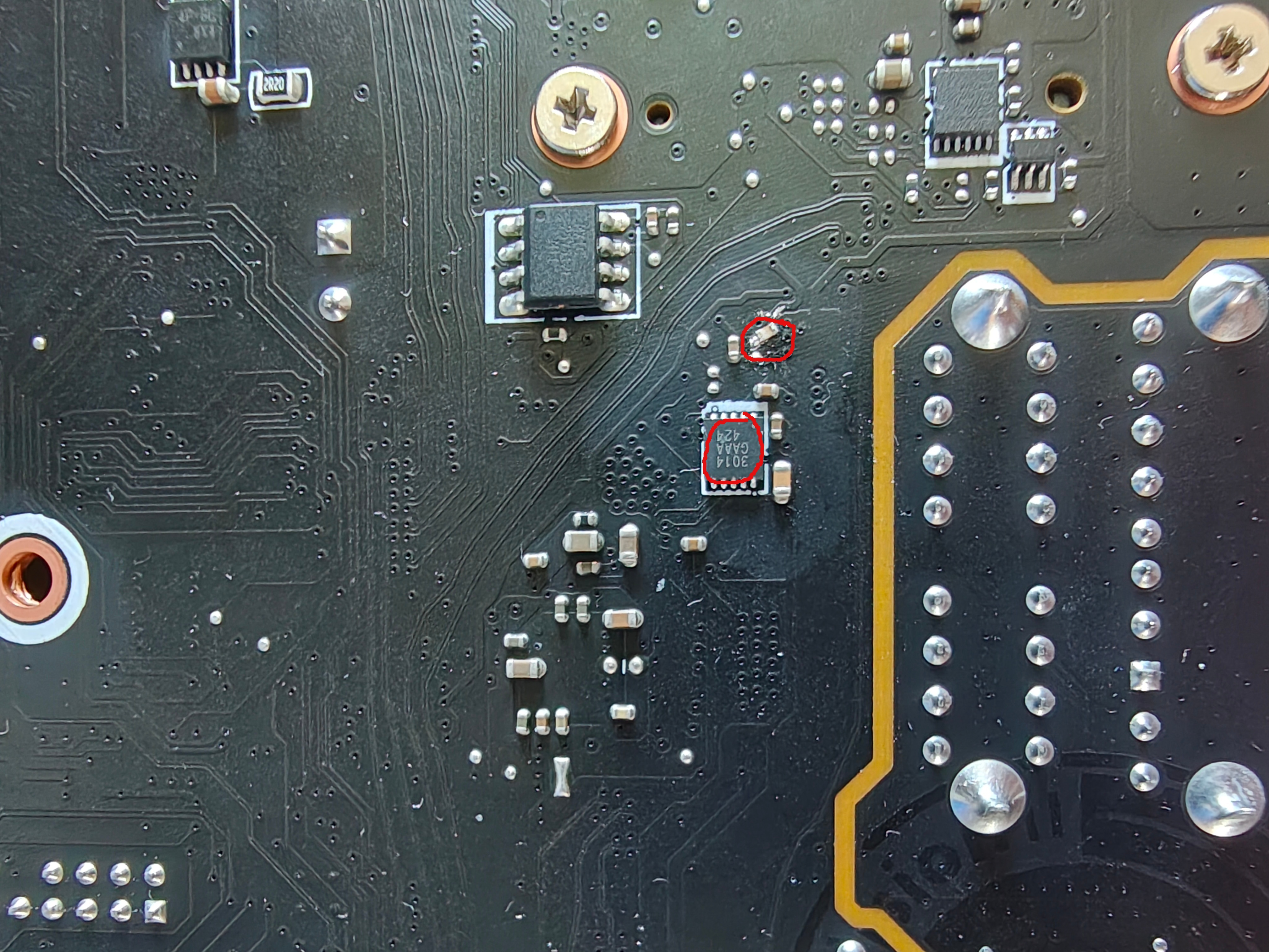

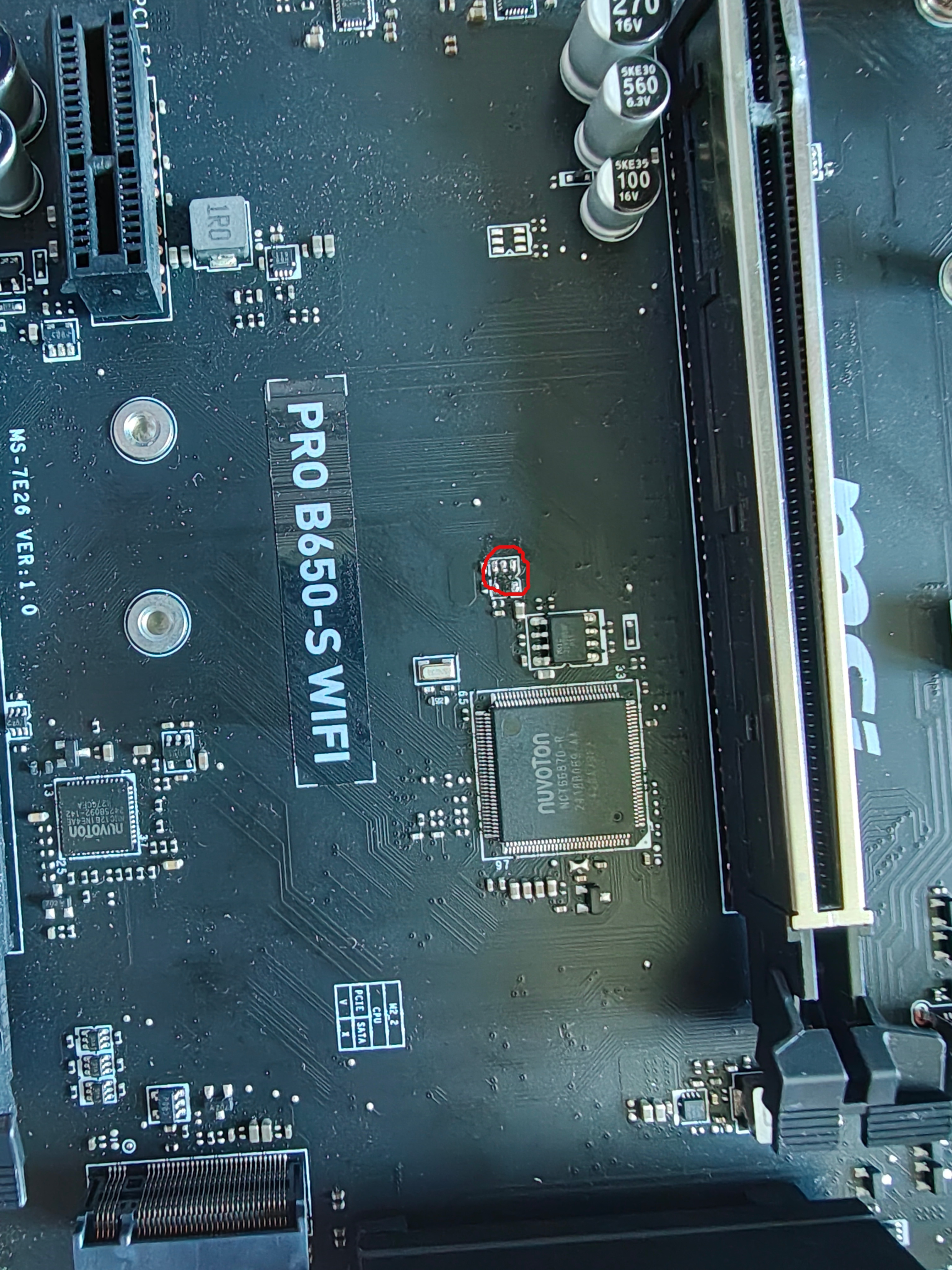

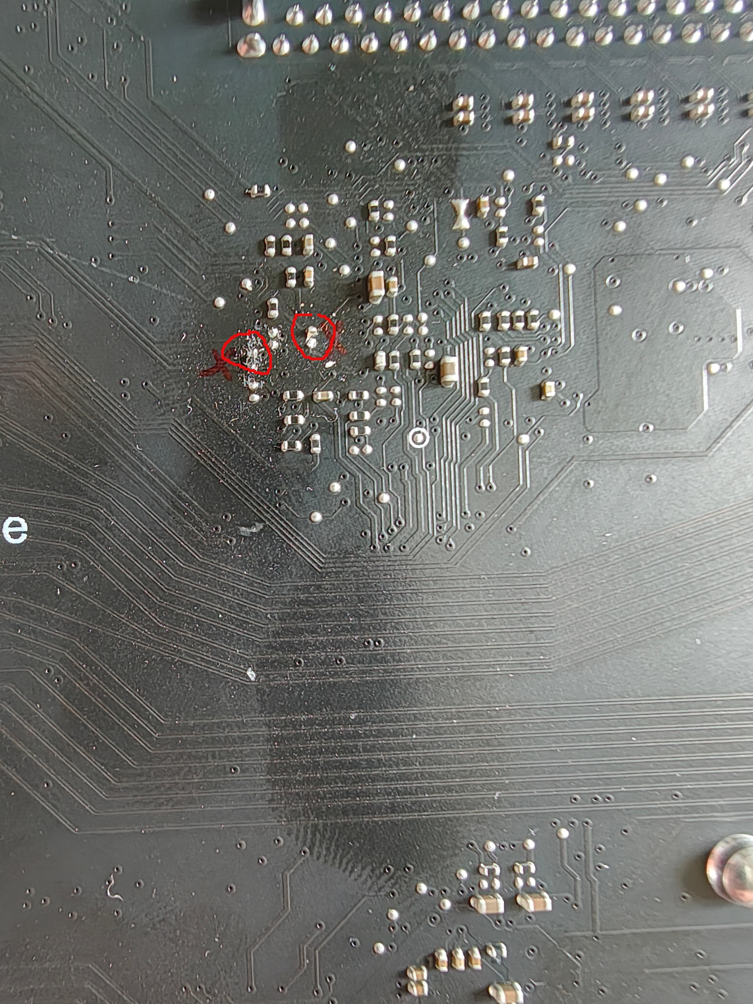

    I bought this board for fixing. It has short on 5vsb and missing components on the back under SIO ... I will be very grateful for help in finding at least a similar one boardview.

    NEED PICTURE BACK UNDER SIO
    • noname2024
      • Aug 2024
      • 276
      • CỎ MỸ XỊN
      TRY
      • Grzegorz_N
        • Dec 2024
        • 11
        • Polska

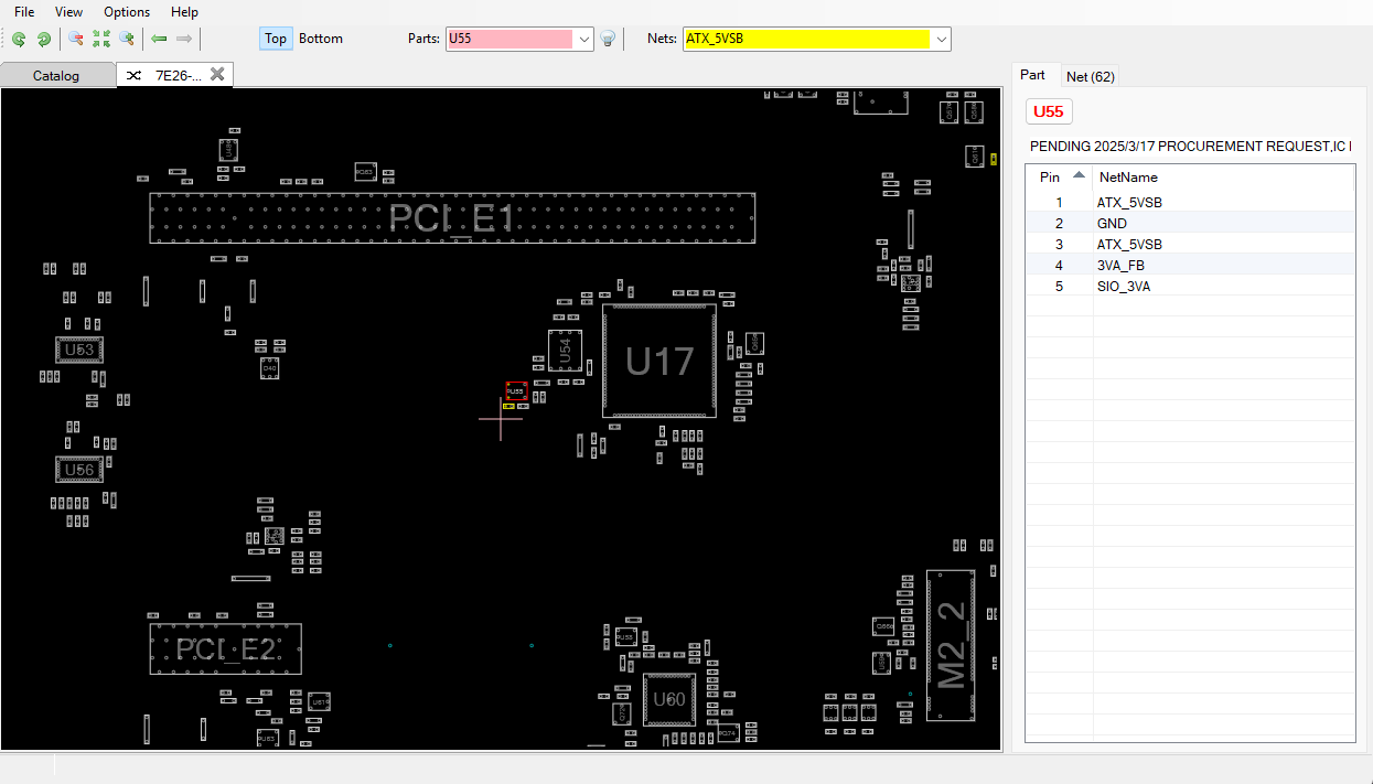

        Can You send me the file ? I need to find witch part shorts to ground on 5vsb.
        • noname2024
          • Aug 2024
          • 276
          • CỎ MỸ XỊN

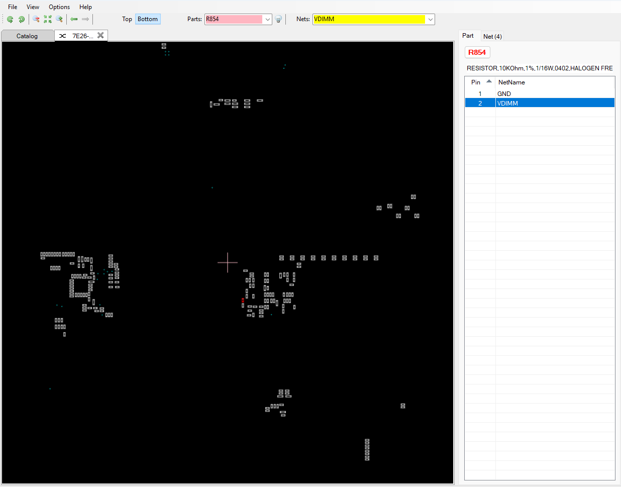

          ........... Click image for larger version
ID:	3695935 Click image for larger version

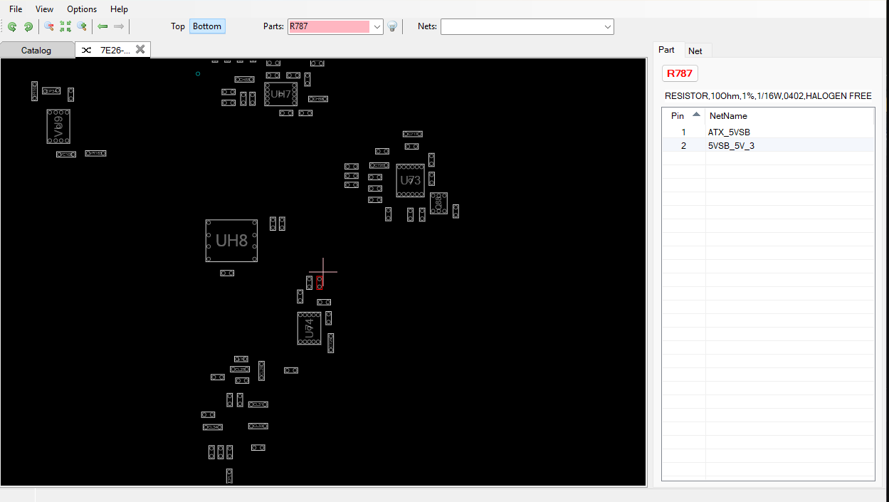

            Thanks for the help, but I still need to figure out which components on the 5vsb line are causing the short.
            • Grzegorz_N
              • Dec 2024
              • 11
              • Polska
              I think I've found the problem in two places, three elements. I need their names. Thanks in advance for help.
              • noname2024
                • Aug 2024
                • 276
                • CỎ MỸ XỊN
ID:	3697008 Click image for larger version

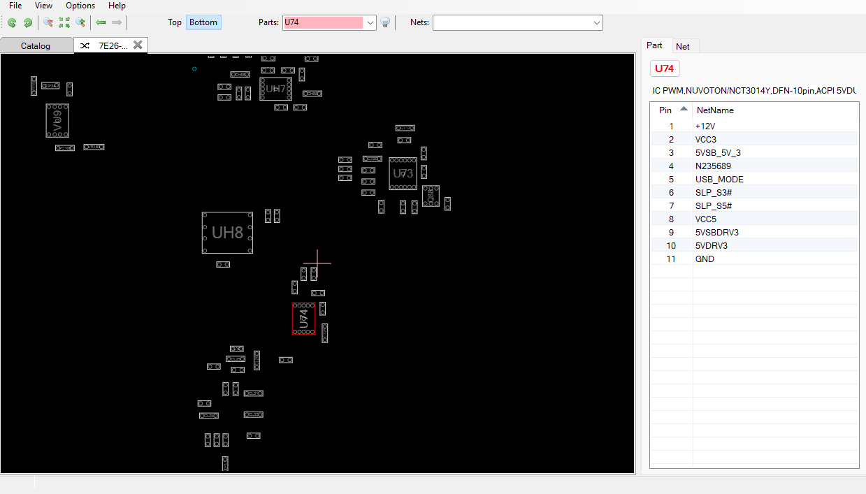

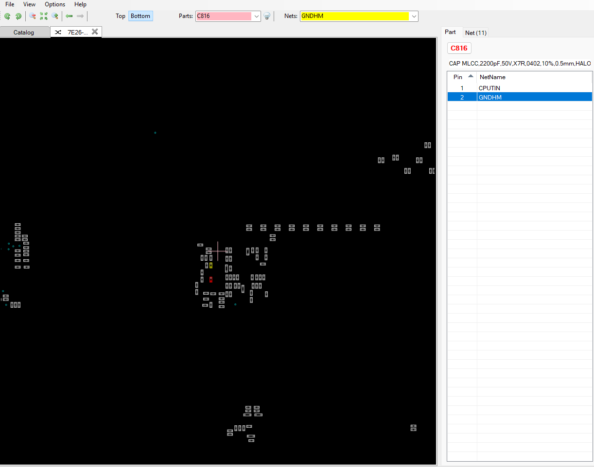

                • noname2024
                  • Aug 2024
                  • 276
                  • CỎ MỸ XỊN
                  • Grzegorz_N
                    • Dec 2024
                    • 11
                    • Polska
                    Thanks, but i need 1 more item U74 from first screen.
                    • Grzegorz_N
                      • Dec 2024
                      • 11
                      • Polska
                      Thanks a lot for your help.
