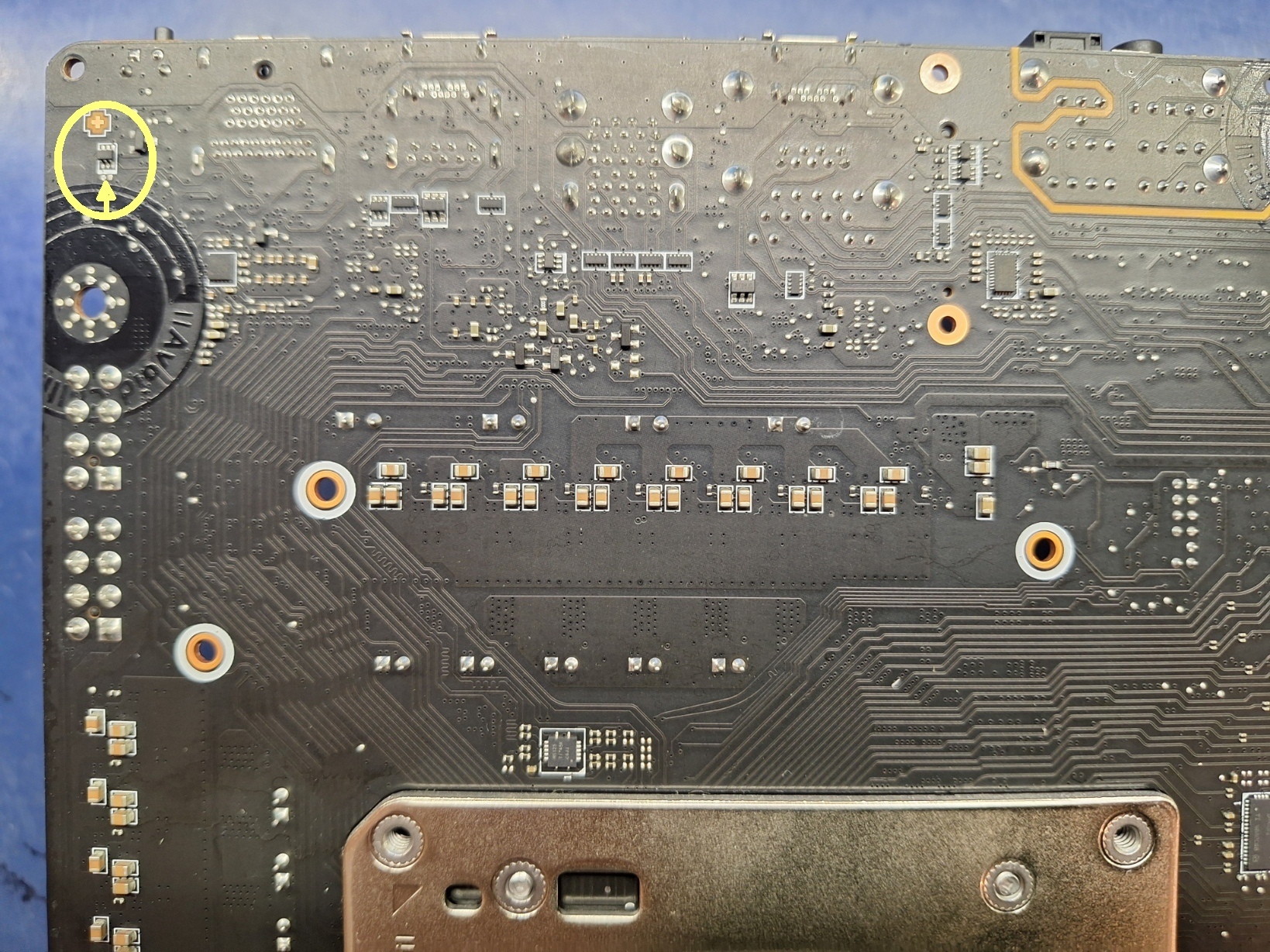

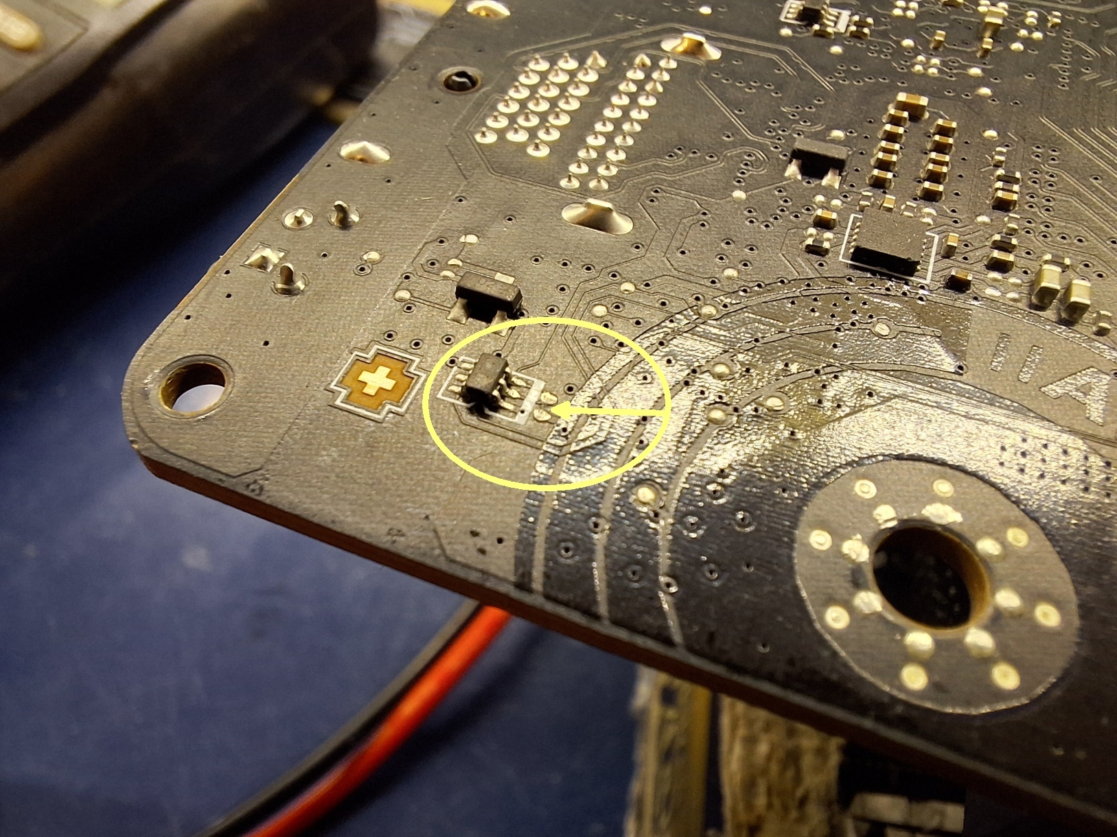

        I have exactly this board (MSI MPG X670E TOMAHAWK WIFI, MS-7E12) with a missing element on the backside of the board.
        I'd appreciate is you or anybody could help me with identifying this missing element - the place is shown on below's pictures - it's on the bottom of the board, close to the BIOS Flashback button corner.
        The board does not POST probably due to this element missing, and the the MSI X670E CARBON boardview is very different and of no help.
        I guess it's a resistor, pls if anybody could measure this resistor (cap) and could post here.
        If it's a resistor, pls measure it in both directions, as it is in-circuit measurement, and the resust can be falsified due to the other in-circuit resistances.
        A measurement in both directions (+/-) can help to find the righ resistance of the device.
        Thanks in advance for your help.

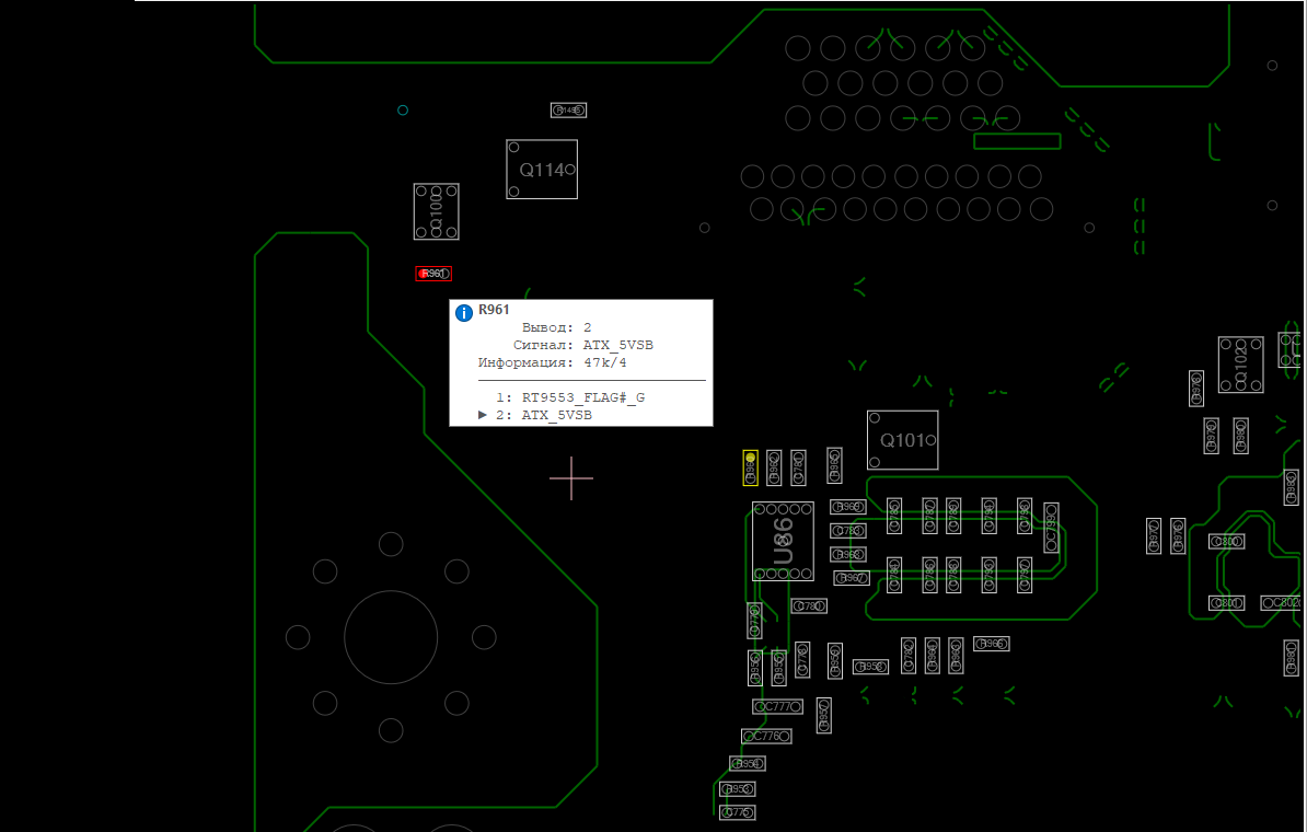

          The resistor is 47 kOhm
