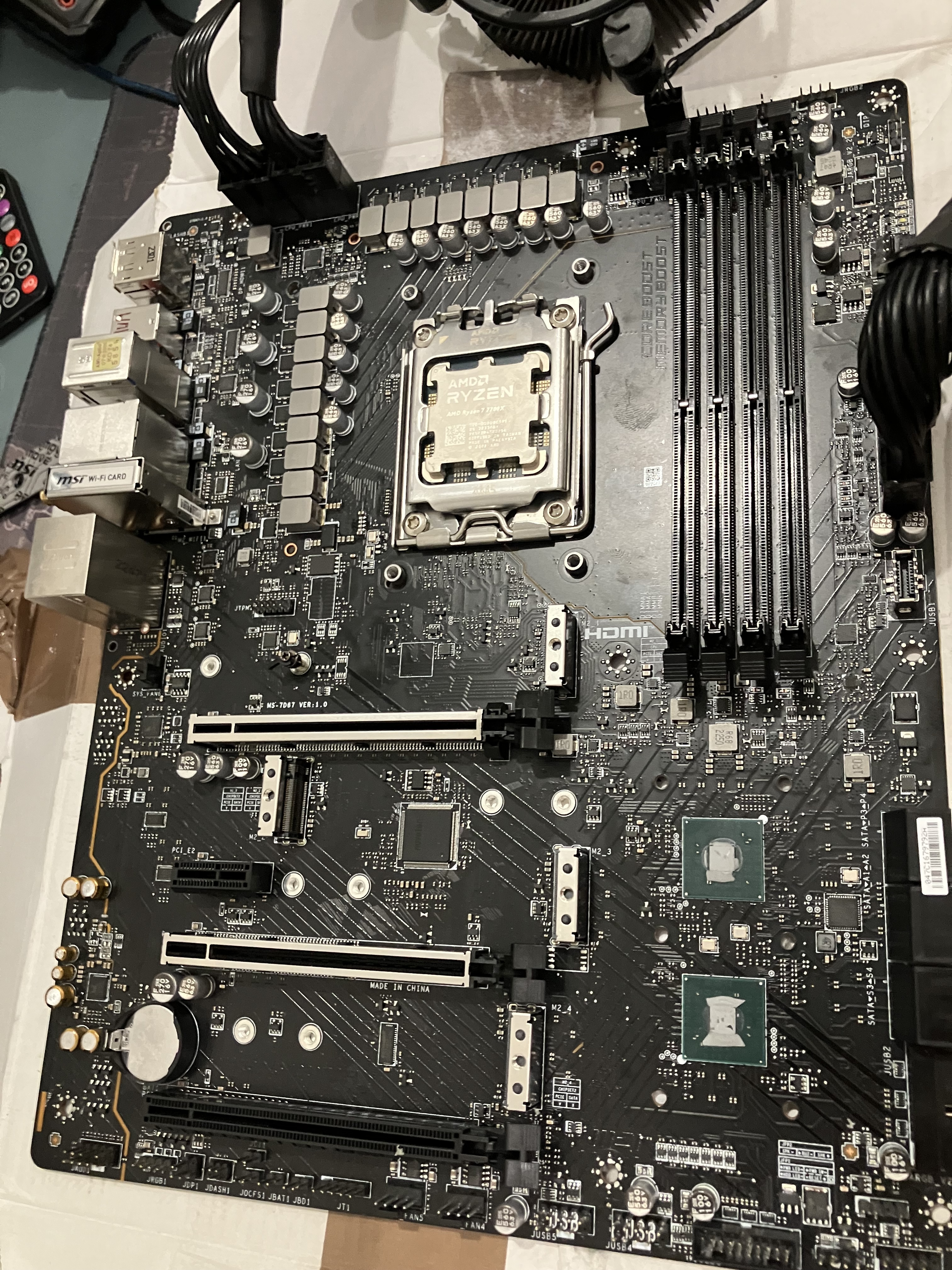

    I have an MSI Pro X670p Wi-Fi. When I boot directly with the CPU and memory, the red CPU LED and orange DRAM LED light up.
    I tried updating the BIOS with QFlash from USB, and there's a signal from pin 2. I checked all voltages and they're OK, including coils, chipset, BIOS, etc. I checked the pins between the CPU and RAM.
    I've also tried swapping the CPU for another one that's working in my personal PC and moving memory to different slots.
    If anyone has any ideas or suggestions, I'm at a standstill...
    If possible and if someone has a schematic it would also be of great help.
    Thanks, best regards.
