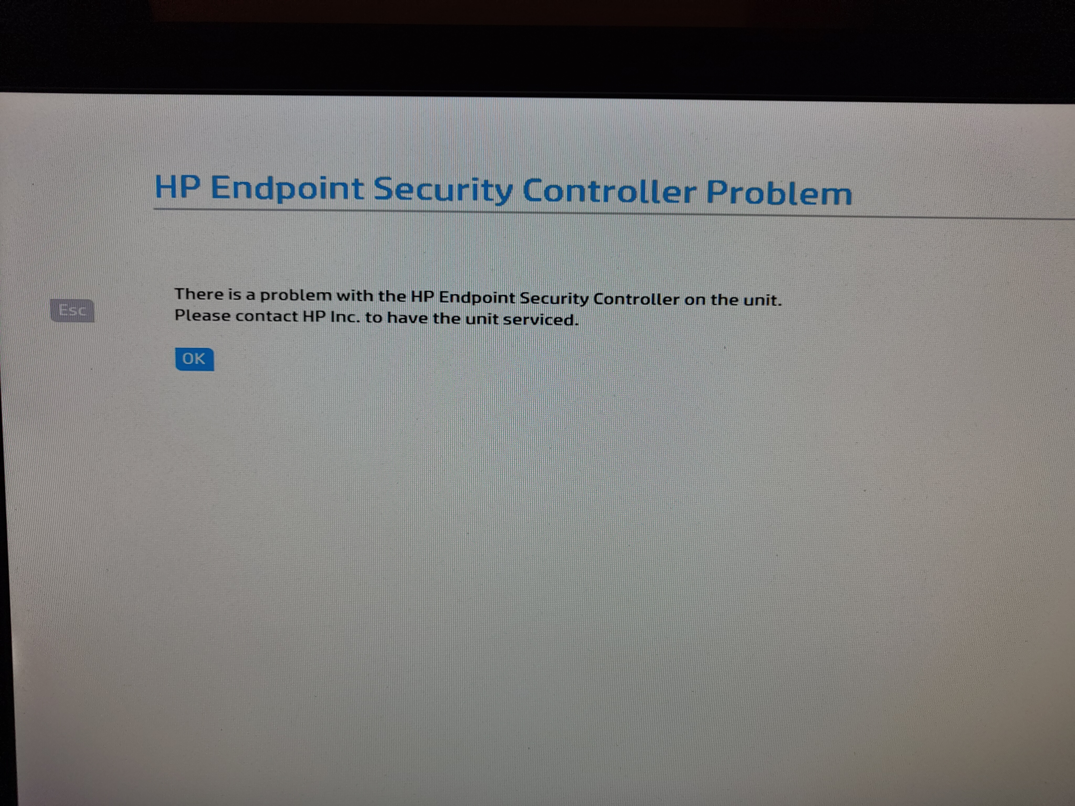

                        Please one more thing, the number 2 has started showing the "There is a problem with the HP Endpoint Security Controller on the unti.", I am attaching a photo as well.
                        I am also attaching current BIOS dump. I do not know if this is fixable, since I am missing the original XU68/PRVROM backup from this device.
                        Also if there is a way I could support your work, please let me know.
                        Thank you very much!
                          https://www.badcaps.net/forum/troubleshooting-hardware-devices-and-electronics-theory/troubleshooting-laptops-tablets-and-mobile-devices/bios-requests-only/3305683-i-have-hp-probook-
                          https://www.badcaps.net/forum/troubleshooting-hardware-devices-and-electronics-theory/troubleshooting-laptops-tablets-and-mobile-devices/bios-requests-only/3325398-hp-clean-vss2-dumps-fix-endpoint-security-error
