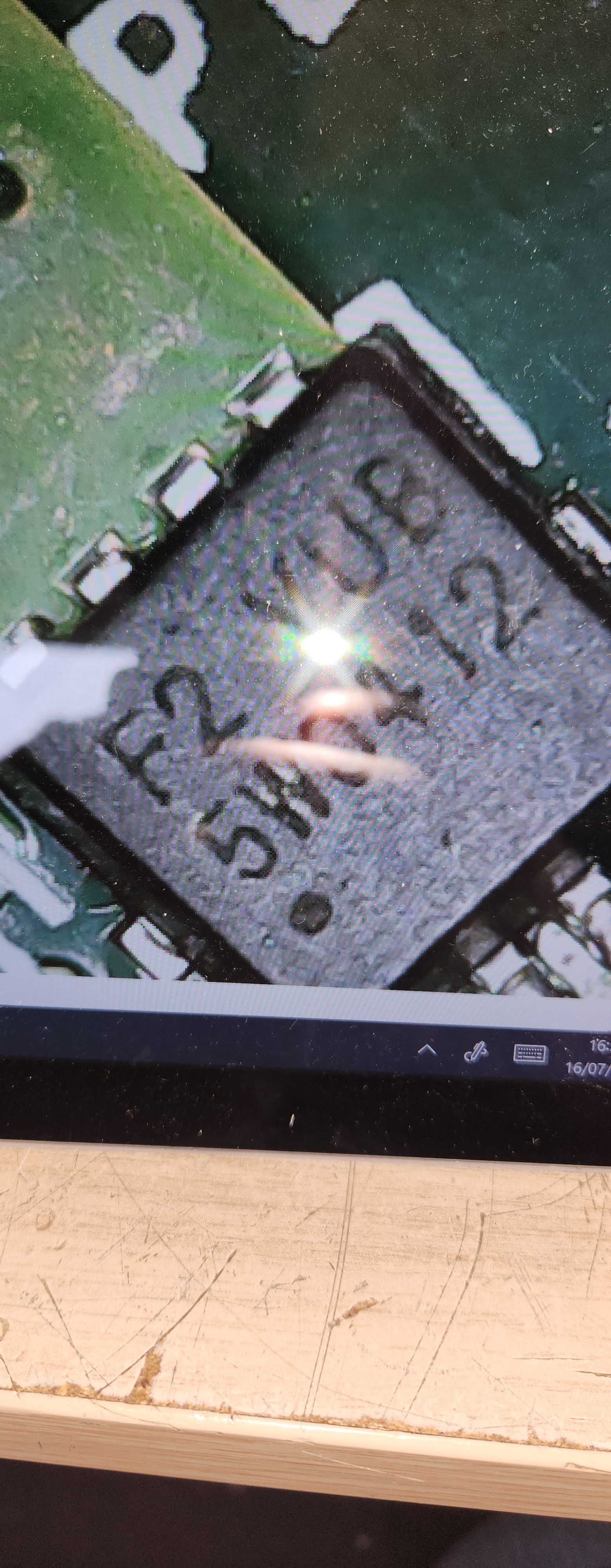

    Hello, im working on an lenovo ideacentre aio 3 27imb05 all in one pc and there is no power, i think ive narrowed it down to a short on a MOSFET but i need to know what it is to order on can anyone help with a schematic?

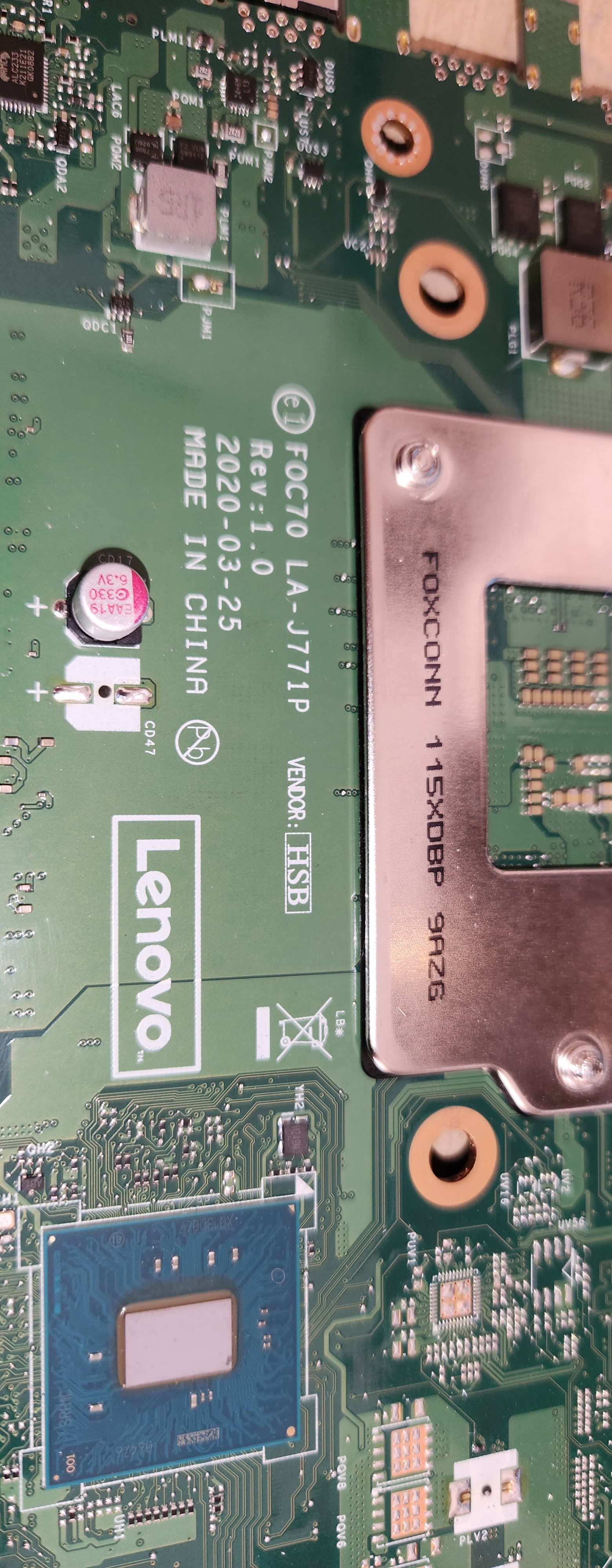

    Post the motherboard model number, it will be silkscreened in white lettering somewhere. The mosfet is PE606BA https://www.badcaps.net/forum/troubl...86#post1672286

      LA-J771P Rev: 1.0
