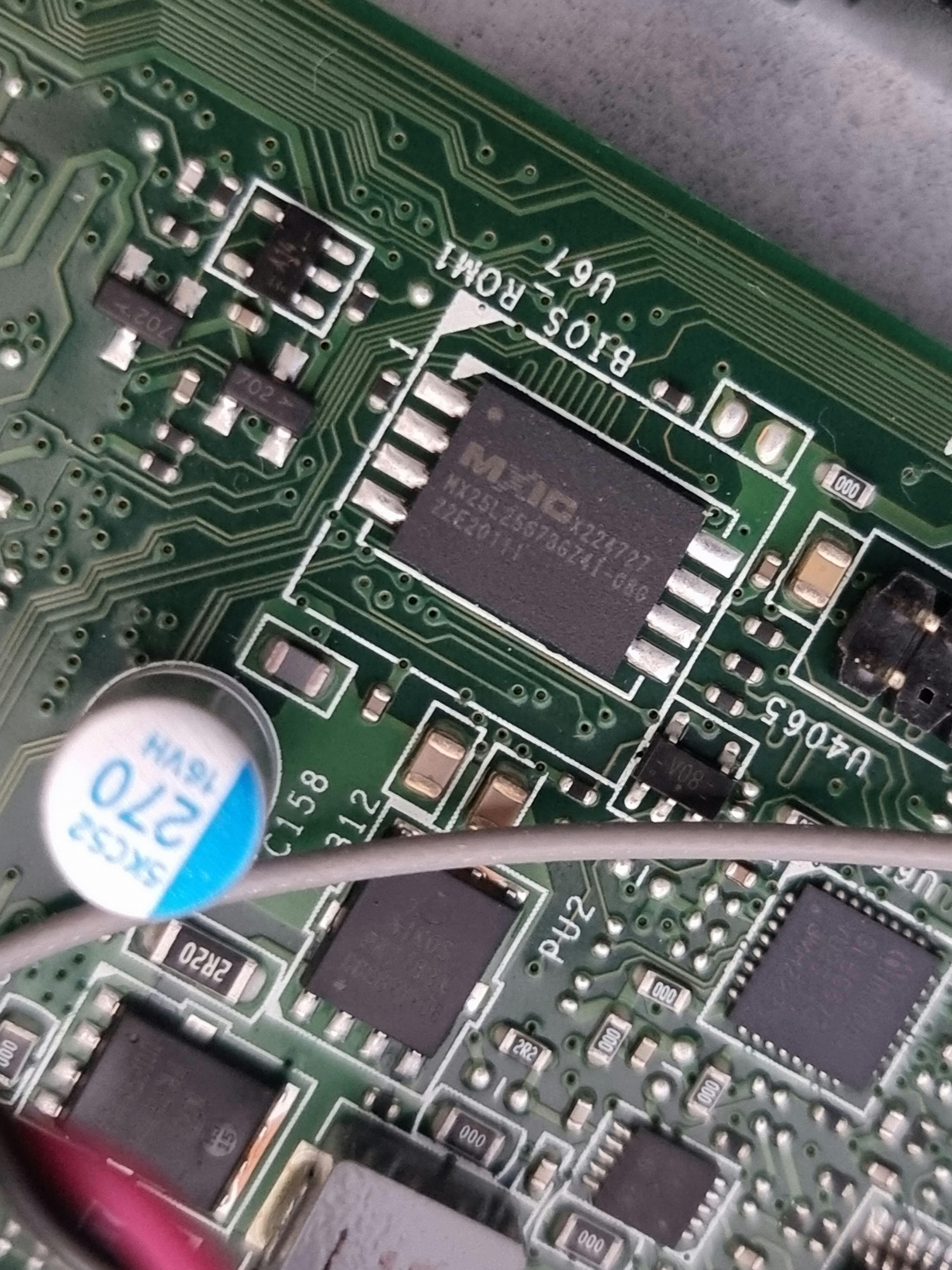

    I'm a total beginner about bios, chip etc.
    I tried to make some search, but it's pretty difficult to have a good understanding about this.
    I have a Lenovo m80s gen 3, with a forgotten bios password.
    From what I've seen, I have 2 chips on the motherboard, on the bios_rom 1, I have this written on : mxic x224727 mx25l25673gz41-08g
    I would appreciate some help about this :
    1) is it possible to get rid about the password in my case (any method) ?
    2) what kind of materiel should I buy to be able to dump this kind of chip and write on it ?
    I'm truly sorry if my questions are dumb, I don't think I was able to find my asking by research, but maybe it's because my knowledge about that is very poor.
    Thanks a lot for your help and answers !

    Your bios chip : mx25l25673gz41-08g
    Remove password : https://www.badcaps.net/forum/troubl...al#post3182482
    Device read / write bios : CH341A , RT906...
    https://www.youtube.com/results?search_query=how+to+use+ch341a

      Hello, thanks you, I start to understand well !
      Last few questions :
      I have 2 bios chip on the motherboard, do I have to dump both, patch both and overwrite both ?
      what is rt906 ?

        I'm wrong, RT809H
