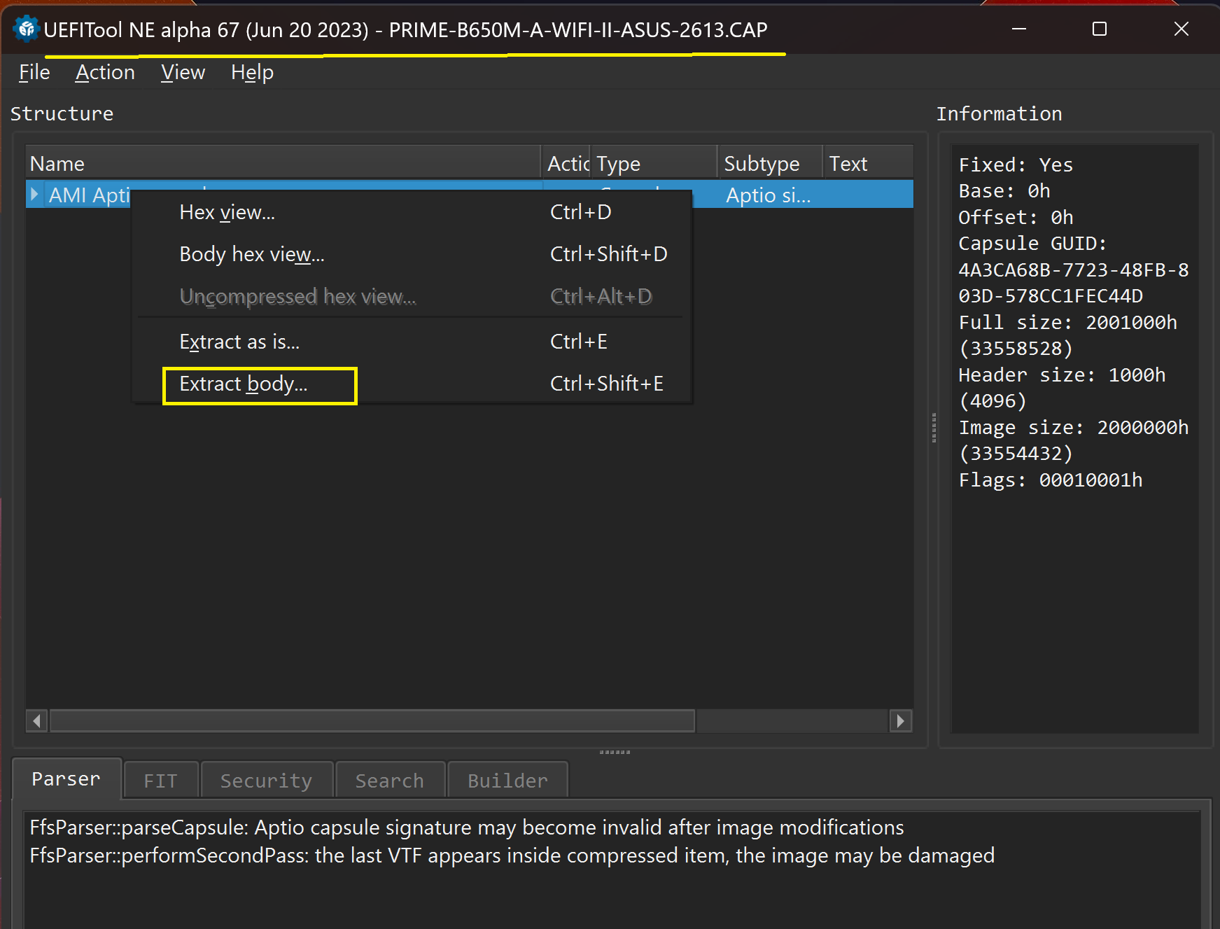

    I NEED THE BIOS DUMP FILE. BIOS CRASHED

    Backup bios file.

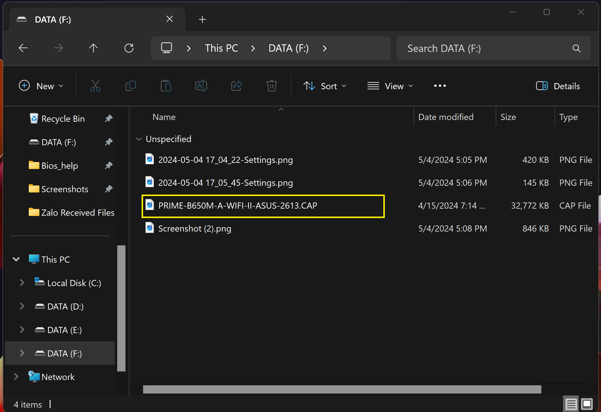

ID:	3264749 Click image for larger version

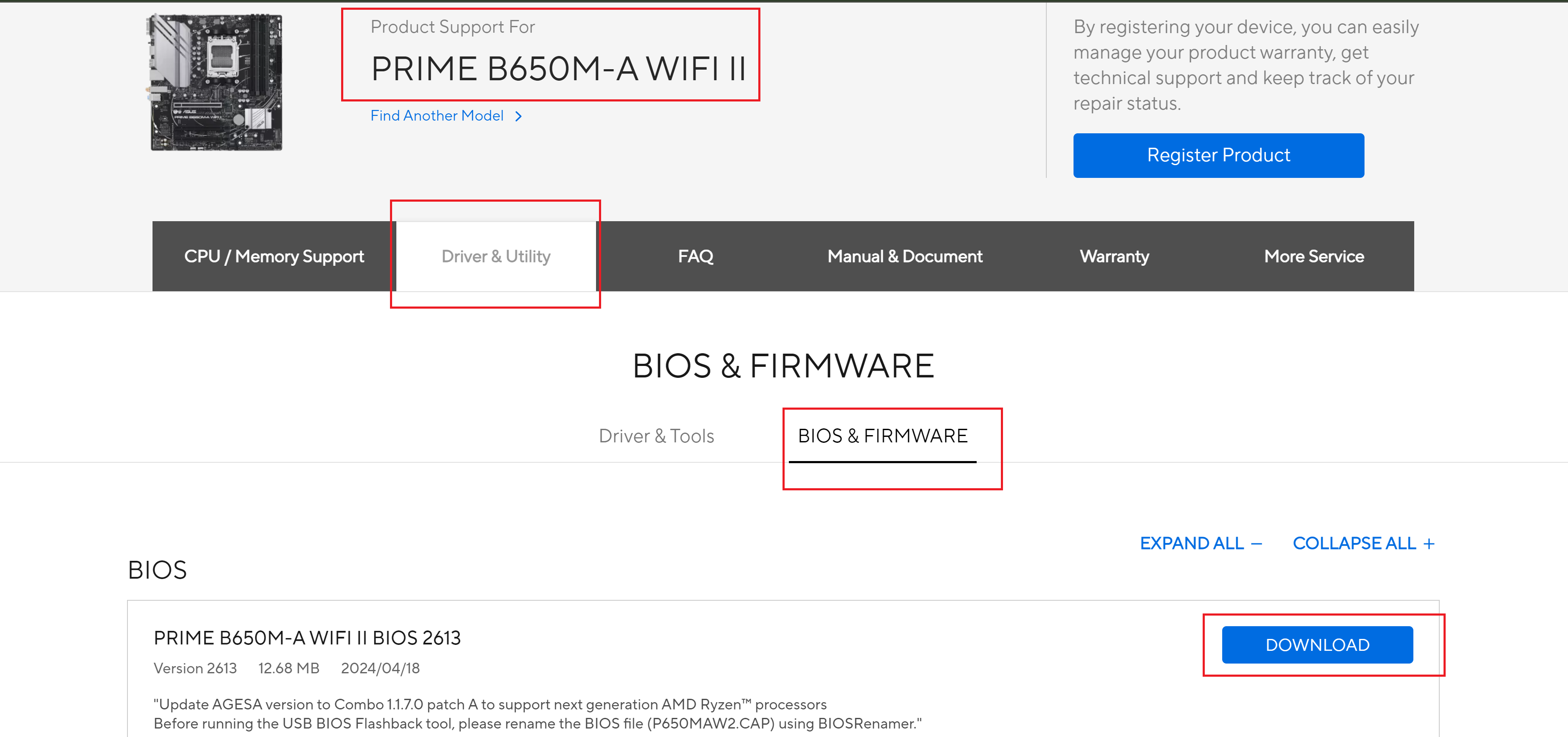

ID:	3264750 Click image for larger version

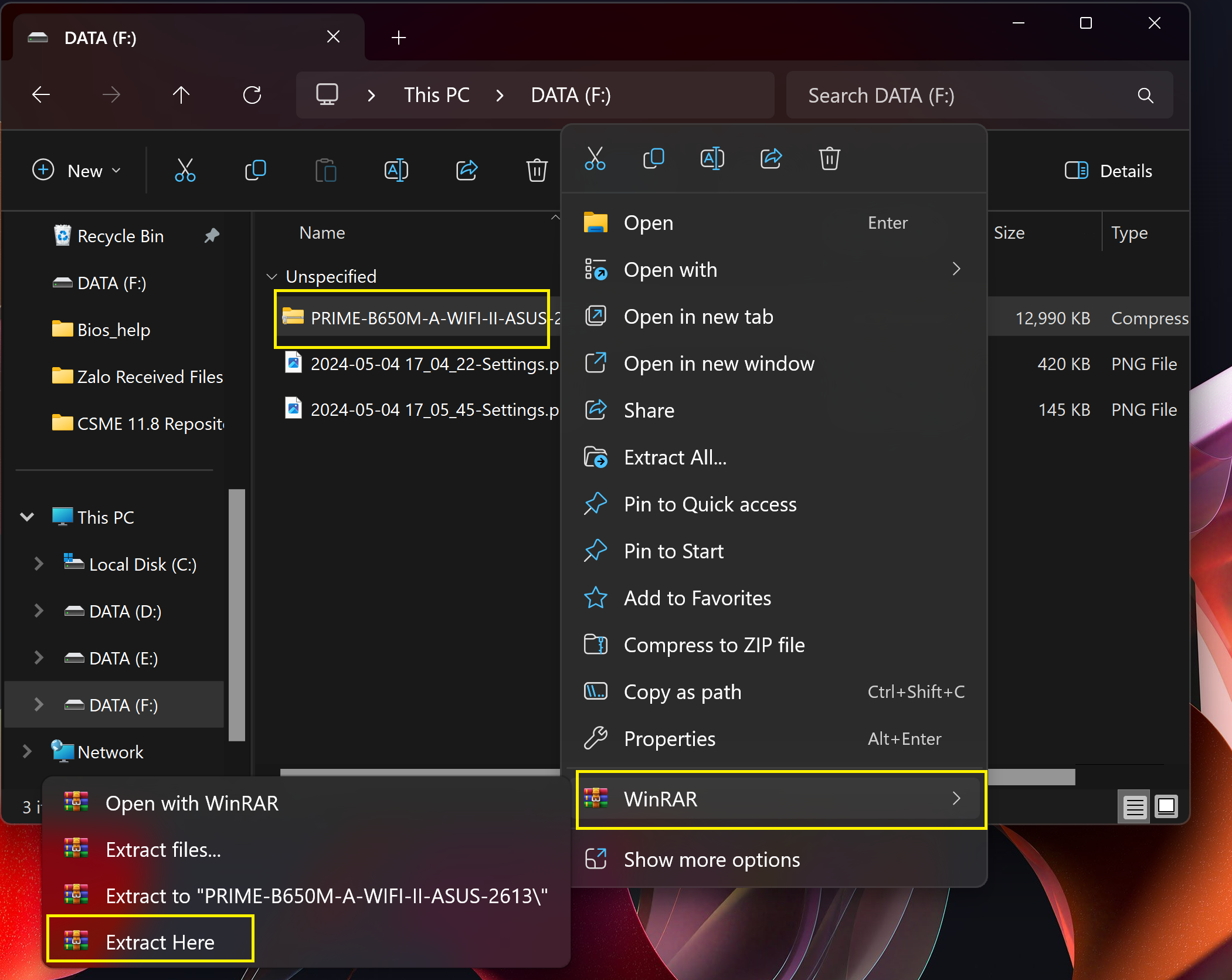

ID:	3264751 Click image for larger version

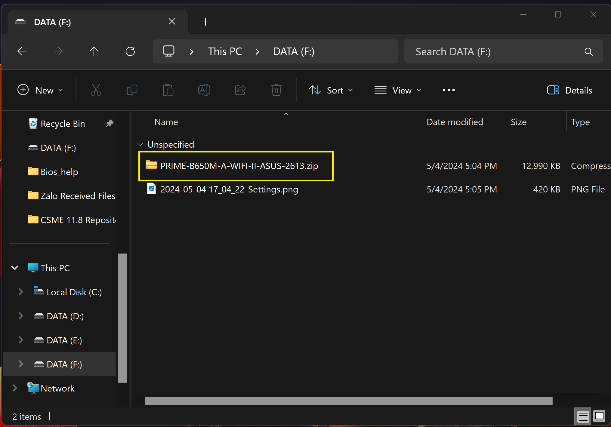

        Originally posted by sertac545454
        come in
        Look at the pictures Click image for larger version
