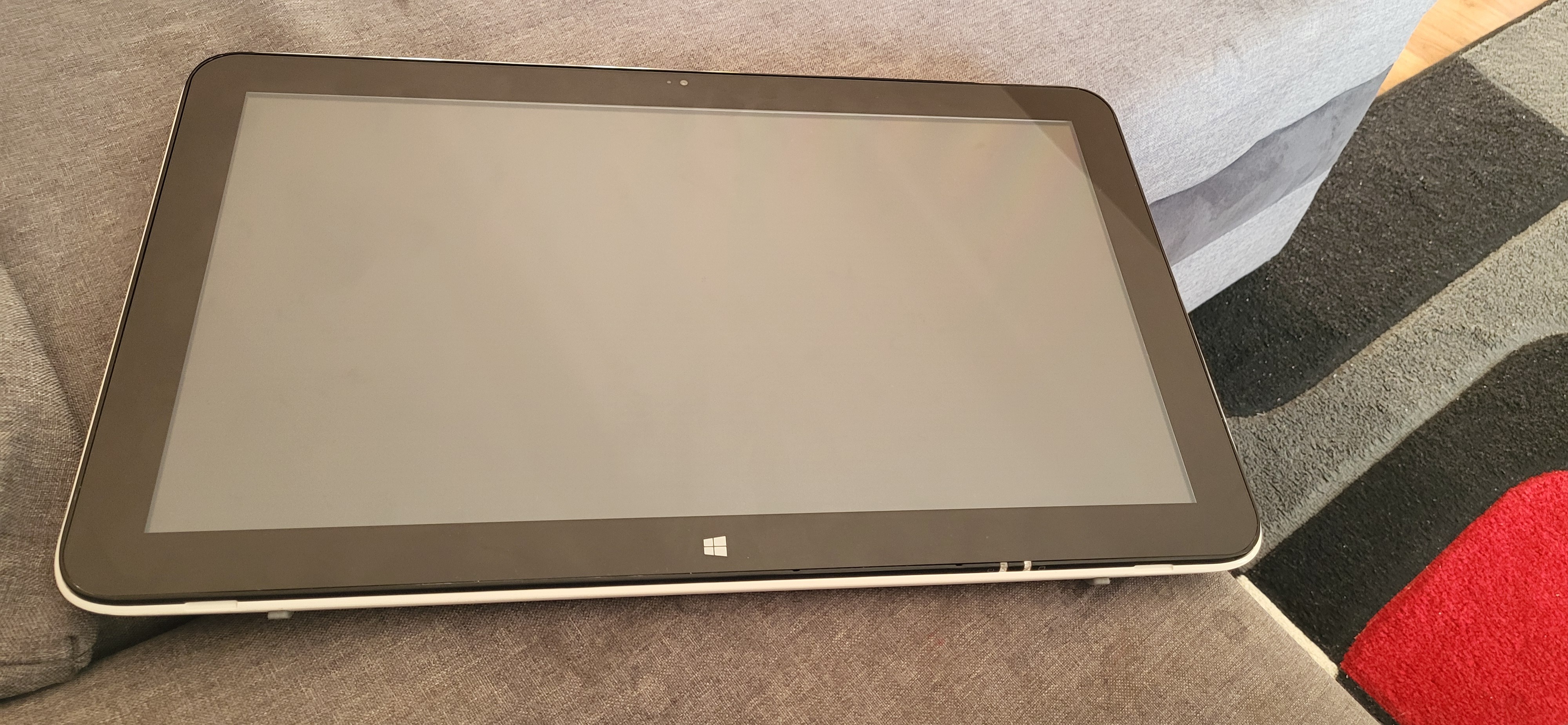

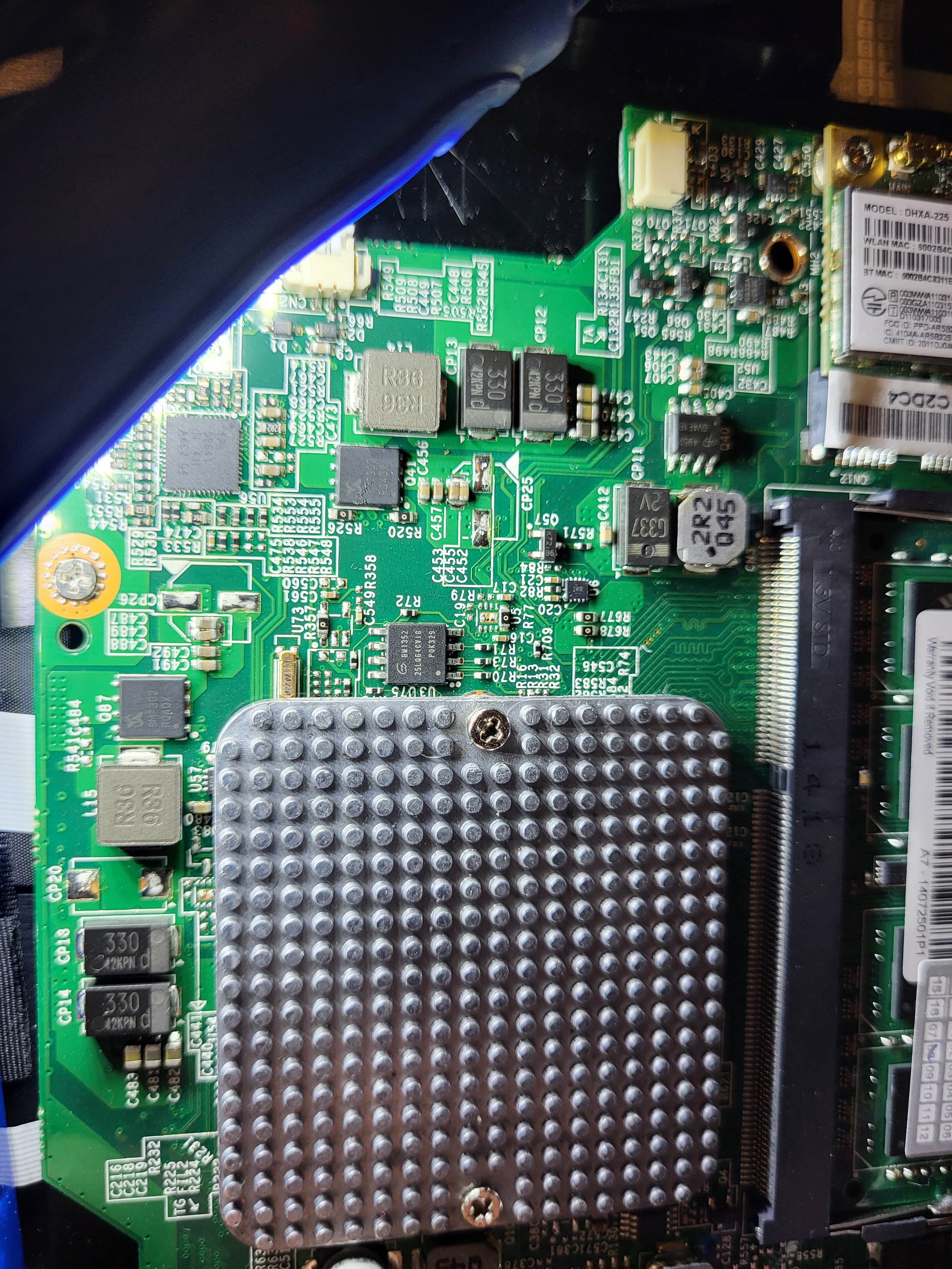

    Hello! there is a tablet marked Cello aio 101 on which the bios died. After switching on, there is a backlight for 5 seconds, then it turns off, there is no picture, and if I leave it in this state, the cpu heats up, which leads to the conclusion that something is working in the background or it should be working. If I cut off all power and then turn it back on, the process cools down as well. I would like to fix this bios, but I can't find how and which one anywhere. It has an Intel N2930 processor. The bios mark " ETON ET866 94v-0 E213441 TOP V1.03 1429-8 5000-0004-0203 2013.1114.1700 " bios is required. I also tried what worked for others, but without success or wrong.
    Click image for larger version  Name:	20240115_145516.jpg Views:	8 Size:	1.37 MB ID:	3179010 Click image for larger version  Name:	20240115_145333.jpg Views:	13 Size:	1.64 MB ID:	3179009 Click image for larger version  Name:	20240115_145415.jpg Views:	8 Size:	1.54 MB ID:	3179011

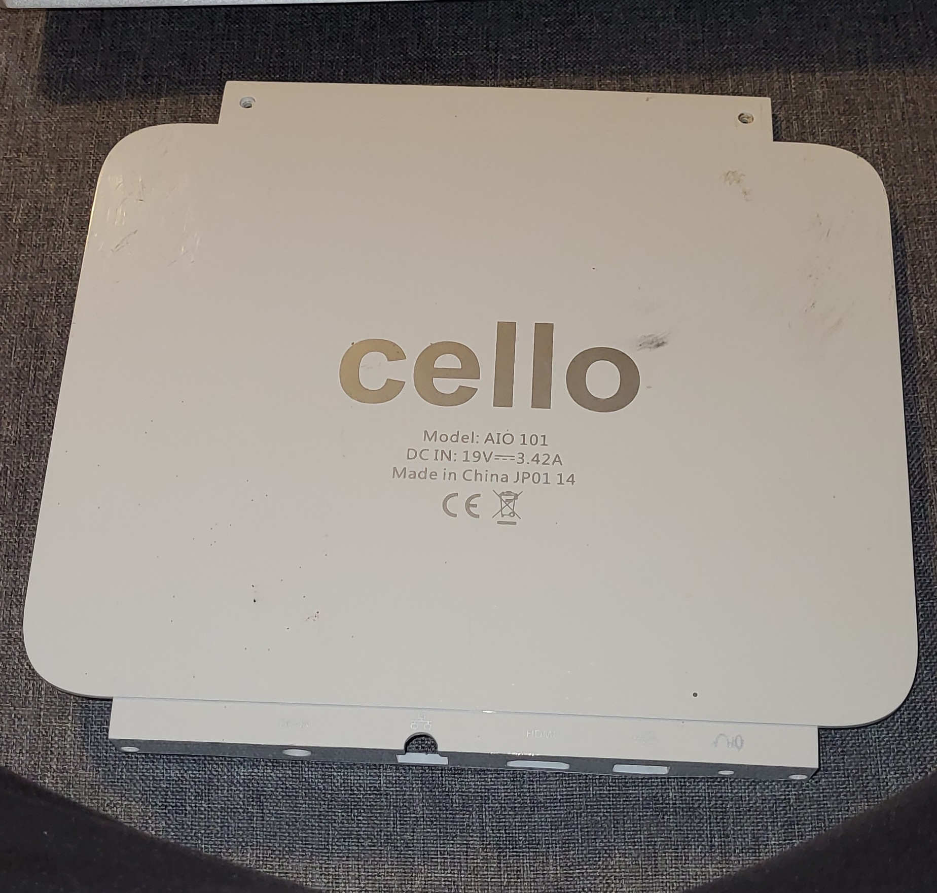

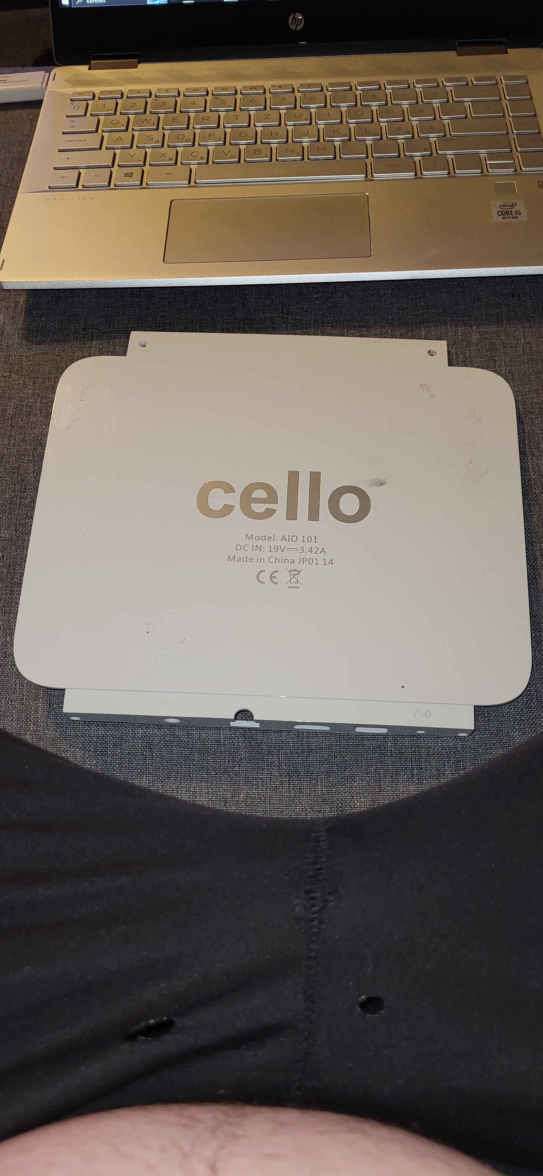

    If there is a serial number and part numbers on the back cover post them

        on the back there is as much as shown in the picture. I don't have a bios backup because it crashed a while ago and I can't get it to work. Click image for larger version
          that's all there is on the back. picture attached. Click image for larger version

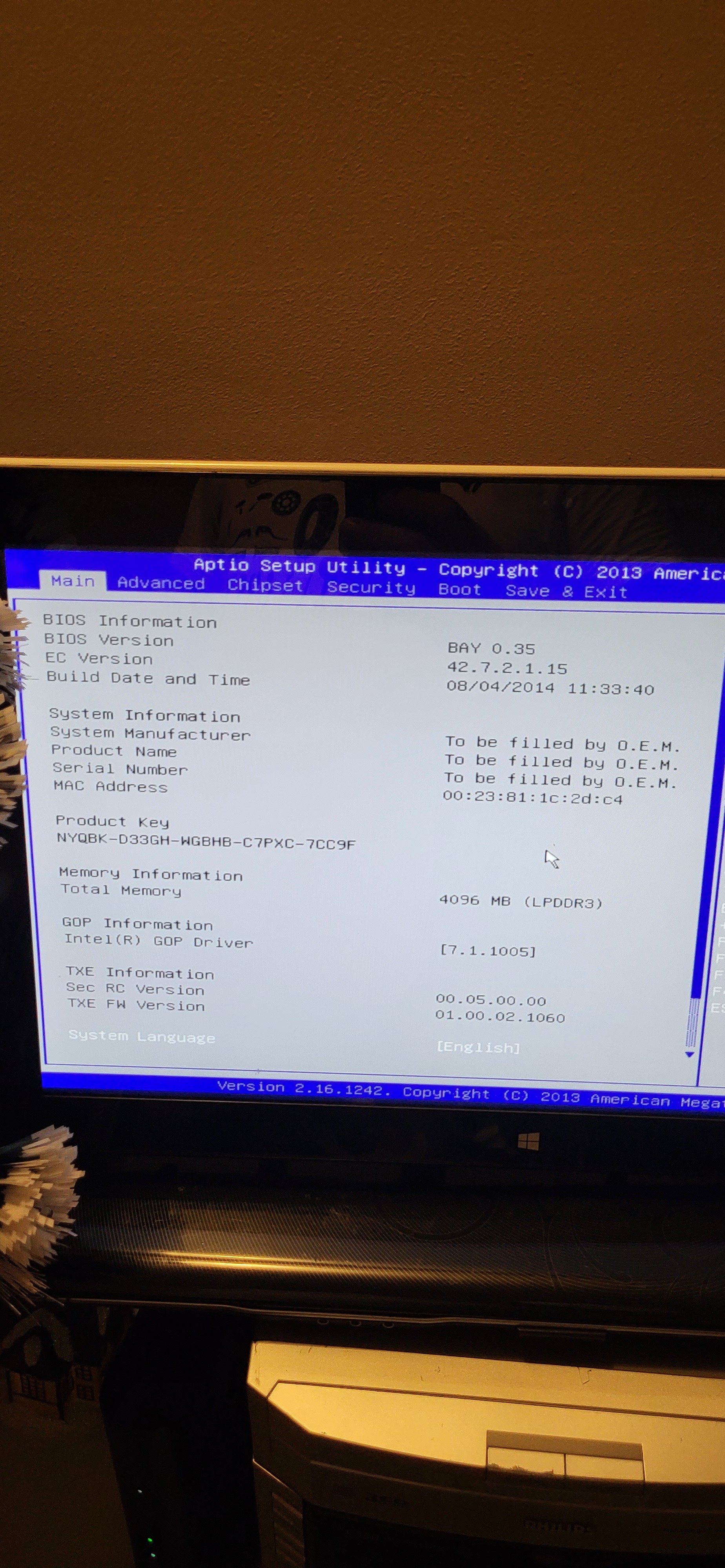

            Originally posted by leo037_2023
            PLEASE attach the backup bios .
            I managed to photograph this a few days before the bios died Click image for larger version  Name:	20240113_210227.jpg Views:	4 Size:	1.27 MB ID:	3179165
                ok , now attach you backup files , with your SPI programmer like CH341 - TL866 (SVOD 3) or (SVOD 4) or RT809F OR RT809H.

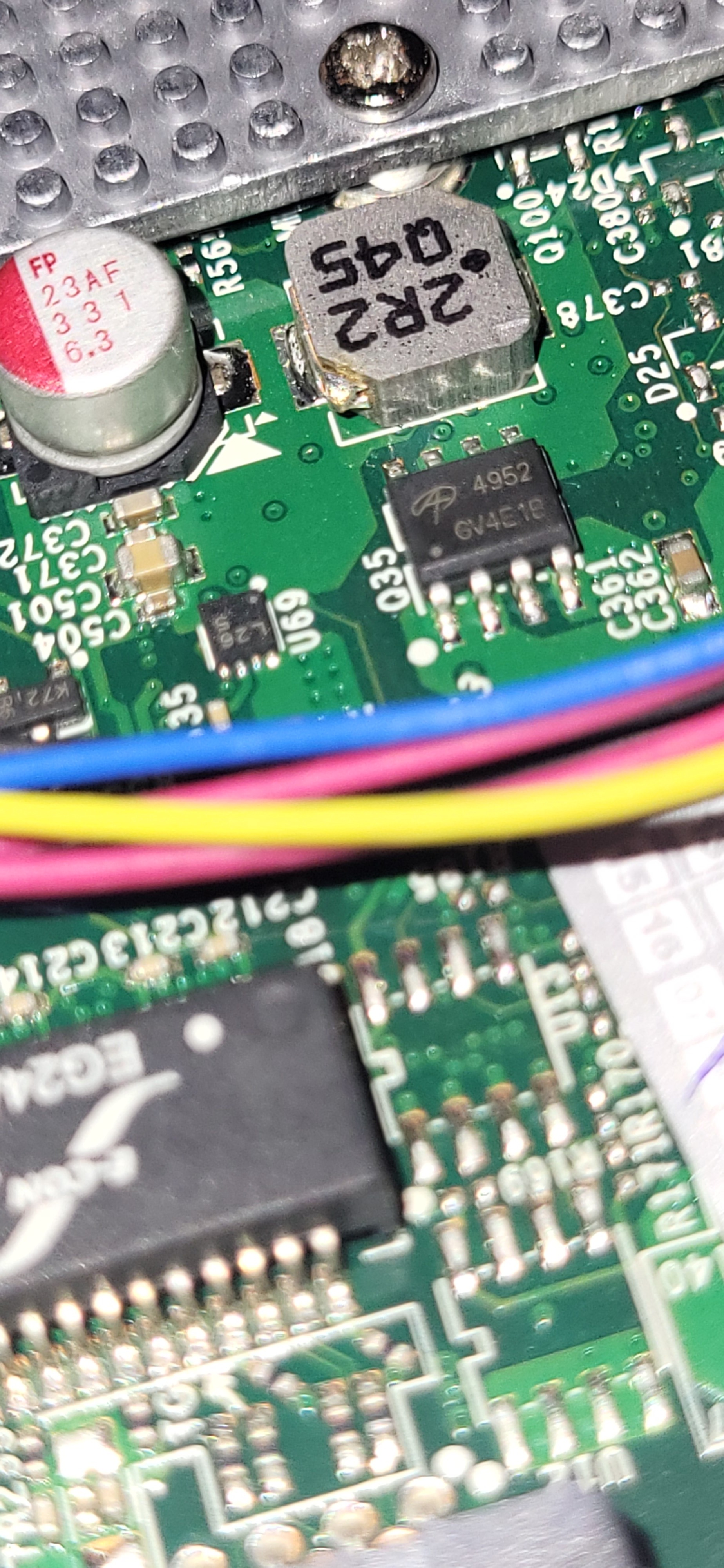

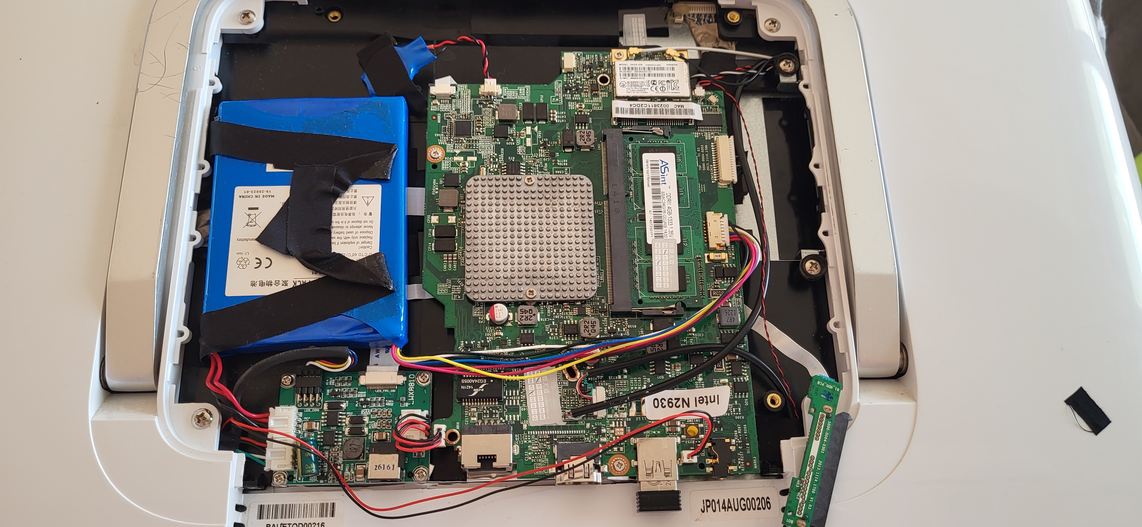

                  I'm buying a spi programmer today. which chip will the bios be on? there are 4 of the 8-pin chips shown in the picture, but I don't see a bios inscription next to any of them. Click image for larger version
                    SMDFlea commented
                    Editing a comment
                    That one`s a mosfet. Look at the part number on top of the 8/16 pin SOP8/WSON8 chips , one will say something like 25Q64 ,25Q128

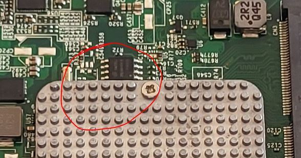

                  • 22424
                  Post the part number on top of this chip

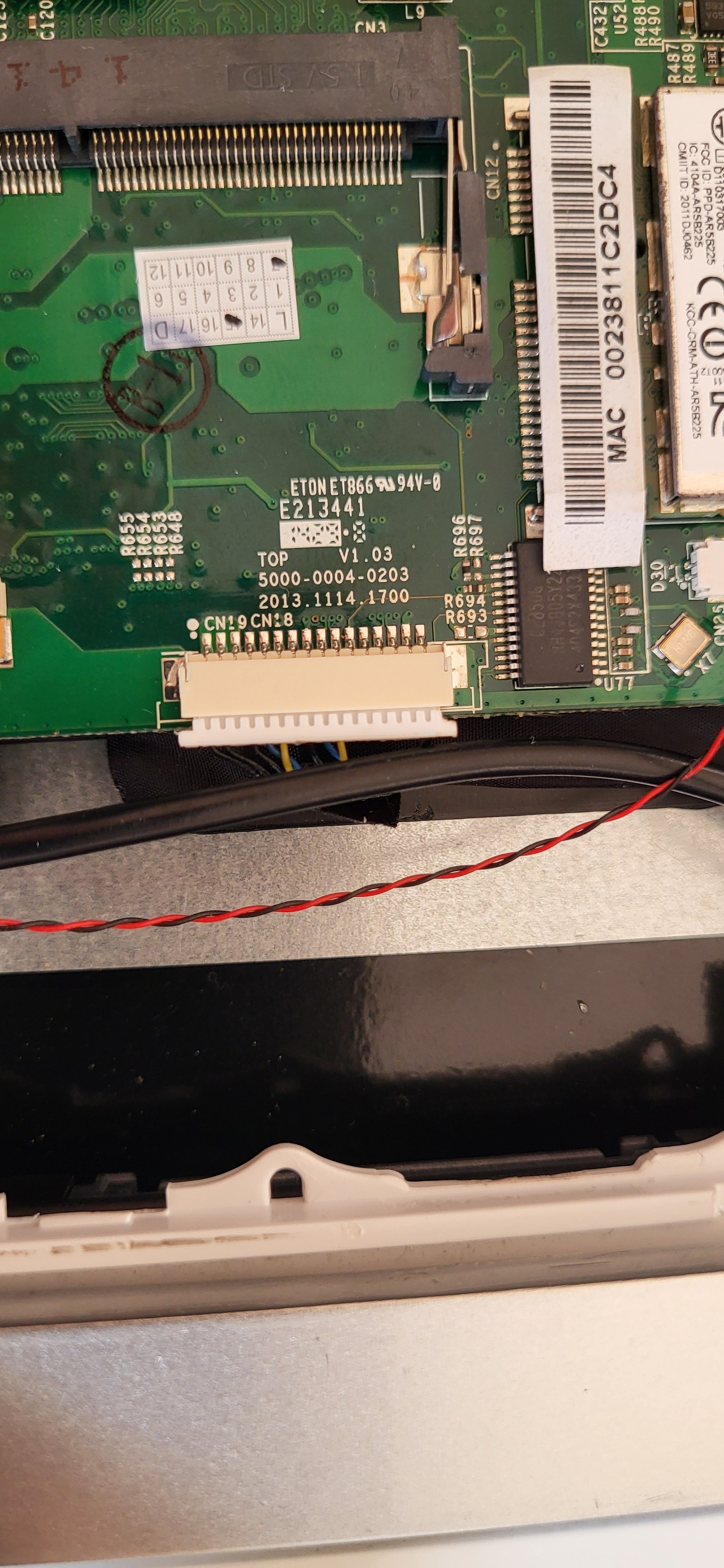

                    [QUOTE=SMDFlea;n3179697]Post the part number on top of this chip
                    I don't have the programmer yet so I can read and save the bios. On top of the chip next to the processor (with your help) the following inscription can be read: 6N1352 25LQ64 CVI6 P0K329. But maybe you see it differently than I do. unfortunately, this is the best sharpness I could get from my phone. Click image for larger version
ID:	3179824 Click image for larger version
                      G 25lq64CVIG es un chip GIGADEVICE , Generally on motherboards you have to look for chips that say MXIC - windbond-- - gigadevice --- cfeon. etc

                        You could look at the picture I posted. For me, the one you circled in your picture.
                          this chip BIOS is the one you have to backup with your bios reprogrammer and attach it to the forum and put it inside a winrar
