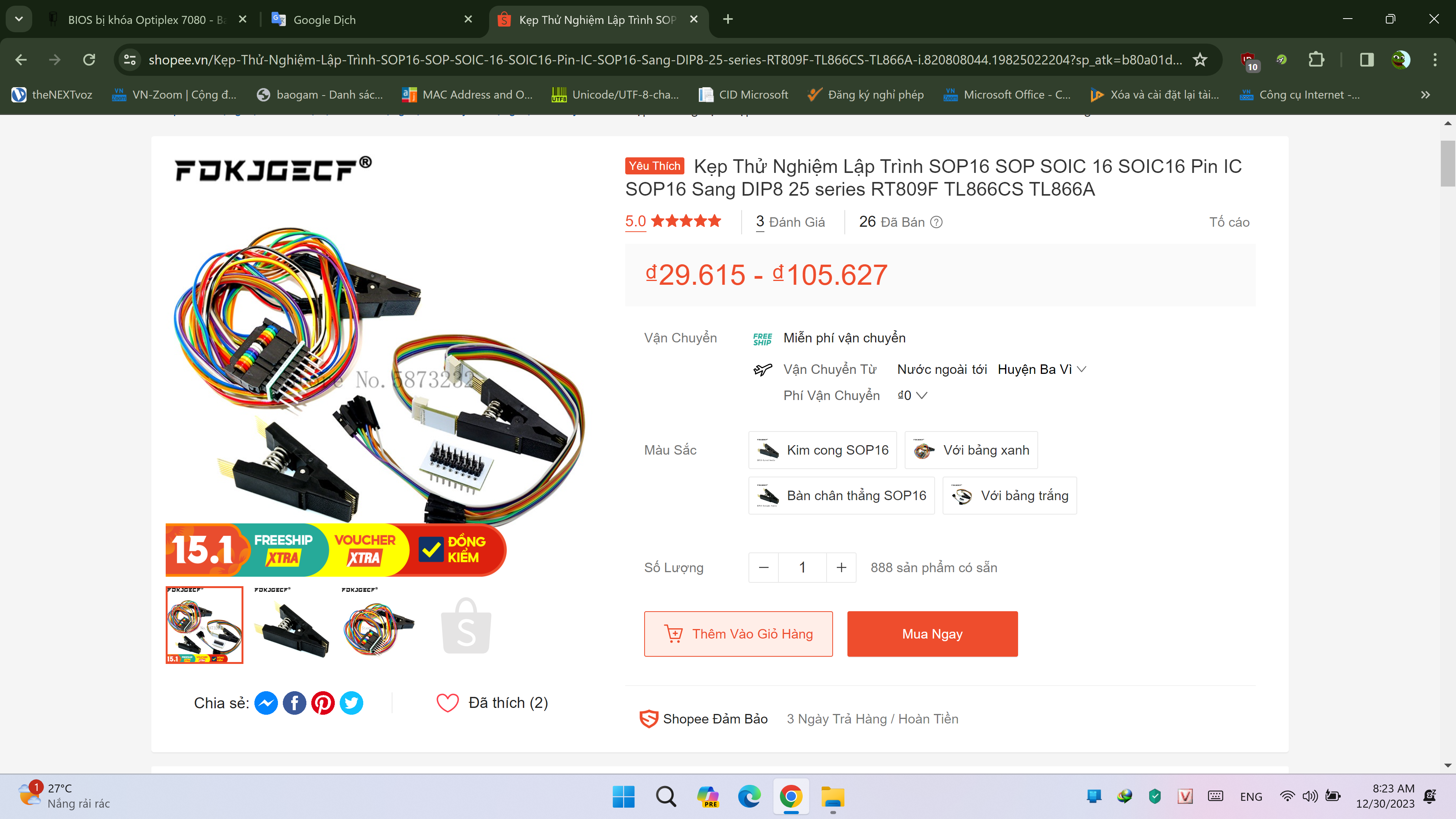

        Use 16pin clamp.

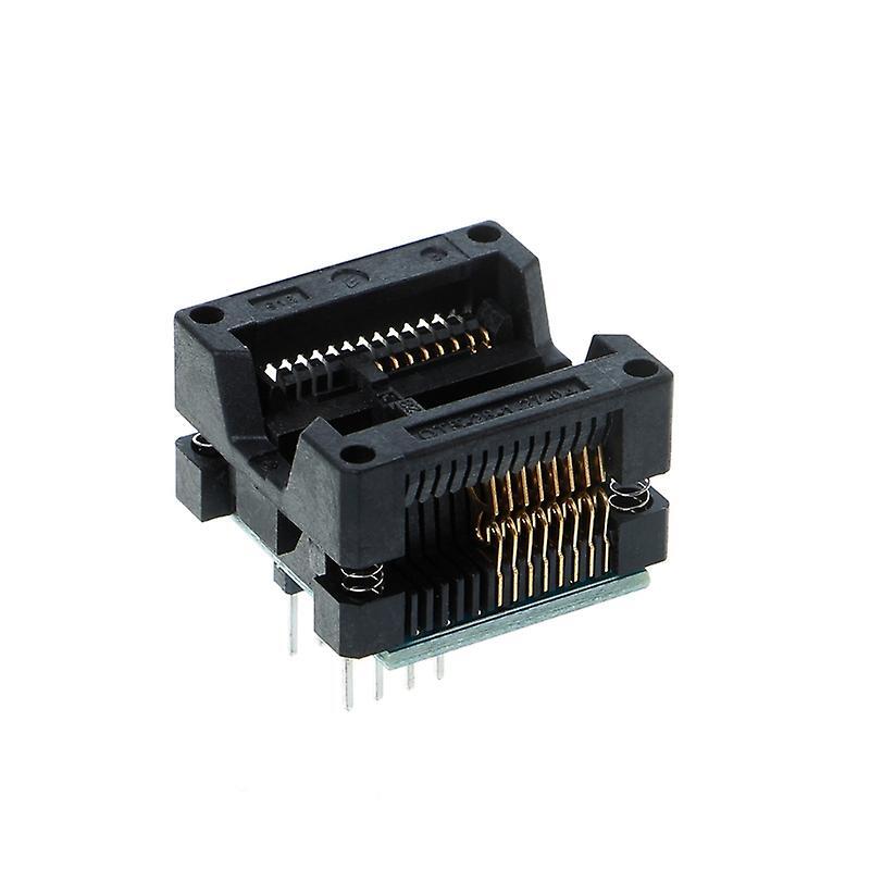

          you try Sop16 To Dip8 Adapter 300mil Socket Ic
            I cannot use this because the chip is welded to the mother board. Is there a clamp kit that I could use?
            I apologize, I'm still a rookie, I'm trying to understand how these things works.
