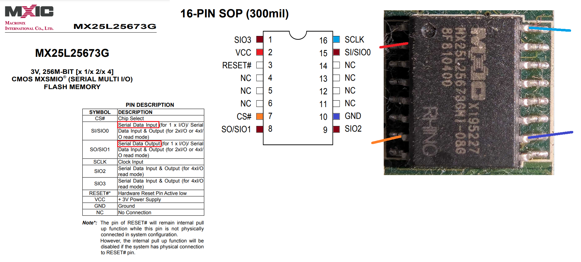

    elijahuff Derek Elliott i hope this image help.
    I think that if they jump cables to the reprogrammer where it should go, they can read the bios chip
    obviously remove the chip from the motherboard and then solder cables to the bios chip pins ( 256M-BIT ---> 32MB its the size of .bin )Click image for larger version  Name:	image.png Views:	0 Size:	892.1 KB ID:	3204558
