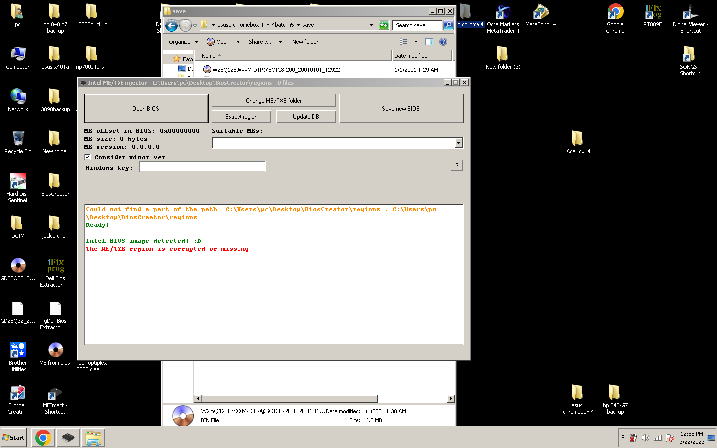

    How to Fix this i can't used to other unit but same model may be error ME/TXE region i cant fine firmware 14.0.40.1209 to make clean BIN
    any one can help me clean this file ME/TXE region thank you and advance
                try replacing ME Region with one extracted from another bios here. Use UEFITool.

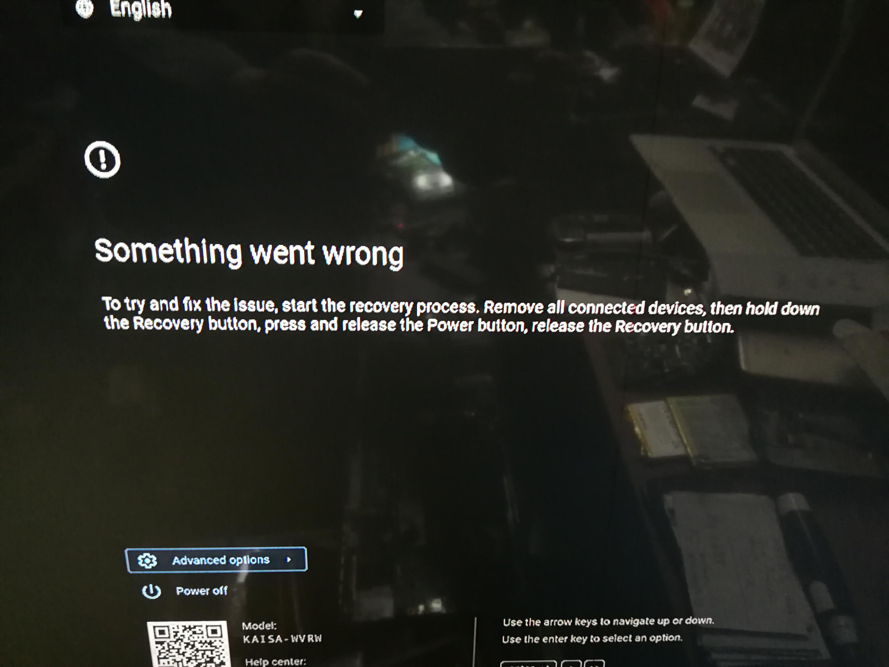

                      Hi thank you for your help. sorry it is not warking. I tried the one given to smallvhin. the box power on but the recovery crash. see attached image.
                      • volinakis
                        • Jan 2021
                        • 2723
                        • N/A
                        #31
                        Re: Acer chromebox CX14
                        reinstall, hold Recovery button and press power until screen shows "insert recovery USB stick" or something like this. After that press Ctrl+D, press recovery button one more time and screen will go off. there is on youtube how to reset or reinstall acer chromebox.
