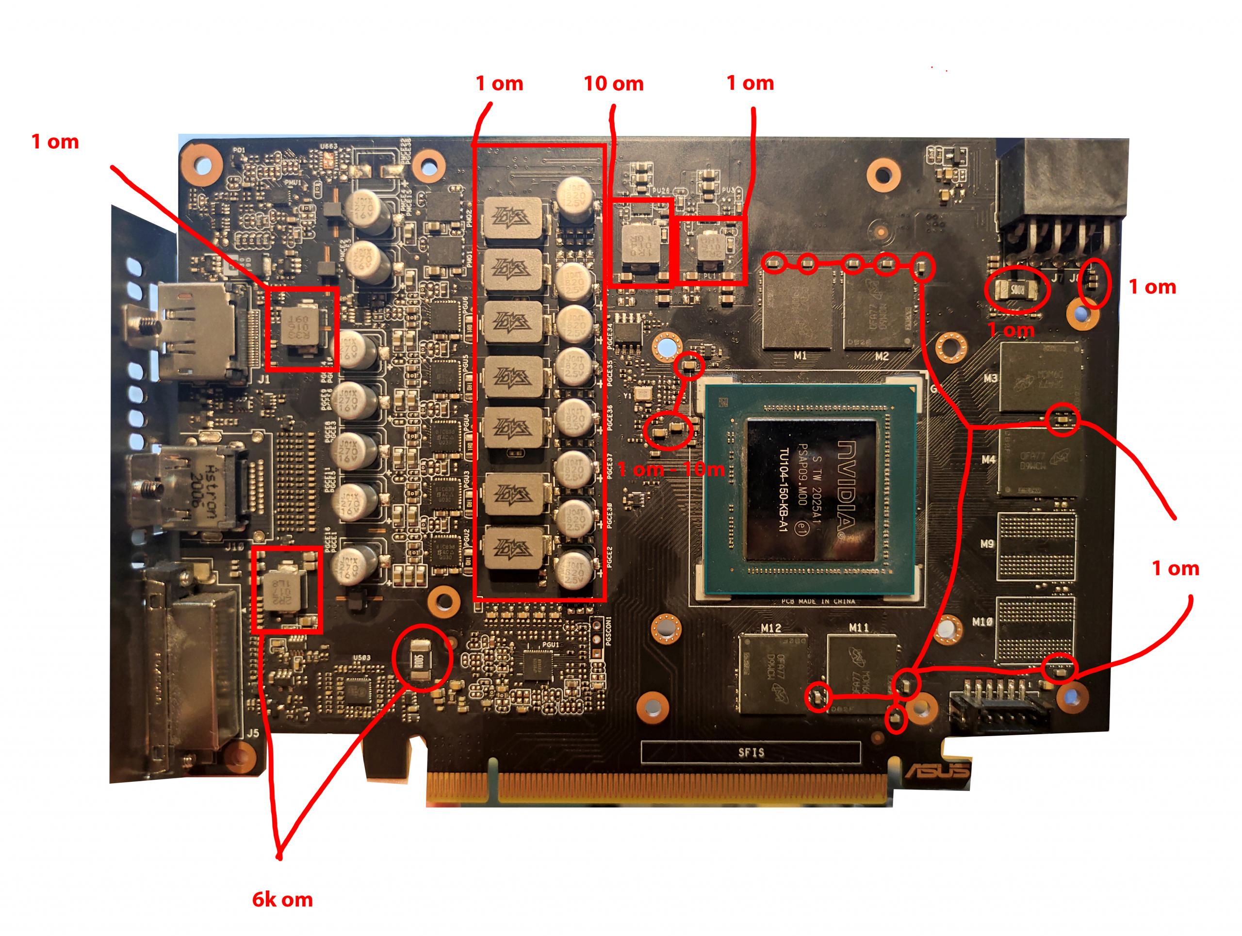

    Looks like I got short on a 12V, not sure how to pinpoint the short exactly.
    PCIe pins have no shorts, so GPU could be fine.
    At the back of the board
    PEX_VDD - 10 om
    MEM - 1 om
    I think I will have to get a desk power supply to inject the voltage I think, or maybe there is another way ?
    Also, I just had a look at a board view from MSI card and maybe the module that is responsible for 0.6v and 1V8 is making a short.
    If any of you have an idea, it would be appreciated.

    Re: ASUS DUAL RTX 2060 MINI - short on 12V
    remove coils from memory rail to find where is short
      I did a voltage injection and one memory is getting hot, will remove it and see if the short is gone.
      After removing the ram, the GPU is getting hot. So I think the GPU is dead.
        One mosfet was shorted, will get new one. So there is some chance that it will work again.
