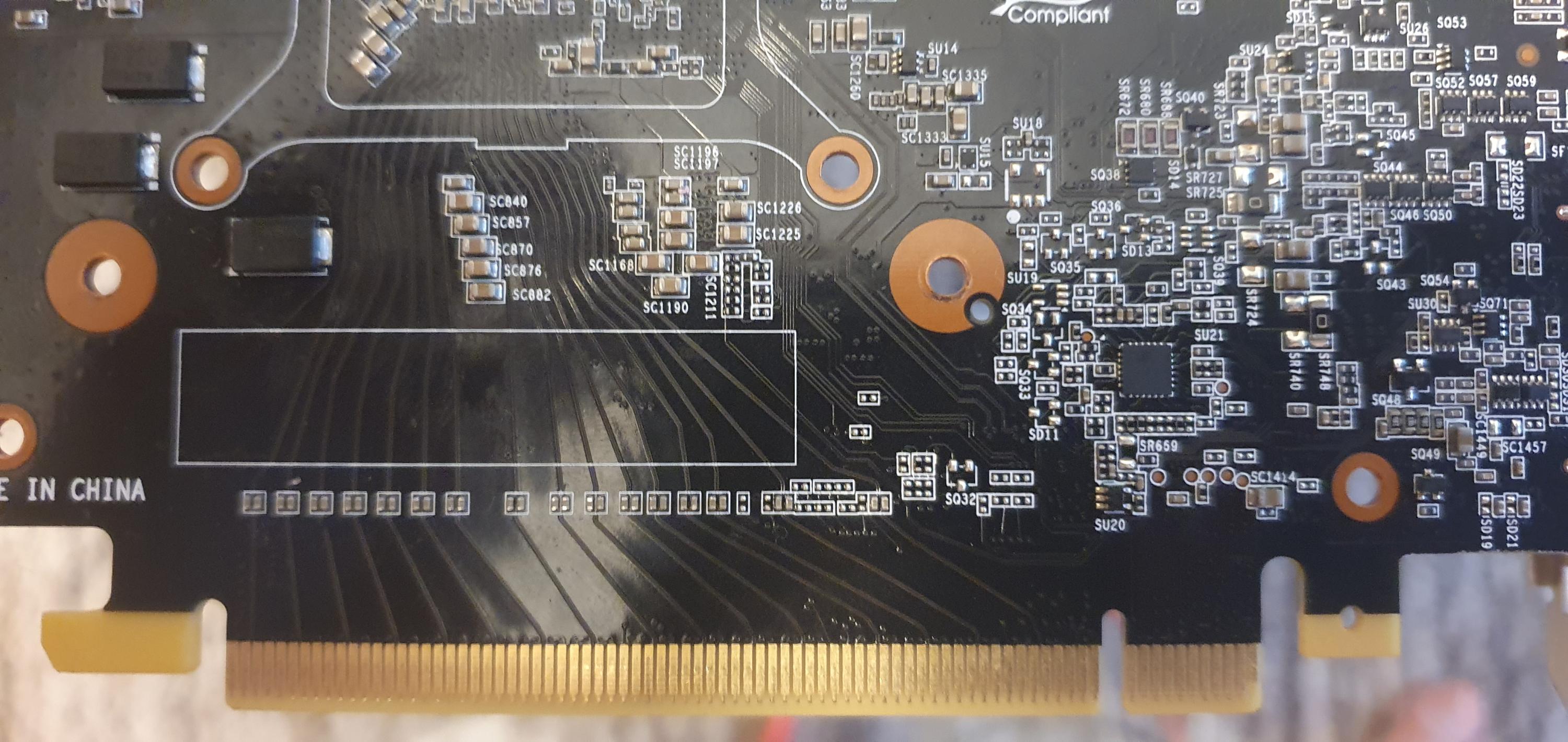

    Confirm the small SMD components are present near the PCIe gold fingers.
    Sometimes, a part can be damaged or go missing which will halt the detection of the PCIe adapter (any). Do inspect both sides of the PCB.
    Mainly, there will be tons of dc-blocking caps that are 0402 in size. Each and every one should be present on the PCB if you have solder pads onboard.
    Post pics if you can of the same area.
    What is the history of this adapter ? It was working one day and stopped the next ? Was it dropped ? Any liquid damage ?

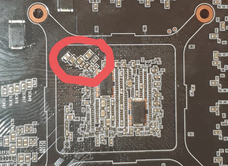

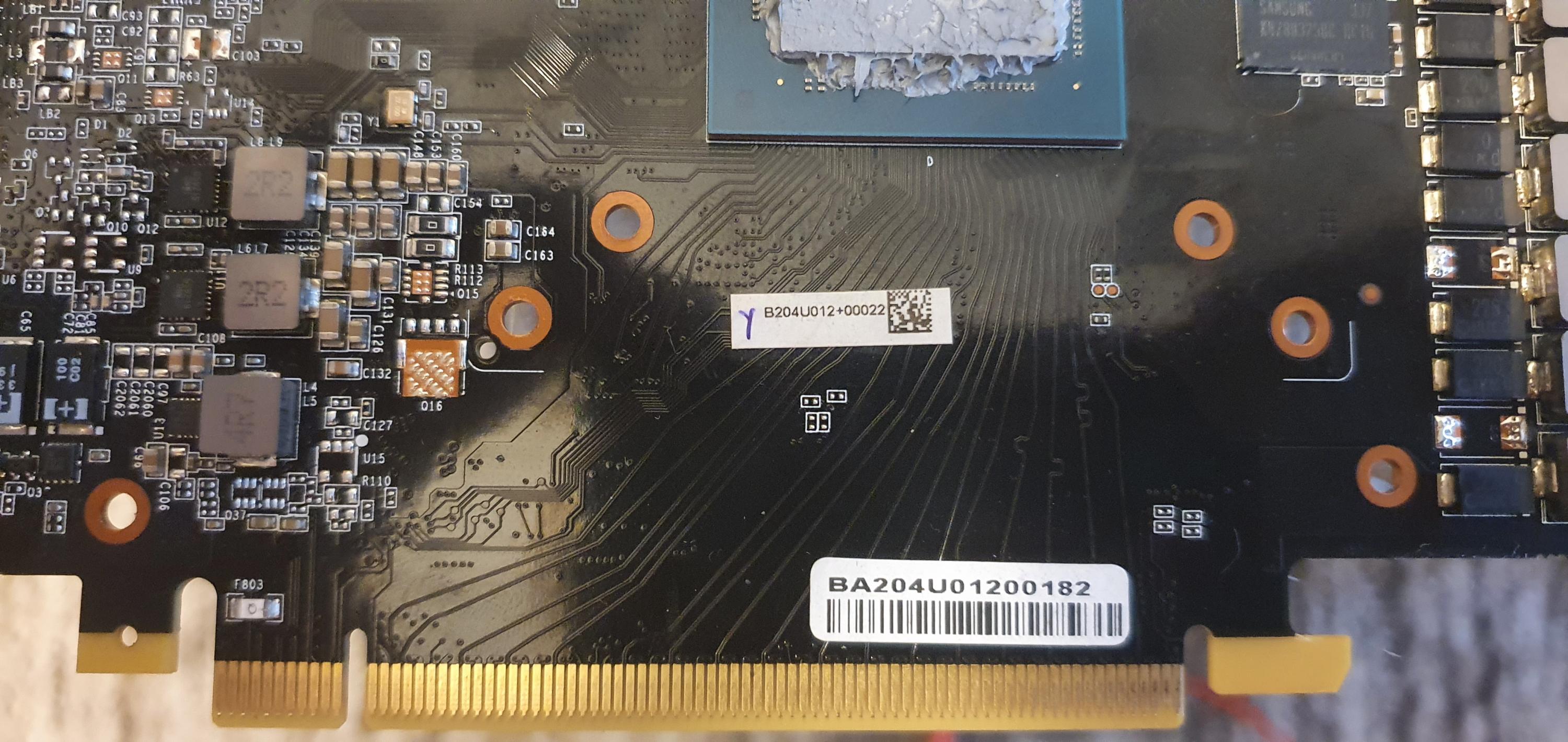

        • gamaliux
          • May 2022
          • 11
          • Lithuania
          Re: Need help for Gainward RTX 2080 Super repair
          Hello Mon2,
          Attaching photos as you asked.
          I have checked each capacitor, there is continuity between pcie pins and caps, after caps I can see around 0.8V drop between GND. It seems that all pairs are ok.
          Also you can see a photo where I have circled capacitors.
          I can see that two of them may be soldered not originally, as I can see solder on full both capacitor sides and it is shiny. Also those caps shows 0.4ohm on them. I do not know if this is ok, but if these caps are realated to core 0.8V it is possible that it is ok, as there I can see 0.3ohm resistance on this voltage line.
