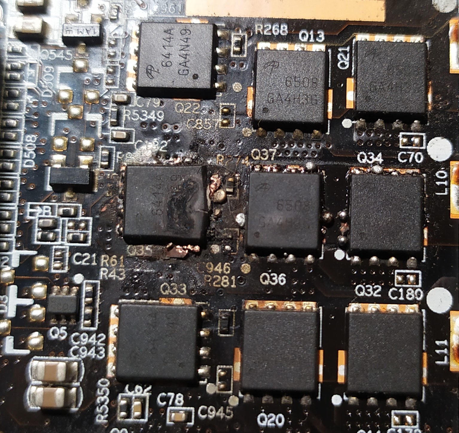

    My gtx 970 gigabyte windforce smoked(((
    Tell me, is there hope to revive her?

    That looks nasty. No real way of knowing "what lies beneath".
    Start with removing it, hope you can save the pads and take measurements.
    The low side MOSFET to the right of the burnt one seems to have a bulge.
