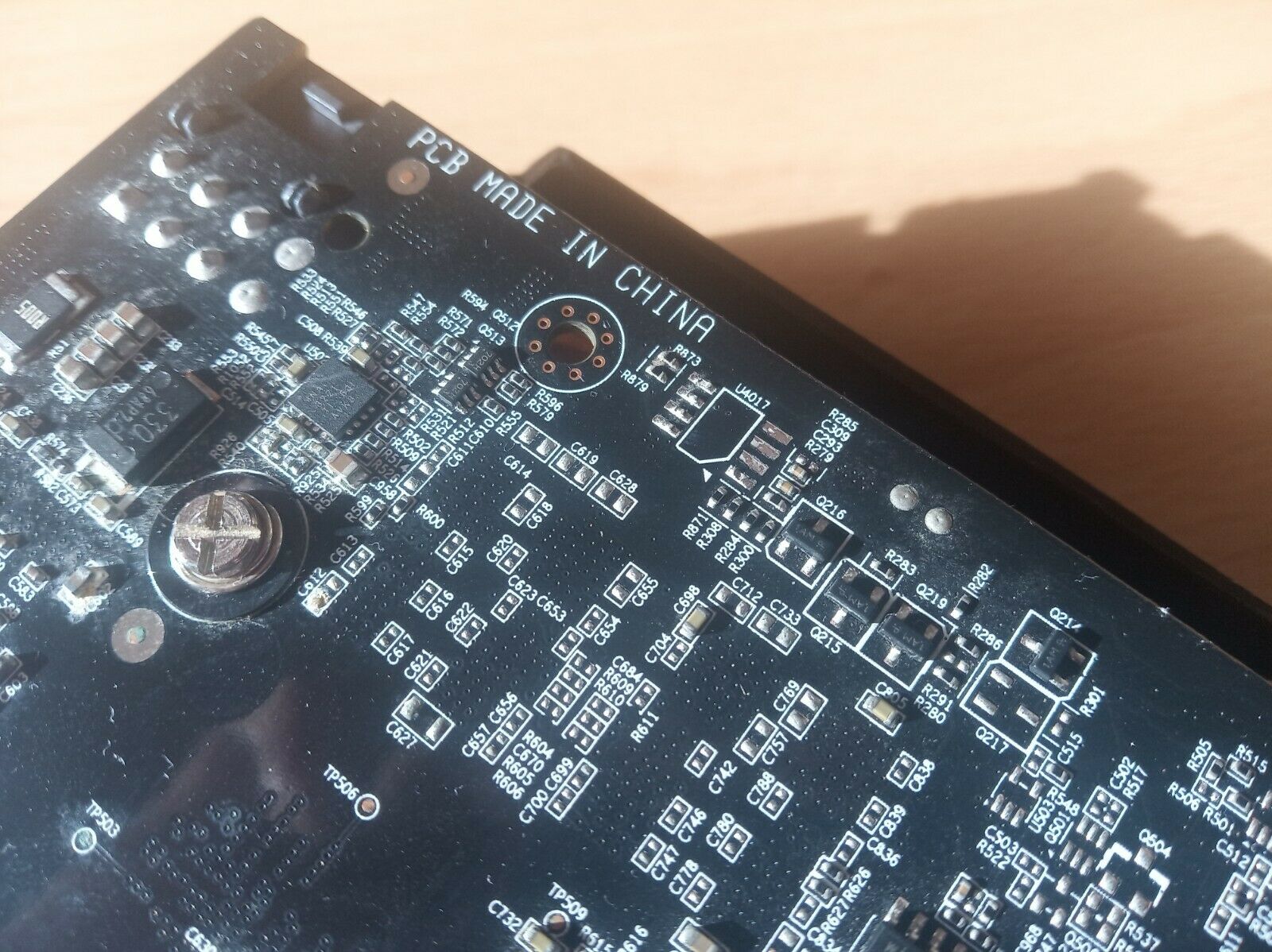

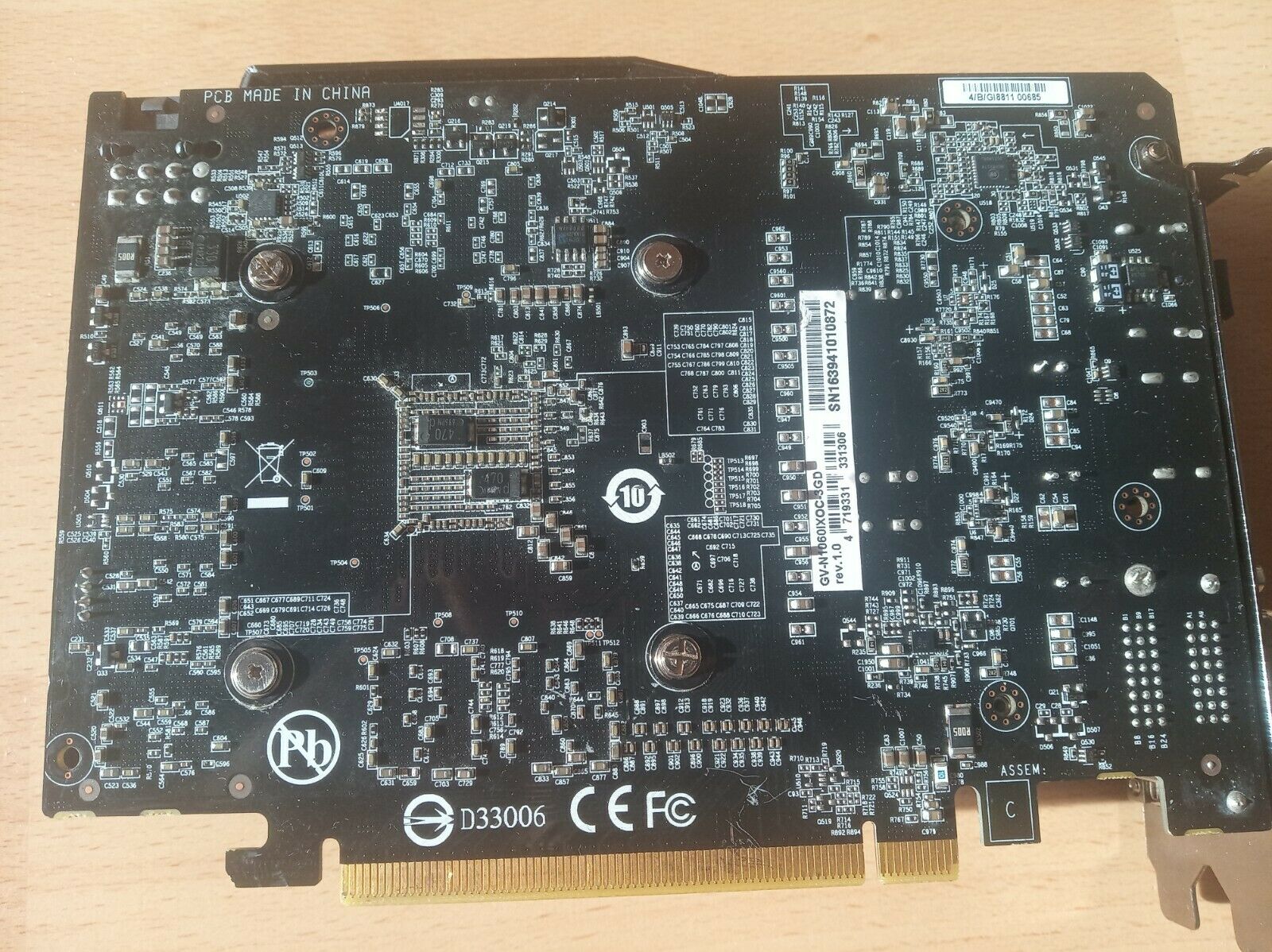

    I have a GIGABYTE GTX 1060 MINI ITX OC 3GB (GV-N1060IXOC-3GD) on my way and it looks like it's missing a component. Unfortunately there aren't any good high resolution photos of the PCB on the internet and I would like to order & replace this component - the U4017 on the photos.
    Thanks for any help in advance!

    Looks like this should be an LM358 opamp

      Hi Bozog, thanks, that seems correct, I got another card just like it (but the 6GB version) with an identical layout.
      Do you maybe have the schematics or boardview of this card? I'm not getting NVVDD_EN signal and for the life of me I can't find the AND gate which should send it.
        Re: GIGABYTE GTX 1060 MINI ITX OC 3GB Component Identification
        Not that exact card, but there are several schematics over here that will help https://discord.gg/VfARmUpgdV
