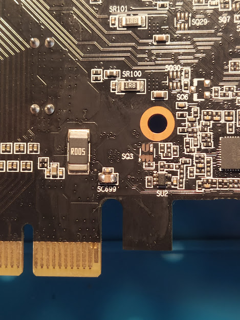

    Hello.
    Have this Palit RTX2060 Super 8GB Dual with RIPped off component SQ3. Can somebody check marking on this component if u have one of this cards.

    Re: Palit RTX2060 Super 8GB Dual - RIPped off component
    its been a long time but im still searching for it
      q_fet_n_enh_SC70_6. use bv ms-v375 r2.2 it same structure
