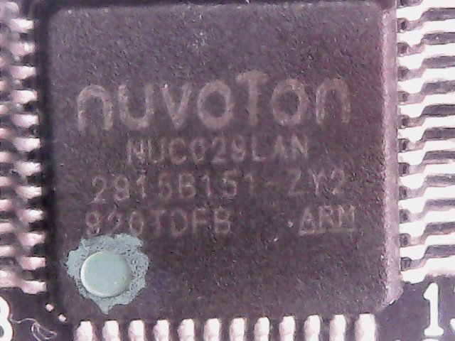

    I am trying to save RX 5700 XT Sapphire Nitro. Computer was normally shut down in the evening and next day graphics card was not responding - no post.
    I have done some troubleshooting but I've come to dead end.
    What do we know so far:
    - LEDs light up and cycle trough colours as normal
    - fans light up but don't spin
    - all fuses are OK
    - no shorts
    - no visual damage to PCB or components
    - GPU is not heating up
    - 12V (from 3 connectors) - present
    - 5V (from 2 regulators) - present
    - 3,3V (from PCIe connector) - present
    - No 1,8V
    - No 0,75V
    - No 0,9V (Vcore and/or Vmem)
    Now since there is no 1,8V of course there won't be anything going on until that is present. This is where I've hit the dead end. I can not identify any of voltage regulators and since I can not do that, I can not get pinouts. If I don't have pinout then I can not see what is going on with regulator etc.
    Hopefully someone here will be able to help me. Either with identifying regulators and therefore pinouts or maybe just with other advises.
    I have prepared some graphics for front and back of PCB so one could easily understand current situation.
    Red arrows - 12V is present at these points
    Green arrows - 5V is present at these points
    Orange arrows - 3,3V is present at these points
    Blue arrows - 0V is present at these points
    Yellow squares with numbers - unknown voltage regulators that I need help with
    On marked "unknown" voltage regulators these writings are present:
    1.) 7162 0NVZ
    2.) FFK 153
    3.) FFK 153
    4.) Nuvoton NUC028LAN - probably only used for LED and fan control
    5.) AREK 930
    If someone could help me with identifying these it would help me a lot.
    Also I have no idea which one of these produces what voltage, so that would also help.
    Any help will be greatly appreciated.

      • dicky96
        Sun Seeker
        • Mar 2017
        • 1825
        • Spain
        Re: AMD Radeon RX 5700 XT Sapphire Nitro - troubleshooting and repair
        1.8V is usually an LDO, not a buck regulator - if that helps
        It is usually near the PCIe connector where the 3.3V come in. I suggest you trace from PCIe 3.3V and see where it goes to in that area
        What are the two 8 pin SOIC chips near the PCIe connector? Is one of them a uPxxxx? If so that is probably the 1.8V regulator

          • for.software3.45
            • Jan 2022
            • 12
            • Eu
            Not a whole lot of progress but better something than none at all.
            Since I've got nothing to work with I started comparing working and non-working "unknown regulators" with the same designation (numbers 2 & 3 from the first post, both FFK 153). The working one is for 5V rail on the top of the card (#3) and the non-working (#2) one was for unknown voltage source near PCIe connector. Since only the output voltage is suppose to be different I started comparing them pin-to-pin.
            Here is what I found.
            On the non working one there was one pin without signal (apart the output one of course). That pin was connected to 10kOhm resistor which had 3.3V on one side (the one not connected to FFK 153) and 0V on side connected to the pin. This 0V side was also connected to another line which I traced back only to find out it comes from the back of the PCB - from another "unknown regulator" AREK930 (#5 in first post). This must be "power good" from AREK to enable the FFK 153. Because of this I believe that AREK930 is the one that produces 1,8V on this card.
            If I had pinout for this "AREK 930" regulator things would be alot easier. The unit itself has 16-pins. 12 in DIL configuration and 2x2 on the sides (photo attached in first post).
            Hopefully someone will recognize this element.
