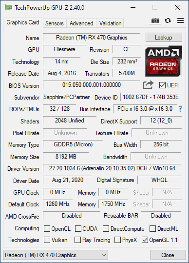

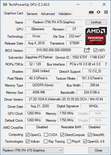

    Does anybody know if it possible to change memory on a 4GB SAPPHIRE RX470 (a mining version with only one DVI connector) to 8GB only by changing the GDDR5 chips to higher 8GB capacity type ?
    Will the card recognize this automatically, or needs something more to be done, eg. a different BIOS ?
    Are the RAM chips to be same vendor, or can one use any vendor, eg. Hynix or Micron (the card has physically Samsung chips K4G41325FC-HC28 chips, although BIOS shows Hynix) ?
    Attached the GPU-Z screenshot of the card.

      Just changed the memory to 8gb Micron D9TCB and changed the Bios to 8gb Bios (according to Techpowerup suitable for Samsung and Micron) . The card starts and gives a picture, shows also 8gb and is correctly listed in device manager, however its not stable, any test eg. OCCT freezes the system with a black screen. Also an attempt to mine ends in freeze. So there must be something more than Bios, or timings have to be corrected to the specific rams. I have also seen on Nvidia schematics some hardware coding for different ram vendors, maybe something like that? Or maybe AMD just deliveres for 4gb cards GPU's which have production failure in 5-8gb address area, and just can only work up to 4gb? I will dig more into the topic and get back if any success.

                  Installed the card on a newer motherboard and booted. During boot Bios gives me the following message:
                  There is no GOP (Graphics Output Protocol) support detected in this card.
                  'BIOS CSM/UEFI Mode' settings in BIOS will be changed to 'CSM'.
                  Press F1 to run setup.
                  Press F2 to load defauls values and continue.
                  Read somewhere this is a conflict in the HAL (mobo and card bios conflict), to be resolved by changing to UEFI again. Unfortunately if I do this, the Bios resets again to CSM, so no way forward.
                  After booting Windows in CSM mode, device manager shows error 43. The card runs, but only under Microsoft Basic Display Driver, not under the AMD driver. GPU-Z shows Open GL 1.1 only, Furmark does not start, requires Open GL 2.0 as min..
                  Any help appreciated.
