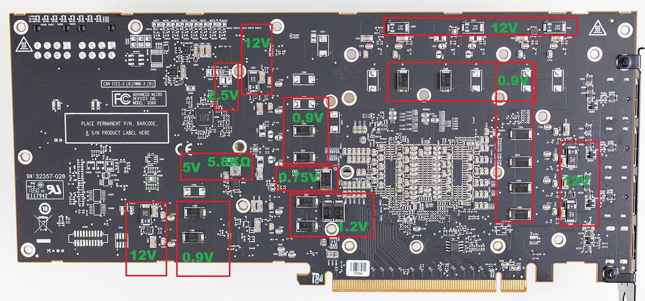

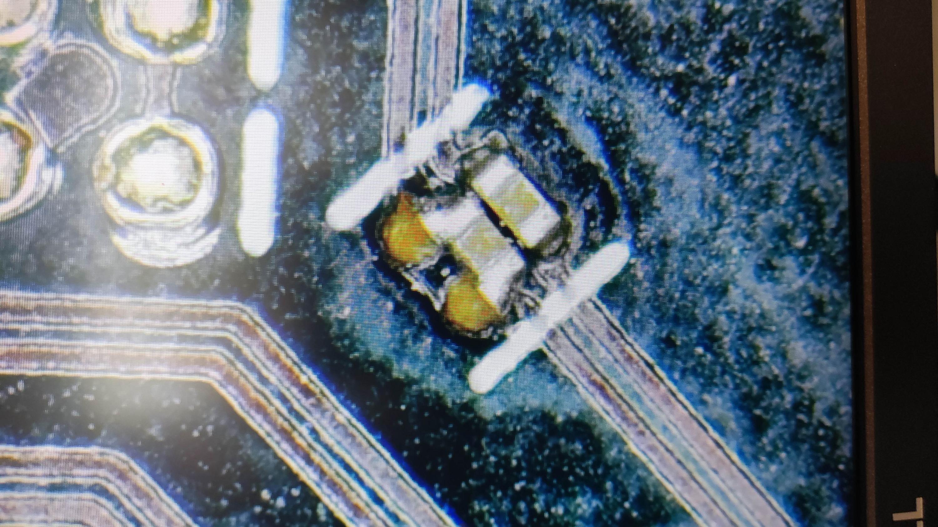

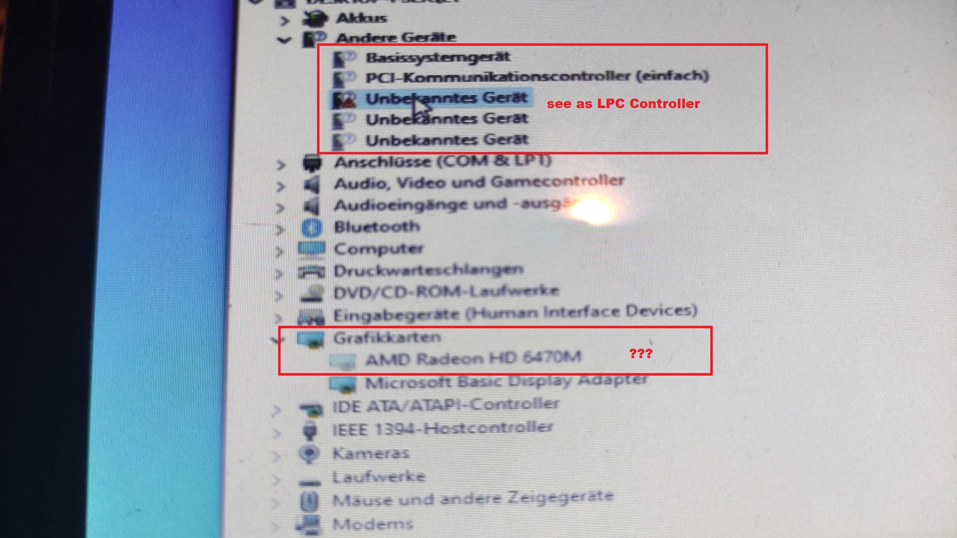

I got a Radeon VII as virigin, unopened, but not working card. Windows not detect, see something, but not recognize what it is exactly. Radeon software's the same. For the first look i found a broken cap, a bit up from the PCI pins. One lay down to the other, i thought bingo, but after correction still not post. (Possibly the cap broke while the previous owner tried to insert and remove the card few times)

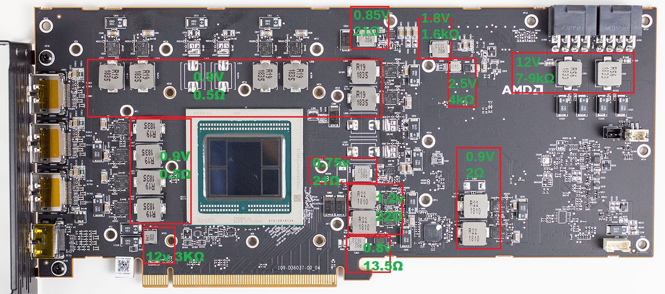

Measured the voltages stable, gpu getting warm, resistances think good so far, all seem ok for me, pls see the pictures below. Connected directly to the bios chip, dumped than updated, but still not working.
If the card has no short and voltages still present, i have no more idea where the problem be. Anyone idea for recognize?
