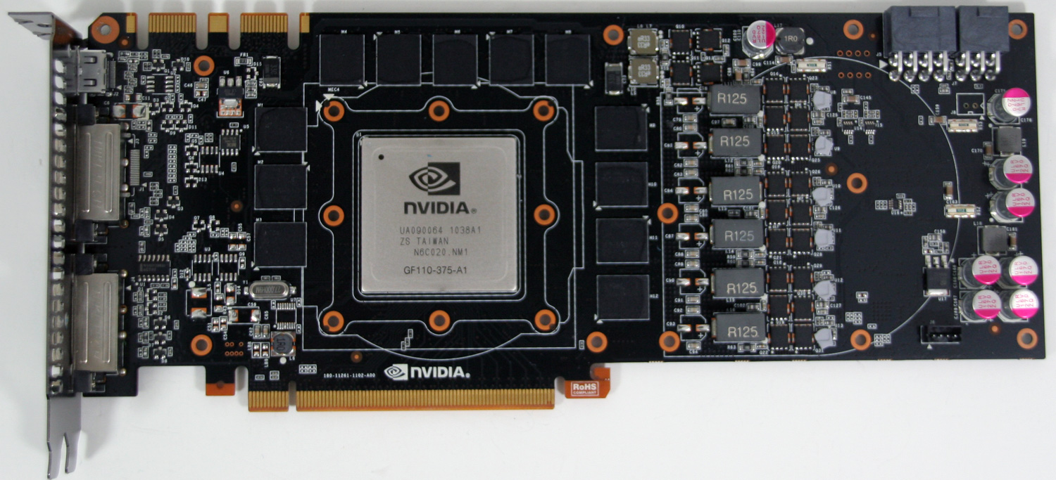

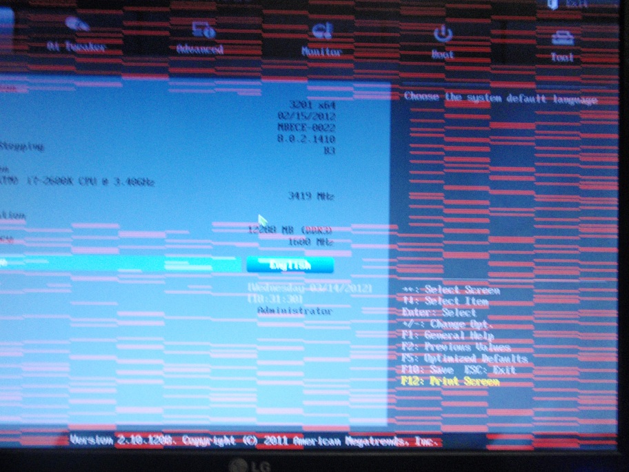

    Hi, I wonder if anyone could give me any advice on this. I've had this card for like ten years and it suddenly started showing artifacts and the PC crashes when trying to log into Windows. The attached photo I found on the internet but my case looks identical. I reduced the voltage with msi Afterburner from 1025mv to like 963mv and then an hour or so later, while running an intensive game the PC just crashed. Typical of me to do dumb things but my PC was baking, so yeah... From what I've read undervolting shouldn't physically damage anything but it seems too big of a coincidence. Although I've seen quite an amount of similar cases with this card on the net, but nothing too helpful. I've also seen these cards getting fixed by reballing either the GPU or the VRAM chips but then later I've heard it's not really the reballing that fixed it but the heating of those chips that is supposedly only a temporary fix. Yet I've heard others claim that it is indeed the BGA at fault, because manufacturers use lead free solder that's prone to cracking... What are your thoughts on it? I've run this bootable tool called "Video Memory stress Test" and it did spit out tons of identical errors but I'm yet to figure out what it means. One thing I might try to do is edit and reflash the GPU's bios with lowered clocks, since this card is slightly factory overclocked. Would be glad to hear your ideas!

    the gpu is toast. no amount of messing with the voltage or clocks will fix it. u can try reflowing it but the success rate is low for nvidia gpus.
    the better solution is to prevent this from happening in the first place. prevention is better than cure. the preventive measure is to make it run as cool as possible. the cooler it runs the longer it will last. many video card manufacturers use undersized or inadequate coolers and/or crappy/slow fans. u can get around this by always running the fan at full blast either by using overclocking software like msi afterburner. however, the system would become very noisy then.
    another way is to replace the stock cooler with a better and quieter one like the arctic twin turbo or accelero extreme. since this is a lead-free gpu, always make sure it runs under 70°C at all times to make it last long. research has shown that tin whiskers form at an exponential rate at temperatures hotter than 70°C, thus lead-free gpus will die fast if they run at above 70°C for long periods.
    anyway, u got 10 years of life out of that gpu which is pretty impressive for a high end gpu. unless that system or hardware has sentimental value or legacy purpose, its time to move on and get something better...

      The thing is, it had barely any load on it for a few hours before it crashed, then I started a very intensive game and like a minute like it crashed. I was also doing some Alt+Tabbing, so I suspect thermal cycling was the final push. I feel like one of the BGAs cracked, either the one between the card PCB and the GPU PCB or one of the memory chips. Or it could be the micro-BGA that's in between the GPU PCB and the actual silicon die.
      Also, just like in that photo I attached, mine also has this rectangle of area where there are no artifacts. Kind of makes me think that one of the memory chips is at fault. I've tried putting pressure on every memory chip and the GPU itself while it's running to see if the artifacts go away but unsuccessfully, there's probably too much surface tension on those BGA balls and when they break a big gap appears.

          they're not. a break in the many connections that connects the gpu to the video ram can also occur, giving the appearance of bad memory, memory artifacts or memory related issues but really its just the gpu breaking its connection to the video ram due to age and heat.
          also, some video memory errors can backfeed further and further into the frame buffer, making even more errors. so just one bad connection from gpu to video ram can give the appearance of multiple artifacts.
          since the gtx 580 is a 384-bit mem bus video card, so plenty of things and connections to go wrong and break for it to fail and produce artifacts.

            Also please take a look at the attached picture, see those six unpopulated SMD capacitor slots? My card is like that. I wonder if it hurts the card not having them. I've seen other versions of this card that do have them installed.

                PS.: for the caps google for pictures on the internet of same type of card and compare.
