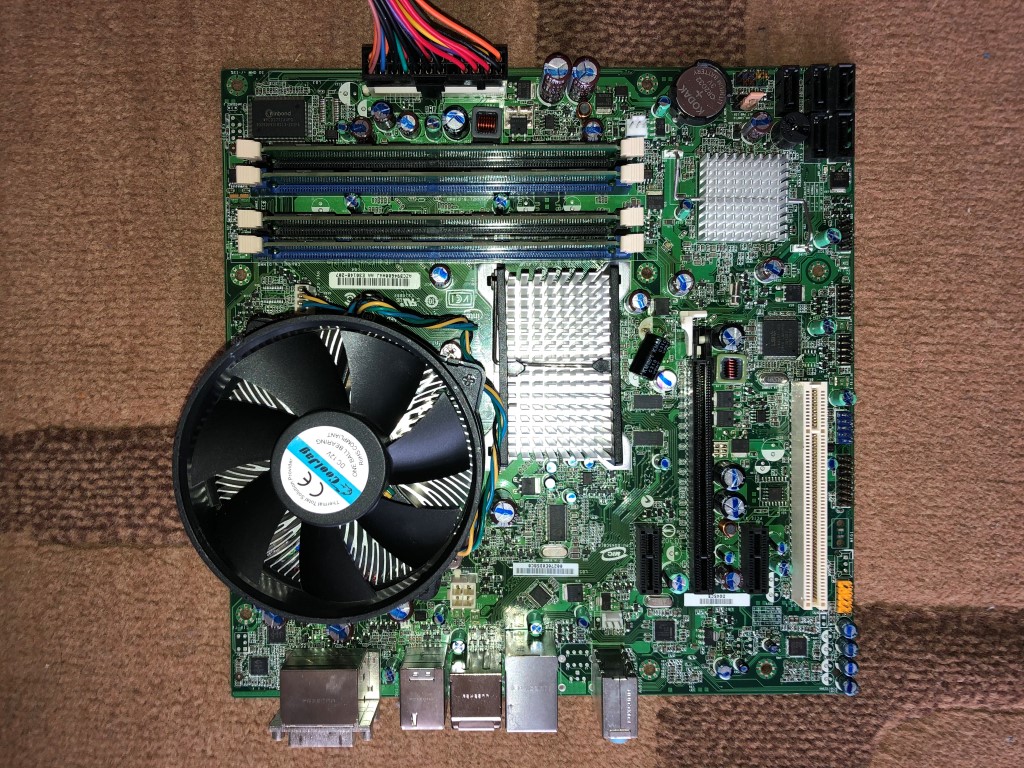

    I have two Intel DQ45CB Based PC's. One works, the other does not.
    When power is first applied to the working one, it will immediately start up, and shut down again after about 5 seconds. Upon pressing the Power Button, normal boot up occurs.
    When power is applied to the faulty one, you just get the Green Motherboard Power LED on. IF the power button is pressed, the CPU fan goes full speed, but there is no display output to the onboard DVI connector (or graphics card when fitted), there are no beeps.
    I have removed the RAM, Graphics card, all front panel connectors, drives etc, changed the PSU, all with no change in behaviour.

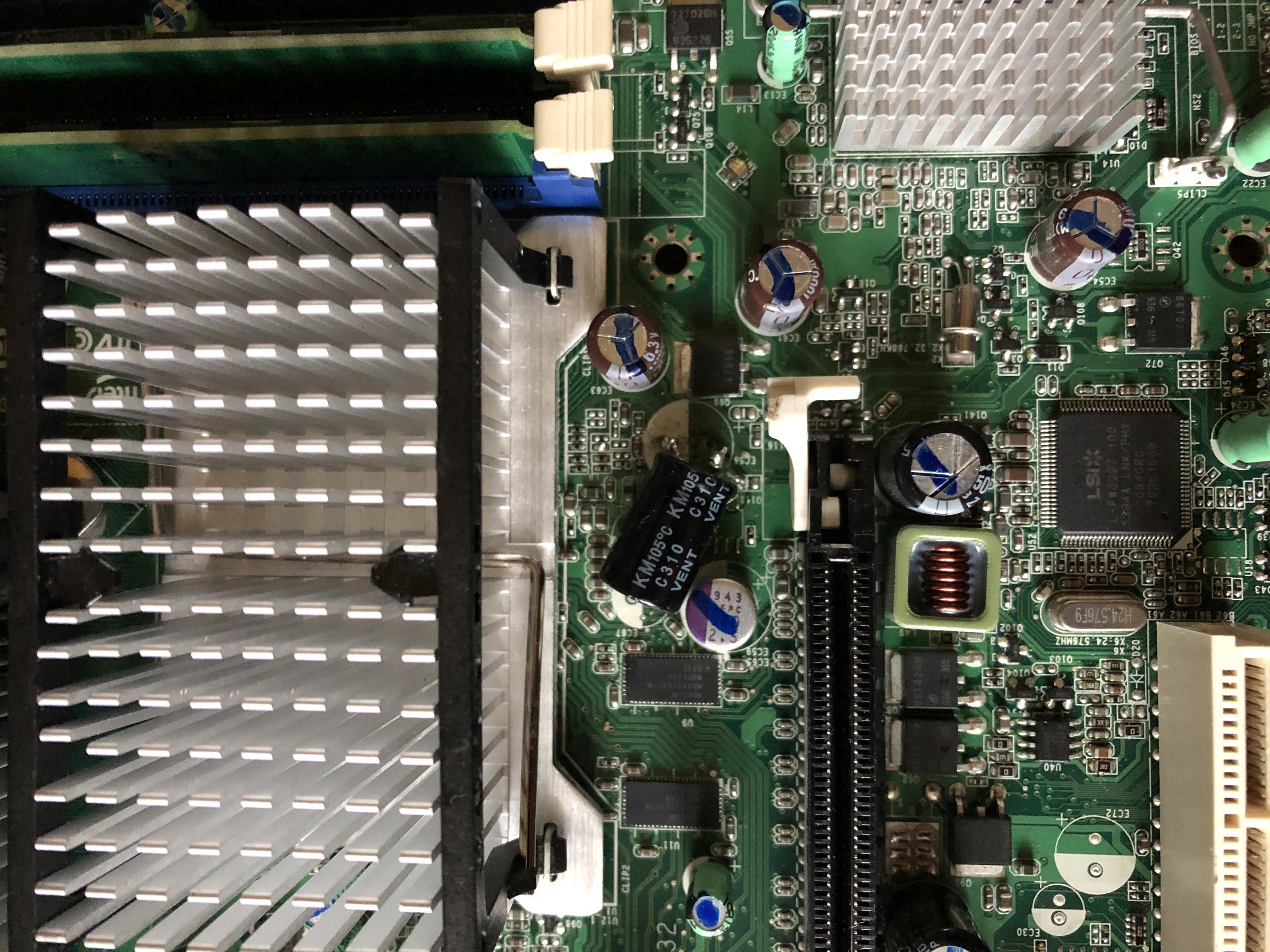

    I have replaced a capacitor which had shown signs of bulging (only one capacitor on the board is bulging) with no change.
    I did try booting with the 4-Way CPU power plug removed, and then when powered up the CPU fan ran slower (don't know if that helps or not!.
    All board fuses are OK.
    The voltage across the replaced capacitor is about 1.1v (Capacitor rating is 6V3 1500uF)

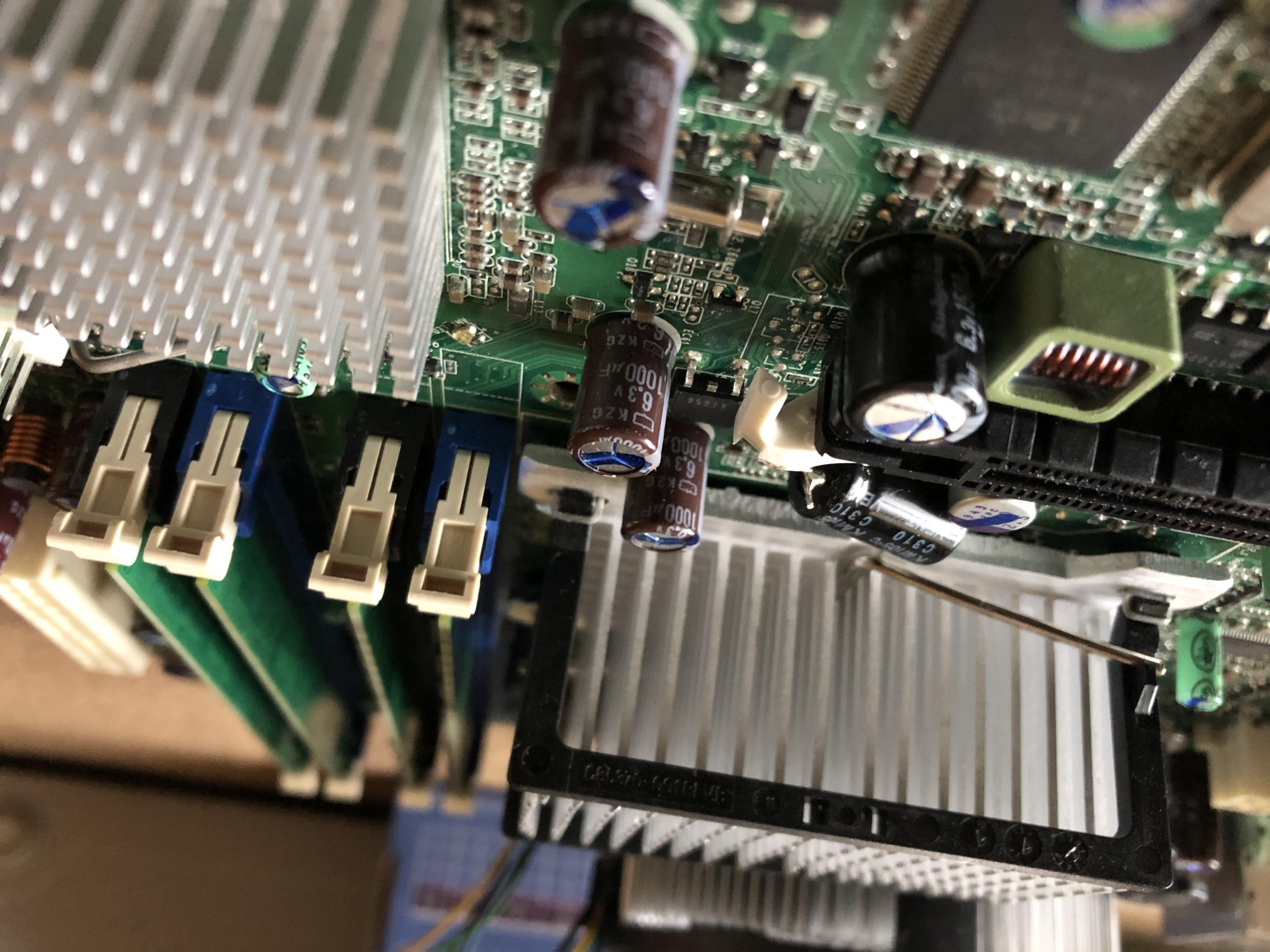

    Can you post a picture of the mother board and which capacitor you changed?
    It sounds like it was on Vcore (if it has about 1.1V across it) but I would like to be sure you do have Vcore to the processor.

      The capacitor I changed was not near the CPU, so not sure if it is supplied from VCore. It is located near the Graphics slot.
      I managed to remove the capacitor, but was unable to clean the hole out to receive the replacement, so I did a temporary fix (which looks very amateurish for someone with 30+ years of soldering experience, hence why I am reluctant to post a picture!) for test purposes, as I didn't want to lift any tracks on the reverse side of the board.

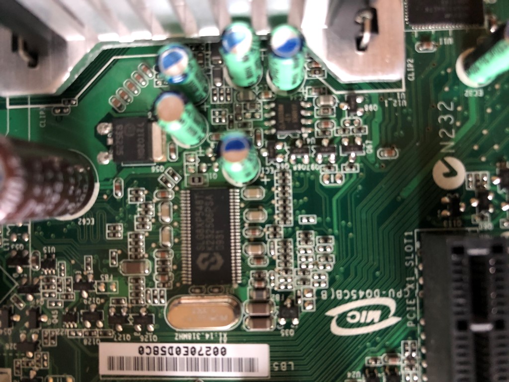

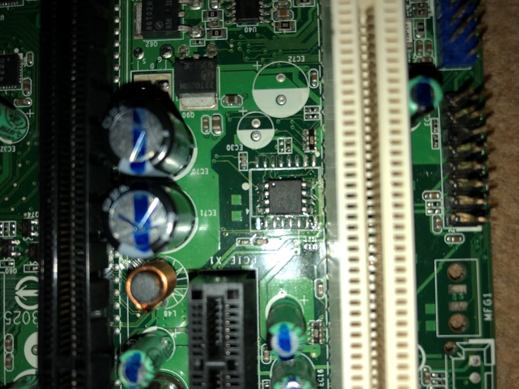

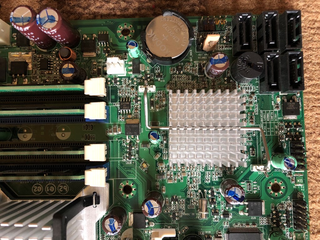

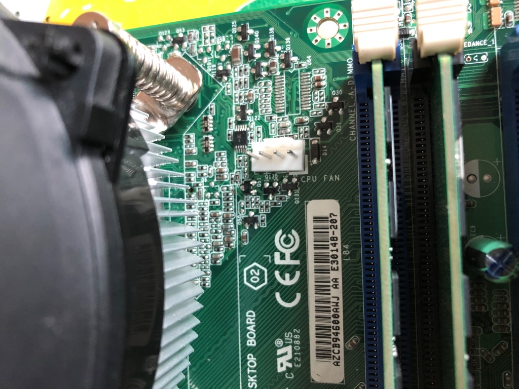

                          So we are going to have to work from component datasheets. Can you post some pics of the motherboard here please. maybe one pic of the whole board and a few close ups of each area.

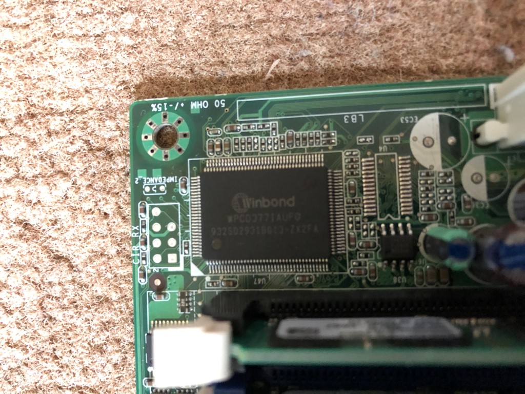

                          The next thing I would be looking for is the SIO - what is the part number, can we find a datasheet?

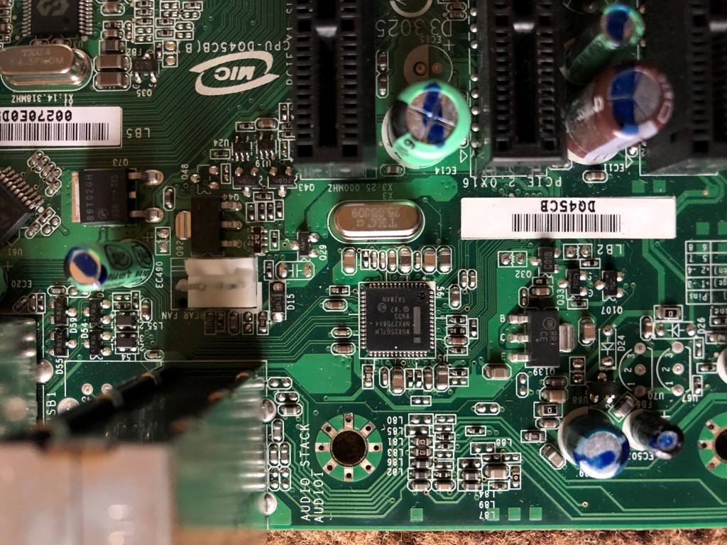

                            There a couple of crystals on board.
                            32.768KHz (cylindrical type) and a 24.576Mhz
                            The 32Khz crystal measure about 32.5Khz with my DVM, so I will say that is working. Cannot work out which is the RTC chip.

                              Hi Russ. The 32,768 will be for the RTC and this should oscillate even when there is no PSU - it powers from the CMOS battery
                              The 24.576MHz will go to the clock generator and from there it generates all the clock signals for the motherboard, CPU PCI etc. This should be oscillating once power is applied to the motherboard and you turn it on.
                              The RTC will be built in to the SIO
                              Can you post some pics of the motherboard close enough to read the IC markings please.

                                  Hi Rich
                                  I have taken some pictures, but getting the chip numbers visible is not so easy!
                                  Picture quality may not be great due to having to resize them to upload them.
                                  I have replaced the existing fan with a stock Intel LGA775 fan.
                                  Additionally, when powered on, the MB now wakes up on its own (like the good one does) but doesn't shut down after 5 seconds like the good one does (this situation occurred without any further action on my part.
                                  It just stays "running" with the Intel fan running at "normal" speed now (not full speed like the previous fan was doing).
                                  When system is running, I can command it to go off by holding the power switch for 4 seconds (normal)
                                  I can then power on with the front power switch (by momentary press), but it still doesn't actually boot.
                                  The LED on the mouse lights briefly on power up.
                                  The LAN connection has Green and Orange indicators when connected to a WIFI repeater hub by LAN cable (just to verify the function of the LAN chip)
                                  I have heard three beeps at startup on a few occasions, which according to the Intel website, indicates a Memory Issue.
                                  I have swapped all the memory, but no change - no boot.
                                  I have not taken the CPU or Memory from the other system as I don't want to risk any issues on the working system as it is being used by my son for home schooling.
                                  The CPU was a spare and the Memory I used to swap was taken from the other system as I added some extra memory to that system, so the memory should be OK.
                                  All MOSFETS appear to test OK and voltages on them are "expected" like 5V,12V, 3.3V 1.8V, 1.1V - none are running hot.
                                  May be time to buy a PCI analyser as there seems to be nothing else I can measure as being wrong.
                                  I cannot work out which chip is the BIOS SPI chip - maybe the 8 pin SOIC that is near the graphics slot?
                                  Russ

                                    I can't see the chip numbers either. The BIOS chip will be an 8 pin SOIC probably part number like 25Qxxxx or 28Xxxxx or similar - it may well say Winbond on it but not 100% it will

                                      Can you please post a picture of the area with your replaced capacitor that dicky96 asked about?
                                      To me it looks like the capacitor next to it is bad from your overview photo.
                                      It is also important that a proper LOW ESR capacitor was used as the replacement.

                                        Hi Per,
                                        Thanks for getting in touch.
                                        The replacement capacitor was salvaged from a TV PSU output stage, so I am hopeful that it is a Low ESR type, but I cannot prove this.
                                        At this point, I was hoping that the faulty capacitor may have been dragging the VCore voltage down, but the replacement capacitor has not changed the voltage, but it was a 1.1V before I started the work, which seems to be about the right voltage to expect.
                                        I attached some pictures (ignore the terrible soldering job).
                                        The capacitor which I replaced was the only bulging one on the whole board, and it not near any heatsink, not even the graphics card which was plugged in near the capacitor, as the heatsink was on the other side of the Graphics Card.
                                        I have yet to use "tested" CPU & RAM components, to rule these out as causes.
                                        In my limited experience, I have only ever seem one bad RAM stick, and that only caused issues when the particular address of RAM which was faulty, was addressed, so the fault was quite random. I have never seen a CPU failure - not that this is impossible, especially of the CPU was overclocked, or under cooled. I know that that this CPU was definitely not overclocked.
                                        The original CPU fan does run full speed, so under cooling is also not a likely cause.
